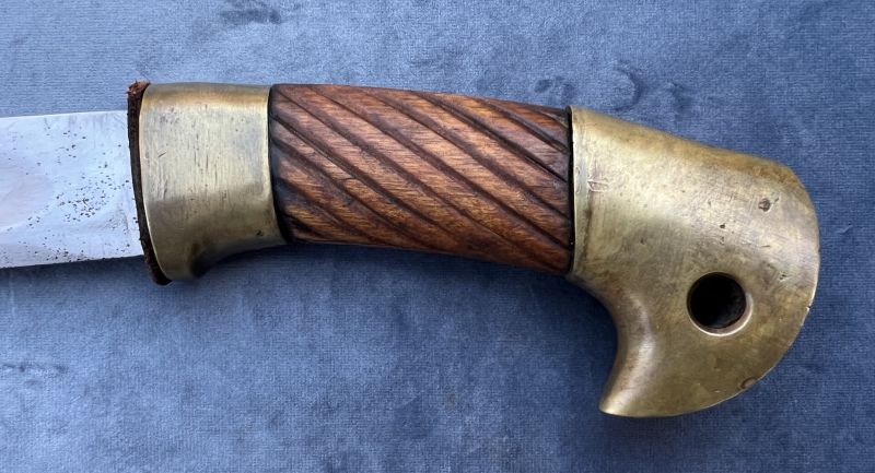

Old 29th November 2025, 11:16 AM   #8
Pertinax
Pertinax's Avatar
Join Date: Dec 2023
Location: City by the Black Sea
Posts: 351
Cavalry shashka for enlisted men and junior officers, M1927
Sincerely,
Yuri
Pertinax is offline   Reply With Quote

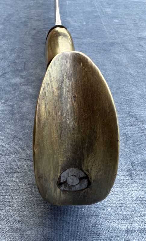

Old 30th November 2025, 12:10 PM   #9
Posts: 4,740
Thanks Pertinax. A very similar nut. Can you tell me the outer diameter of that nut and the diameter of the threaded tang?
Regards, Ian.
Old 30th November 2025, 12:56 PM   #10
Pertinax
Pertinax's Avatar
Join Date: Dec 2023
Posts: 351
Regards, Ian.
Nut - 12 mm diameter, 5-6 mm shank
Glad to help.
Yuri
