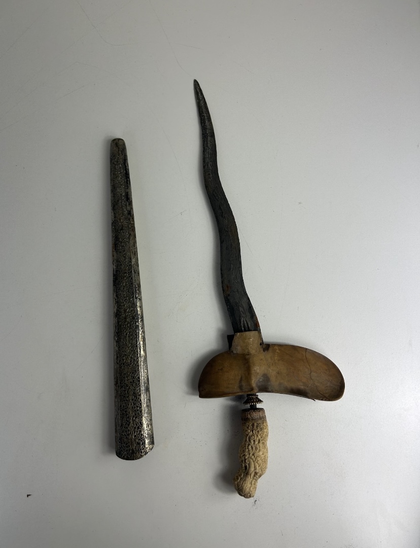

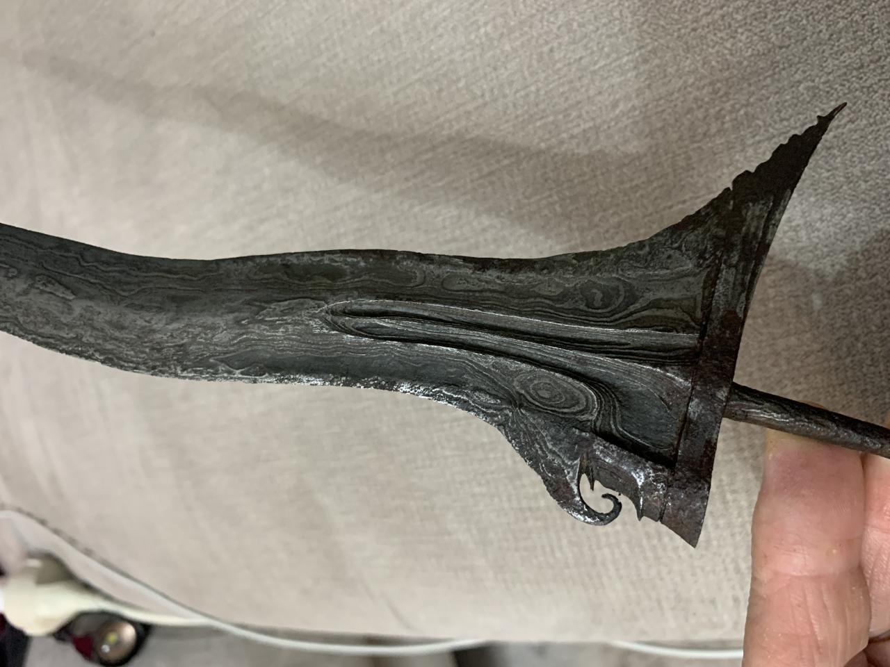

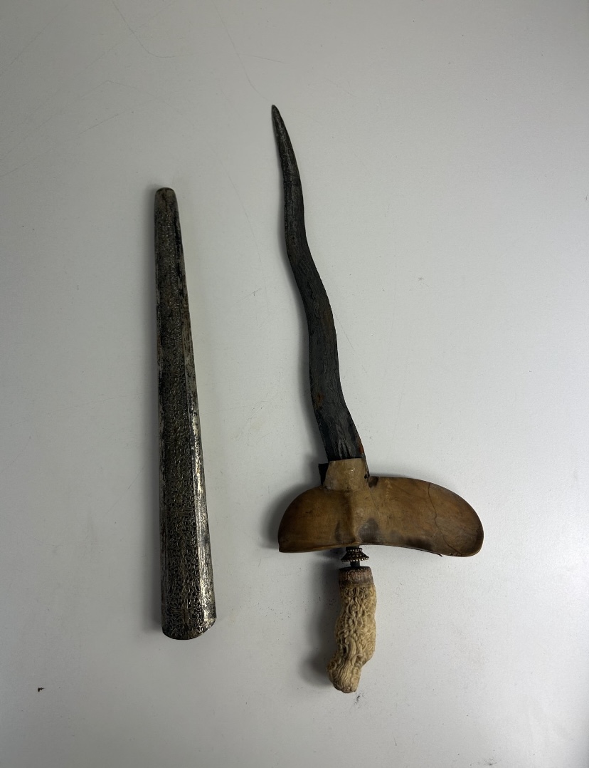

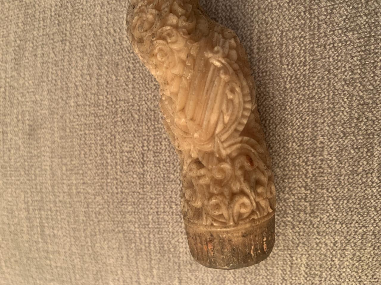

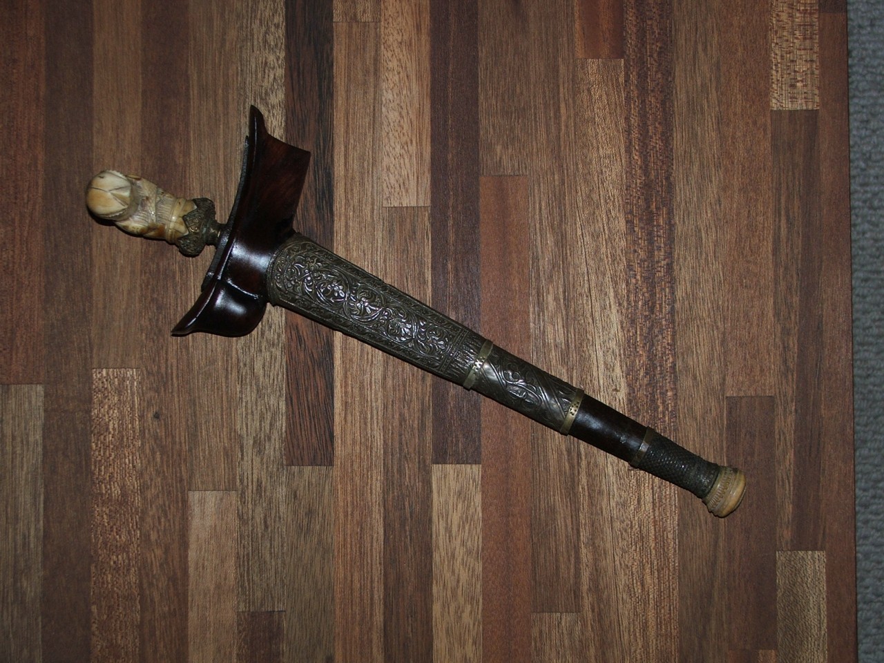

I'd much appreciate any insight into this keris; old Makassar/Ladrang type sampir, which is very narrow; I'm thinking Sumatran, possibly Mingangkabau. It didn't come with a hilt cup, so I added this one. I have not touched the blade. Many thanks

I would be grateful if anyone has views on the origin of this keris they are willing to share

Adam, this type of keris is not my area of speciality, you need somebody with knowledge in this specific field.
However, it might help if you could clarify whether you mean the entire, dressed keris, or only the blade of the keris, what we might call the "wilah".

Thanks Alan - what I want to know about this keris, to use an Australianism I hope other forumites will understand, is the whole kit and caboodle!

So --- point of geographic origin of blade, scabbard, hilt, hilt cup, and also estimate of age for all those things.
Not my field Adam, but there are people here who might care to provide an educated guess.
Just hope they read this thread.
But for now, my uneducated guess:- a keris of the Bugis people, probably 19th century, geographically maybe North Sumatera through to Peninsula.
Old 27th November 2025, 05:39 PM   #6
Posts: 7,297
I don't see much that is particularly Bugis in this keris. The dress looks Sumatran to my eyes and the blade as well, but while some Sumatran keris will indeed have a Bugis influence i am not seeing that here, beyond the pistol style hilt.

David, I have little interest in keris that are outside the core keris culture area of Jawa-Bali, however if I apply the way in which keris in these areas were classified by the people who taught me, the scabbard & hilt that I'm looking at here would be given as Bugis, the blade would be given as "diluar Jawa" outside Jawa, which is understood as "it doesn't really matter". That's Jawa keris thought, not keris collector thought.
Now, Adam has said "whole kit & caboodle", I understand that as the entire keris, ie, the keris that we see before we remove the blade from the scabbard.
So looking at this entire keris, I really cannot see anything other than a keris that falls within the spread of Bugis culture.
The blade?
Well, that is "outside Jawa".
When somebody can tell me exactly where, outside Jawa, & why from that specific place, I'll certainly listen and take note.

I also think that the keris is Sumatran but I am not sure from where exactly. South Sumatra? Minangkabau?

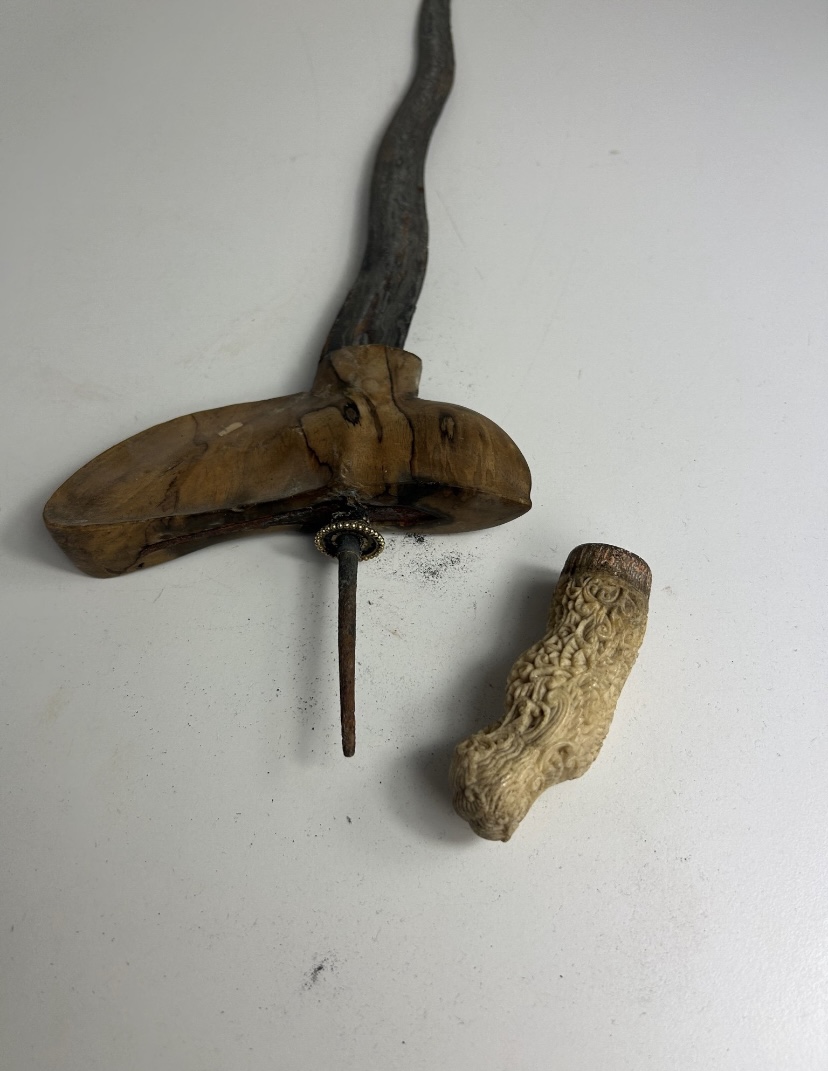

But I think or guess that "gandar" is glued wrong to the "atasan", I think the atasan needs to be turned about 180 degrees, that's the impression when I look at the pictures. But it could also be caused by the done repair that it looks a little bit weird. I am unsure.

Actually, that idea of "Bugis style" is very probably a bit off track. Monumental evidence indicates that the scabbard used in East Jawa during the Mojopahit era was the same form that we now call a "Bugis" scabbard. The keris began its spread through SE Asia during Mojo times, due to trade links, & and as a "weapon" of diplomacy --- the binding force of the keris.
This early Javanese form was adopted by the Bugis people, so really, we are looking at an early Javanese scabbard form.
As I commented in my original guess:- " --- geographically maybe North Sumatera through to Peninsula".
So I'm not at all arguing against Sumatra, I'm saying that I am unable to rationally support any specific geographic location, I'm saying --- very clearly --- that I'm guessing.
I do know some very experienced keris people who would place that scabbard as Riau.
I know other equally experienced keris people who would place the hilt as South Sulawesi & give it the correct name used in that area.
The hilt cup I think is most likely Peninsula, & that's a genuine guess.
The blade certainly appears to be outside Jawa, but it could possibly be from one of the areas not under direct kraton influence, however, I'm still inclined to go with what I believe would be the opinion of my teachers:- "diluarJawa" & thus not even worthy of consideration --- in fairness, these teachers were very Jawa-centric, maybe I should say Solo-centric.
If I had it in hand I might be able to construct a supportable opinion, from a photo I cannot:- a photo simply cannot give sufficient information upon which to give a defensible opinion.
A guess is a guess, and an opinion in the absence of supporting evidence is pretty much the same as a guess.
Detlef, yeah, I agree, that repair looks pretty clumsy, maybe the blade is not original to the scabbard & this strange angle was forced upon it. Maybe.
Post #5
I think I should tighten up my relaxed comment here, & write what I really mean. Forget "--- maybe North Sumatera ---" & substitute "--- maybe along the North Coast of Sumatera & including adjacent islands ---". It is still a guess.

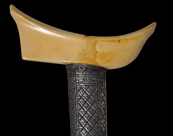

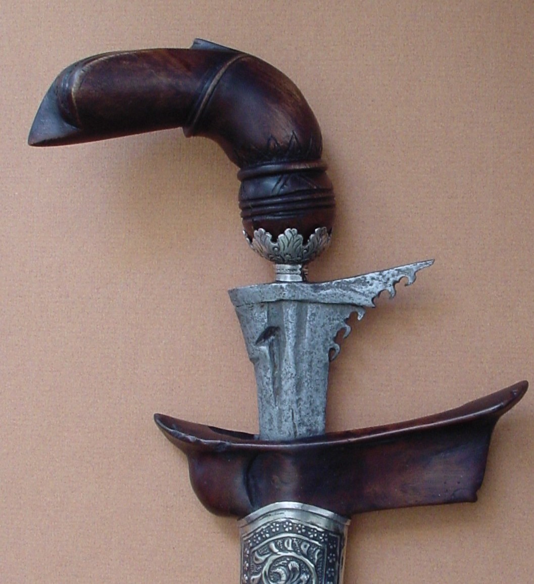

It's width is much thinner and it seems to have a form that puts me in mind of Minangkabau keris. Likewise the hiltcup. See the example below.
That said, i am much like you in this regard in that the majority of my focus in keris has been placed upon Jawa, Bali and to some extent Madura, so i really am operating more on feelings than solid fact here. But i would not be surprised to find that is South Sumatran, possibly Minang. I also suspect that the gandar is not simple a bad repair, but not at all the original sheath stem, which may have offered more clues to it's origin if it had been intact.
Agree with you David, I also would place it as South Sumatra or Minang. And a very good suggestion that the gandar might not be the original one, the weird joint and the overall appearance of the scabbard I am uncomfortable with. The gandar looks Malay IMVHO.

So, if I look at this keris as a complete entity comprised of scabbard, hilt, hilt cup, blade, then what I see is a keris of the Bugis people, a cultural classification, not a geographic classification.
Once we put any blade at all into the dress items that are identifiable as belonging to a particular culture, society, or region, then we refer to that keris according to what we can see, we do not recognise the identity of the blade until it has been removed and independently addressed.
In my post #9 I did independently address the blade:-
“The blade certainly appears to be outside Jawa, but it could possibly be from one of the areas not under direct kraton influence, however, I'm still inclined to go with what I believe would be the opinion of my teachers:- "diluarJawa" & thus not even worthy of consideration---”
the opinion of my teachers, not of myself.
In recent years there have been several books published on Bugis keris, but it seems to me that if these books represent the sum total of knowledge on geographic origin of blades dressed as Bugis keris, & regarded as Bugis keris, by Bugis people, then there is quite a way to go before we can confidently name the geographic point of origin of the blade used in a Bugis keris when we consider the entirety of a Bugis keris.
There are good, solid reasons that with Javanese keris we have a very deep well of knowledge & belief, and for other keris bearing societies we have a well of knowledge that is in many cases dry, or almost so.
I do not wish to address this problem.
To summarise:- in my opinion, this keris in its entirety is a keris of the Bugis people, I am not able to defend an opinion that might place the geographic origin of the blade of this complete keris in any specific geographic location. Further, based upon my own field research & my own experience, I am not prepared to name with confidence the geographic locations that contributed the parts other than the blade to this keris as a complete entity. Any opinion I might express in respect of this keris is based upon the opinions of other people.
To compress this into a few words:- I do not know.

Of course, with the above view images it is clear to me that this sheath has not been made for this blade, nor has there been any real attempt to properly fit it, so it is very possible that all these parts have completely different origins and that it can't really be said that it is of ANY particular people. Could it be a dealer special? Who knows? We can probably leave it at that.

That said, we do have a keris that obviously has been placed in a sheath that was not made for it, nor that anyone bothered to properly refit. That sheath seems very likely to have a gandar that is not original to the sheath. And not knowing enough about it, to my eyes the hilt seems oversized and out of proportion to the ensemble as a whole. So what i see is a keris that was very possible assembled from parts from numerous origins. I do, however, welcome being proved wrong on that if somebody can show a single origin for this ensemble as a whole.

Yeah, sure it is possible that it is a dealer's or collectors montage, but this can happen in an indigenous society as well. In Bali it is not at all uncommon to see Javanese blades in Bali dress, & a lot of Bali pusaka keris are in fact Jawa keris in Bali dress. In Jawa we find both Bugis & Bali blades in Jawa dress.
I remember a keris that I once saw that had excellent provenance, it had been acquired many years previously on the North Coast of Sumatera & each and every part of that keris was from a different geographic location.
The scabbard fitted neatly to the blade that collectors like to see is in my experience not particularly usual outside of areas where the keris is a required part of formal dress. Even in those areas, somebody who wants to redress his keris might not be able to afford the services of a m'ranggi, so he buys a new ready made wrongko in the market and fits it himself, not everybody is all that skilled at this.

Thanks all for your insight. Yes the gandar fits awkwardly to the sampir; it probably is a replacement but apparently an old one
