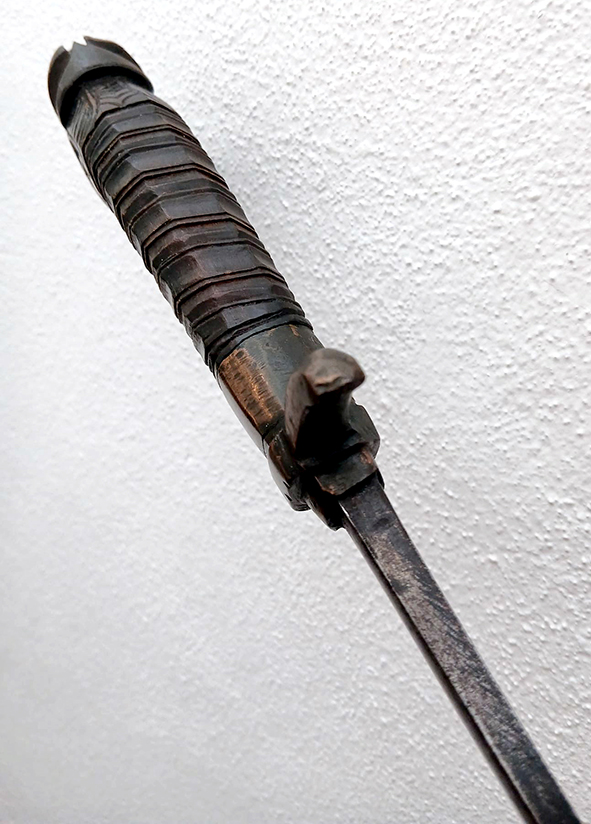

For my first post, I'd like to share a piece from our private collection that I think is quite interesting, and I hope it will spark a fruitful discussion.
We think it's a Talunasan...
Measurements:

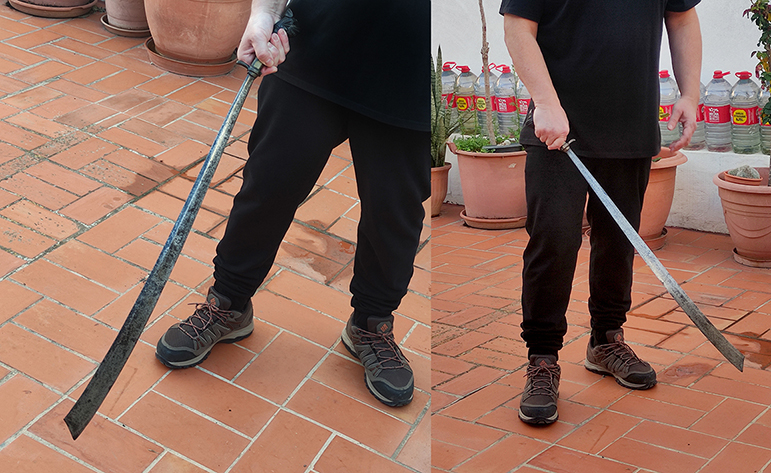

Overall length: 91 cm.
Blade length: 71 cm with an asymmetrical rhomboidal cross-section.
Width near the handle: 1.6 cm; maximum width: 4 cm.
Thickness near the handle: 0.8 cm.
Balance point: 25 cm from the guard.
Weight: 0.906 kg.
The handle with a so beautiful patina, is made by horn, with a brass guard-ferrule.
From an old Spanish collection.
It was sold alongside Kampilans, Barongs, Krisses, negrito, high-status axes, and bolos… All from the Philippine archipelago and dating from the 18th- 19th centuries.
Please enjoy the photos.
Thank you.

Hello Gus!

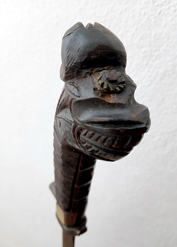

Welcome to the Ethno Forum. What an interesting sword you have posted! There has been increased interest in recent years with the long-bladed, square-ended, Ilocano/Kapangan sword called talunasan. Your sword certainly bears a resemblance to those uncommon long swords described with this name.

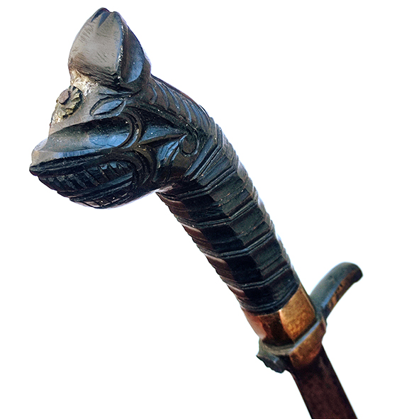

However, the hilt on yours is not associated with northern/central Luzon weapons. I would describe the pommel on your example as being in the genre of an "aso motif," resembling a dog or bat. Such hilts are usually associated with Bicol or Batangas, or even into the Visayas.
I notice that one half of the guard on your sword seems to be missing/broken off. Is that the case? It leaves me wondering if this sword may have had a D-guard at one time, and the knuckle bow was broken or removed for some reason. The presence of a knuckle bow could again suggest a Bicolano origin (such as seen on minisbad).
I look forward to Raymundo's (xasterix) comments on your sword.
Regards, Ian

Please, find kindly attached a photo of the area where the lower part of the guard is missing. Is full of patina so I guess has been missing for long time.

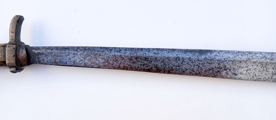

Adding some photos of the blade.
Thanks,
Gus

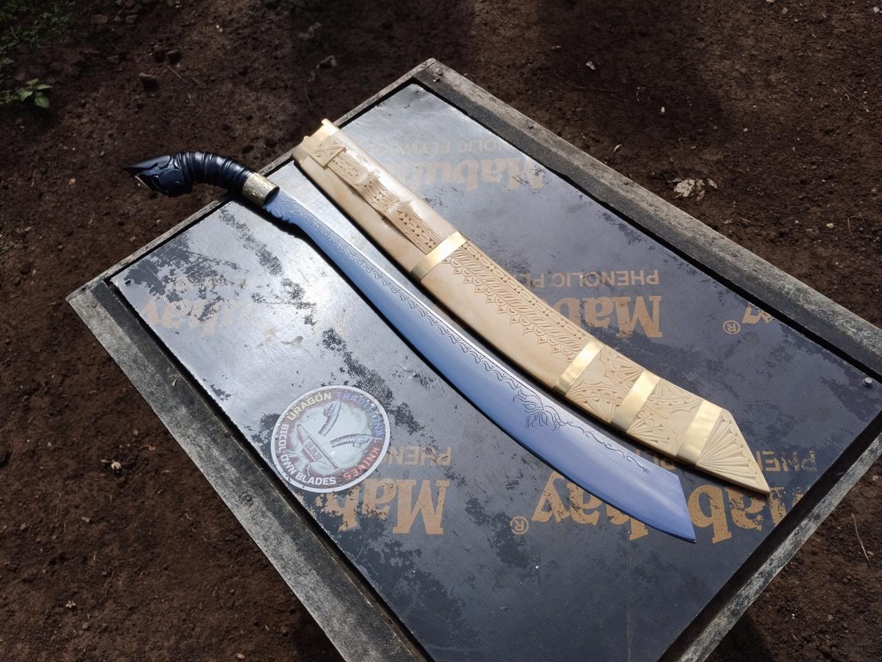

Hello Gustavo, well met here in the forums, hope all is well in Spain =) thanks for the redirect Ian.
That's a great sample you got there- it's still classified as a Minasbad from Bicol; the Bicol people call that "Minasbad putol." "Putol" means broken, signifying the aesthetic state of the blade's tip. They still make that blade profile nowadays. The unique thing about your piece- it seems the lower handguard is also broken, which makes it twice-broken, so to speak- a really nice piece, especially for its length!
I'm also attaching a pic sample of a piece made just this year.
Hope that info helps
