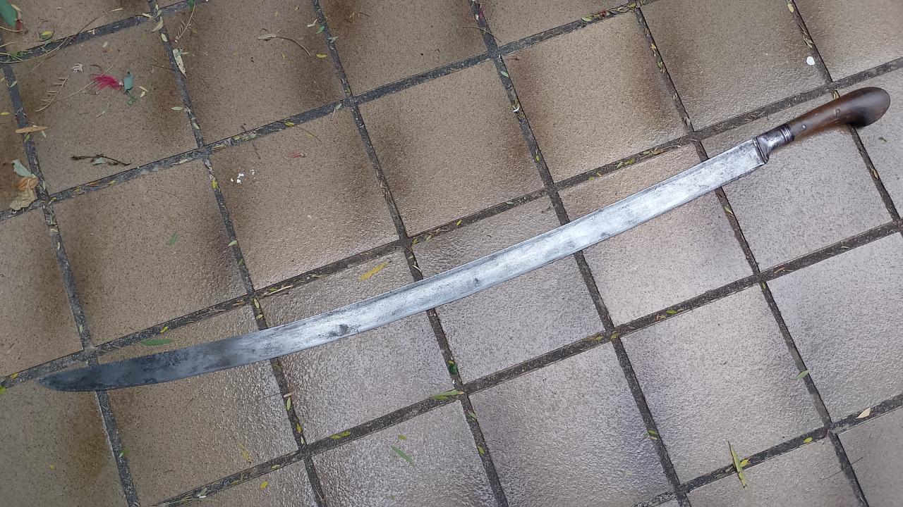

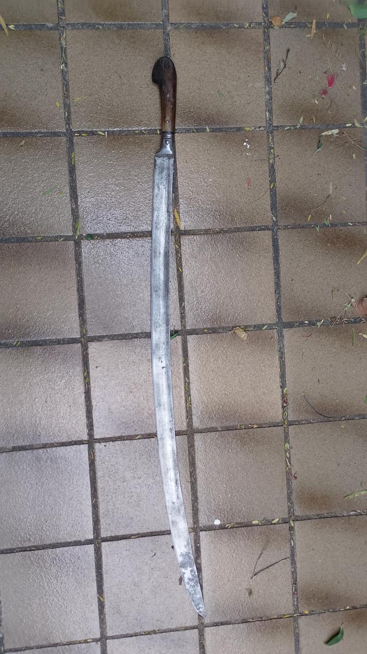

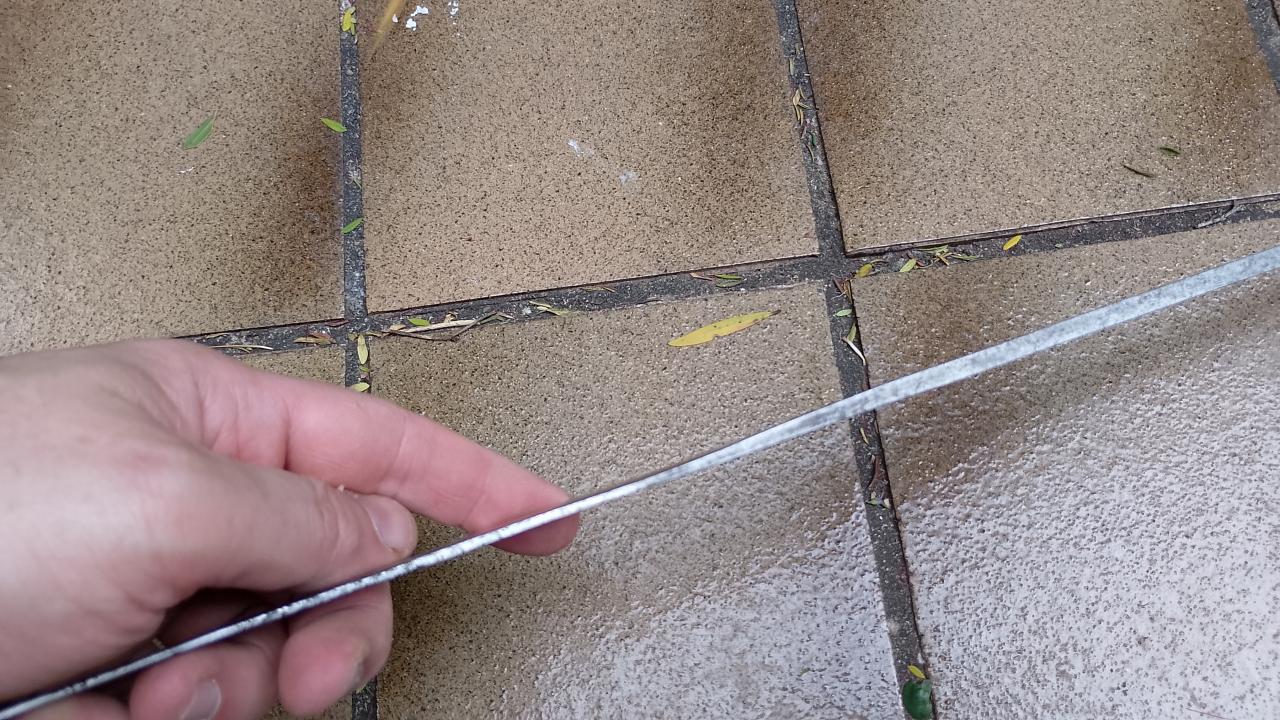

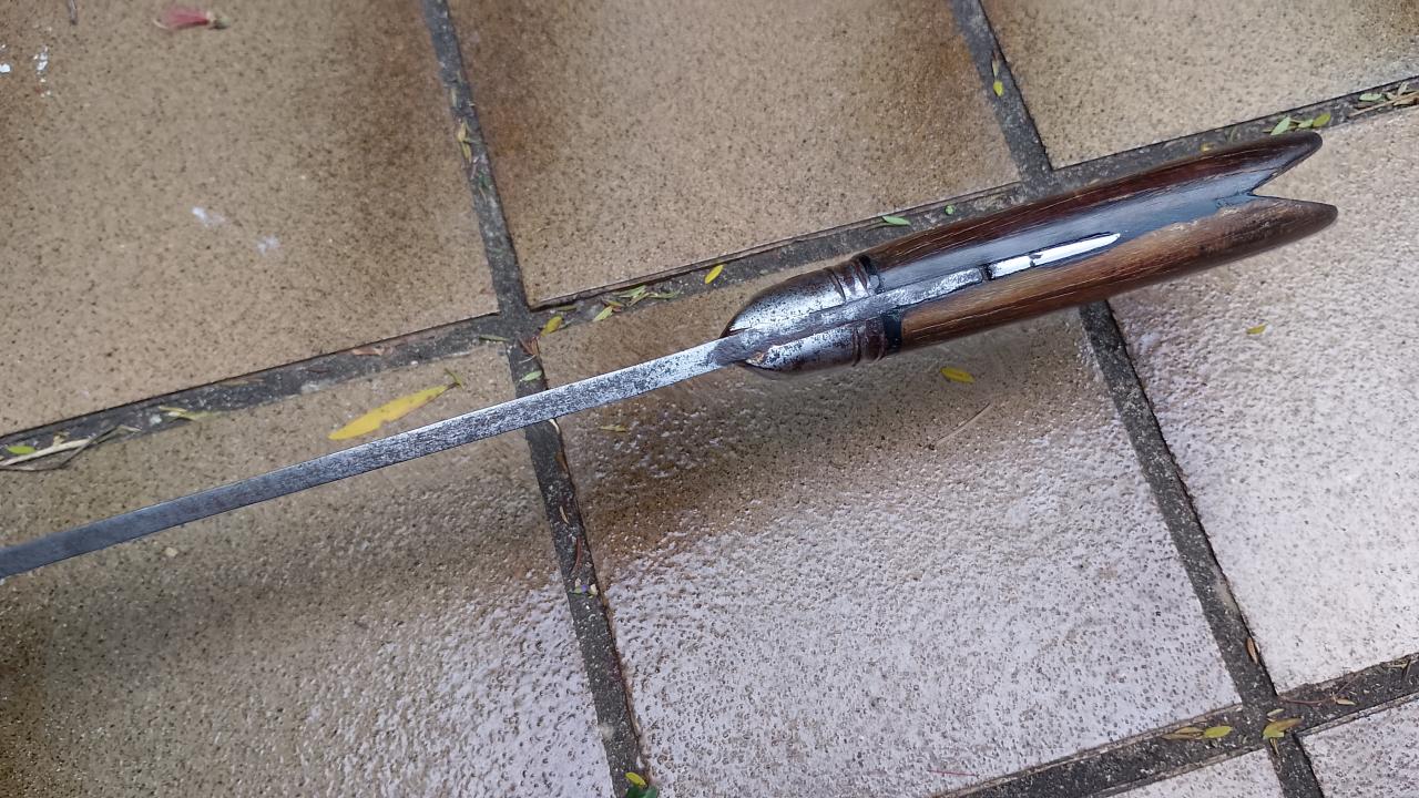

Here is a typical example of a central Asian "shashka".

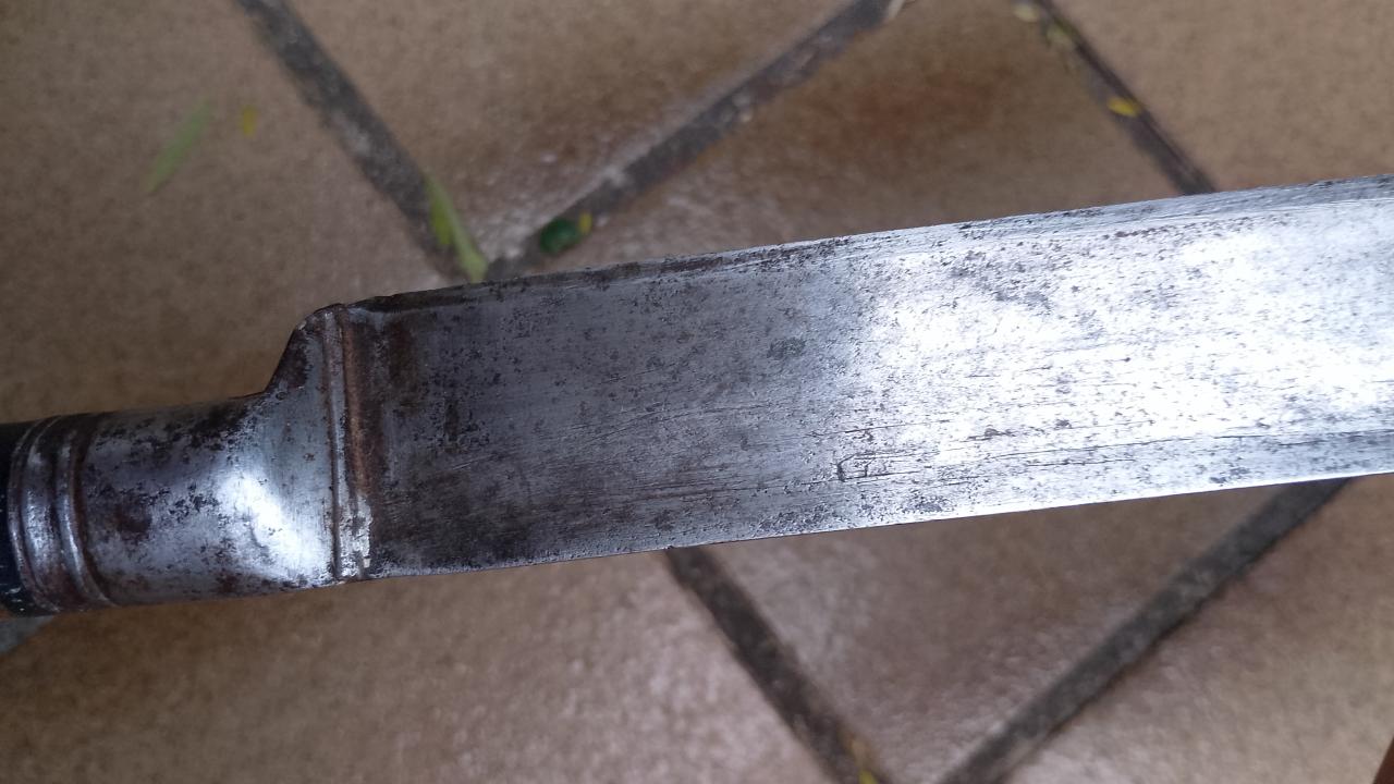

The blade has a slight T section and almost no taper till the foible where it tapers abruptly.
The blade gets thinner and less robust along its profile but the T section thickness is almost the same as at the ricasso till the foible

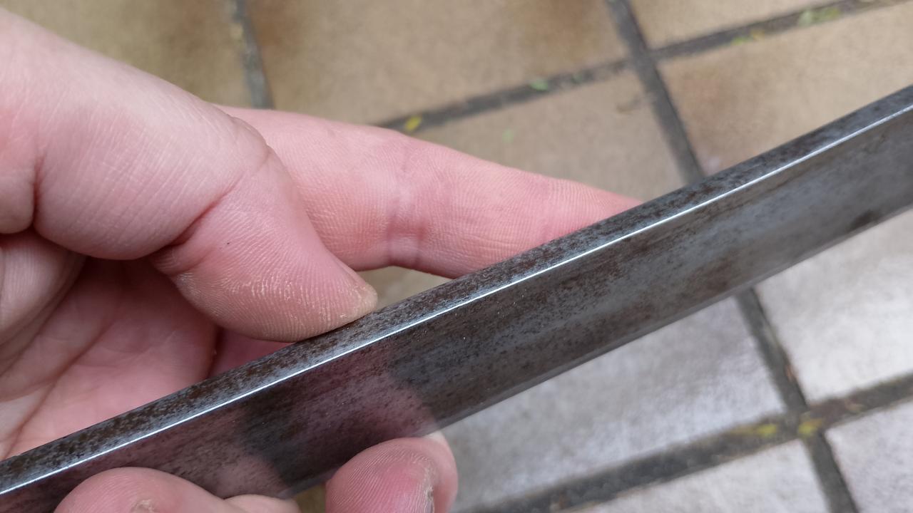

Sharpened all the way to the hilt (many Afghan ones are sharpening 4-7cms up the blade like indian swords)
It's missing it's scabbard.
It's not to fancy so I've used it to cut with. It has a bevel like a peshkabz.

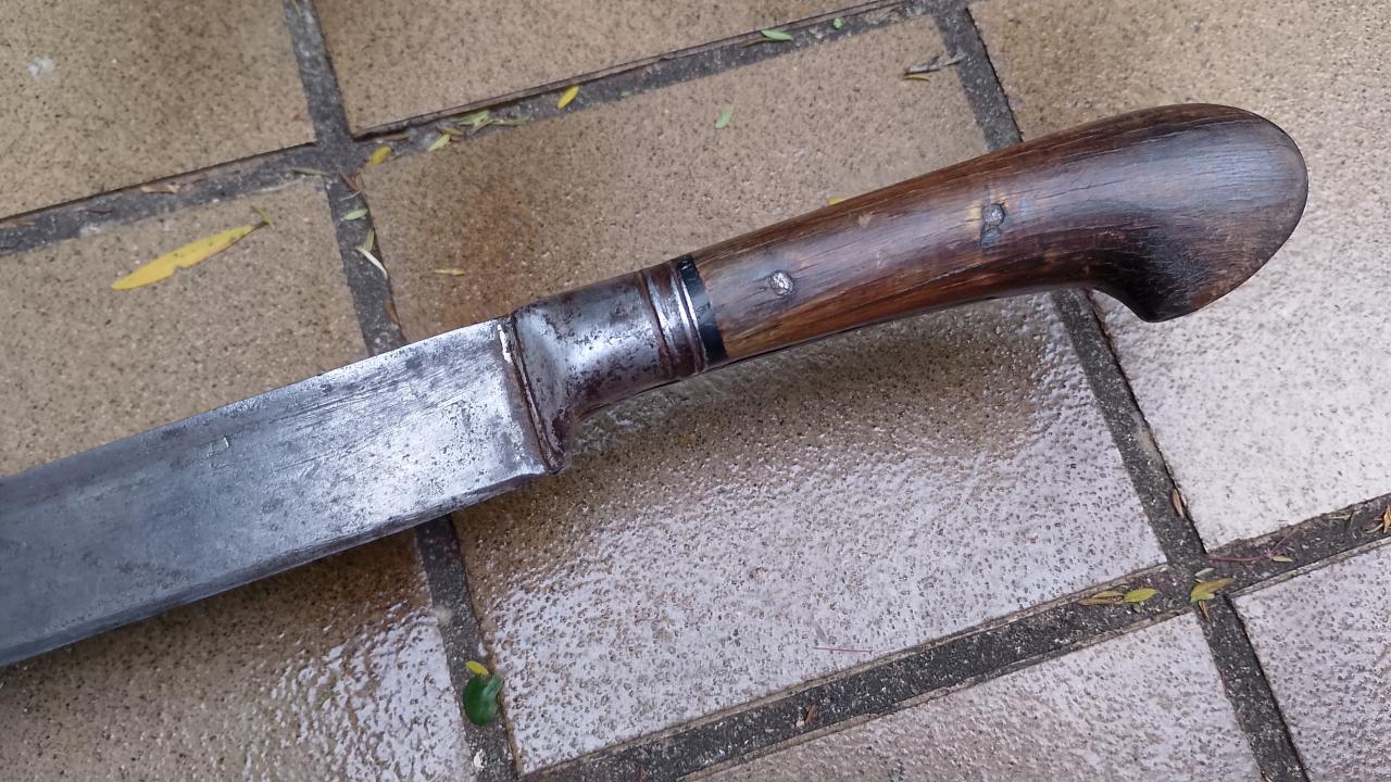

I have to say compared to the traditional caucasian shashkas this style with the bag shaped grip that is common in central Asia is a vastly inferior weapon in handling and speed, cutting power even though on average the blade is heavier and longer.
I could cut substantially faster with a caucasian shashkas and much harder and with far more control.
The two arms are not comparable but at a glance look the same.

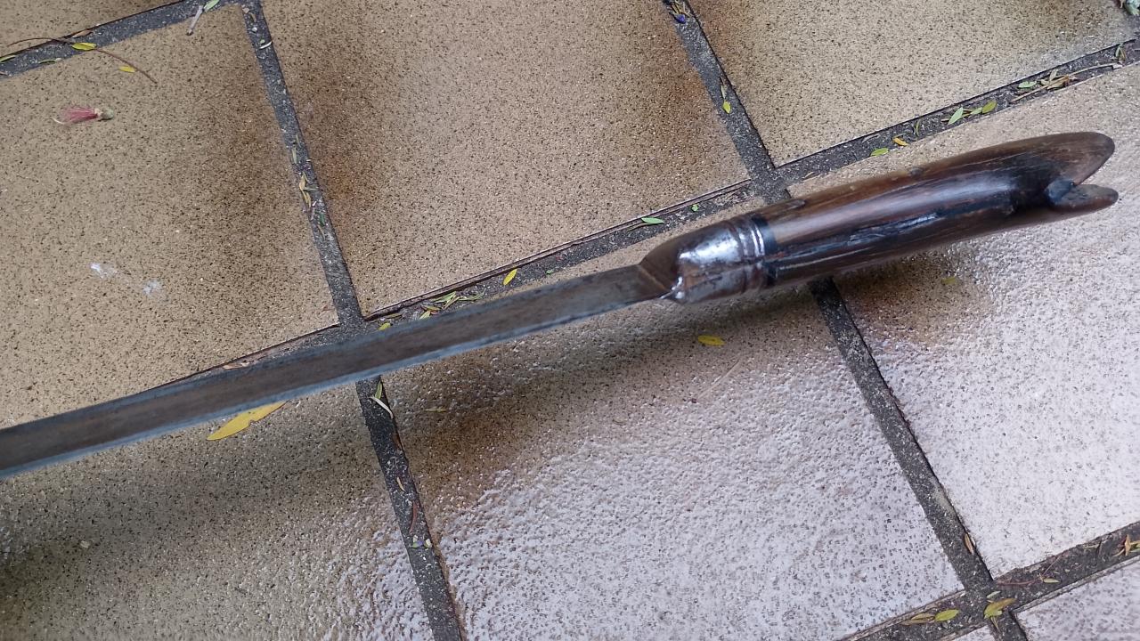

The central Asian/Afghan shashka style with a wider handle with 5 or 7 pins and without wars. Identical in handle to some peshkabz handles better but it's generally a heavy blades slow choppy weapon.
