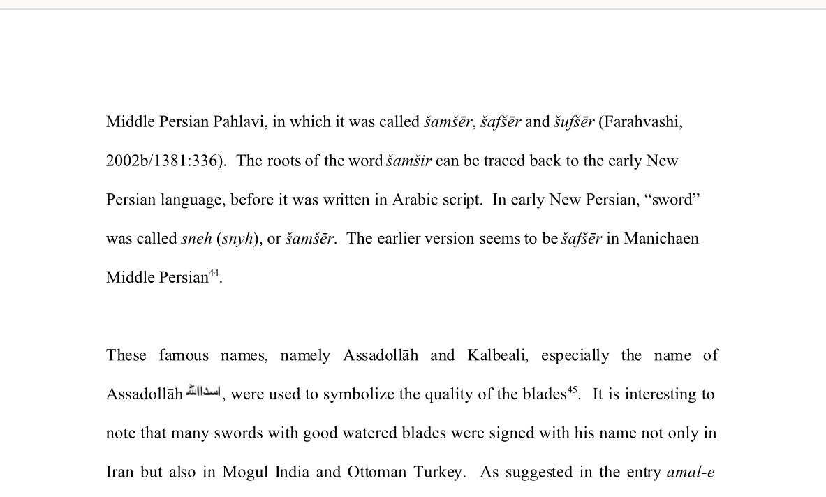

I was intrigued by this exerpt which stated asadollah signatures were found on ottoman blades, not just on Persian blades. Is this true?

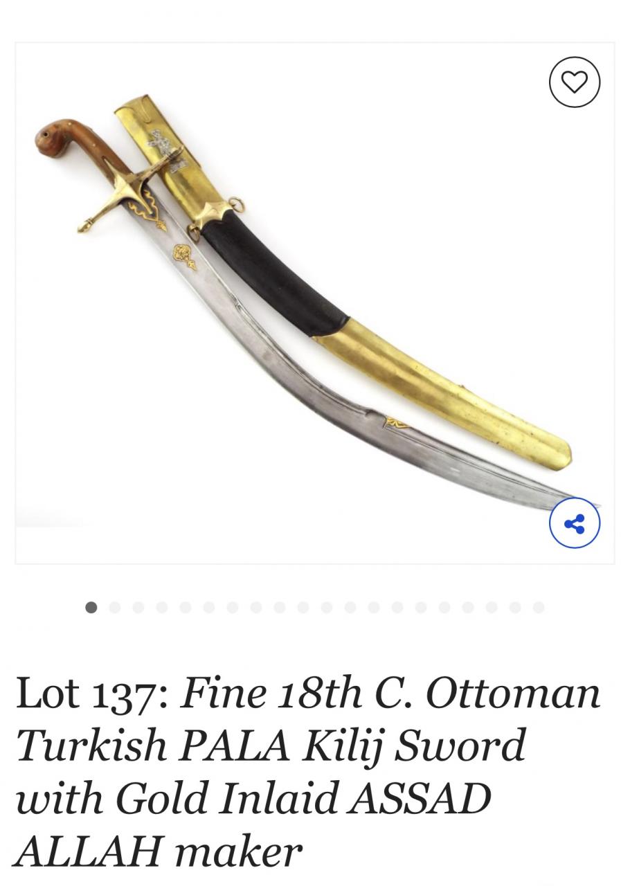

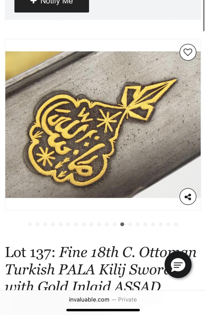

Sorry I should have specified, I know actual persian blades were used by ottomans, but I was specifically wondering if ottomans for example forged their own blades and imitated the asadullah mark on them- this is a purported example from an old auction, but I cannot read the cartouche to confirm

Oliver Pinchot
Join Date: Sep 2012
Posts: 471
In the case of this sword, the question is moot.
The inscription reads Mash'Allah, meaning God has willed it,
rather than Assad Allah.
