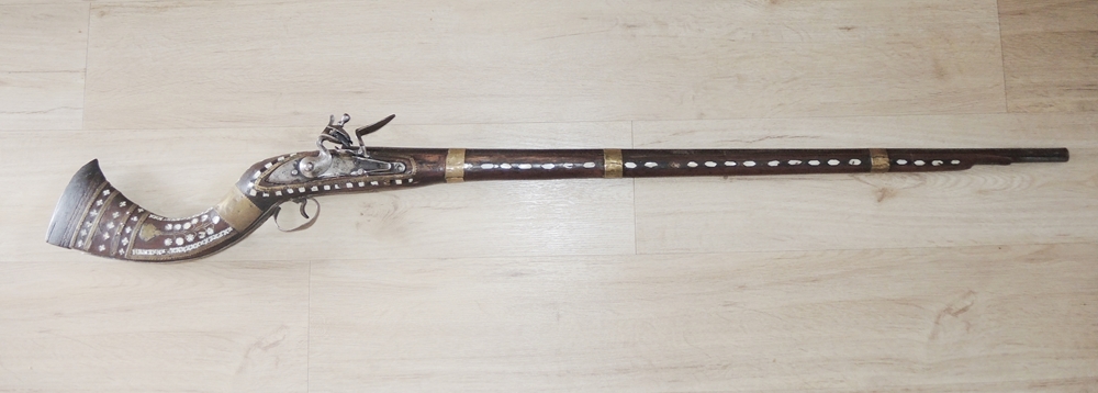

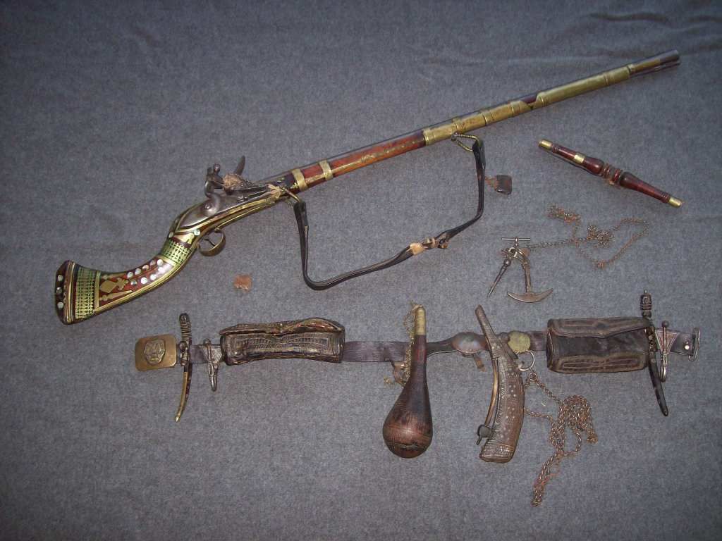

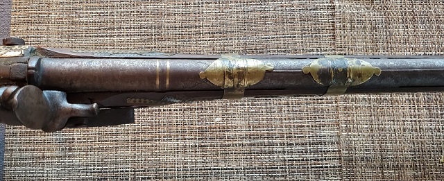

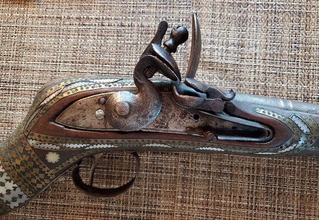

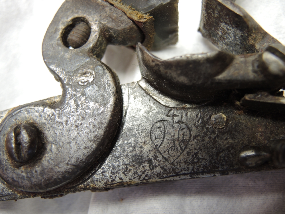

I somehow came across this jezail, in Albuquerque of all places, and have always wanted one after all the years of reading about them here, so I got it.
While it clearly is in the 'tourist' category, and most probably came from the Kuch-e-Morgha (Chicken Street) in Kabul, I would like to think that perhaps it came there from the Khyber regions, and was genuinely fashioned for a Pathan tribesman some time ago.
After reviewing as many images as possible of EIC gun locks, I feel that this is quite possibly a genuine lock from probably a Windus pattern Brown Bess that was acquired in the First Anglo-Afghan war in 1839.
The use of the rampant lion on the lock seems to have begun around 1808, with the date on the tail of the lock.
Both these and the quartered heart with initials of EIC seem to have abound in these Afghan regions ever since, and while they were widely copied, this seems close enough to be authentic.
The gun itself highly embellished in style that was used often authentically by tribesmen, was also of course widely produced as souvenirs, often using authentic locks as refurbished from worn old guns.
The pics are of the one I acquired, said to be .58 cal. smoothbore.

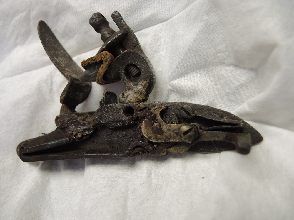

The red backed lock image is of an known authentic example as comparison.

Jim, the barrel on your new acquisition looks promising and could well be dating back to the 19th century. We will wait for you to receive the gun and take better pictures. I cannot comment on the rest.

Thank you Teodor, I have the gun, I found it in a shop here in Albuquerque. Here is another pic of the barrel. I never realized how long and heavy these things are.

These guns are so - too - many on the market and as you said most of them are decorative.
Then even in the original and functionnal ones, you have some of them made with good and old original pieces English and Persian, then the others locally made but functionnal.
I have some serious doubt about your lock... Of course Rick will tell you everything about your gun.

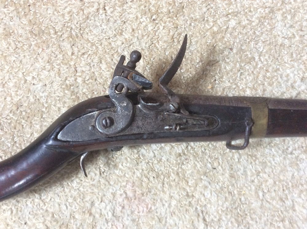

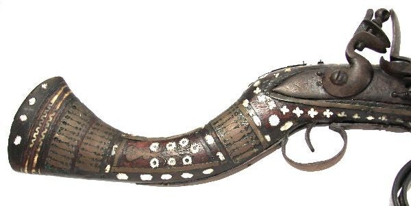

I have a similar Jezail which, though probably functional in terms of shooting, appears as if it could be, though not definitely, made for tourists, as it is also (like yours), prolificly decorated with MOP.
Pics of a couple of my Jezails.

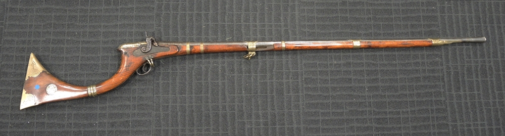

Not to digress from the Jezail, there is another gun of similar shape which is also attributed to Afghanistan, though it's origins are more Sindhi/Baluchistan. It must be remembered that when we today discuss Afghani guns, that the borders have been many times redrawn since colonial days, and what was once part of Afghanistan is now part of Pakistan.
A couple of pics of these guns attached also.

Whether or not your lock is original EIC is difficult to say from the photo's. The main components look as if they could be; but if so it has definitely suffered some local tinkering in that all the screws would appear to be replacements.

Thank you Kubur, Stu and Richard! I really appreciate this input as I know you guys are well seasoned in the collecting and study of these.
I have had doubts about the lock as well, but in comparing it to some of the examples known authentic it is remarkably well done if indeed a copy. As far as I have known the Afghan copies have never been that faithfully copied, only rendered interpretations. All of the screw positions etc. seem to line up, and the 'work' in adding this lock appears to use similar technique and even hardware to other Afghan components. While the profiled outlining on the perimeters of the lock seem slightly crude in joins, it seems most Afghan examples dont even bother with this detail.
These are just my estimations based on research to get up to speed as I cannot claim any great experience or knowledge on these.
Thank you for the historic and geographic insights as well Stu, and important to note how in flux these boundaries have been.
Stu,thank you for the great examples you posted! Those are beauties, and these guns are incredibly attractive. I take it the Sind examples have a long slender neck (or wrist?) on the stock.

Can anyone share more on the locks on these with closeups and insights on them so as to put together a bit of identification compendium?

Of course, first i think your lock is an Afghan copy decorative or not i don't know.

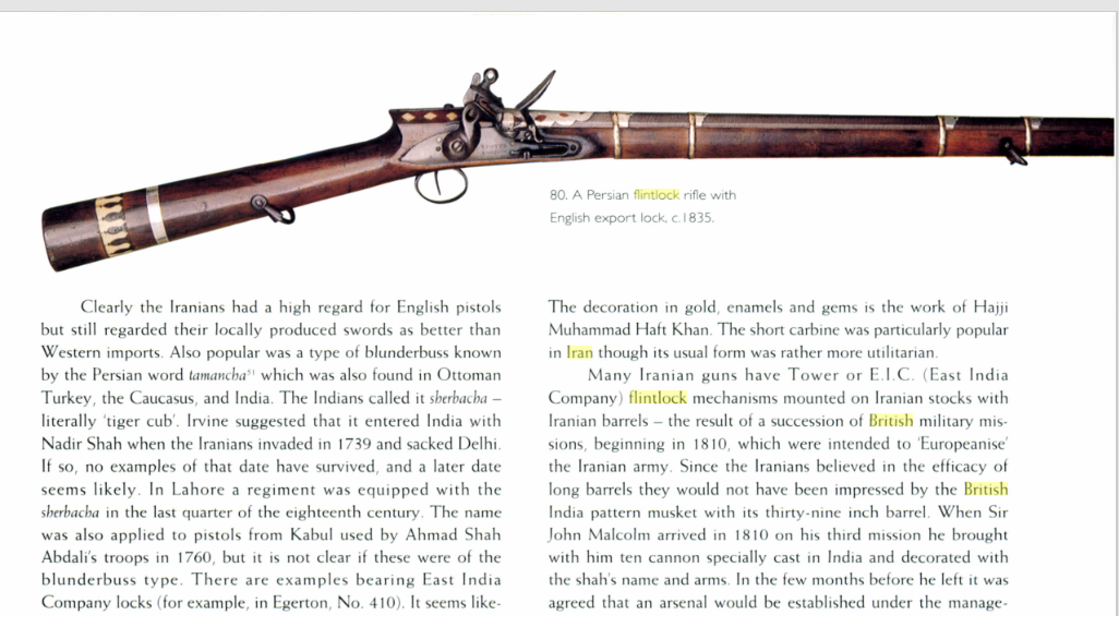

Second i think Elgood mentionned somewhere that British had a factory in Persia and then many locks are English made in Iran...
It would explain the quantities found in Afganistan.

Thank you Kubur! and I am inclined to agree, my example does appear to be an Afghan copy, it is not nearly as well executed as the example in the photo (with red background) which is deemed an authentic British lock.
I very much appreciate you sharing this page from Elgood, which I do not have with me presently.
Interesting that the British had manufacturing involvement in Iran, just as they did in Afghanistan with the Machin Khana in Kabul. At the Kabul factory though they did not produce spuriously marked locks etc and the factory had their own use of the Afghan royal stamp.
The spuriously marked locks seem to have come from the independent tribal artisans in Khyber locations such as Darra Khel and others.

Here is the full section relating to EIC guns made in Tabriz.(From Firearms of the Islamic World in the Tareq Museum Kuwait by Elgood).
I seem to remember reading somewhere that Tabriz was not the only place in Persia where these guns were made, but can not remember where I read it.

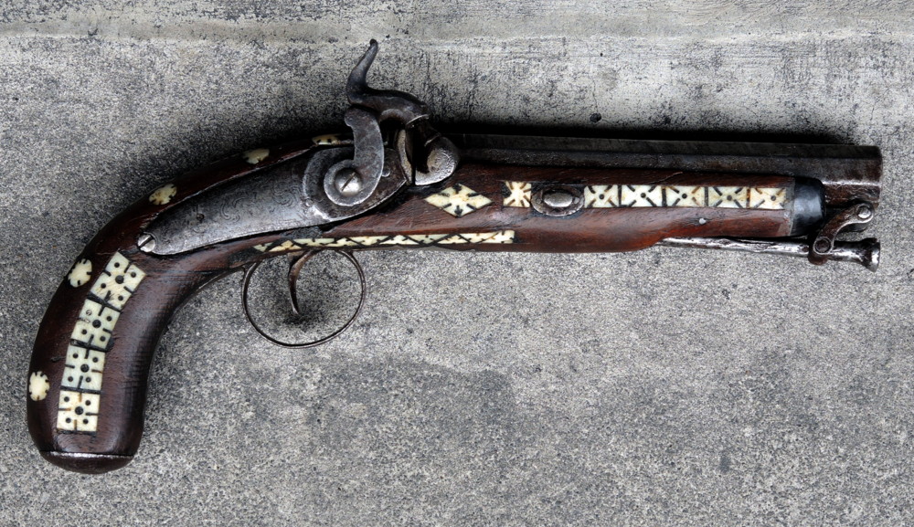

Also an Afghan pistol which is locally made. I do not wish to detract or confuse the current theme of this thread, so it is only posted for interest only and not for comment.

Here are pics of the lock of the second jezail shown in my pics. This gun has no trigger guard (as made) and the lock bears the heart shaped bale mark of the EIC, but not the rampant lion. I would class this lock as "genuine" as the lock parts are fixed with screws rather than peened. When I get a moment I will post pics of the other locks.

Originally Posted by Victrix
Interesting rifle Jim! These Jezails are quite exotic and were produced all over I think. And many parts were likely replaced during their lifetime.
I found this article useful when researching my jezail: http://www.armscollectors.com/darra/afghanold.htm
Thank you so much for the kind note !!!
These truly are exotic and attractive, and it does seem they were often reworked and had very long working lives. I honestly wish I could display it, but the bookmobile has little space for such mounting.
The link you have added is an absolutely fascinating and wonderful article which goes exactly in the direction I have hoped to lead this thread.....perfect addition
I have made many notes over the years on East India Co. gunlocks, mostly from research on the bale marks of the Company, and had some interesting communication with David Harding back when he was completing his volumes "Small Arms of the East India Company 1600-1856" (1999).
I sure wish I would have gotten a copy then (three volumes at first, another later).
It seems there have been other articles which show how to recognize Afghan copies from originals, but still searching.
Old 10th August 2019, 12:46 PM   #27
Posts: 10,718
Originally Posted by kahnjar1

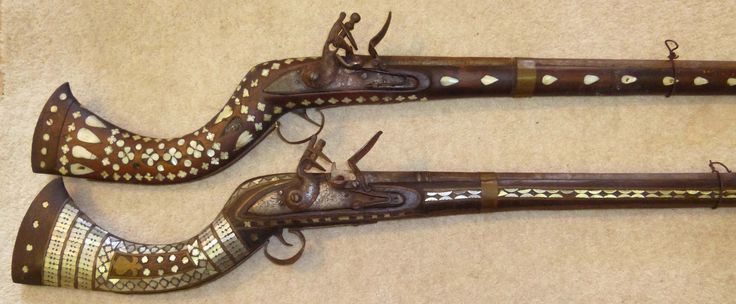

Hi Jim,
Stu
Excellent Stu!!! That is exactly what I am trying to gather here, close ups and detail on these locks.
It seems the rampant lion came in around 1808 with the EIC but as always exact dates are unclear.
The EIC heart seen in your example here has rather than the quartered heart, what is known as the 'flaunched' heart, which has curved lines rather than quarters.
I had always thought that the VEIC stood for Venerable East India Co.
but I learned from David Harding that it was actually United East India Company (or to that effect as the 'U' was seen as a 'V' in those days).
It is amazing to me, and pretty exciting, that the Afghans so thoroughly copied these British markings from the many Brown Bess they obtained during the long years of campaigns in these rugged and vast regions.
Thanks very much for the great examples you are adding here.
Also again for the notes on the Sindhi (Baluch) versions of these guns.
It is my impression that it is hard to accurately define these as from Sind or Baluchistan as not only are these areas unclearly defined geographically, but the tribal diffusions are complicated. Simply more that makes the study of the arms of these regions so fascinating.

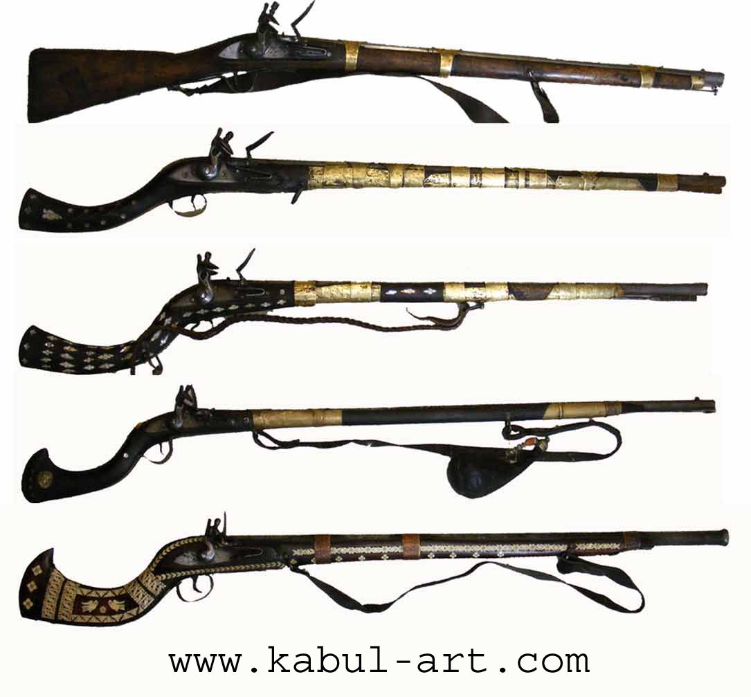

Victrix
Victrix's Avatar
Join Date: Apr 2017
Posts: 765

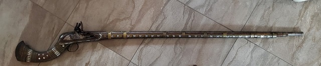

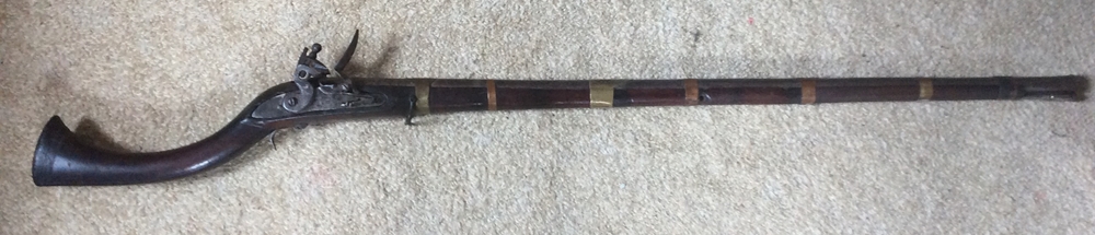

Glad you liked the article Jim. The last rifle I thought looked rather similar to yours. The EIC flintlocks have a charm of their own I must admit.
Here is another photo of some Afghan tribesmen.
