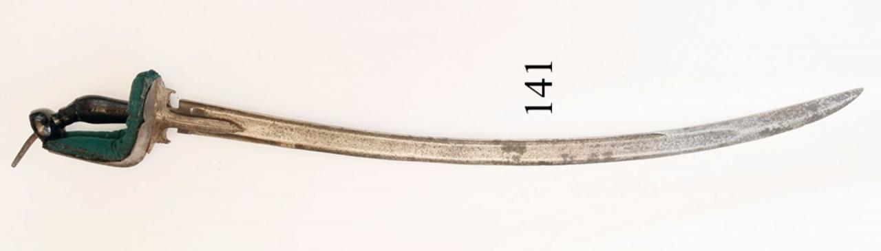

It's interesting to note that the khanda sword was adopted in the North of Sumatra and there it was called peudeung, just won by a German auction such a sword, mislabeled as "Khanda from India".
Old 10th April 2025, 11:37 AM   #7
werecow
werecow's Avatar
Join Date: Sep 2021
Location: Leiden, NL
Posts: 679
There's one in the World Museum here in Leiden that is similarly misidentified. I attempted to correct this years ago but it remains in the little Mughal arms exhibit to this day.
