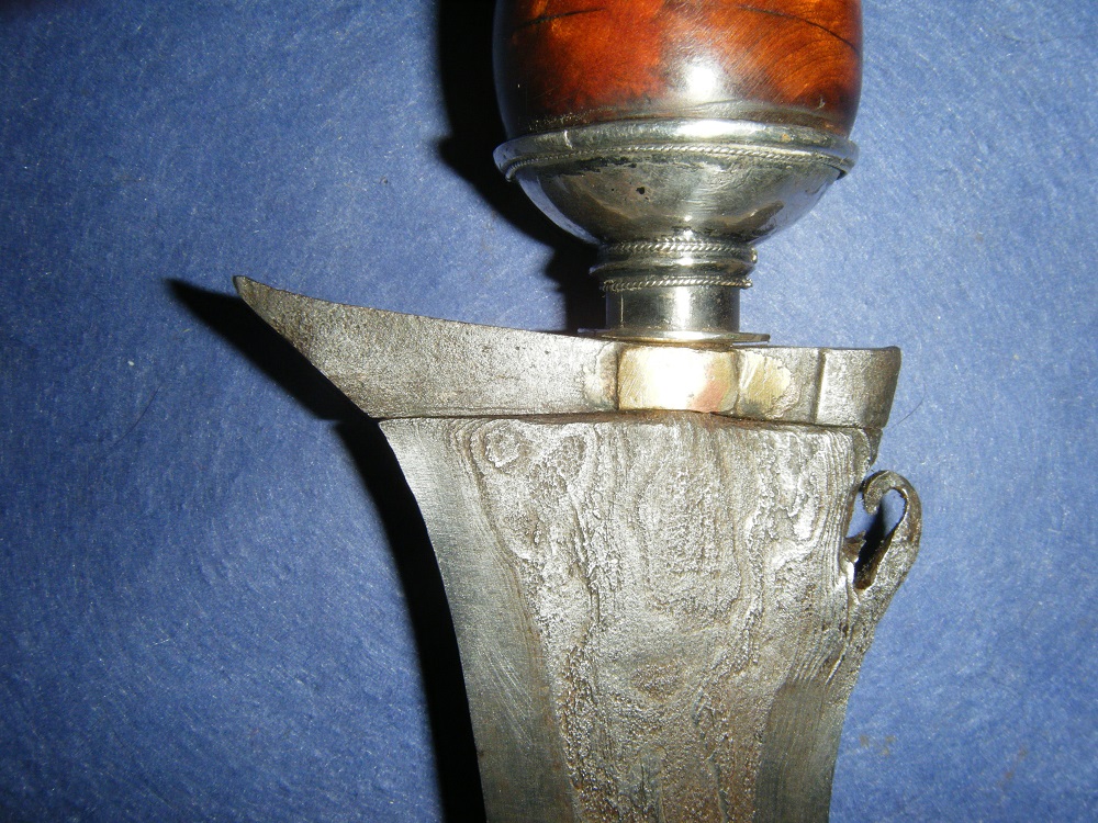

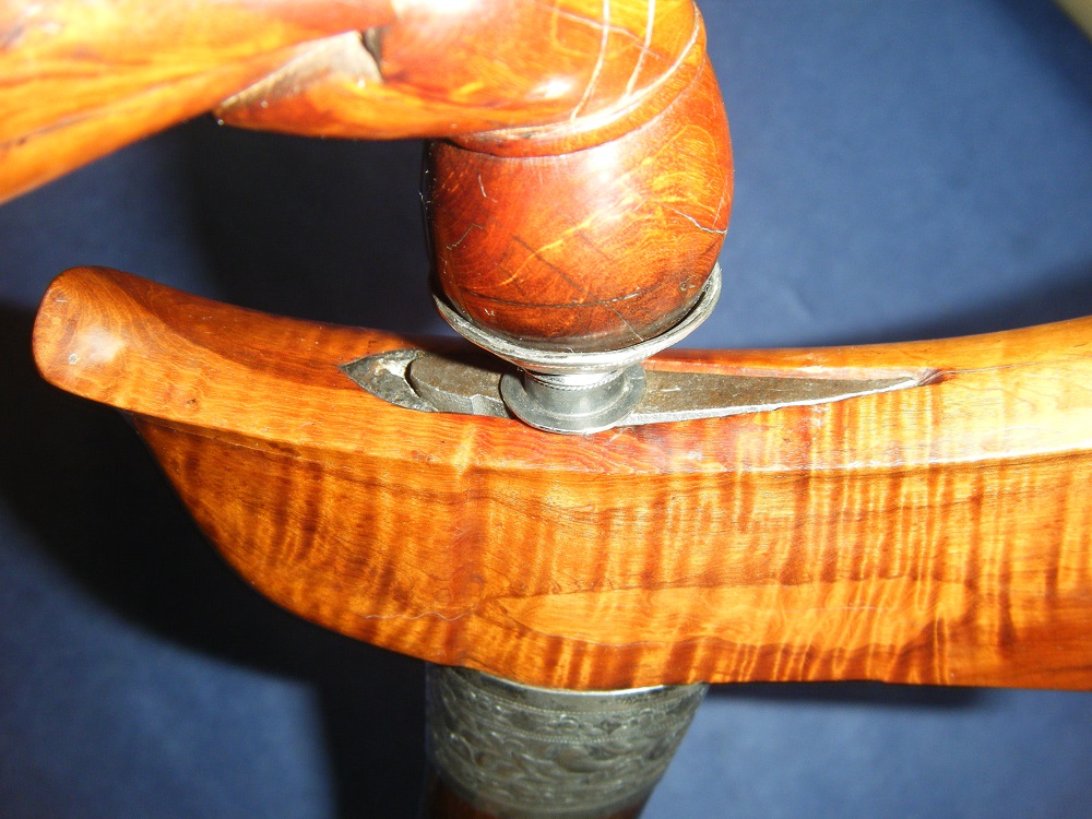

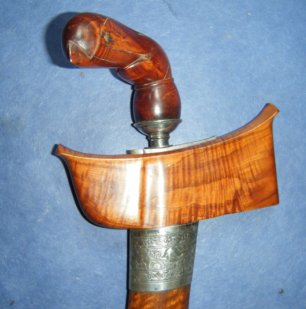

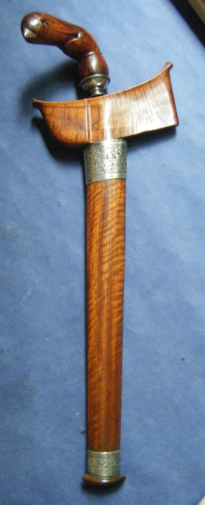

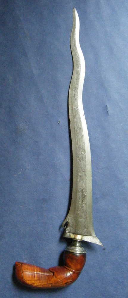

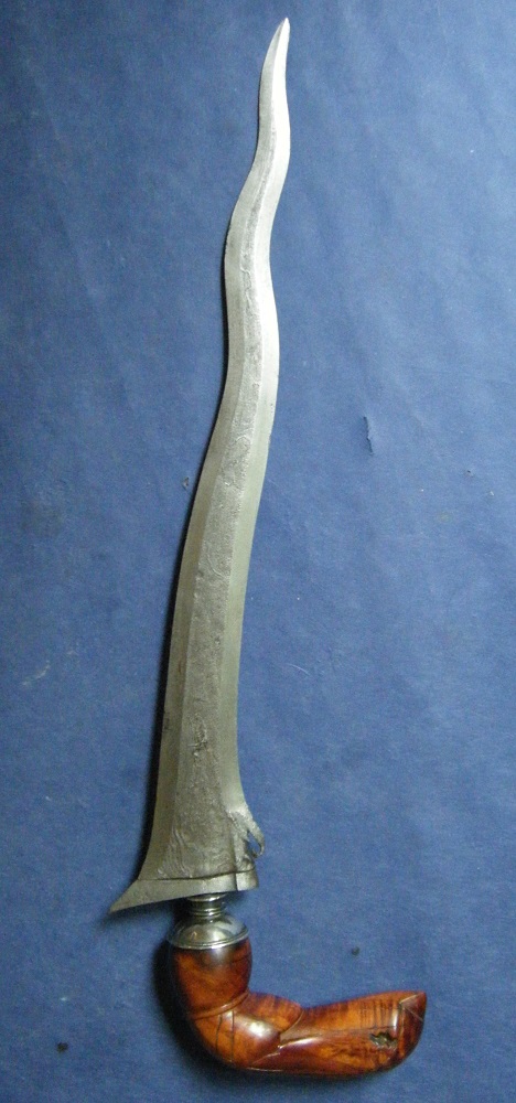

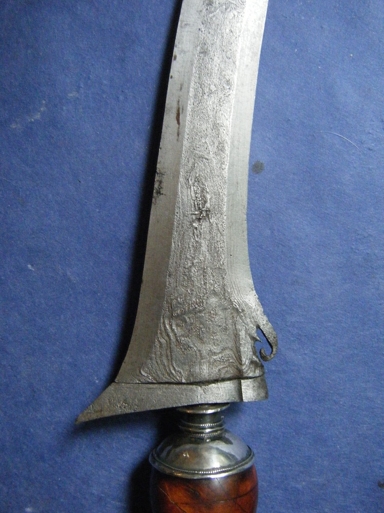

Hello dear members,
I come across this Terengganu (at least I think it is) keris. The gonjo is repaired on one side and the scabbard wasn't made for this blade, there is an old infill from resin in front. The 5 luk blade is very well made but is it as well Terengganu?
All comments are very welcome!

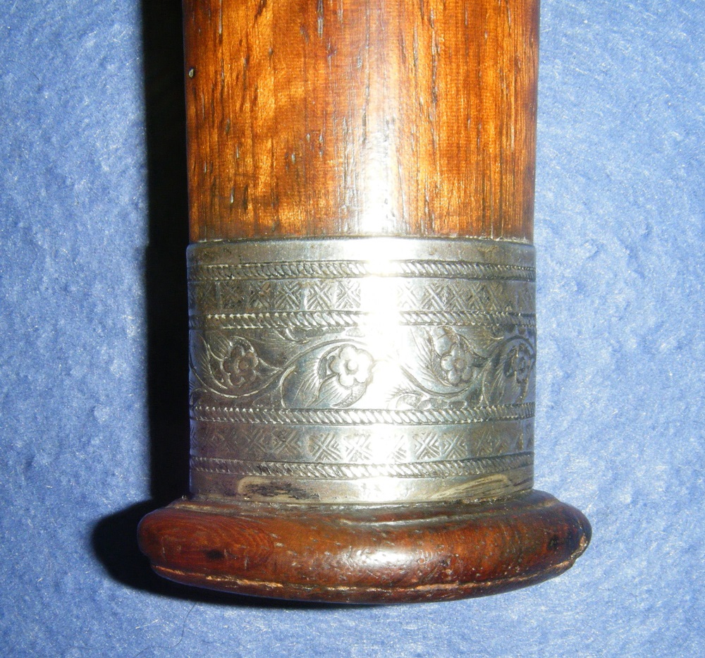

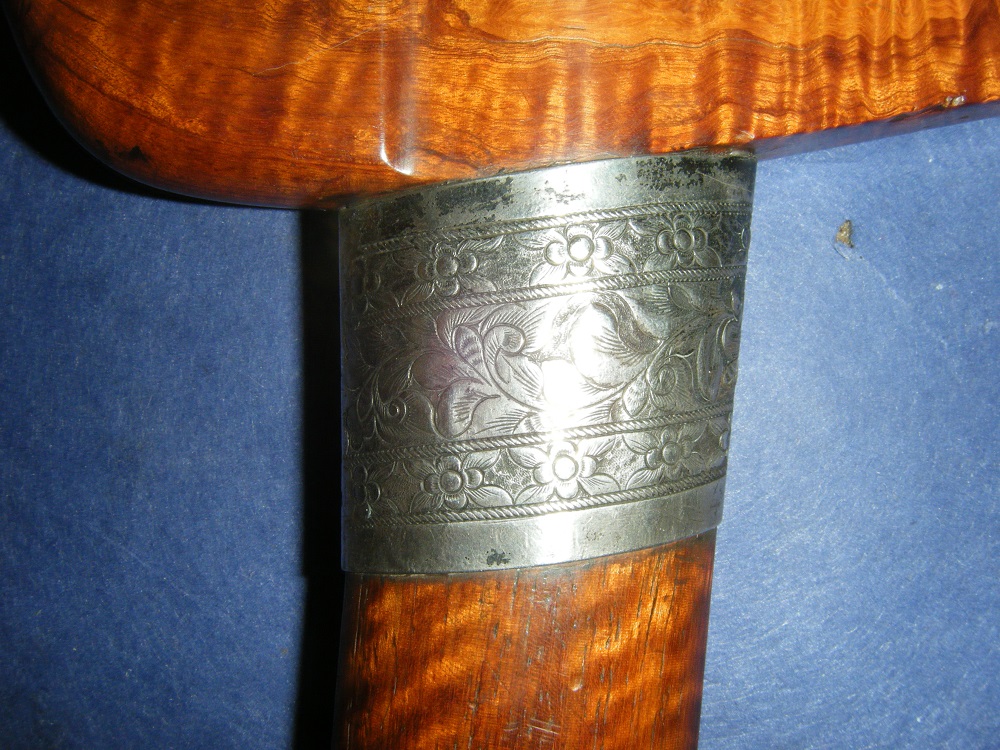

Old 1st September 2019, 07:52 PM   #2
Posts: 7,385
What is the meaning of 2 silver chased bands?
Old 1st September 2019, 10:04 PM   #3
Post
Hello Detlef,
That's a tough one - I'd like to see more details and pics taken at a right angle!
The blade does strike me as originating from Sulawesi though (probably the hilt, too).
What's the blade length?
Old 1st September 2019, 10:29 PM   #4
Posts: 9,680
Purely decorative IMHO!
Sajen is online now   Reply With Quote
Old 1st September 2019, 10:46 PM   #5
Posts: 7,193
Yes Detlef, decorative, but not purely so.
These bands strengthen the joints, sometimes the joint areas are bound with twine, and this binding serves the same purpose.
Old 1st September 2019, 10:53 PM   #6
Posts: 9,680
Hello Kai,
Thank you! Think you mean pic.3 & 4? The pictures are taken in the correct angel! Only the bolbous part of the hilt could cause a little disorientation. I will take tomorrow a picture with the keris in hand to show the unusual shape of the blade. The first luk is a real long one!
I am unsure about this point. With the blade in hand and having hold several blades in my hands from both origins I would tend to think it's a Malay blade. Treatment, finish and material let me think in this direction. Would agree with you regarding the hilt but on the other hand is the pendokok very Malay and seems together with the hilt for a very long time. [/QUOTE]
the blade length?
Blade length including gonjo and excluding pesi is 35 cm.

Old 1st September 2019, 11:41 PM   #9
Gustav
Join Date: Jun 2009
Posts: 1,319
It's difficult to say, because it appears to be a mix of parts.
I cannot comment on blade, sheath could also be Riau-Lingga (very similar and almost the same to Terengganu form, which tend to become boxier approaching newer times) - see the well known golden Sultan's Keris. Pendongkok could come from everywhere, but is not typical for Peninsula. Hilt is more likely Sumatra/Straits.
Old 2nd September 2019, 05:29 PM   #10
Posts: 9,680
Thank you Gustav! The pendokok is from silver, seldom seen by Bugis pendokoks and nearly undecorated so my first impression that it's Maly. But you could be correct.
You are also correct that it seems to be a "mix of parts" but I think that it was for a long time together like this.

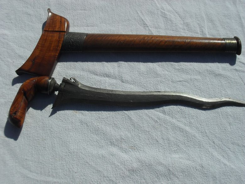

Old 2nd September 2019, 05:35 PM   #11
Posts: 9,680
By different reasons I wasn't able to take the promised picture so here one of the sellers pictures.
