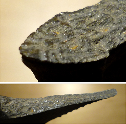

Here is another kris which puzzles me.
Right now I am showing only the sorsoran part to show the ricikan and peksi and hope to find some answers.
It is a slender 9 luk blade anyway.

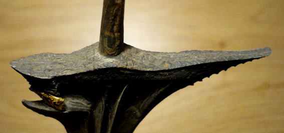

* Is this a ganjairas blade? Probably so.

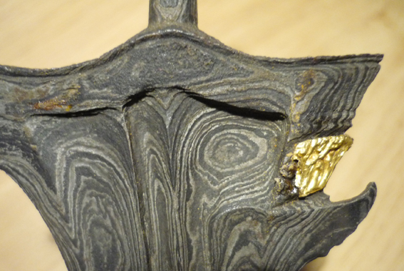

* The circular pamor motif in the pejetan area, what does it tell us.
* This is a blade with panji pilis kinatah mas. Not gold paint but some kind of foil (crumbling off a bit).
* The upper wavy ganja part once had goud incrustations as well, from the side I can see a rim?

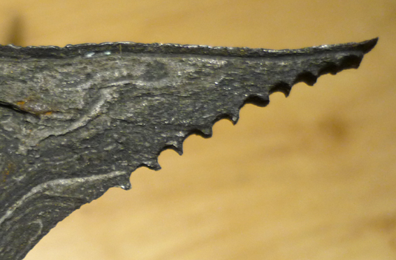

* Funny repeating greneng of similar kind (cut later?).

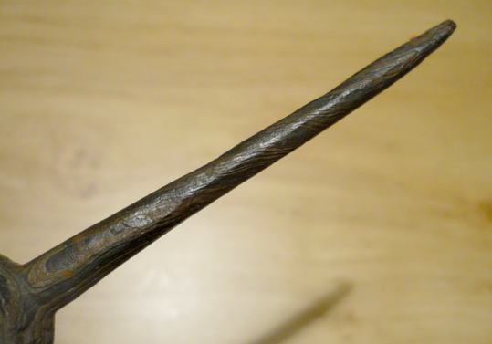

* The peksi is smooth, so what does it tell about age? Not to old?

Well Paul, i'll address some of your questions.
Yes, definitely.
It's part of the pamor pattern, yes. What do you think it should "tell us"?
Yes, i have seen this foil application many times, mostly on Sumatran keris which is why my first suggestion was that this could be a Sumatran blade.
Funny indeed, but i think probably cut originally. It has obviously been worn down some so it is hard to tell what it originally looked like, but from what remains it does not seem to fall into any greneng pattern that would make much sense on a Javanese keris.
Yes, the pesi is smooth, but it appears to be worn smooth for some reason. While this blade isn't ancient, it does seem to exhibit some legitimate age. But then, some people are very good at faking such things.

Inclined gandhik, long tip, kelap lintah gonjo, improper greneng = Maduro , probably early 20th century.

I would need to handle the blade to comment on the pamor, there are a couple of possibilities and I will not comment on these from photos.

Actually Kelap Lintah (in combination with inclined Gandhik) and Ada2 are not unusual on South-Sumatran Keris, also Gonjo Iras.
The type of gold application on Gandhik and Gonjo seen here is typical for Palembang blades, and Palembang imitated many styles bladewise.

There is some discrepancy with the wear of Jenggot and Greneng, and at least two possibilities to explain it.
