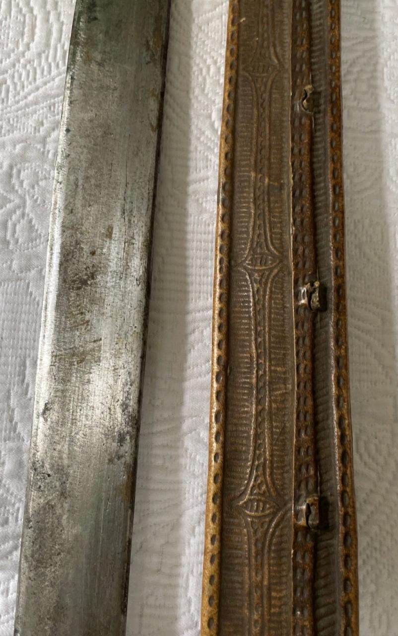

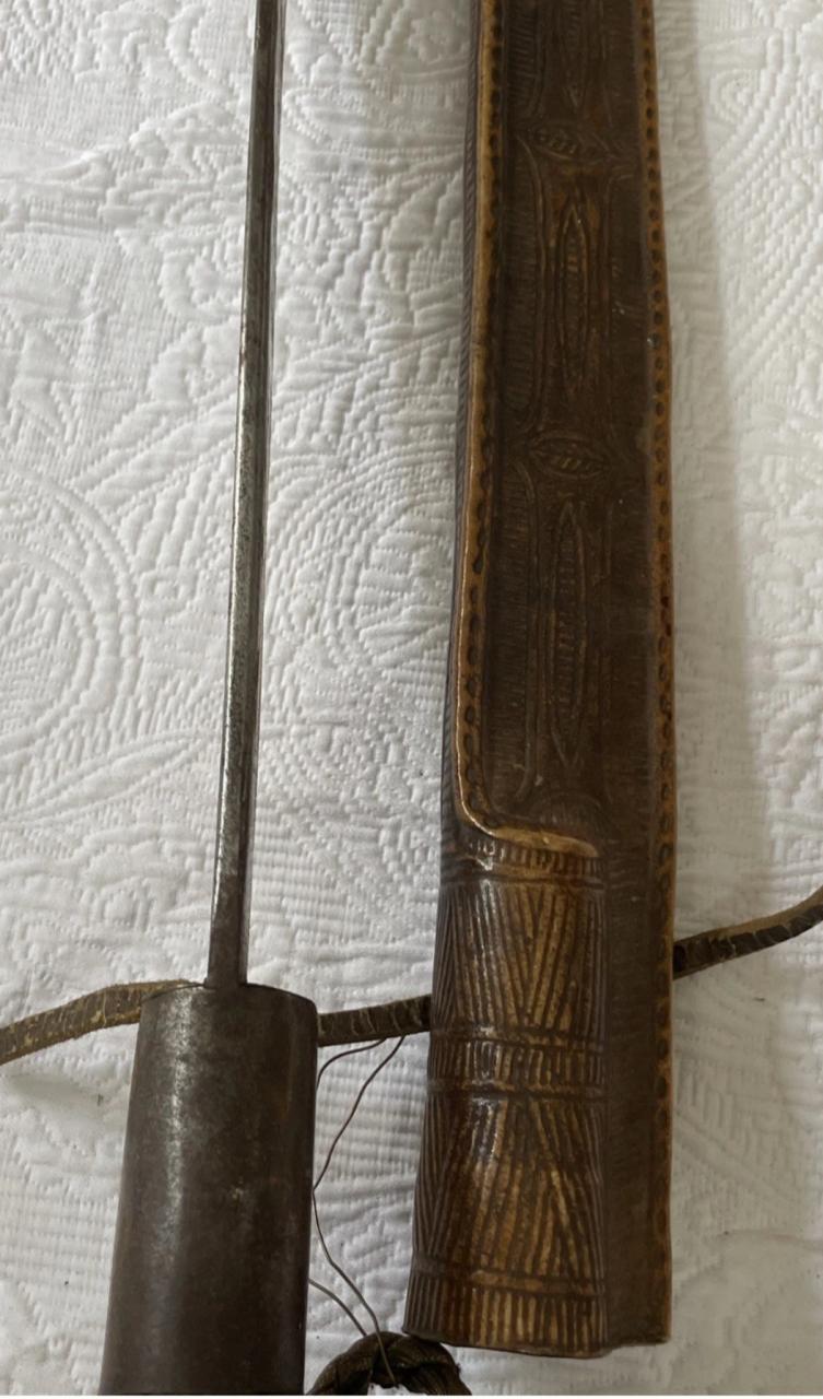

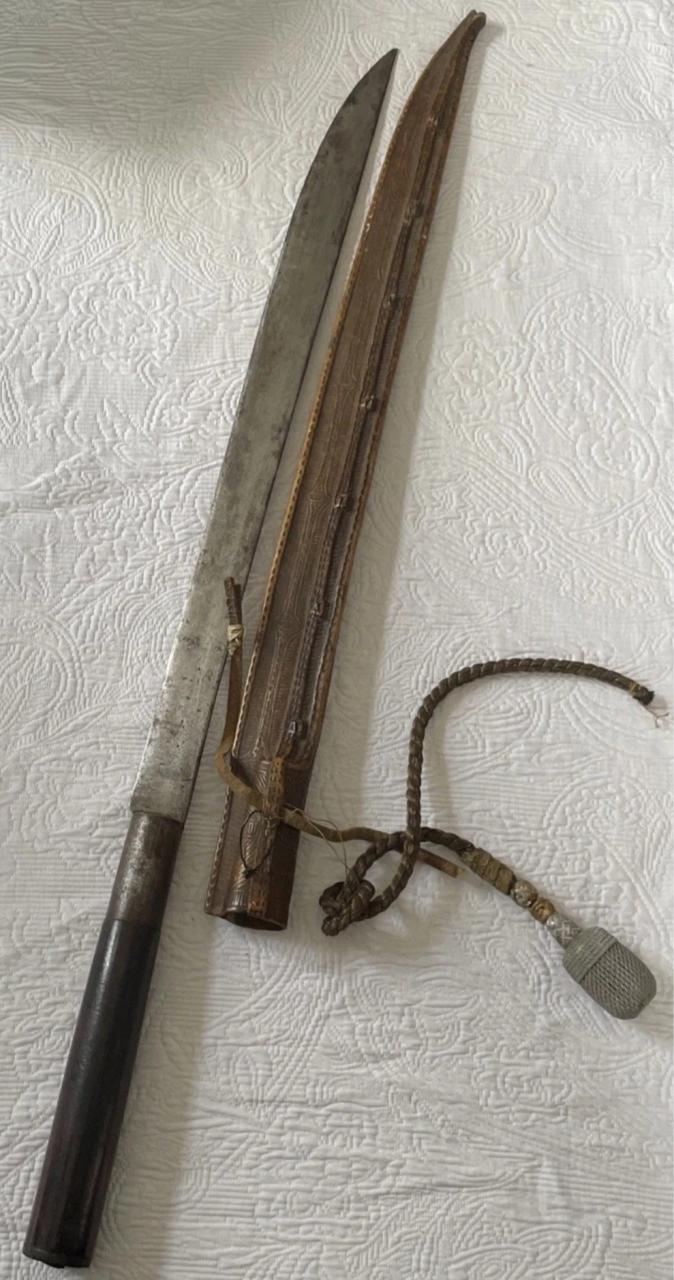

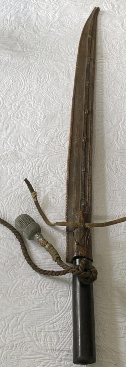

A recent Ebay auction (I did not bid). This is an unusual piece. It was listed as a dha but many features don't line up. I am assuming the German portepee tassel is not original to the sword.

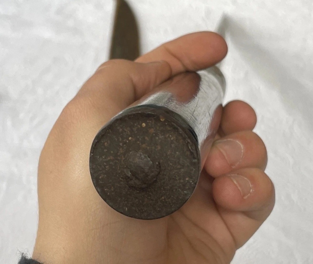

Tang appears to pass through and be peened over a pommel plate/end cap. Dha-type swords are uncommon with peened full-tang construction.
Scabbard is form fit leather, I do not recall another dha with a leather scabbard. It is heavily tooled with repeating geometric motifs, including eye/lozenge forms and punched border decoration. Tje design appears tribal to me. A raised central strip running down one face of the scabbard with multiple small repeated tabs/loops/fixtures spaced along it. These look functional rather than decorative.
Provenance from seller: obtained from the grandchildren of Wigand Wüster (German owner), could be a Stalingrad veteran and author of a memoir of his POW experience.

That looks like from old Formosa with a bit of European sword knot added.

There is nothing Formosan on it either on the knife nor on the scabbard!

I feel the scabbard is likely the most diagnostic feature, clearly made for the blade, unusual motifs.
Agree completely with you Jeff!

I have changed my mind. It came to mind that we have seen another Asian looking Afrucan knife with the same type of form fit leather scabbaed. It is in the forum somewhere. I think the conclusion was the great lakes regions. It was a small knife compered to the one in discussion. It had an ivory hilt with some red pigment decoration. I will try to find it.

Thanks for that very interesting link! Your suggestion of a Formosan connection is a nice "outside-the box' idea. Unfortunately, I have to agree with Detlef -- I can't see any Formosan connection for this sword.
Jeff,
I can see why someone thought this might be a SE Asian dha, daab, daav. Looking at the sword without the scabbard, it could pass for a Cambodian sword I suppose. But I can't place the leather scabbard and its "tribal" designs in a mainland SE Asian context, and the portepee tassel is a challenge to explain.
Looking at German colonial involvement elsewhere, as Tim has suggested, may prove profitable. When faced with similar conundrums, I sometimes go back to Stone's encyclopedic book and try to match a sword or scabbard. It's surprising how much obscure information is included in his book.
