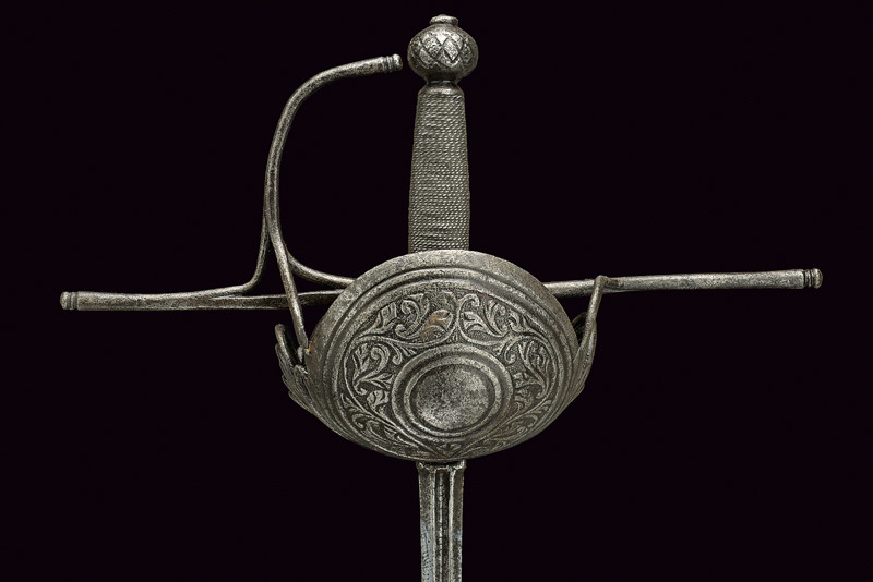

Got this rapier with the long, slender blade inscribed on both sides of the fuller "TOLEDO XX HEINRICH XX BRACHO."
I didn't manage to find any additional information about such a swordsmith so any opinions pertaining its origin, age and maker are very welcomed!

very good! btw your rapier hilt is indeed Spanish. Blade can be of Solingen manufacture or as it says Toledo. some Solingen sword smiths went to Spain.
I believe Johannes Brach did this around 1625 ! maybe his father, I have to check this later because my books are stored for the moment.

A very nice sword indeed , I like the model, nice old patina and no doubt all parts are original and belong together

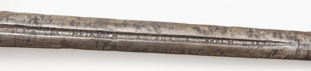

As I was trying to compare the signature on my sword with the one in the photo supplied by Jasper, while examining the blade under 10x magnification, I made a stunning discovery:
On one side the signature reads:
TOLEDO XX HEINRICH XX BRACHO XX
on the other side
TOLEDO XX HEINRICH XX BRACH XX
In both inscriptions the size of the letters decreases towards the tip, as the fuller gets narrower, exactly like in the photo supplied by Jasper.
THANK YOU VERY MUCH FOR YOUR HELP!

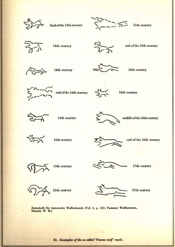

Musicians and artists have a well-known reputation for "cribbing" their competitors' and predecessors' ideas, and the blade-making centers of Europe were up to the same shtik as well. As Solingen surpassed Passau in output at the beginning of the 16th cent., its workshops imitated the latter's renowned running-wolf mark in order to cash in on its sterling reputation (I've seen the wolf on blades mounted up as far afield as India and China). In the 19th cent., swordsmiths in the Caucasus were putting the same wolf on their blades; you can see some examples of the originals and the knockoffs in E. Astvatsaturyan, ORUZHIYE NARODOV KAVKAZA (armament of the Caucasian peoples), St Petersburg 2004, fig. 33, p 53. Some of them are pretty true-to-form, but the truly humorous ones display a good deal of artistic license: one of them is more a kangaroo rat or mutant gerbil than anything remotely lupine.
Pp 56-57 of the same book show comparisons of original European blade motifs (the familiar religious figures, hussars on rearing horses, crosses, and Latin inscriptions) and the copies seen on blades forged in the Caucasus. The Muslim artisans did a very credible job depicting subjects like the Virgin Mary, and the Hungarian royal arms, but their attempts at copying Latin text were even clumsier than those of the typical illiterate workman in Western countries -- letters reversed, oddly spaced, or transposed. Sometimes the Caucasians simply gave up trying to imitate the florid cursive German hand, and stuck an Arabic inscription inside the same baroque scrollwork cartouche seen on a typical blade from Germany.

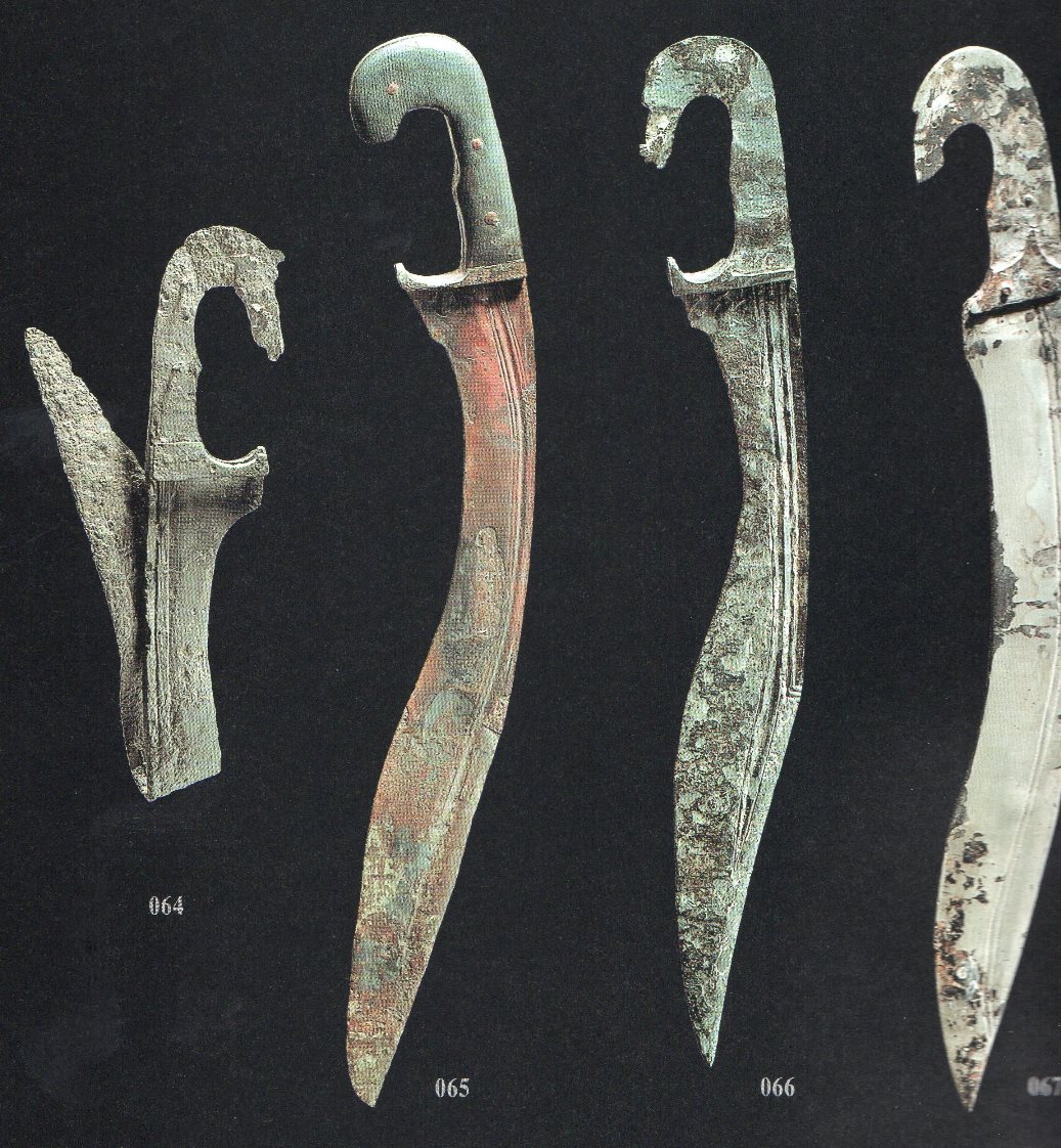

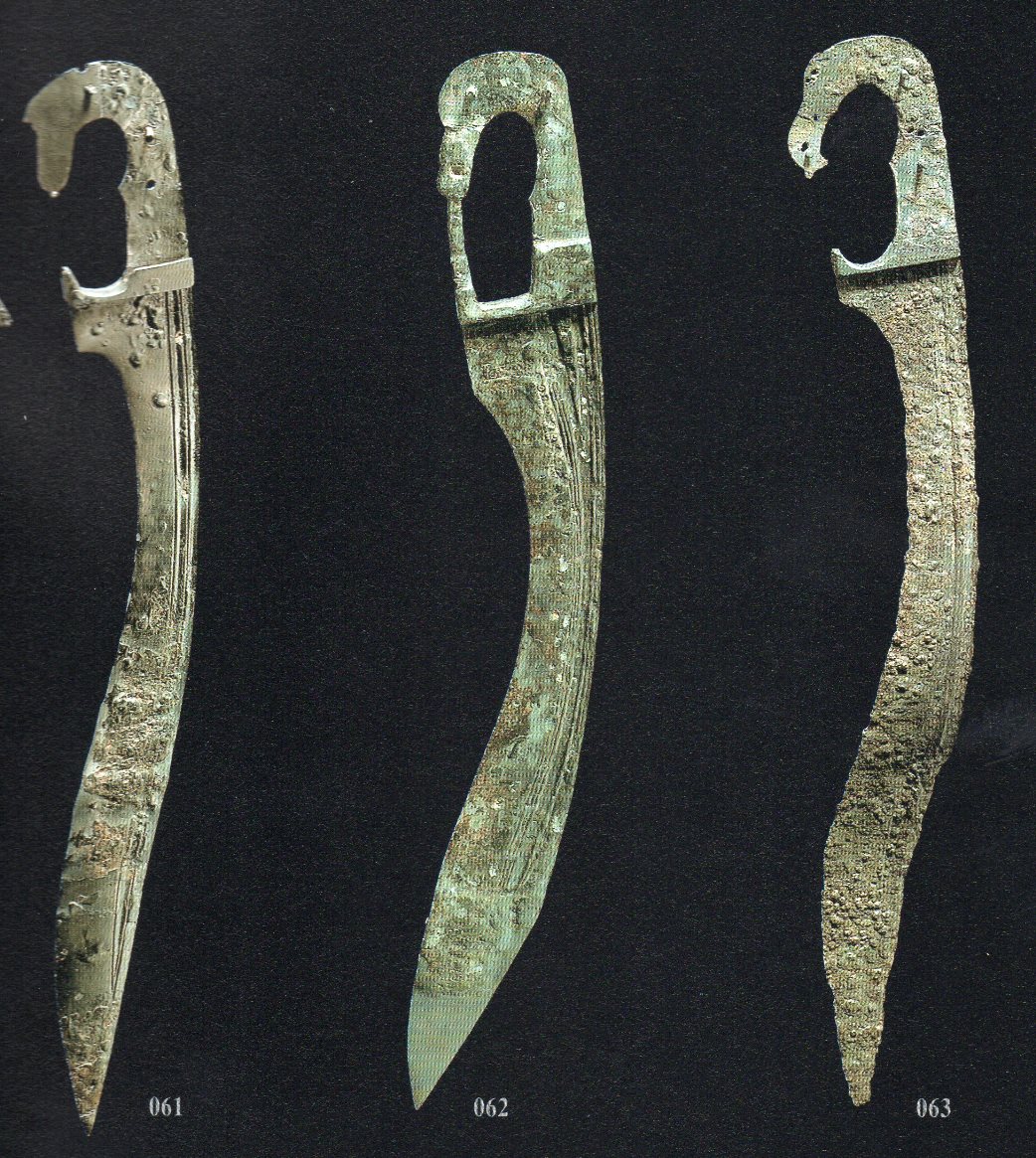

I couldn't resist uploading pictures of a few fascinating Iberian falcatas, dated 5th to 2nd. centuries B.C. sold from the Axel Guttman collection at Hermann Historica in 2003.
Note that item #064 has its blade intentionally bent (deceased ritual remnants ?), a detail that, for my ignorant knowledge, contradicts the exceptional temper they were said to have.
Hello Fernando,
While I am no specialist, I assume the Iberian Falcatas in your photos were of rather low carbon content steel, and while they may have displayed exceptional resilience due to their exceptional tempering, this may have been only exceptional for their period and compared to their Roman counterparts, but may be quite far away from our unerstanding based on modern standards.
Second, even some modern swords can be bent like this as elasticity works only up to a point and then, contingent on the steel composition and micro-structure, either plastic deformation or rupture follows.

Precisely what i want to get at; things may become mythic and legendary, but it helps a lot to contextualize them for a better judgement .

Philip,
Thank you so much for the nicely detailed response to my post, and it is truly rewarding to revisit some of this early history of the sword, something we don't often get to discuss as we examine much more recent weapons.
Very well noted on the character of these markings, in particular that of the famed 'running wolf' of Passau, which seems to have evolved around latter 13th century but of course dates are always debated.
As you note, the marking was taken up by Solingen smiths as they were advancing their production and usurping the business of Passau, among other centers, and applying spurious adaptions of their marks.
The almost whimsical interpretation of these chiseled 'wolf' marks is noted by Ewart Oakeshott in his most venerable "Archaeology of Weapons" (NY 1960 pp222-23), where he comments, "...a mark easily mistaken for the wolf of Passau is a unicorn since both wolf and unicorn only very summarily sketched with a few inlaid strokes, it needs the eye of faith to distinguish an animal at all".
It does seem that the design or stylization was dynamically varied depending on the skill or other as they were applied in various shops by various workers.

Jim,
Thanks for some very interesting points. There could well be something to the suggested connection between all this lupine / canine / vulpine imagery that you cite. The Passau wolf symbol is so stylized, and is often depicted with fairly short legs and extremely pointed snout that the result can be said to resemble a fox.
