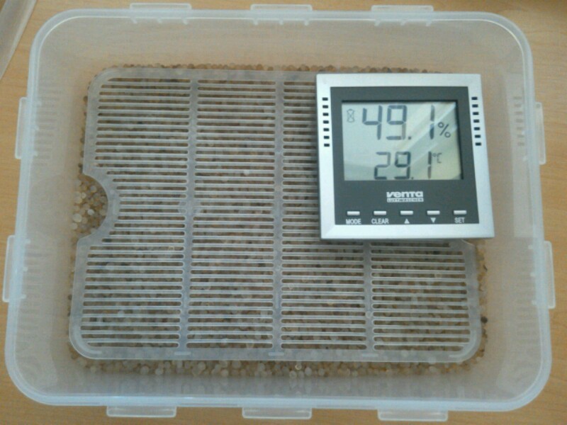

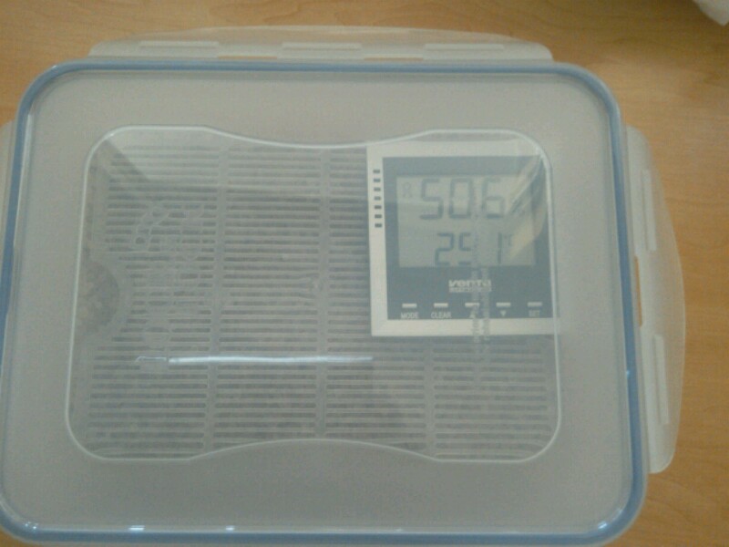

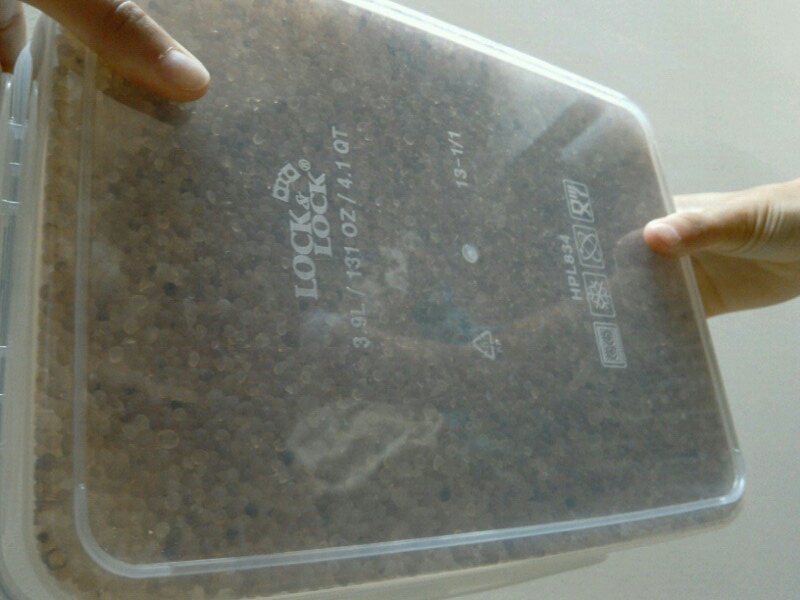

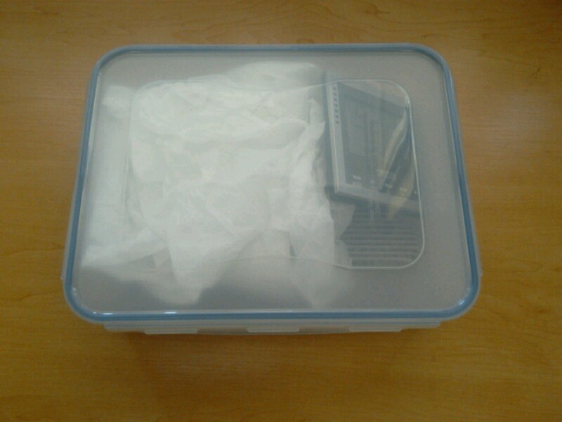

Sadly i yet cant provide knowledge about weaponry but i will share my know-how on storeing your pieces best.
The problem: Since about an year or so i am tracing many weapon auctions. Bone inlaid guns, swords, knives, shaffrons etc. Sadly i often come across cracked wood, biscuit ivory, brittle leather and similar issues preventing me to buy since i always aim for the "perfect" piece and i am rather picky collector. Ok i admit i am very picky one ![]() Its somehow an ambivalent approach. I know old pieces have dents, nicks, marks and other flaws but how much patina is allowed? To give an overdrawn example. Is a perfectly carved gun stock from 'the master of the tierkopfranke' cracked into two still really desirable? Or better skip that piece.....??? But you also cant blame in most of the cases the previous owners since it was just not an issue in earlier days to preserve to excessively. Furthermore the knowledge wasnt simply there. So what to do now??? My approach to this issue is called "passive humidity stabilization". If here are any cigar aficionados around they will know the system. Its similar to a humidor. But conditioned to 50% and not 70% humidity. 50% humidity prevents to have fungus on organic material spreading and the stabilizing the humidity prevents cracks from upcoming tension due to expand and shrinking materials. It also prevents paper falling to dust and leather crumbling apart. The whole package fresh out of the vault. SEE PICTURE 1 BELOW I use a airtight "tupperwarebox". Make sure its BPA free and has the food safe sign. Museums use special kind of foils which are even more airtight. But since i regularly visit my items anyway, my focus was more on stability. Please note if you are thinking now to invest in a similar system, any ivory item needs to be in a clear coloured box. Without light, ivory tends to get yellowish-biscuit coloured which is less desirable. SEE PICTURE 2 BELOW view from bottom SEE PICTURE 3 BELOW How it looks inside. (the fence thing inside came with the box and was not bought intentionally. However it proofed to be very practical to separate the pearls from the item.) SEE PICTURE 4 BELOW pearls closeup: SEE PICTURE 5 BELOW 2 different airbubble foils for warehousing depending on which size of the item. i always pack my boxes additonally with them in case of an earthquake, a attacking godzilla or whatever ![]() SEE PICTURE 6 BELOW conclusion the good: +preservation of objects, helping to keep status quo +low tech +rather cheap compared to an hourly wage of an conservator ^^ +easily adaptable for individual needs the bad: -It does not counteract varying temperatures. (const. 20° is the optimum) -At the moment state, my objects cant really be displayed properly. (I am still designing my own glas display cases) total cost without the hygrometer: ~40 euro for everything. I hope i gave you some ideas and its not stale news. If you have any feedback or want to show your preserving and warehousing methods feel free to post them here. kind regards Andi Last edited by Ian; 10th August 2015 at 02:57 AM. |

Yes of course if you have a big collection it would maybe make sense to adapt the whole room. Most museums handle it like that.
Before i bought my boxes i had most of my items at home and needed to check the humidity twice a day. Since my house has on average 35% humidity i was hanging wet towels to upkeep the needed 50% on a daily basis. This went on for an half a year or so and was a real pain in the a**. Someday i really got fed up, the whole situation was just ridiculous so i went and asked the -kunsthistorische museum- in vienna how they coop with this issue. They were very friendly and came up with that passive solution for me. ![]() If your items are already behind a display case you can still use the passive system. Just leave a bowl with the buffer-material inside and make sure the display cases are tight. The sealing gaskets costs around 4 euro per meter and is easily retrofitted. Sometimes you may see mysterious little boxes inside the display cases when you visit the museum next time. This is nothing else than the humidity-buffer. ![]() With 'active systems' which control the humidity and temperature i havent delved into. So i sadly cant tell prices or which companies to go for nor do i have any longtime experience. Besides of the running costs, like all electrical appliances, if there is current involved, those products tend to brake up after some time. Imho if you are not a museum or an super high-tier collector its not worth it. As soon as my display cases are finished i will post every important technical detail so you can rebuild them or let a glazier recreate it. I have visited the austrian treasure chamber now several times and studied nothing else but the show cases just to be able to reverse engineer them. HAHAHAHA furthermore information (in better english )about the actual problem. http://www.nga.gov/content/ngaweb/co...e-temp-rh.html http://www.nga.gov/content/ngaweb/co...e-temp-rh.html kind regards Andi |
