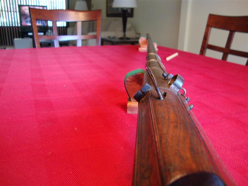

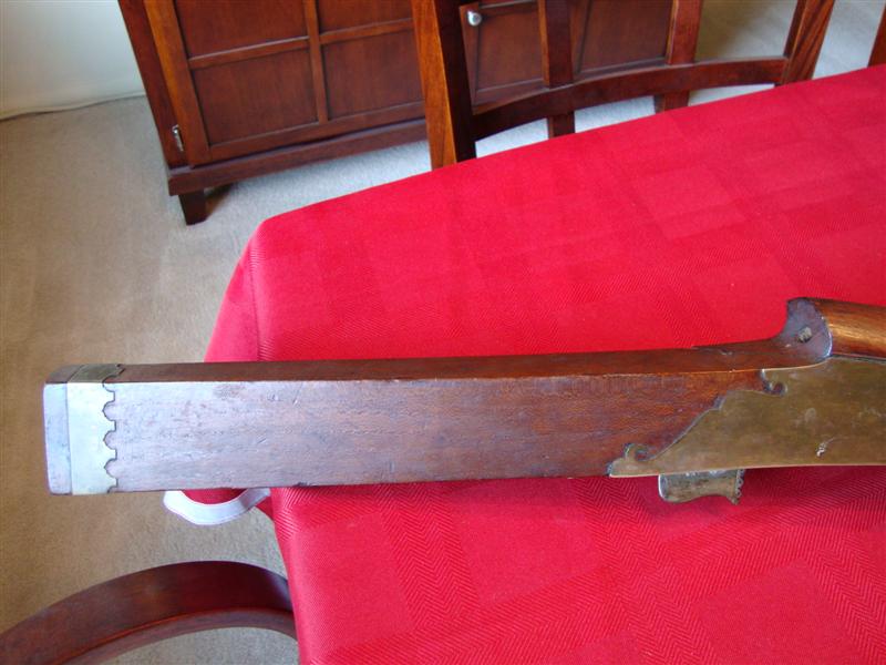

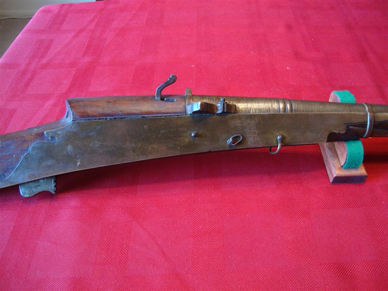

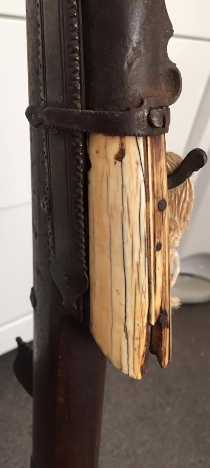

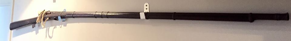

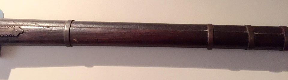

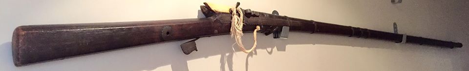

Indian matchlock musket or Torador
Early 19 th century,Rajasthan ,North west India.Ivory and silver inlays
190 cms long
Longest gun in my collection

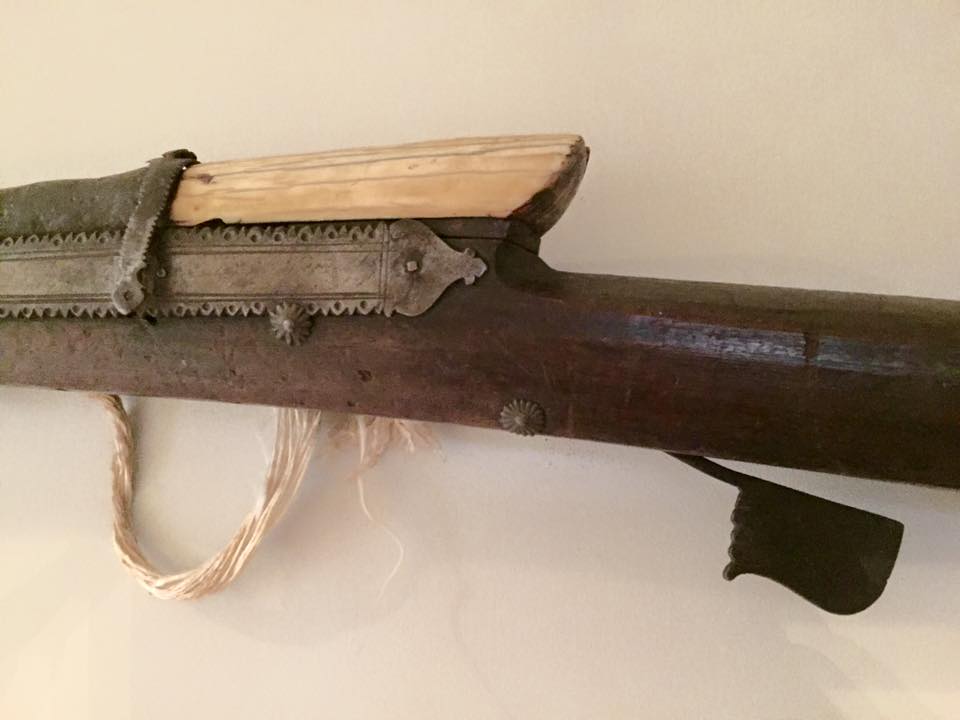

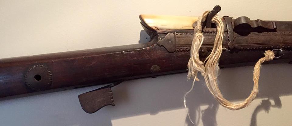

I note that the trigger bar is obviously bent on your Torador. Needs to be straightened so that the trigger is inside the slot underneath, and more importantly so that it does not accidently get broken off.
Stu

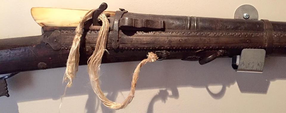

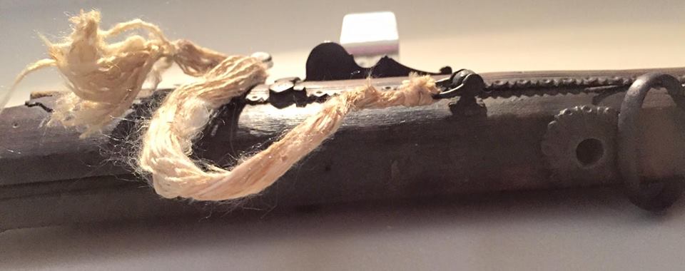

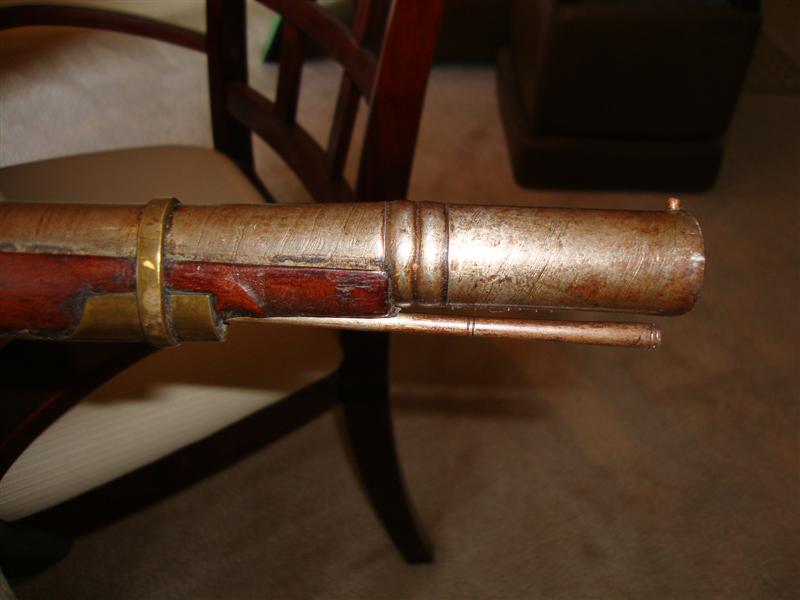

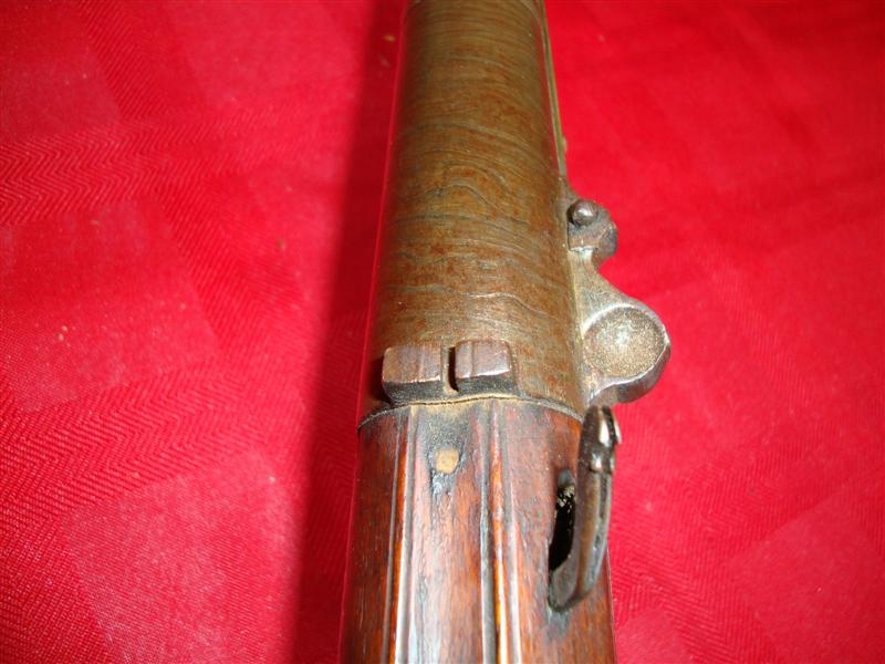

Here's a couple of pics of my Torador...
YES IT LOOKS IN GREAT NICK AND SHOOTING CONDITION,THOUGH I WOULD NEVER MESS WITH SUCH OLD GUNS,DONT LIKE TO RISK BLASTING THEM
