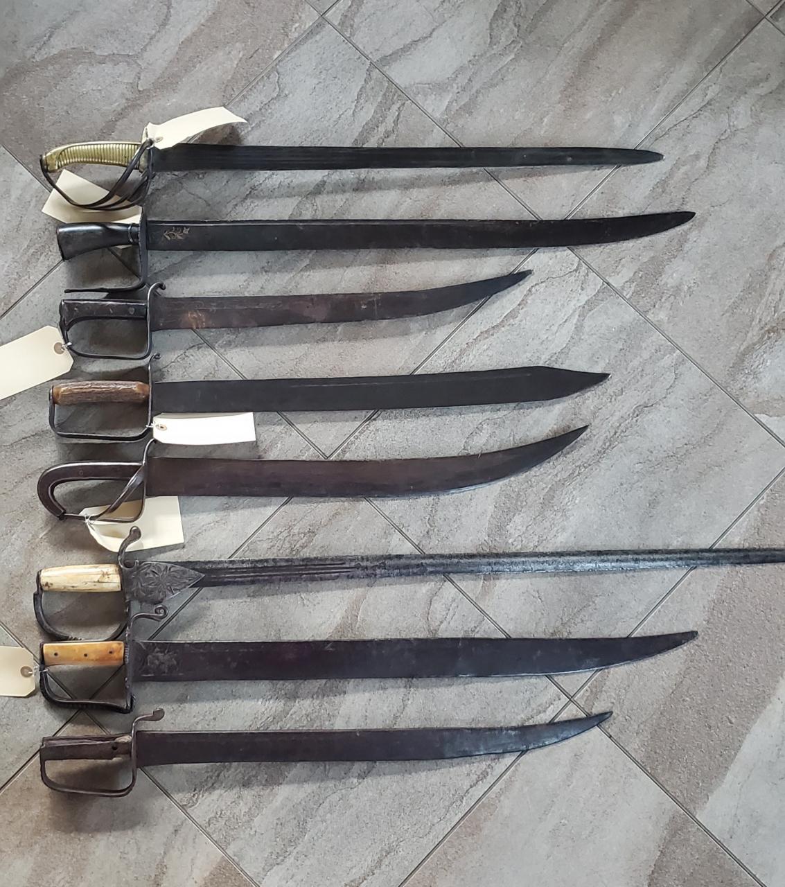

In recent research, traveling over old roads from years ago on these intriguing short swords of the frontiers of New Spain, I was informed of the source for the curious misnomer referring to these.
The term 'espada ancha' in Spanish translates to 'BROAD SWORD', which of course might figuratively apply to some of the wide heavy blades on many of these. However the term more properly applies to the heavier, full size 'broadswords' typically known as 'bilbo's'. Sidney Brinckerhoff ("Spanish Military Weapons in Colonial America 1700-1820", Brinckerhoff & Chamberlain, 1972) apparently once noted that he had apparently applied the term to the short, heavy swords used on the trails for clearing brush etc.
These were actually in the period and regions termed by the locals 'machetes', which is technically better describing what they are.
While these were typically worn by horsemen on the trails in general, the true weapons for any sort of engagement were primarily the lance, the 'broadsword' (typically the bilbo) and occasionally the escopeta or other pistol types.
I am posting a grouping of espada anchas showing the general form but with certain variations, and would appreciate anyone showing other examples, especially if they might lend to regional provenance.
Also posted is the typical military arming broadsword known as the 'bilbo' (a Victorian collectors term, correctly termed 'boca de caballo) which in use as early as 17th c. became known as M1728 and M1768 models by regulation.
While other types of sword were also known, such as crude versions of cup hilt, these were more common. By 1800 military saber hilts also fitted with these long broadsword blades came into use.

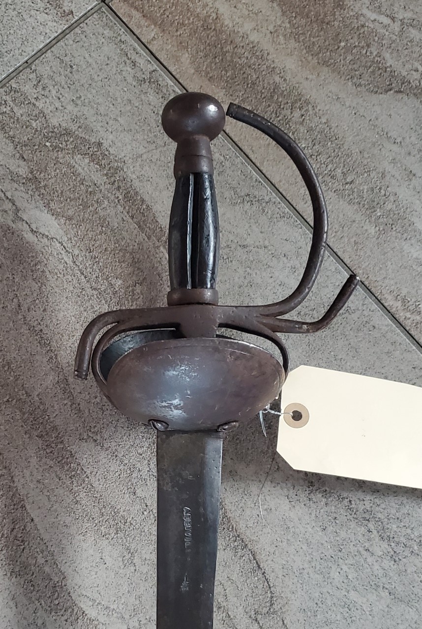

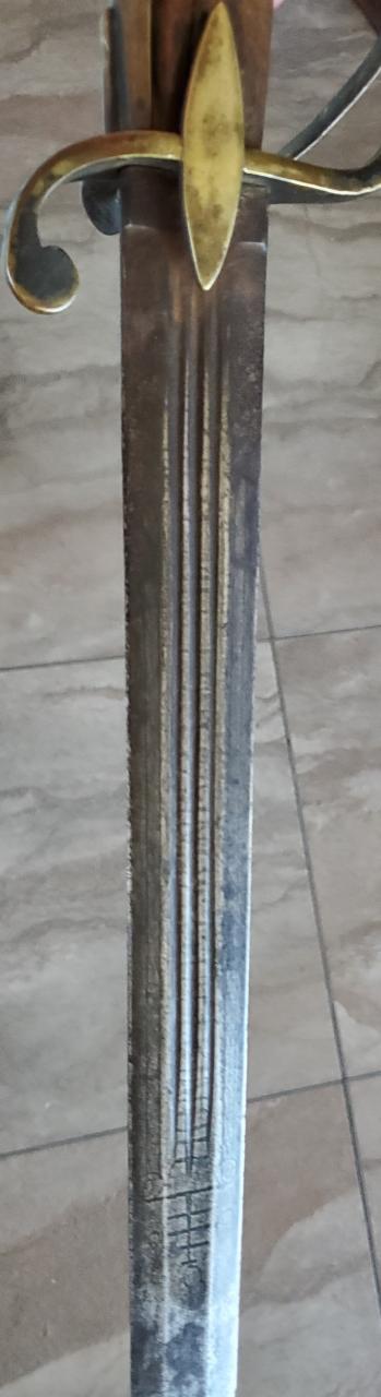

Default The Avila Sword

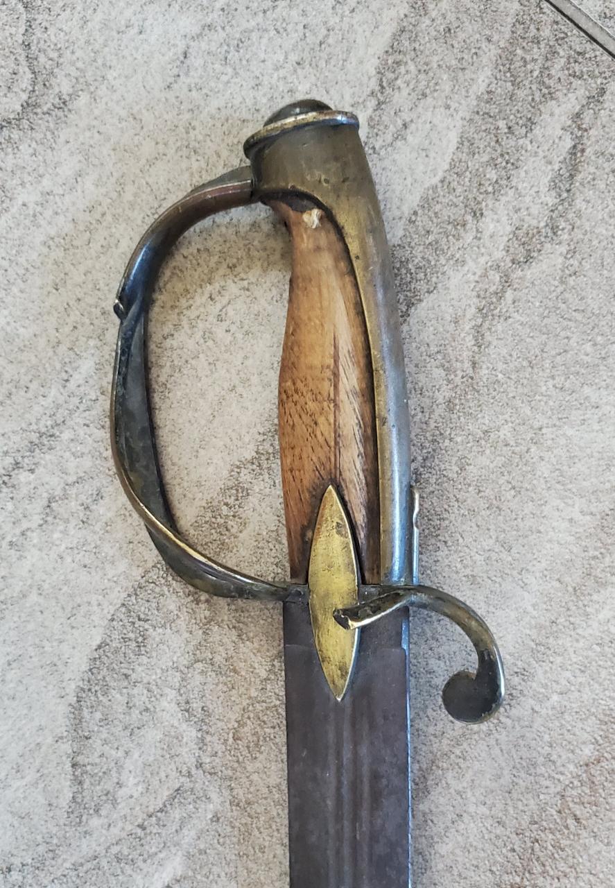

This is an example of the 'espada ancha' type hilt but mounted with one of the double edged dragoon blades typically found on the bilbo as well as the later cavalry hilt (three bar guard) sabers of c.1805+
This example dramatically parallels one like it with ornamented leaf shape shell guard which is in the Los Angeles County Museum and attributed to Captain Jose Maria Avila of the Pueblo of Los Angeles.
On Dec. 5, 1831 in a rebellion against Governor Manuel Victoria, Avila was leading rebel forces and met government forces at Lomitas de la Canada de Breita (near Cahuenga Pass).
Leading the government forces was Capt. Jose Antonio Romualdo Pacheco.
As components of both forces were related; brothers, cousins etc. none wanted to give battle.
In frustration, both Avila and Pacheco rode at each other with lances.
After three passes, Pacheco knocked Avilas lance to the ground.
Astonishingly, Avila shot Pacheco, killing him, and stunned at what he had done, sat dumbfounded in his saddle.
What happened next is confusing, some say Gov. Victoria shot Avila, others say another, but he was shot dead there on the field.
They say both men fought with swords and lances, but that remains unclear.
This example I have as noted is quite similar to what is known as the Avila sword, which is said to have been his and became property of Del Valle family, who donoted it and other to LA County Museum.
This information from "Swords of California and Mexico" Arthur Woodward,
'ANTIQUES MAGAZINE, Vol. L, 1946, pp.102-104
It is noted that while Avila had his sword in 1831 as per the museum catalog, it is believed much older late 18th c.
While the machete type (espada ancha) hilts were usually with short heavy blades, it is clear that rancheros had the longer dragoon blades fitted as these swords became mounted on saddles under mochilo.
Thus my example here would appear to fall into that category.
Illustrations of Cahuenga Pass area 1847; Pueblo of Los Angeles c. 1869; my example of espada of Californio form (by comparison to the Avila example) with bone grip late 18thc

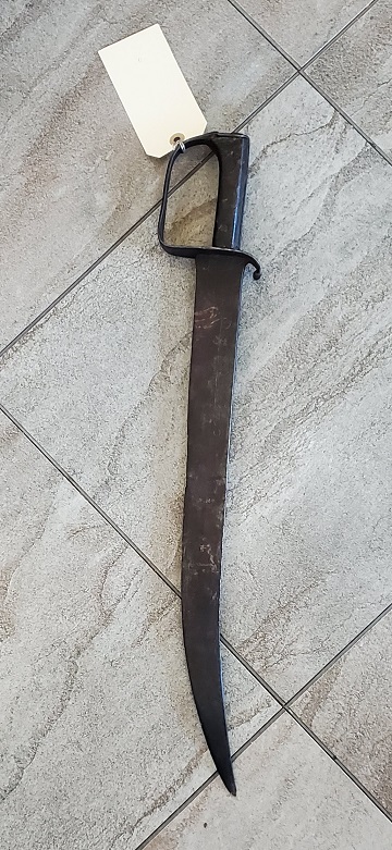

Default Espada Ancha -Potosi style

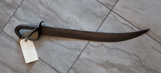

This is an example of espada ancha that has been claimed to be of San Luis Potosi/ Guanajuato regions (just northeast of Mexico city). This is noted in "The Unique Swords of Old Mexico" (Bill Adams, "knives '85" , DBI Books, 1984.).
These hilts are distinctive for overall metal hilt with downturned pommel which nearly meets the half knucklebow. Many of these have zoomorphic terminals.
The Potosi region was closely connected to caravan trails northward from Mexico City to the Frontera regions of Arizona and into Santa Fe, N.M.
This one was found in Tucson.
Note the uptick and sharp point on the blade, which seems to have become notable in early 19th c.on these 'machetes'.

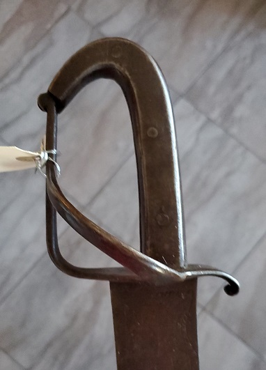

Default Round tang espada

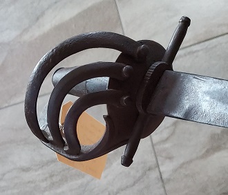

This is a form known as a 'round tang' espada, as per Adams, (1984, op. cit.). as it is stated the hilt, typically wood or horn, is drilled out to receive the tang. This seems unusual as some of these seem to have cut down saber blades but the tangs could have been ground.
The branched guards it seems I was once told were termed gavillas (Sp. -sheaves, of wheat), and this form seems of probably first quarter 19th c.

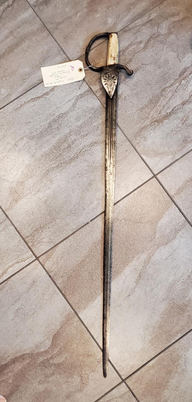

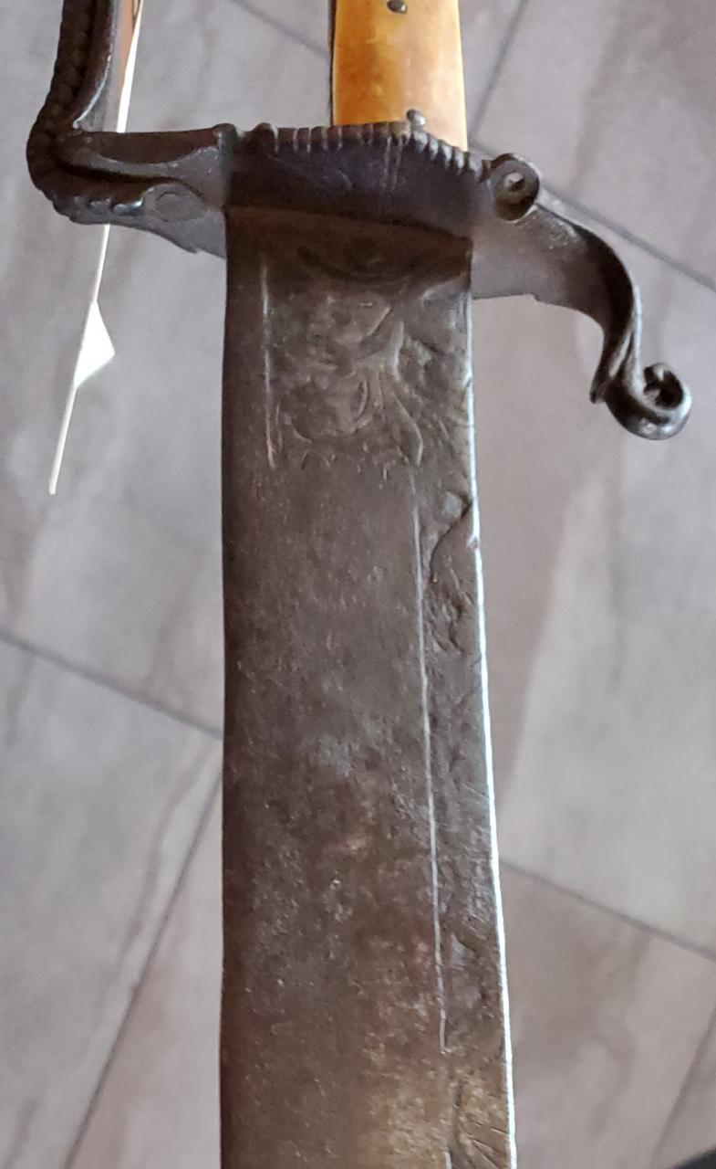

Default Espada ancha -Nuevo Laredo
In keeping with what I have asked here, I am going through old notes (Ive been on this topic since early 90s and earlier) and am trying to add what I can to the examples I have.

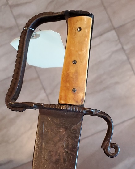

This example was located in Houston some years ago, and said to be from the Nuevo Laredo region. (#3 from top in OP).
This is of course the famed Laredo, Texas which is right on the Rio Grande.
As a settlement of New Spain, it was founded in 1755 as Villa de San Agustin de Laredo. This was named for the city of Laredo in Cantabria, Spain.
In 1840 this became the capital of the Independent Republic of Rio Grande which was in opposition to Gen. Antonio Lopez de Santa Anna.
In 1846 it was occupied by Texas Rangers, and later Laredo became Texas territory, while Nuevo Laredo in the Mexican state of Tamaulipas was across the Rio Grande .
What is noticeable is the familiar uptick at the point of these 19th c. espadas which I was told in conversations in 2003 with Enrique Guerrera of Texas, was responsible for these on the frontiers being called 'frog stickers'.
Also notable is the artwork inscribed in the blade, which I am hoping might compare to other material culture regionally and give us more on regional attribution.

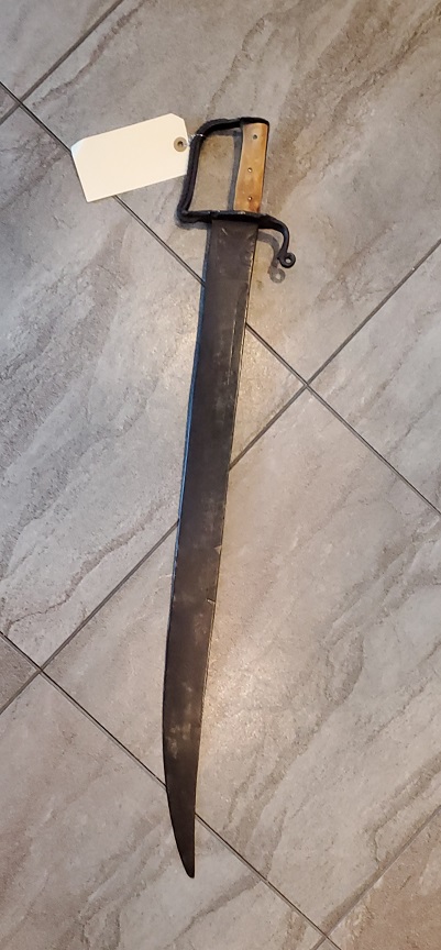

This example is extremely heavy and seems an earlier form, of 18th c. and is said to be from New Mexico, so presumably Santa Fe regions. Note the detail in the guard and the elaborate engraved panel along blade back. This seems like the example from Nuevo Laredo which is however much later in my view.
The convention of this inscribed art along the blade hopefully might give more insights into this convention.
The bone grip slabs are riveted directly to tang and these heavy blades seem to have been forged by blacksmiths in these areas.

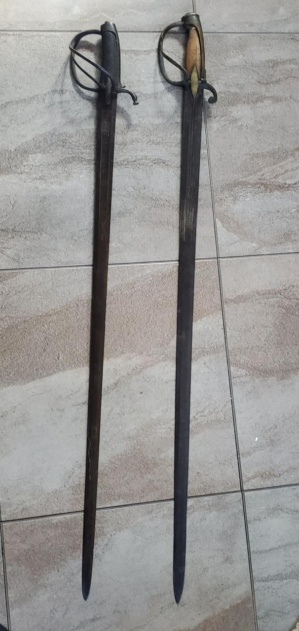

The attached are examples of the 'cavalry' hilts that began being mounted with these 18th century straight broadsword dragoon blades in the early 19th century, seen being worn under the saddle and left leg as in this painting by James Walker of a vaquero. It is believed this was Don Peralta,the sword shows the branched guard.
The one with dragoon blade and espada ancha hilt with leaf shaped shell on crossguard is as previously discussed similar to the Avila sword c. 1831 Los Angeles. It is noted on the Avila sword, the blade is much earlier.
