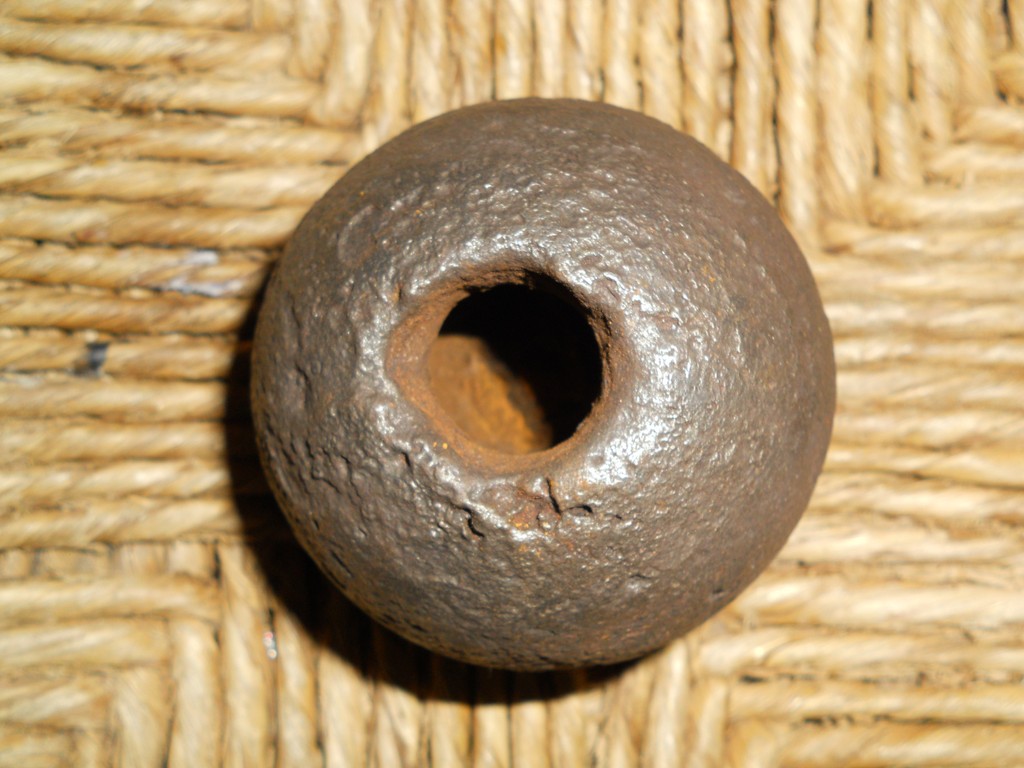

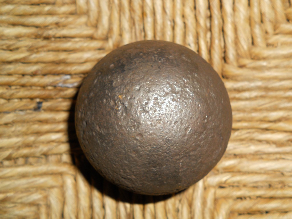

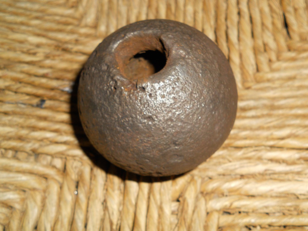

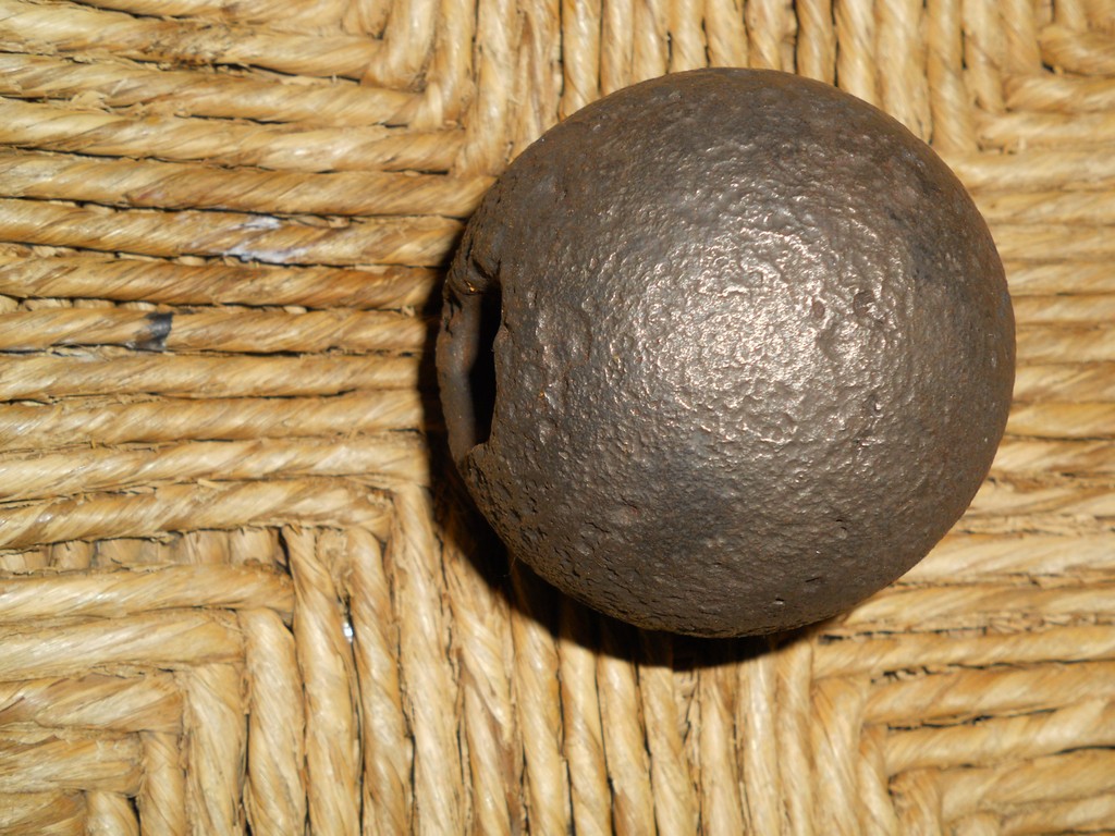

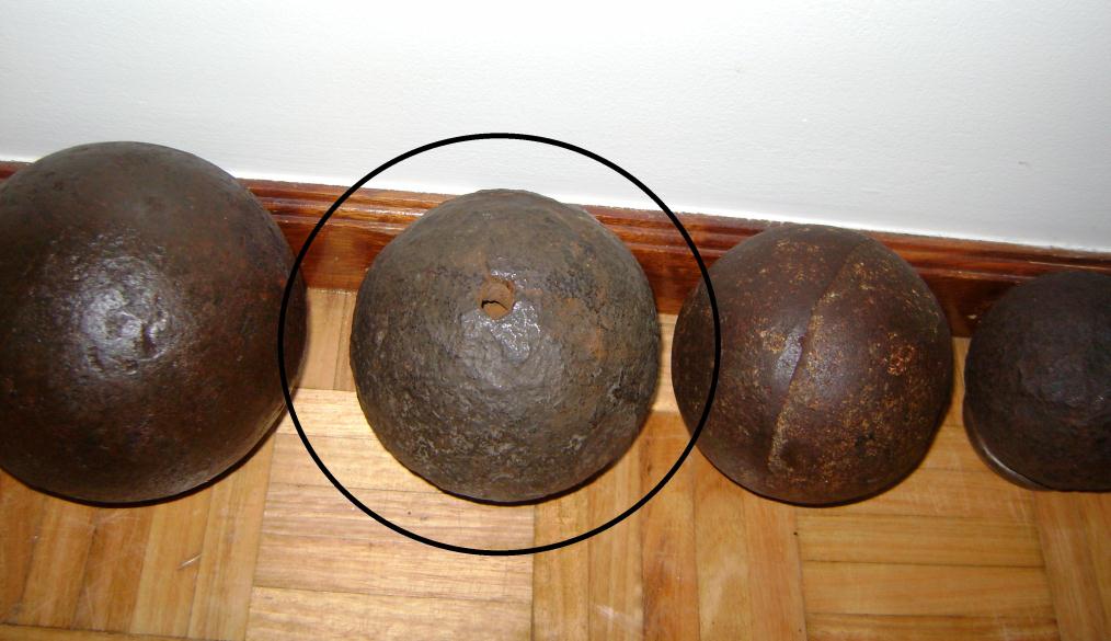

Can any members help me with any info about this item which I hope is some kind of cannon ball . It weighs 1.1 kg and is about 65 mm in diameter .
Old 28th October 2013, 06:16 PM   #2
Sure thing; more precisely a grenade. Cannon balls are solid, grenades are hollow, to be filled with explosives or shrapnel. The loading hole also fits a fuse. Early ones were simply matchcord and later ones were 'inteligent' devices, like detonators and timers.
This one was possibly for a 2 1/2" howitzer.
18th or early 19th century, i would say.
Crikey Fernando , you are fast as lightning .... thank you so much for your rapid reply .... it will go well in my Napoleonic display then . One more question , if this is a grenade for use in a howitzer, how would it differ from a hand thrown grenade ?

Originally Posted by thinreadline
.... Crikey Fernando , you are fast as lightning...
That's what you will turn into, when you retire
.... it will go well in my Napoleonic display then ...
Yes, quite an indicated match.
.... ...if this is a grenade for use in a howitzer, how would it differ from a hand thrown grenade ?
Completely a different universe; in generation, shape, technology.
But don't be lazy; browse the Net
Ah but I 'm not retired , any how, I will consider myself told off and go and browse the net. However I have to say that I prefer the wisdom of someone like yourself who I perceive to be an authority , rather than the unsubstantiated stuff one often encounters on the internet !

Man, i know nothing; don't be surprised if someone comes after me and says i am wrong
I am comparing yours to mine; although mine is larger (51/2"), the approach is the same.

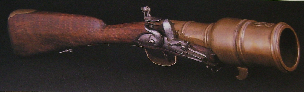

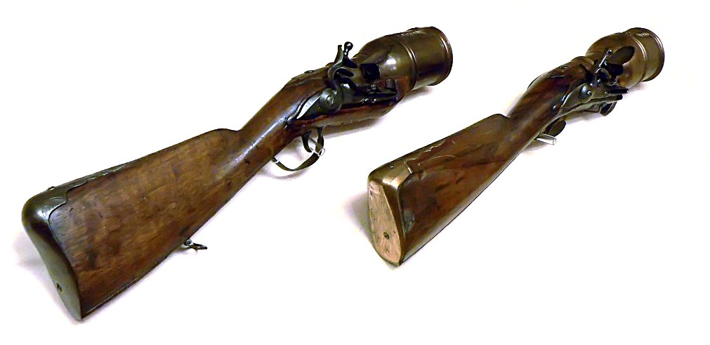

During your browsing you may find these 'grenade launchers' or 'portable mortars'. They date from the 18th century, but i don't think they are the issue here.

Grenades vs mortar shells...this has always troubled me as well. Per Gilkerson, grenades were rarely smooth and often not even perfectly circular, because they didn't need to fit perfectly in the barrel. Mortar shells were more like solid shot in that they were supposed to be well formed and smooth, at least theoretically. Put one in the ground for a few centuries and it might not be so easy. I have what I think is a grenade in my collection, somewhat between the size bigger than a golf ball, but smaller than a tennis ball. It has a very small 1/4" hole and congealed powder inside. It isn't perfectly round, so I assumed grenade. Problem is, most resources claim grenades are larger than mine and with a bigger fuse hole. Hope to someday find a resource that shows other sizes besides what 'Boarders Away' lists.
Another controversy is with the brass grenade launchers. Some sources say that these rifle types were too short and too thin to be effective as launchers and that these guns were more likely for shooting off flares or fireworks.

...Another controversy is with the brass grenade launchers. Some sources say that these rifle types were too short and too thin to be effective as launchers and that these guns were more likely for shooting off flares or fireworks.
Speaking of which ...
This example is in exhibition in the Portuguese Royal Palace of Vila Viçosa armour collection.
For what it is worth, the text says that it is a XVIII century Spanish (?) portable mortar, with a 73 m/m mouth. Cast in bronze, with a chamber of much narrower section, with a support hook in the lower part. Silex lock a la French. It shot 'case' with multiple projectiles. It was used in ships and parapets.

I tell you Mark that i concur with your doubts in this issue and find the definition you quote (Gilkerson) rather hard to digest ... though admiting that such person will be an expert in the matter and i, an ignarus .
I don't see why the distinction between a grenade and a shell would be their outer perfection.
I know that hundreds of 5 1/2" howitzer grenades were shot during the French invasions (1807-1814). I am trying hard to locate the illustration of one of these projectiles. On the other hand, i don't see any reason for the example i have shown above not be one of such things. Most howitzers were mounted in fortification lines around Lisbon and i got this one over there.
Despite its corrosion due to age, it looks rather spherical ... and the fuse hole is pretty narrow.
I would quicker assimilate that the difference between grenades and shells and even between mortars and howitzer typology, resides in their time evolution and origin.

Yes, just one of the many frustrating and foggy areas of naval collecting. I like the bronze gun for the 'Tops'. It would have done well against boarders.
I don't necessarily question Mr. Gilkerson, but I feel that his study concentrated particularly on one country's type of grenado from a specific time period (Great Britiain, ca. 1600-1750-ish). As we've seen on this forum, there were all manner of exploding shells around made in different materials (clay, stone, etc). Perhaps in the future, someone will do a more definitive and specific volume on said lobbed bombards.
Here's mine from an old link. As I said, it's smaller than the examples Gilkerson mentions, bigger than golf ball but smaller than a tennis ball, approx 2 1/4" tall with a hole the size of a garden pea (at this small size, I imagine just enough room for a wick with no inner core, as some do-

The subject of hand grenades & small common shells is too broad to receive an accurate answer to, various countries altered what they used/did as they progressed & not every country did the same thing etc.
However if you ask about British practice there is quite a bit of information covering approx. 1750 onwards.
Some snippets:
Hand Grenades
Some mention has to be made of the hand grenade. The service grenade was a small hollow sphere of iron, with a single hole in it into which was fitted a beechwood fuse.
The sea service hand grenade was 31/2 inches diameter (actually 3.49 inches), and weighed 3 lb 11 ½ oz. The land service hand grenade was smaller: 2 3/4 inches diameter weighing 1 lb 13 1/2 OZ. These sizes were standard from at least 1755 , to 1790 . The fuse had a burning time of 9 seconds , and was tilled with a mixture of equal parts of mealed powder, saltpetre and sulphur. The hand grenade contained 4 oz. of powder. No record has been found of how useful or efficient they were, but the mere fact that 200 of them were carried in a 74-gun ship in 1765 suggests that plenty of employment was found for them. They were supplied in boxes, 20 grenades to a box; some degree of deterioration in the fuse was anticipated, as 20 were carried, fully fixed, as spares, which assumes a 10% unserviceability rate . As an aside, it is worth mentioning that the French Navy issued practice grenades, made of of papier-máché, but there is no trace of any such device in the Board of Ordnance papers of the British Navy. There was however a hand grenade made of glass, of which examples are in

Would a small sphere such as mine more likely be a grenade or a very small mortar shell? Did they make them this small??
The smallest mortar in British service was the Coehorn at 4 2/5 " bore.
However that does not help differentiate between a shell or grenade, a 4pr cannon could fire a shell, as could a 3 pr etc. I would suggest that shells were often used as grenades - hence the British (apologies to the rest of Europe etc for using them as an example all the time) had 3pr grenades (same dia as a 3pr common shell) & 6pr grenades (same dia as 6pr common shell) & eventually grenades were purpose made. Just as solid shot were used for the sport of shot putting, eventually shot puts were purpose made.
(but sometimes still found on e-bay being sold as antique cannon balls....)
In summary, its quite likely that what you have could be both, unless you know its country of origin & investigate their cannon calibres which might narrow that probability down if it is not of a cannon caliber.

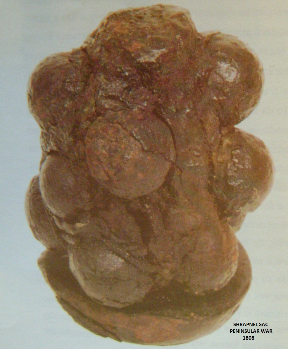

I would say that, one reason for this period grenade fuze holes being larger than others was the need for some to be wide enough to introduce shrapnel, namely (lead) bullets ... resuming that thin holes were to fit simple matchcord and respective grenades to be filled with only gunpowder.
The British introduced the shrapnel grenade in Portugal during the Peninsular War, an invention soon adopted by Portuguese. Apparently Wellington had some doubts about the efficiency of such grenades, on grounds that their projectiles impeled by the bomb explosion didn't have enough velocity to penetrate and kill victims, only injuring them. But he appreciated the use of such shrapnel in heavy cannonry (24 pounder), with visible results in Badajoz.

I have not heard of shrapnel grenades, however there were of course shrapnel shells as invented by Henry Shrapnel. His shells were called Spherical Case Shot until some years after Shrapnel's death when his family petitioned successfully to have the shell officially renamed as Shrapnel shell, in about circa 1850. They were fired from guns (cannons) & howitzers & were designed to burst just above & ahead of the target, usually massed foot or horse troops. The velocity of the shell was given to the bullets within that shell, the bursting charge therefore needed to be as small as possible, just enough to crack open the shell at the right moment in flight & not enough to scatter the balls which would open up their pattern & lessen their effect. Much experimentation was done in the 1850s to perfect the charge size & its placement for best results.
I do not believe that shrapnel shells were used as grenades as they would not have been explosive enough & grenades worked best with fragmentation of their outer layer. The museum photo would more correctly be described by the British as a "Spherical Case Shot" or "Shrapnel Shell".
Also the Shrapnel Sac shown would be known is a "Grapeshot", and nowadays we call this type a quilted grapeshot.

Besides the poor grade of my empirical translations, very often terms are not strictly translatable to the letter.
In portuguese the term 'shell' doesn't apply to the ammunition universe. We either have 'grenade' or 'bomb' for what this issue matters.
Also the attribution of 'sac', admittedly not being the primary term in artillery lexicon, has its origin in the fact that grapeshot was indeed wrapped in a canvas sac, tightened with string to apply solidity to its contents.
Eventually ammunitions involved in this issue have have somehow different names in portuguese, which creates some difficulty in shifting them to english; grapeshot is called 'bunch' (like for grape bunch) and caseshot is called 'lanterneta' (from lantern).
What i infer from Welington's words is that he preferred (sacs of) musket bullets (sic) being shot directly by cannons than shrapnel being bursted by howitzer, call it shells/grenades/bombs.

The piece in question is a cast iron grenade indeed, most probably 18th century, and was fired from a piece of ordnance.
