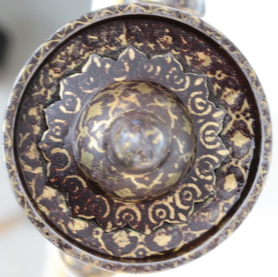

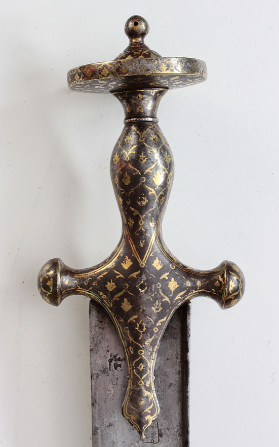

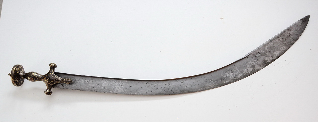

Some time ago there was a discussion about what a tegha looked like, besides from the ones with the very extreem blades.
The one showed below is a tegha. North Indian late 17th to early 18th century, and the floral decoration has a Mughal influence.
The blade is pattern welded, has a heavy 'T' spine, and is at the yelman 6 cm broad. The hilt is a tulwar hilt, and yet there are differences, as the disc is rather heavy and the ends of the quillons are more rounded than normal.
Total length 92 cm, length of blade 80 cm.

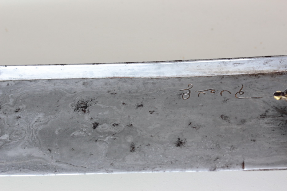

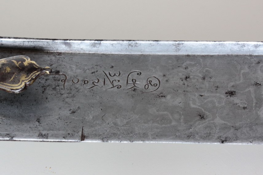

On each side of the blade there is an inscription. On one side it says 'Shri Wodeyar Krishna III', and on the other side 'Thega 16'. Notice the different way of spelling Tegha.
Wodeyar Krishna III was placed on the throne after the death of Tipu Sultan, beinf of the ruling family from before Haider Ali and his son Tipu Sultan took power. I am sure the British had learned the lesson, and removed a big part of the weapons from Tipu Sultand armouties before they let Krishna onto the throne.
It is likely that the tegha was in the Mysore armoury before before Krishna got to the throne, if not he must have boght it, but it is known, that he marked the weapons in his armoury with his name and the name of the weapon.
Does anyone have a sword with a hilt like this one?
Jens

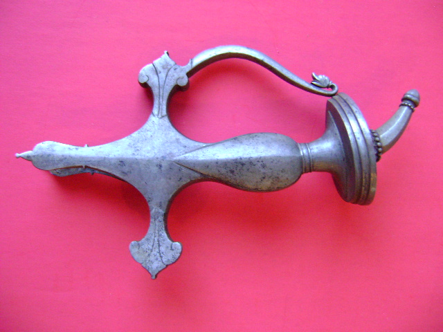

I have a somewhat similar handle: massive disk and quillons. The latter have a Deccani/Persian configuration.
The axis of the handle is a bit aslant of the axis of the blade: AFAIK a South Indian feature.

Canted pommel disc or hilt a South Indian feature? I hadn't particularly noticed that in S. Indian swords, which typically did not utilize the 'tulwar' or Indo-Persian hilt had this characteristic. It does seem that the canted hilt did often occur in certain Caucasian and Tatar sabres, like the 'Mingrelian' shashka and the ordynka. Seems quite unique for this type sword so it would interesting to see other tulwar hilts using the feature in addition to these.
Extremely interesting to see the 'thega 16' inscription also. Would this be an identification and arsenal entry number?

Nice hilt Ariel, but not quite what I was looking for.

Very nice Tegha, Jens! I absolutely like it but been thinking of the inscription is not authentic? it looks fresh to me.
Old 22nd January 2013, 11:00 AM   #6
Lew
Lew's Avatar
Location: East Coast USA
Posts: 3,191
Lotfi
The inscription is smooth and flowing and exhibits a high degree of skill it shows the the proper oxidation within the letters. When compared to the dot matrix lettering often seen on weapons from the Bikaner armory. As Jens stated these swords would have these markings applied and be sent back into the stock so I see no reason to suspect that they are recently applied. In fact I'm sure that this flowery style of script is not even used any more.
Jens
Sorry, that's the best I had to add: the massive disk :-)

Gorgeous piece...thanks for posting.
I am most fascinated by the very word 'Thega' being chiseled on the blade.

Lotfi, the inscription is very clear, but you must not forget thet you see a picture, and I have studied the sword closely.
To this comes, that most of the swords in the armoury of Wodeyar Krishna III, likely never left the armoury till they were sold. An armoury consisted of weapons for use and replacements, but if some of the replacements were never needed, they would stay in the armoury.

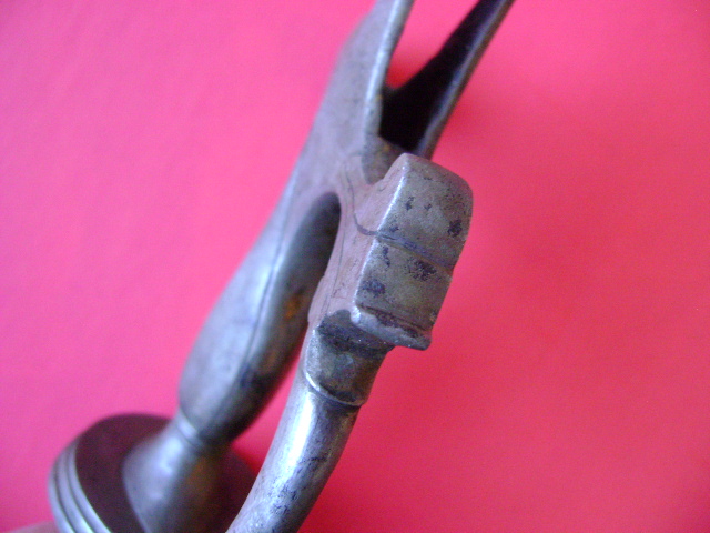

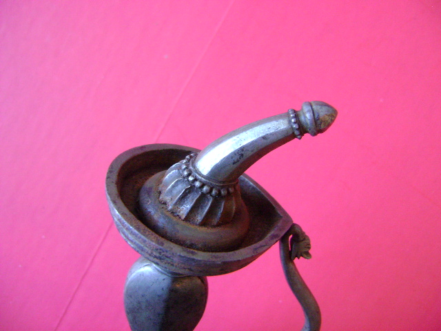

Jens
Jens,
I have swords here with some similar aspects but not all aspects in the one hilt.
One has a very similar squared off disc pommel and some untranslated script to the quillon block. A very strong and bold hilt type with an Indian made pattern welded blade of near exact 1796 light cavalry profile and dimensions.
Another has the very similar fine quillon ends with the more globular profile rather than the typical hemisphere.
This hilt with the finer globular quillon ends shared a similar refined slender shape but is distinctly different.
Gavin
