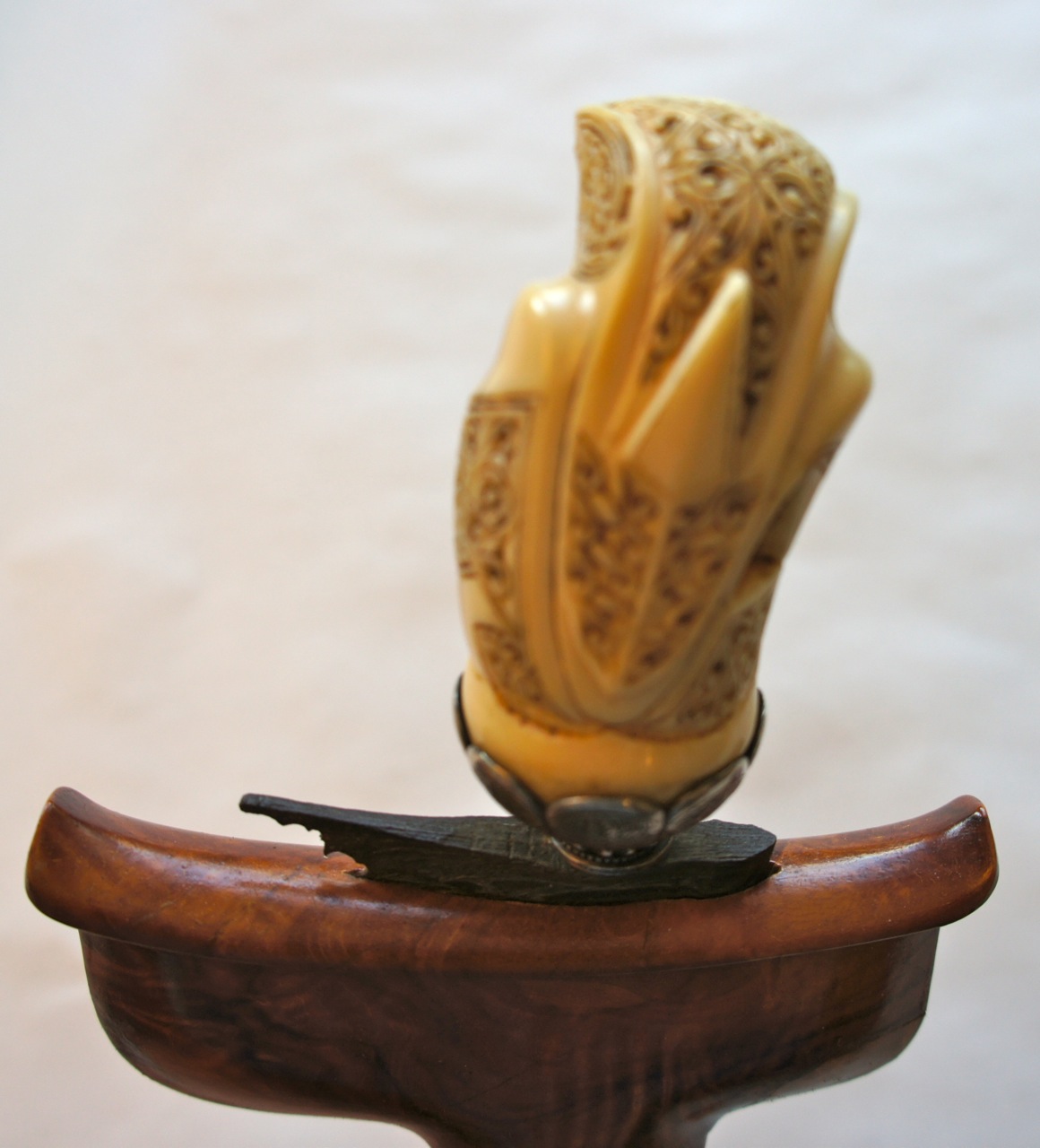

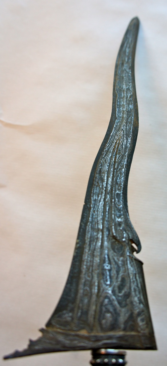

Here is a keris were the seller and I don't agree on the possible origin.
I would appreciate your comments and ideas on this one too.

Hello Michael,

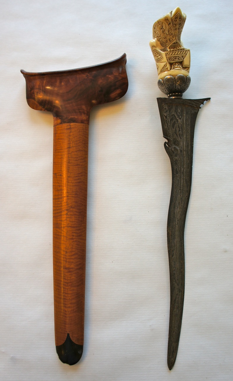

beautiful keris although I don't think that the blade is original to the sheath IMHO. But in my humble opinion all look very Peninsula to my eyes, special hilt, pendokok and sheath. By the blade I am unsure.

Hi Michael,

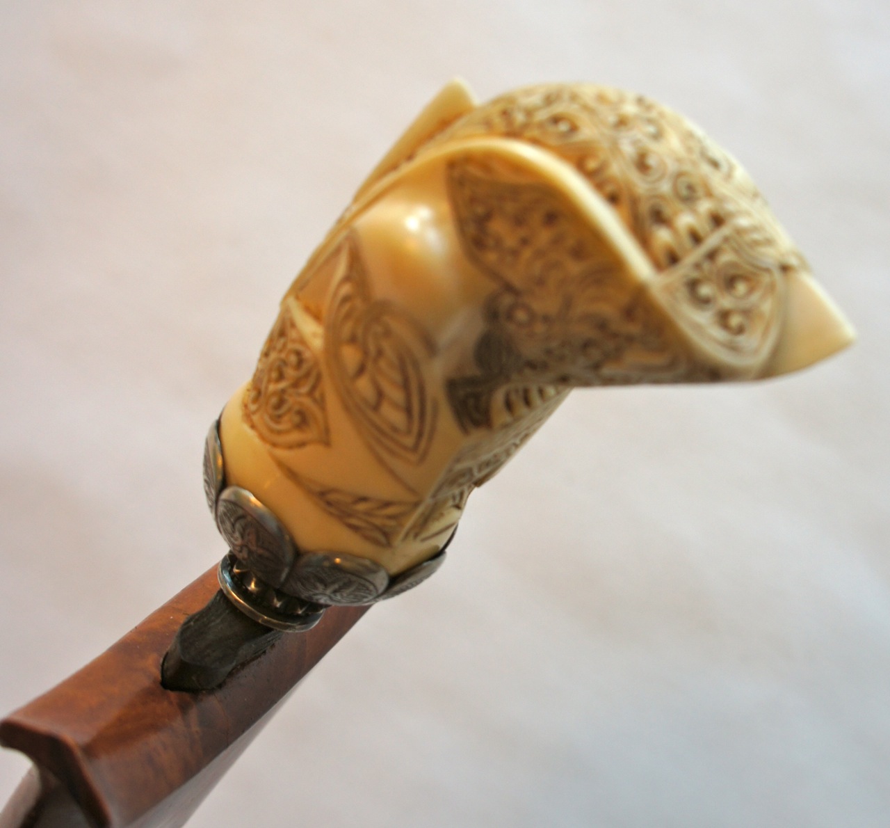

Imho, the hilt, hilt cup and sheath are Peninsular made, probably Kelantan. The blade, I'm not sure. During my last visit to Kelantan, months ago, I've seen newer blades in this form. The hilt, emulating Palembang style but probably made in Malaysia. Seen quite a few, in private collections made by local craftsmen, old and new..

It's a N Malay interpretation of a Sumatran keris. Nice catch, Michael.

Thanks all so far,
Then I was wrong because I thought the hilt was a poorly made (in) Palembang.
The blade seems a bit tricky?

Michael, even out of focus i am having a hard time accepting your hilt as "poorly made"...
Old 19th June 2011, 07:02 PM   #7
Posts: 9,664
Agree with David! When you don't like the hilt send it to me Michael!!

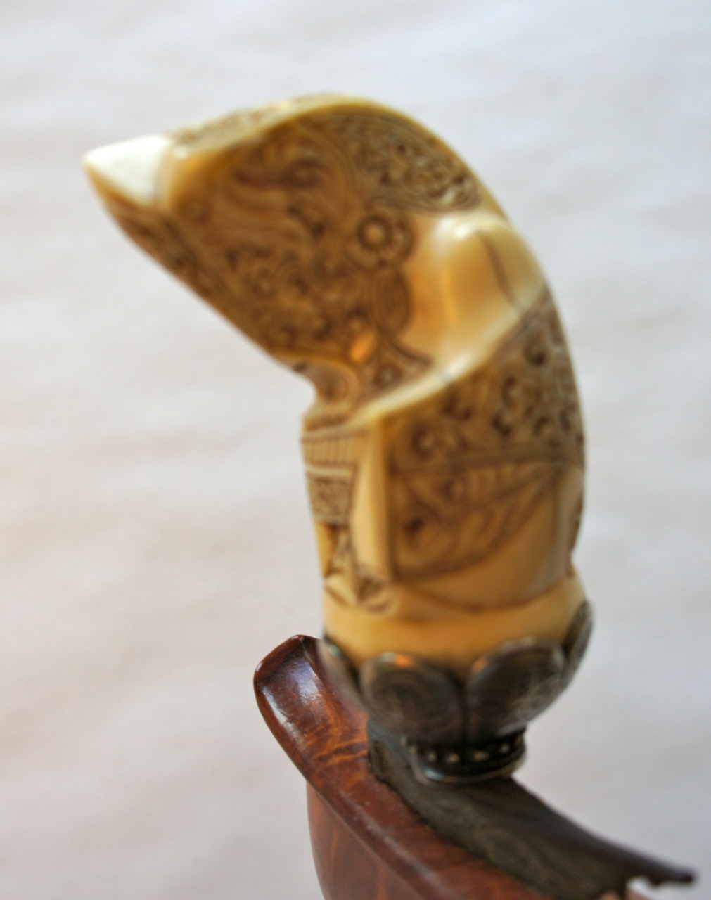

I think it's hippo ivory, can you confirm this?

All very very nice. The blade is :
I am with David and Detlef.
Of course there are Palembang hilts that are carved much finer. But This hilt is very nice and it fits the ensemble quite well.
Love the pendokok.

Kelantan or Terengganu dating to around 1920 - 1940. There was a craze in those days for innovation and hybrid styles abound. The Palembang style seems to have been particularly influential. The 'air-tangan' of the piece though is unmistakably Peninsular - so is the sheath, which is the debek style and very Kelantanese. In these days smallish keris for "formal" attire were popular and even today in Kota Bahru they call them keris selit because the fit just nicely into the waist of your sarong.
Super nice piece and absolutely all original. Another nice catch Michael...

Hello Dave,

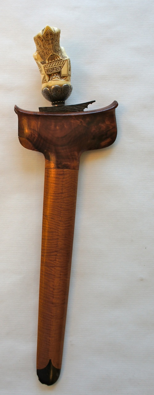

is it normal that the blade stick out so much from the sarung?

I'm not sure that the scabbard is original to the blade......

W, D&D, I just ment that it wasn't the same quality of carving as those found in Palembang. So I will keep it some more.
Thanks Dave for the additional information.
Do you have any ideas about the blade?

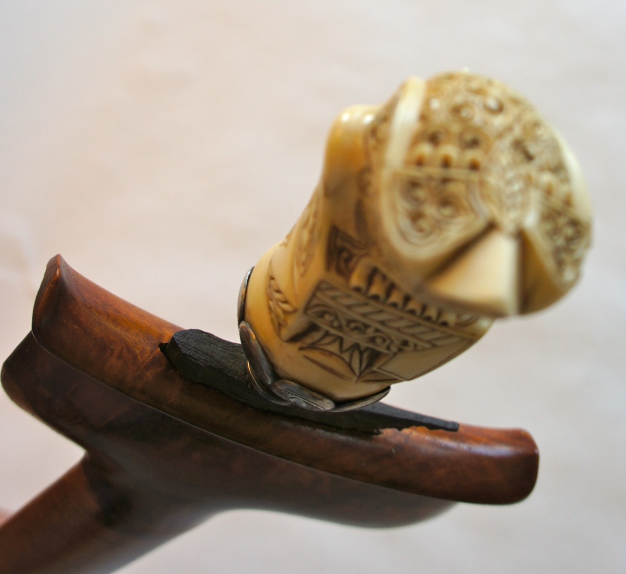

I agree that it is suspicious that the ganja doesn't fit at all the scabbard.

I have an impression, the 20 cent. Peninsular keris have the gonjo more often completely out of sampir, it seems to be almost like a sort of proud extravagance.
The ensemble looks genuine to me.

Well from the pictures at least the fit looks more or less good although a bit loose. Its possible there's a bit of crud down in the bottom of the batang that's keeping it from setting down quite perfectly. Might be worth a little bit of digging if you have the right tools for the job. could also just be shrinkage/warping. Again if you have a tool that will serve you might be able to get it to set down just a bit more nicely...
The blade is clearly late-ish and not quite as refined as they were in the heyday of the mid-late 19th c but its consistent with N.E. Peninsular work of the period.

Yes, it's quite usual with the blade sitting higher on Sumatran and Peninsular Malay blades. But if you look from the top the ganja isn't even close to fit.
Usually it's more that the scabbards are a bit tight or maybe have shrunk in Europe.
Well, I like it anyway and thanks for the additional information on the blade.

The custom of sitting a blade high in the scabbard is not confined to Peninsula blades, it was also practiced in old Balinese dress, and there seems to be some indication that it may also have been practiced in early Jawa.
However, in all examples I have seen, no matter where from, the line of the top of the gonjo parallels the line of the top of the scabbard, and it is only the gonjo, or even part of the gonjo that stands proud.
If this scabbard was indeed made for this blade, I am inclined to Dave Henckel's view, that proper entry of the blade could be being hindered by an obstruction in the gandar.
