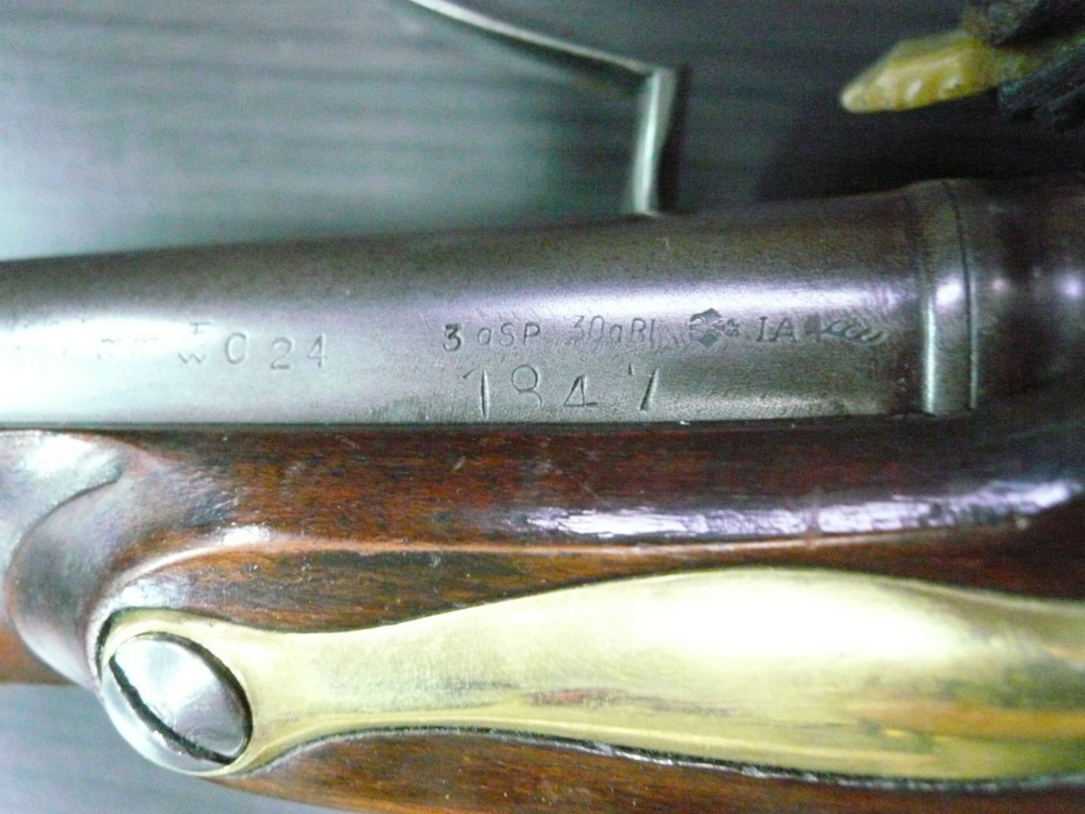

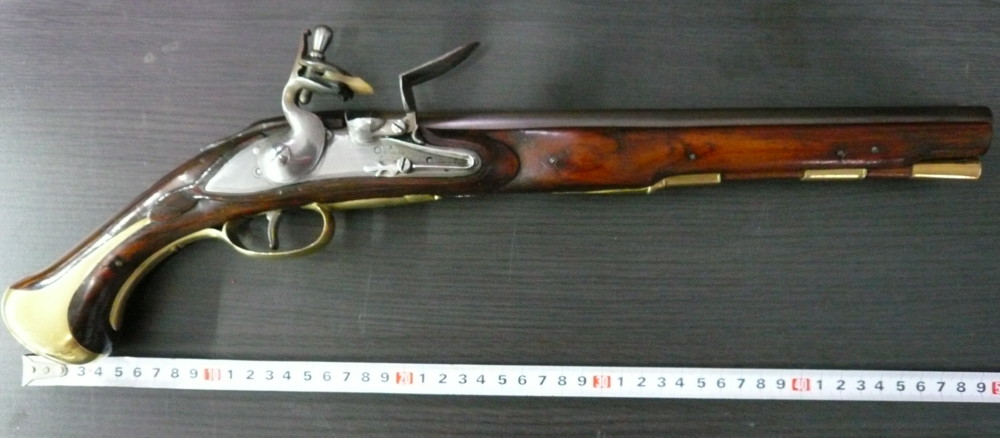

Hi everyone
I bought recently this pistol and I want your opinion if it is an antique one or a copy.
It has marks on it 1847 St Etienn.At all parts there are marks "MM" even at the screws.
Thanks a lot.

Something worth to analize.
The lock 'might' be French, but the barrel has marks from the Ulm proof house in Germany.

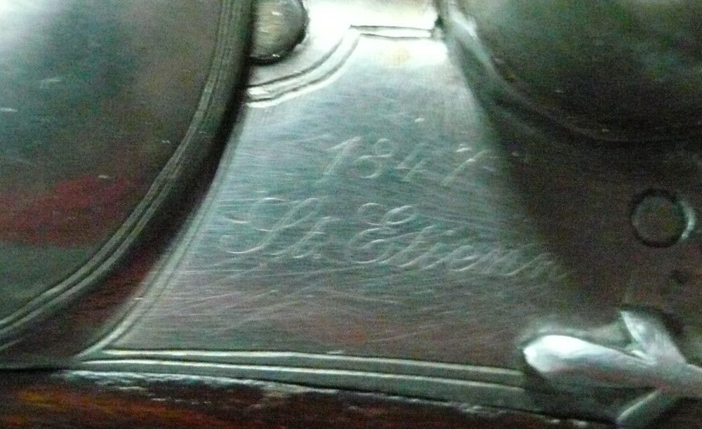

Does the lock reads Etienn instead of Etienne ?. That is very strange
Some other member will comment further?
Fernando

libra
Join Date: Jan 2009
Location: GREECE Patras
Posts: 40
Hi Fernando.
Thanks a lot for the information about the barrel.
The lock writting is St Etienne but the ''e'' is not visible at the picture that I have provide.
Does this change something?Is the pistol antique or not?

Judging by the pictures, the stock has a decent look.
But it is highly improbable that the flintlock system was still being made in 1847. This type of pistol was active some eighty years before this date.

It cannot be denied this is a very handsome pistol, and with my limited knowledge of guns, I can only note that the St. Etienn inscribed on the lock with date above seems odd. The inscribed 'date' , then the stamped 'date' on the barrel with misaligned numbers seems incongruent.

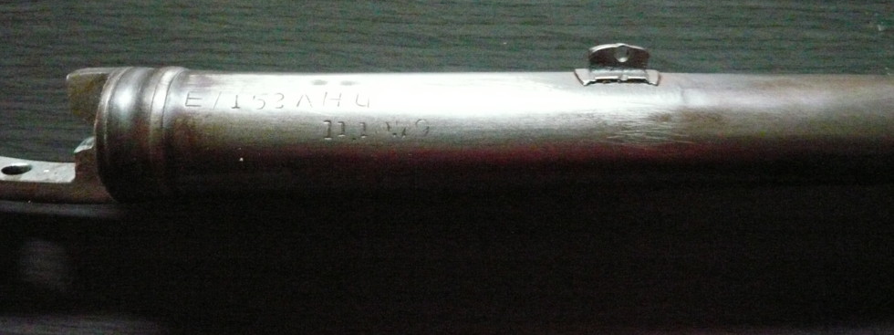

The proof marks in my opinion are definately NOT Belgian or French. I believe that the Eagle over the letters SP is the German Black Powder Proof mark used from 1951 onwards. The mark to the extreme right looks remarkably like the ULM Proofhouse mark (an antler) used from the same date. If some other Member has the History of Proof Marks by Mr Lee Kennett, they might like to confirm my thinking. So.................what do we think now about age?
Regards Stu

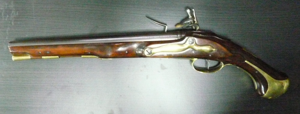

The previous posts about the barrel proof-marks rule out French origin of that component, and with my copy of Jean Boudriot, ARMES A FEU FRANCAISES: MODELES REGLEMENTAIRES (Paris, 1981) in front of me, I'd like to add the following observations:
1. None of the regulation-pattern French military pistols of the pre-Franco-Prussian War era are stocked-up like this example. Note the bulbous brass buttcap with the slender extended langets or tangs on each side, a feature seen on none of the French models.
2. France officially switched to the percussion system in 1822, and the divers models of handguns and shoulder-fired weapons (fusils & mousquetons) were standardized mechanically into a unified "system" common to all. The System of 1822 was based on PERCUSSION locks of very similar design (albeit in different sizes for pistols and long-guns), which started out as conversions of the earlier flint locks, although later production runs used entirely new parts. Pistols in the System of 1822 comprised 3 basic configurations, those issued to the cavalry, the gendarmerie, and to all officers. The first two guns, which were issued up to the 1850s or so, had butts of "bird beak" shape, the metal caps having a single dorsal tang, not two lateral ones. The officers model had a simple "dome" buttcap.
3. The next major system to be adopted was that of 1842, and it included one pistol, the gendarme's model of 1842 which like the long guns had a "back-action" percussion lock (i.e. with the internal mainspring located BEHIND the hammer rather than in front as in the previous, flintlock-derived percussion conversions). There was also an officer's pistol, Mod. 1833, which was not associated with a full system, but again that had a back-action percussion lock and furniture clearly derived from civilian handguns.

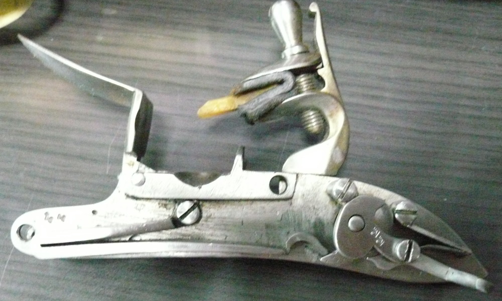

4. The internal parts of the lock on the gun posted here are not identical to the workings of the System 1822 converted flintlocks (the conversion did not require changing anything inside the lockplate), and the quality of fit is noticeably inferior to the original French manufacture.
The gun that is posted on this thread looks to be an export model, manufactured long after the fact to be sold inexpensively, or traded for local commodities, by Europeans in Africa and parts of Asia and Latin America. Many of these were styled after well-known European military arms, which were themselves exported worldwide after they became obsolete at home, and the St. Etienne markings were undoubtedly put on to enhance the gun's marketability. Gun factories in Liege, Belgium, made boatloads of these weapons into the early 20th cent., although there was some manufacture in Britain and other European countries as well. The Belgian guns are a bit short on good looks but are sturdy and reliable; I've shot one or two in my time and they aren't at all bad.

Further to my comments re the proof marks, my suggestion is that this pistol is a modern made item for the blackpowder shooters, and possibly reenactment people. There are many types of old long guns, pistols and revolvers made specifically for this use by MANY makers.

Great contribution, Philip; thanks for sharing the knowledge.
I would support your reasoning on post #8, Stu.
Fernando

While in no way wishing to sound like a wet blanket, I have to wonder: is it possible that this is one of the much-dreaded "Khyber Pass Guns" manufactured in North Pakistan/South Afghanistan? From the pics the quality of the finish looks good - what I've read on the subject leads me to expect a fairly dodgy finish from a lot of these pieces, including the inclusions of a fair tonnage of black-brown filling material - but the mixture of dates, proof marks et al makes me think somewhat along those lines. Stylistically, in fact, I'd suggest (and expect to be corrected having done so by the experts hereabouts) that it bears quite a striking resemblance to the British Heavy Dragoon pistol of the mid-18th century (see http://www.firearmscollector.com/ima...0110%20018.jpg for instance). Anyway, just the twopenn'orth of a newbie.
