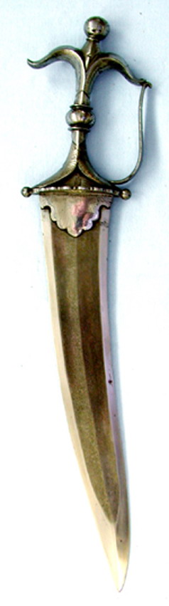

Here is a picture of Anup Singhji - should you be interested.

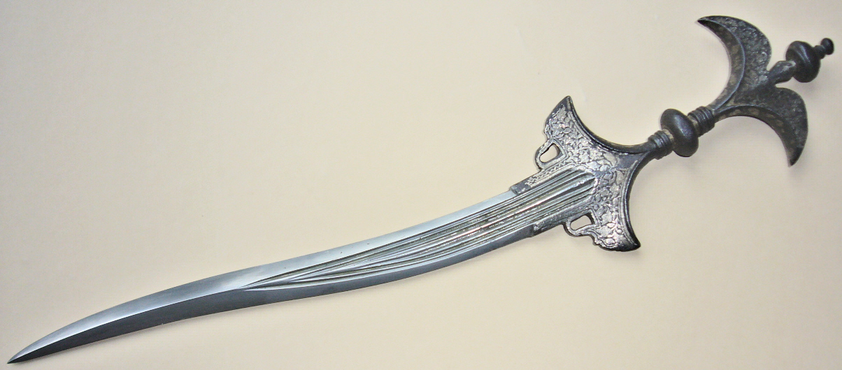

Default Some species
Hi Mahratt ,
Some species from my collection.
Kurt

Thanks of Kurt! They - are fine! Very much it are pleasant to me. I while have one more cillanum. I necessarily will show its photo.

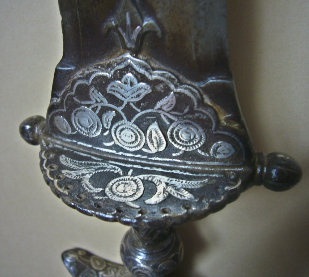

Length the general - 40 sm, length of a blade - 27,5 sm

Default Nr. 1
Hi Jens,
beginning with No. 1
I suspect Deccan in 1600???
Inserted handle iron with silver.
Heavy blade wootz.
Total length 41 cm.
Blade 28.5 cm.
Weight 648 grams
Kurt

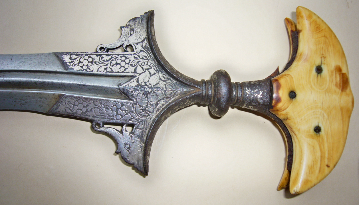

Default Pic 2
Here are two more photos !
Kurt

Hi Kurt,
Great picture, and a very nice chilanum, and thank you for commenting.
I agree with you in your comments, but I doubt that it is from the beginning of 1600. Anyway it is old and very nice.
Jens

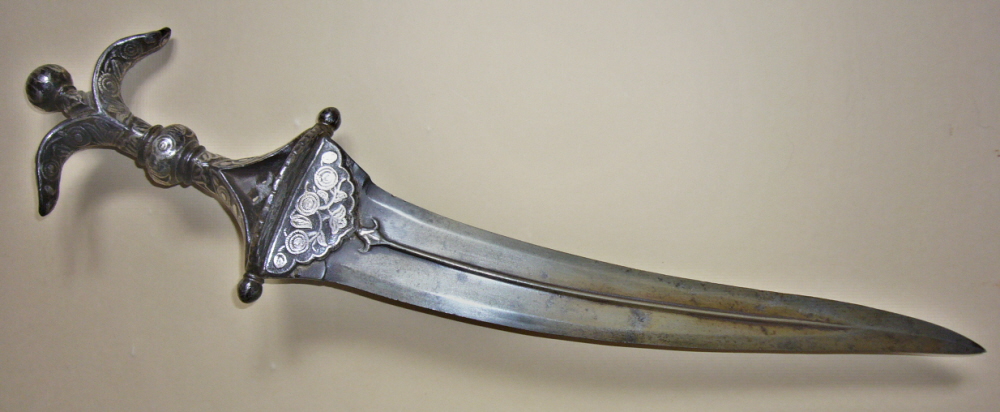

Default Nr. 2
Hi Jens,
Here is No. 2
Suspect 17th century.
Can you tell me from which Indian area?
Made from one piece of steel.
No wootz.
Total length 41 cm.
Blade 32 cm.
Weight 395 grams
Kurt

Hi Kurt,
Once again excellent pictures, of a very nice dagger. 17th century sounds like a safe guess, and it is from Deccan – but you knew that already, didn’t you?

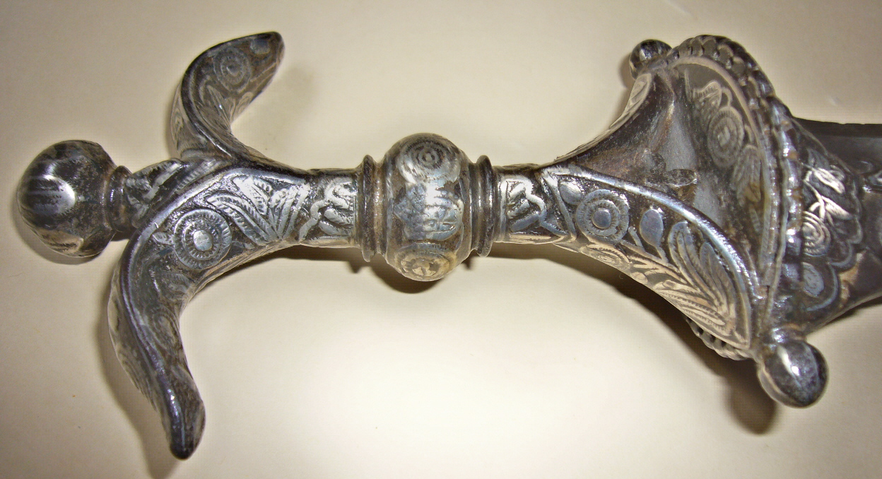

Default Nr.3
Hi Jens,
Here is No. 3
Also 17th century ?
Suspect Deccan
No wootz.
Total length 38 cm.
Blade 28,5 cm.
Weight 310 grams
Kurt

Hi Kurt,
Yes, 17th or early 18th century, and I agree with Deccan.
Again very nice pictures. Did you clean the daggers yourself, or were they cleaned when you got them?
