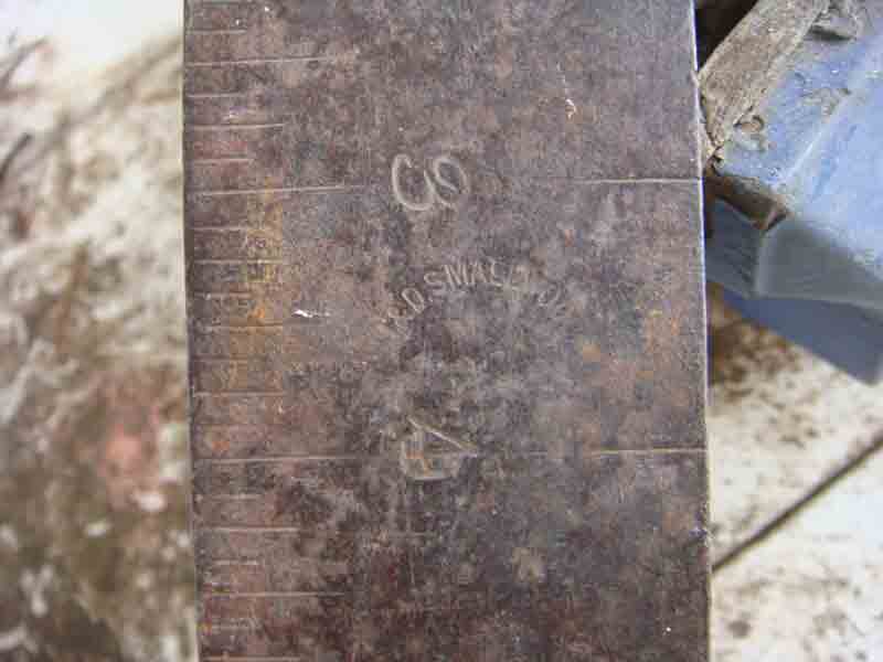

Has anyone here tried sand blasting a heavily rusted sword? I have a few projects which are heavily corroded which I would like to try it on. I have in the past tried the usual iron wool, oil and time, but, I find that it doesn't get the oxide out of the pits and grooves which could be hiding markings.
I will show a trial run I made on a old rusty square. It seems to work fairly quick. I would appreciate any tips and/or advice.
Thanks Jeff

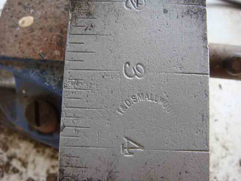

I used 30-60 crushed glass on the square above, and I think it is too aggressive to use on a sword. I will experiment with the glass beads next. In this thread ( http://www.vikingsword.com/vb/showth...t=sandblasting ) it was suggested to use coal slag 'black beauty', wouldn't that be more aggressive than crushed glass? Has any one used it?
Atlantia, the appearance is very similar to a vinegar etch, with a flat dull grey appearance to the metal. I think that is more a result on the oxidation below the original rust in this case? You are also right that the result took only a few seconds and is actually more controllable than a vinegar etch.
