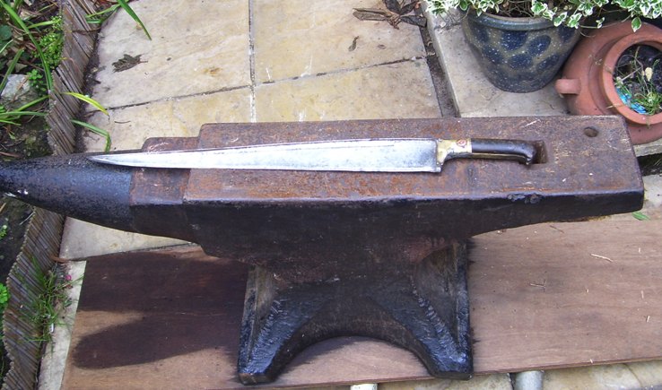

Hope you don't mind me posting this....but I am very excited about it When I first joined the forum, I mentioned that I would like to learn bladesmithing.....'hands on' knowledge in blade manufacture can only increase my overall knowledge.
The item is pointed and made of metal and if you have ever watched 'Wile E Coyote' trying in vain to squash the 'Roadrunner' with one of these....you will know, it can be loosely described as a weapon

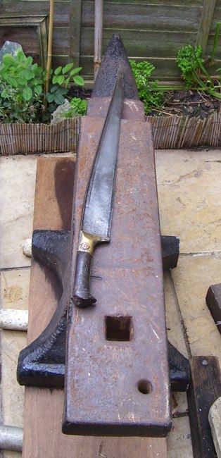

The Anvil is HUGE 40" from the point of the 'beak' to the opposite end. Ideal area for blades. I am incredibly lucky to have obtained this, likely very old (could be earlier than 19th C) and very unusual because of its size.
All comments or advice will be very welcome
Regards David

Fantastic.
remember how people used to make their own brickwork BBQs? Nice one of those with careful ventilation would produce plenty enough heat to get a sword bar hot enough to work.
Probobly have to use heatproof bricks as you're gonna use it regularly.
Use an old wrought iron grate out of a coal fire (set in of course).
boot sales are a great source of BIG old hammers of various sizes.
Of course the neighbours will love you!

Looks like you scored well here.
Best anvil I ever used was one at Hawkesbury Agricultural College, when I was being taught by Gordon Blackwell. Beautiful old English one, 350pounds, and had almost no work since the day it had been made.
You get a good big anvil, it does half the work for you.
My own anvil is only 75 kilos, and made in Singapore. Not much of an anvil, but it does the job. I've got another little no-name anvil that I've had the work table precision ground on, that I can use for getting blades really true.

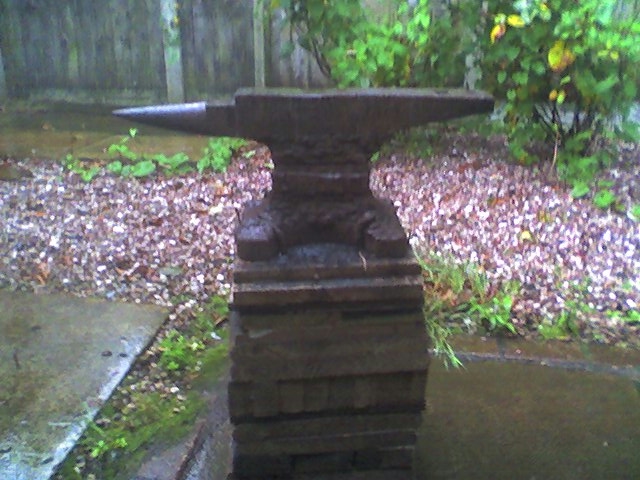

How do you intend to mount this anvil? Might be a bit difficult to get a big enough hardwood stump. The stump needs to support the full base, and should go about 3 feet into the ground. You set the anvil height so that when you stand beside it with a clenched fist, your knuckles just brush the work table.
The whole thing needs to be square, and the horn goes to your left.
Anyway, nice anvil.

Thank you all for your comments.
Atlantia, the ancient technological 'rollers' work a treat

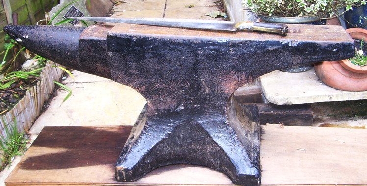

This 'beasty' was down in a household cellar....and was a logistic nightmare to get out, a 'counter balanced hoist', make-shift supports and alot of grunting ...eventually 'eased' the anvil through a small window
Ah, the neighbours, fortunately they are used to my 'eccentricities'....but I will have to 'limit' the noise pollution : ....well I'll try Apparently attaching large magnets (either end) and placing heavy chain around its 'waist' helps to greatly reduce vibration.
My forge is 'under construction', I'm using a cast iron BBQ which I will line with refractory, a steel pipe will be fitted (drilled) to direct air. I have already got a little compressor to provide the 'blow'. I have already started to search 'boot fairs' and already have a number of hammers, files etc (all dirt cheap )
Hi A G Maisey,
this anvil is around 250kgs ( 519 lbs) in weight the largest I have found in this pattern, so far, is actually smaller than mine.
The anvil's manufacturer is 'Peter Wright' , so the anvil is circa 1860....I do not know when they ceased trading. It also seems that 'Peter Wright' produced quality anvils that are still covetted today. (I found a web site dated 2003 that was offering a 350lbs version for $1400 ) It has a lovely 'ring' and rebound. I was going to mount it on railway sleepers. I dont think I will be able to sink the base 3 foot though, I think it will be a case of trail and error getting the platform and sound deadening 'measures' sorted. Have you ever posted any of your work ? I would love to see a few pictures

If you cannot get it properly mounted on a stump, you might like to consider sitting it in a bed of sand. I've never used this, but I know people who have, and they reckon it cuts noise down pretty well. A properly mounted anvil---on a stump--- really doesn't create much noise at all.Think about it:- what you are hitting is material that is already soft because its been in the fire, its not like you're actually hitting the anvil. When you're working at black heat there might be a bit of noise, but its not really excessive. You're going to be using 2lb and 4lb hammers mostly, and if you have a striker, maybe a 10 or 12 lb hammer, and you're using them on a big anvil. That's a lot different to using an oliver or a power hammer.Put it this way:- your blower will probably make more noise, and whatever you do, it won't be as bad as one of those blower things people use to clean up leaves.

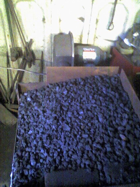

David, I've used coal that I coked myself, manufactured coke, charcoal, and gas. I've also used an oxy torch as a heat source for forging, and propane and oxy blown into a brick enclosure as a heat source for forging.
I like coke the best because I find it the easiest to work with.
Gas is very, very easy. Welding in a gas forge is like making a cake, but easier. Anybody can weld in gas. However, I personally do not like gas, and I have never been able to heat treat successfully with gas. Coke is very easy to heat treat with.
In my opinion the best set up is to have a gas forge to weld with, and a coke forge for all other work.
Thank you very much for the advice Alan, I think that is a good compromise between 'traditional' and 'practical'
