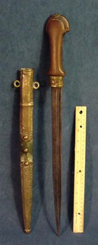

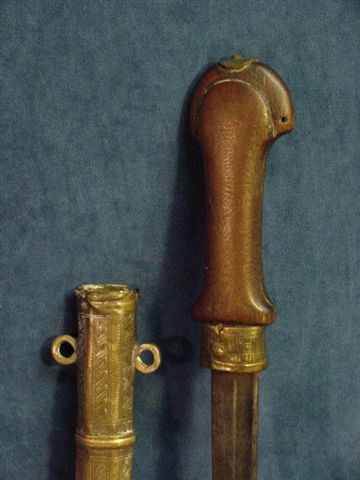

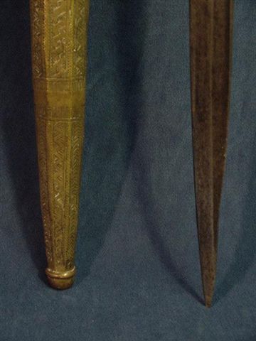

This puppy just went on eBay: http://cgi.ebay.ca/ws/eBayISAPI.dll?...MEWA:IT&ih=022
Nice Moroccan genoui, the seller said the hilt was wooded, but the orange-skin look of it makes me think it's rhino horn.
Comments?

Yup, seems like Artzi is also betting on a horn hilt...

Here is another one of very similar form and materials.

Hi all, maybe I'm wrong but seems that the blade is a bayonet blade? Sorry for the stupid question

Bayonet, smallsword, sabre, most any blade from Europe I imagine. Since they were fitted with rhino horn, they must have been well thought of.
They make awesome-looking dagger I think

Very astute Flavio! and not in the least bit 'stupid' !!!
This probably is a bayonet blade, and these blades taken from the bayonets of colonial weapons quite typical on this form (genoui) as well as the s'boula which turns up as far as Zanzibar and Ethiopia referred to as a Zanzibar sword (see Burton). This is one of the reasons that references to many European and British regulation arms become closely associated to the study of ethnographic edged weapons.
The so called 'Berber' sabres, that attribution remaining somewhat in question, is typically mounted with blades from British M1796 light cavalry sabres with highly profiled tip.
Now the question would be, what type of bayonet? My guess would be 19th century French.....anybody got a bayonet book?

My bayonet books are at home and I am stuck at work on MLK day (sigh), so I am not sure what it is, but it does not look like a Chassepot or Gras bayonet, which is what I would have expected given the strong French presence in this part of the world from the mid 19th to the mid 20th centuries. It could be from the Berthier-Mannlicher rifle (M1892), as the blade is obviously straight with a single, wide fuller. It most certainly is not from the Spanish long M1893 Mauser bayonet.
Now, the question is, has the French Foreign Legion ever been armed with Berthier-Mannlicher rifles? If the answer is yes, then maybe we have identified the blades.

Since the term "genoui" is attributed to these daggers, would Italian blades be possible sources, or is the term just an anachronism from an older period when the Maghrib did trade with the Genoese?

As you noted and I completely agree with you, they can be from anything. The only requirement is that whatever was shortened, should have somehow made its way to the Maghreb.
Here is a picture of a Bertheir bayonet from Richard Abbenbroek's web site, where he has uploaded pictures of various bayonets from his collection. Look at the peculiar discontinuation in the fuller towards the base of the blade - it seems that the same feature is present on Charle's genoui, so his must be made from such a bayonet for sure.
Of course, other bayonets, and not only blades, were also used. I have a shula dagger with a scabbard mouth made from a bayonet scabbard.
Teodor

Very good suggestion Emanuel, and it is true that the Italian trade indeed did produce considerable influence from early times in the Maghreb and throughout the North African littoral. It seems that there have been strong suggestions that the distinctly shaped pommel of the koumiyya derives from the pommel shape of the Italian cinqueda. In those early times such weapons might have come from either Genoa or Venice, both city states who were fiercely competitive for trade.
I wonder if the possible reference to Genoa, might have been used in other weapons in Maghreb regions as well, much as Emanuel suggests in the same parlance as 'firangi' in India, loosely meaning 'foreign'.
I am inclined to think that Italian bayonets would likely not be included, at least from colonial presence in the Sahara, but since they were of course present in East Africa, the profound trade may account for some possibility.
We gotta get the bayonet books!

I agree with you completely that the Berthier bayonet could very likely be the source of the blade for this dagger. My remark was meant at the general use of imported blades.

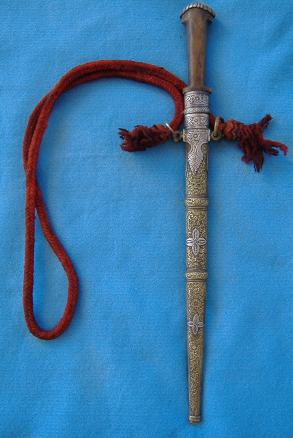

I still find it interesting that these blades were fitted with such a prestige material as rhino horn. I will try to find the other genoui I have seen, perhaps Moroccans appreciated the Berthier highly and saw it as a prestige blade as well...
