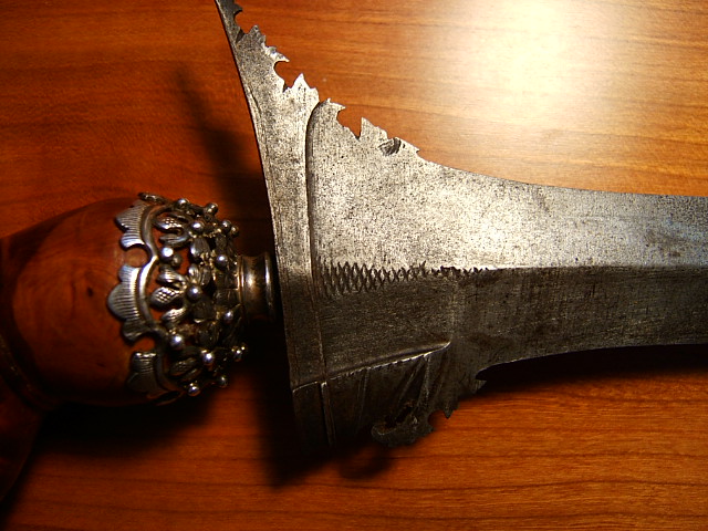

Hi All
I picked this keris up 4 or 5 yrs ago and thought it needed a revisiting
Lew

Lew,
Interesting blade. Looks like it's made from a file.
However, the blade is nicely shaped in the Northern Malaysia / Patani style.

Posts: 3,191
One theory is that the marks were made from a vise?
Interesting theory. Possible, but unlikely. Unless it is done before the ganja is inserted into the pesi (tang). The 'criss-cross' marks are only visible at the thickest section of the blade, which is about the thickness of a thick file. The 'kriss-cross' portion near the gandik, is less visible possibly due to the filework done while shaping the gandik area.
Alam Shah
If you look at the left side you will notice the marks appear at a high point just to the right of the Kembang kacang or Belalai Gajah. Do you think this was purposely done to provide a perch or a guide for proper for gripping the keris?
Lew

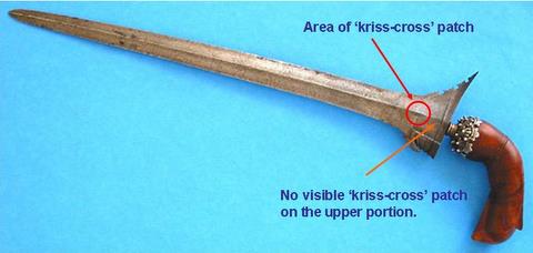

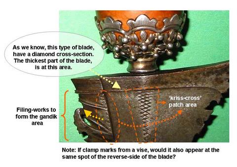

Lew,
Attached are your pictures with some illustrations to aid in our discussion.
(I hope you don't mind). Just to clear some doubts I'm having.
If you don't mind, could you post a picture from the top of the cross-section, with the hilt and hilt cup removed? By the way, what is the thickness at the
thickest part of the blade?

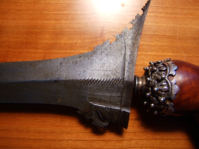

Posts: 3,191
Ther are marks on the other side of the blade I will take a shot of it when I get home tonight. Btw great graphic on the pics.

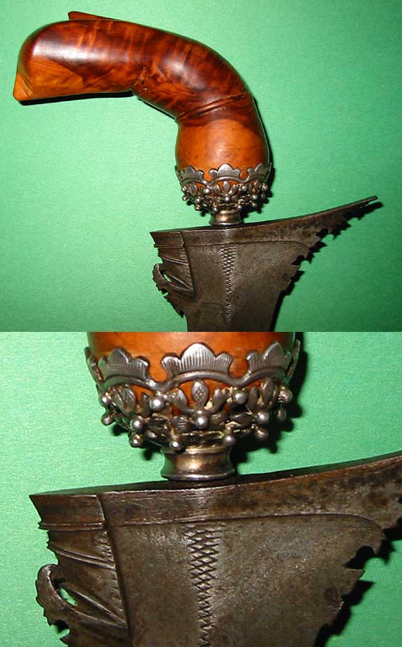

Posts: 3,191
closeups of both sides. Sorry Kai the hilt is on pretty tight so I am not going to chance damaging it by trying to remove it at this time.
Lew

Default More or less... a file beginning...
Lew,
Thanks for the clearer picture.
The blade's diamond cross-section should extend all the way to the base of the blade. In this example, it seems that the thickness is not enough to form the base properly, which is approximately 1/2" or 1.5cm (it does vary).
This is how the base should look like for this type of blade.

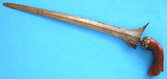

Congrats to Lew for having such a beautiful Keris pandai saras. I think this is a Pattani keris, judging from the hilt style and the greneng.
I think this is still a 'san-mai' construction keris, with the softer steel outer layers sandwiching a harder steel core. There is a difference in the surface condition (different extent of pitting) of the cutting edge and the central body.
The outer soft steel layer could have been made from a file, in my opinion, because of the cross-hatching on the central portion of the base, and on the high point of the gandik.

I took the blade out is some good light and there is a dark line an 1/8 th of an inch wide running down the the length of the blade's edge so this is similar to san mai sorry but I can only see this when the blade is at a certain angle it will be very hard to capture it in a photo. So if this is san mai the use of a file as an outer skin is unlikely files were fully hardened in the 19th and early 20th century so I still think this was squished in a vise at some time. Btw where the diamond cross section ends is higher and thicker than where you see the cross hatch marks so I think that kills the file not being thick enough theory. So vise marks is now the most likely culprit
Lew
