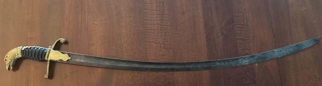

Default Large Eagle Head Sword for ID
A friend just took this on trade yesterday. I was going to see another eagle head sword but he traded it. I had to buy it. Would it be English made for US market? I believe it is circa 1815. Has maker/ distributors name lightly stamped on top edge of blade. Anyone know who it is? He thought it was naval because of shell on cross guard and gold coloring but I told him not necessarily.Any help would be appreciated.
Thanks in advance,
Terry

I'm sorry. Blade is approx. 31inches long with one fuller and straight. Pretty heavy. Bone handle

I was hoping maybe Glen C would come in on this, and don't have all my stuff on American swords handy. From what I see it does seem like a British made sword (the name on the blade may be Wooley) and the time frame right, Federal period c.1815. The 'shell' on the guard unusual but could be naval I suppose, I was thinking more acanthus leaf. The leaves on the heater type shield langet would seem to have fouled anchor if naval.
The wire wrapped bone grip interesting, and the type eagle head seems to resemble Widmann (Philadelphia) style.
It does not seem American eagle heads usually have the guard terminal in beak.
Hope I can find more or Glen shows up.

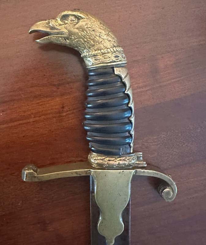

Here are a few other pics.

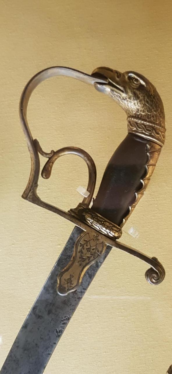

Sorry to be so absent. I have been in the process of moving and have limited access at this point. I could make more excuses like my books are packed up but I don't quickly recognize this bird.. Would it be possible to get a straight on profile shot from both sides in natural light (no flash)?
It would not be Widmann for a couple of reasons. Widmann imported both entire swords and blades from Solingen. Secondly, Woolley predates Widmanns work. It does look a bit like one of the Baltimore birds and would maybe show in the back of Peterson, the Lattimer books or the Medicus collection but I haven't unpacked (literally haven't set up shelving). No crest and huge beak, hmmmm, why am I thinking of a particular Baltimore again but those have a prominent crest.

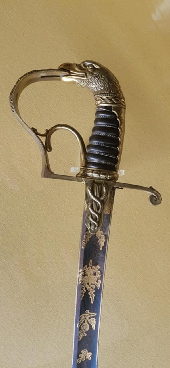

There is something weird about this whole sword but it is probably the lighting. It is possibly an Emmor T Weaver of Philadelphia, let me find a file I have. That would fit with the timeline. Yup, Emmor T Weaver type. Is there an ET stamped on the guard (mebbe not even if him)? The Woolley blade now makes sense of a whole different ball of wax regarding northeastern seaboard cutlers and possible post war surplus blades. Big hmmmm. The E. Andrew Mowbray old testament for the early eagles discusses Weaver, even Peterson has some thoughts in his book. My mind is a bit mush these days but as often as I am wrong, this time I think I am right. The small langets would lead to one thinking post 1821 fashion but then we have the Woolley blade. Looks like refined cast steel as well.

Posts: 555
Good points Eric and in looking at the sword more, the ferrule is what we see on some German swords but then the quillion not unlike Weaver's art in the snake scabbard drag. The scabbard on the lead/object sword looks like a re-fit and not original to the sword.

I have looked in the Medicus book and didn't see it. However I've missed stuff before. I'm sure that the scabbard is a replacement. I do not see any ET anywhere on it. Here are some more pictures. If not good enough please let me know.
Terry

Posts: 86
more

When sprinting for eagle heads Glen can be most difficult to keep up with, however; if you do not run you do not get faster. In Mowbray's The American Eagle Pommel Sword there are 2 types displayed and reviewed but photos of three different types shown. The third style very similar to Terry's sword less the extra long beak and unusual attachment of knuckle bow to beak. German style ferrule and Emmor purchased blades and parts from S&K. The hunting sword dog head quillion used extensively by Solingen, interestingly also elongated. What does not fit unless entirely made by German firm is the over all excellent quality of manufacture. Emmor made nice swords but they still look American made. The flared counter guard almost like a transitional slot hilts also unusual. Eric

See the very nice eagle bought for or by a Scottish officer in Mowbray's book
There is more than one spelling for Wooley
One thing that had caught me about the subject sword was the chasing around the eyes.
In this case the balls are for an artillery oficer and seen with other later birds but not attached at the knuckle bow. Many of the Later Spies types gulp the guard.
Speaking of Solomon Jackson and balls below. Also a Spies clone with a ball.

Of course, in pursuit of something else, I find myself here and now need to add some Portugeuse swords that have been brought to my attention. About Terry's sword, I'm noticing something else that sticks out to me. The ferrule, although upside down, puts it after the 1818ish point
