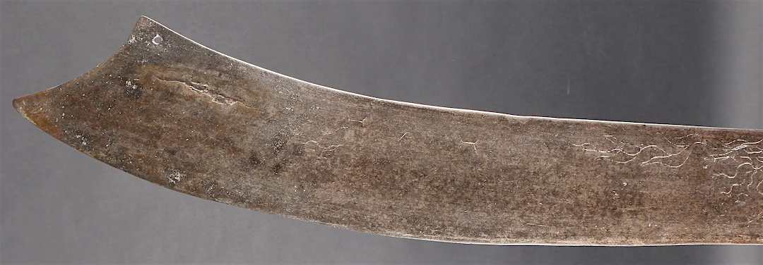

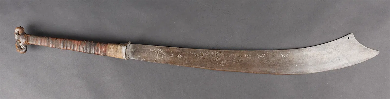

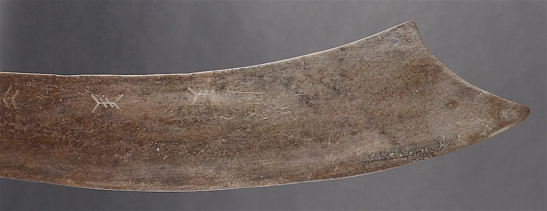

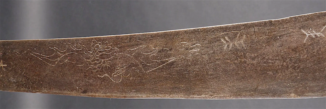

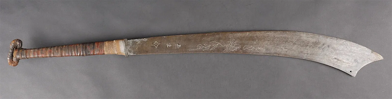

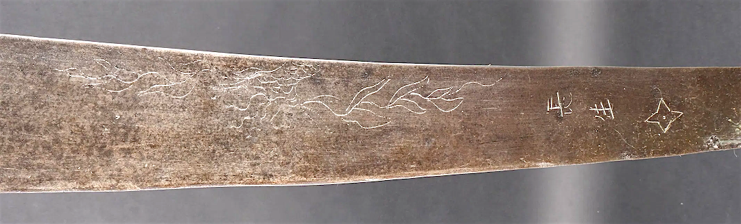

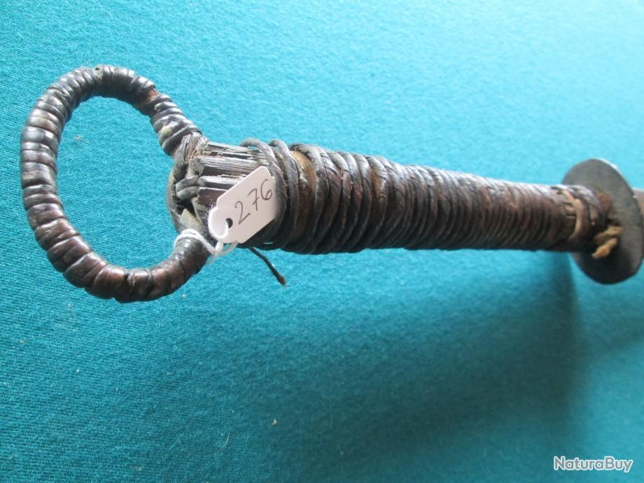

I got an excited message from a young collector friend last night that he had won a dadao on an online Belgian auction. It was a bringback by a Belgian military officer from the time of the Korean War when the UN sent forces to S. Korea to repel the invasion from N. Korea and then a subsequent wave of Chinese military action. He thought this dadao was more likely Korean than Chinese. I was inclined to agree with him, but am no expert on Korean edged weapons, and direct Chinese involvement in the second half of the conflict is well known. All we have at this time are the auction pictures which are reasonable quality.

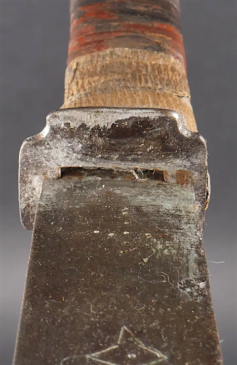

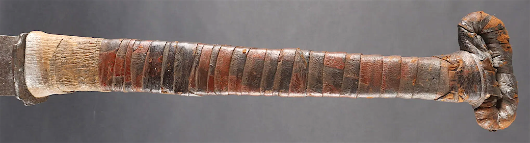

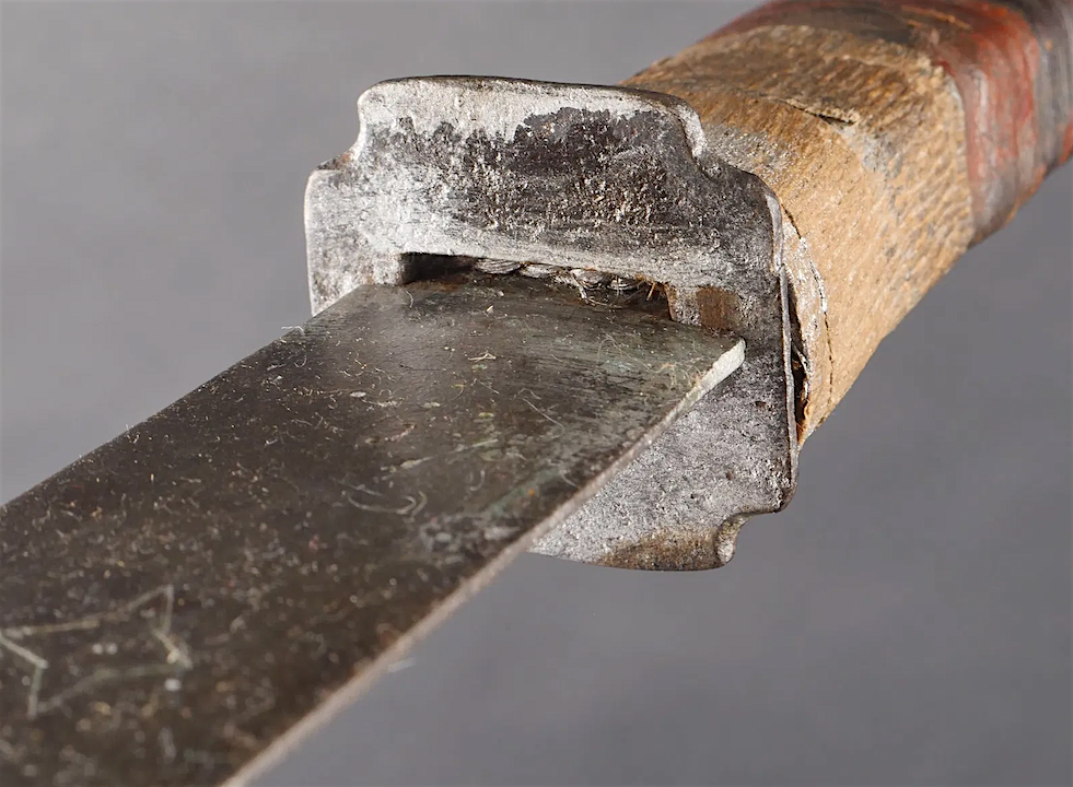

The blade is 58 cm in length and has numerous markings--none of which look especially Chinese to me. The hilt is rectangular in cross section and wrapped with leather strips, plus an "Elastoplast" repair adjacent to a small rectangular brass guard. The pommel is a flattened ovoid ring, also wrapped with leather strips.
Overall length 84.5 cm.
Thoughts and opinions welcome. My friend is very pleased with himself because he paid less than 100 Euros for the sword!

From northern Vietnam... Somebody has crushed the ring pommel

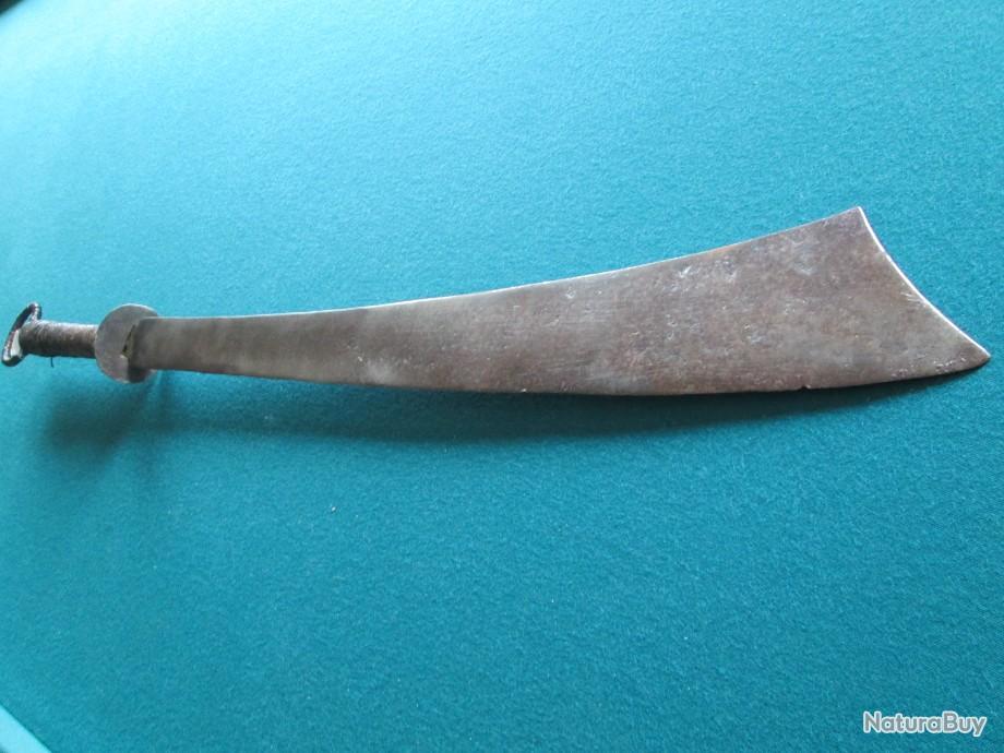

Yes, I would also say Trường đao from Vietnam. My own example below (awkward angle because these were the seller's pics but it's currently too dark here to take better pictures).
Absolute monster of a sword.

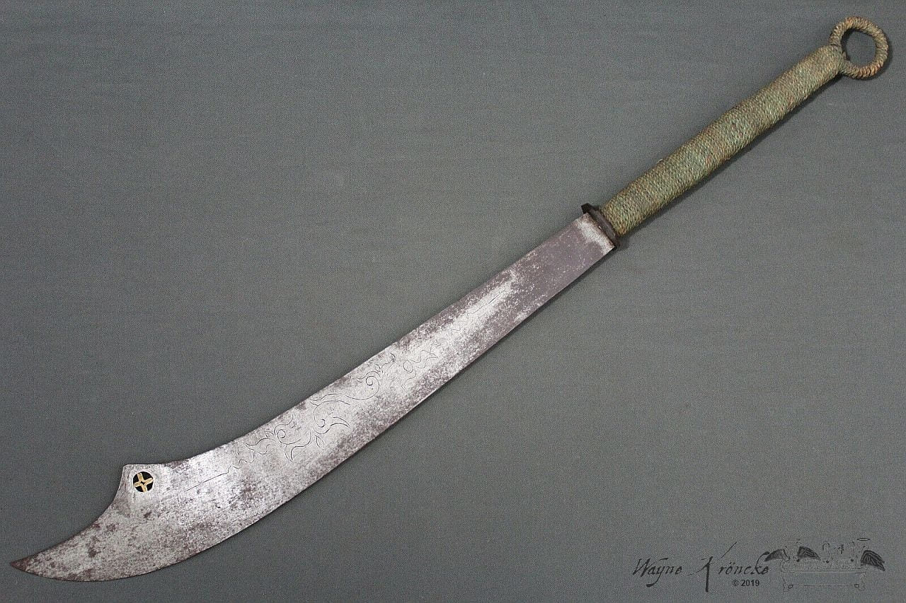

Posts: 4,282
Vietnamese truong Dao:

Thanks for your suggestions. Yes, the truong dao from Vietnam is another version of the dadao, hence its similarity to the original post (OP). However, the firm provenance for the one I show -- a Belgian officer's bring back after serving in the Korean War (1950-1953) -- makes a Vietnamese sword very unlikely. The sword was collected in Korea more than a decade before the Vietnam War. The OP is either Chinese or Korean IMHO.
After looking more into the history of the Chinese dadao, I'm inclined to think that the OP was introduced into Korea via the Chinese People's Volunteer Army (PVA). There is some evidence to indicate that the dadao remained (unofficially) in some units of the PVA up to about 1950 as a cherished weapon celebrating the resistance to the invading Japanese. The dadao was a close-quarter's weapon in the fighting against Japanese forces in the 1930s and 1940s.
So far I have not found any evidence of the Koreans (either North or South) using the dadao in their military ranks.

I posted my Viet one as an example, showing the Original Posted one was NOT like it. Especially the guard.
I suspect the one in post No.1 is a Chinese one rewrapped with a flattened 'eye' pommel. As many CCP soldiers 'assisting' NK carried the dadaos and after loud discussion with the US/UN troops, suddenly didn't need them any more, leaving them where Koreans could pick them up off the battlefields, wash off the bodily fluids, re-wrap them to provide an uncontaminated grip, and use them themselves. Possibly embellishing the blade with pastoral scenes of peace and harmony embodied by the aforementioned loud discussions.
