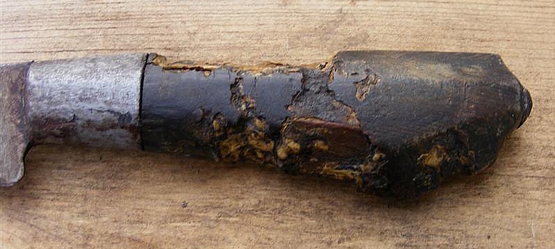

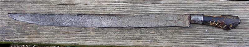

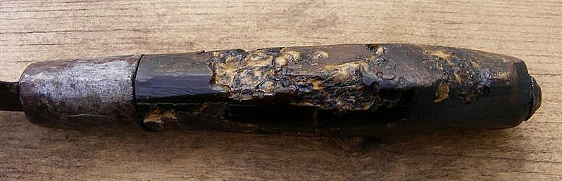

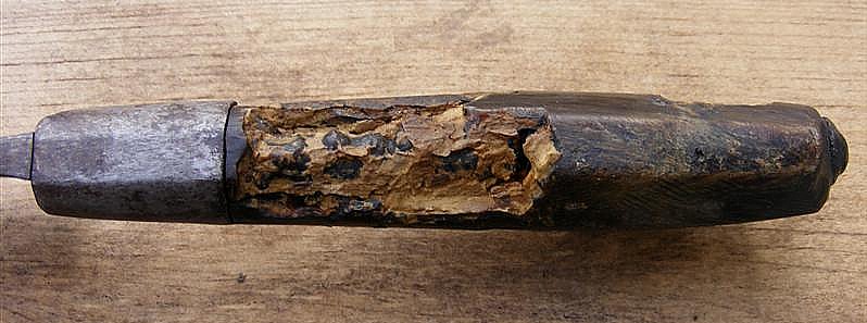

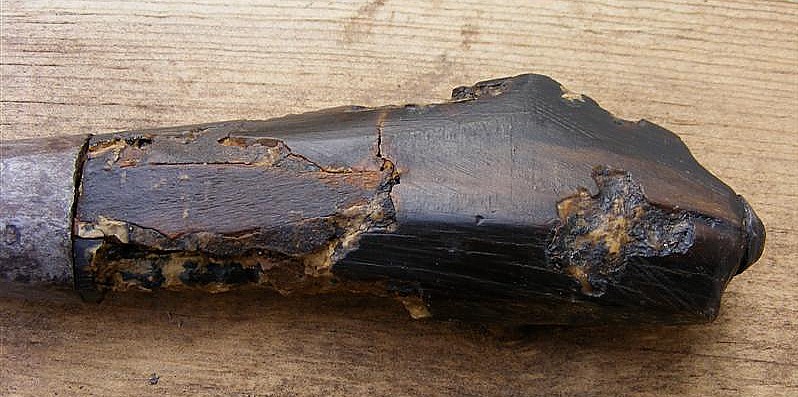

Here is a bolo I recently received. I knew exactly what kind of shape it was in before I bought it because of the detailed pictures the seller provided. The horn hilt has an extreme amount of worm damage.

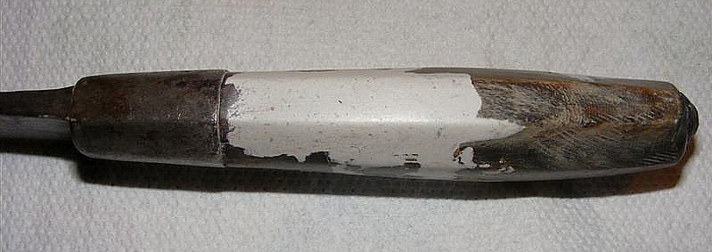

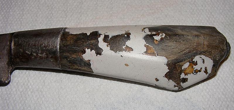

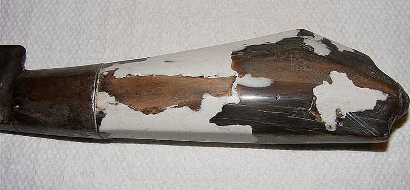

I really hate it when I see things like this bolo that were completely neglected and left to rot with no attempt being made to preserve them at all. To keep from having to grind off the end of the tang to remove the grip and then carve a new one out of horn I opted to replace the damaged areas with epoxy putty. This way I could also retain what is left of the original grip and stabilize it at the same time. The pictures show what it looked like when first received and what it looks like now. At this point it is only roughed in and not yet smooth enough to be stained to match the original horn. I will post more pictures when I am finished with it. My question to all is, what would you have done if this was yours? Robert |

Hello Robert,
I think that is the best you can do with a damaged handle like this. Well done! Think the end result will be nice. sajen |

Nice job, I think since its so extensive, I might have drawn even more attention to it, using epoxy mixed with some colored pigments or metal flakes or something snazzy like that.
Nice handle shape on that one, looks really comfy.

Sajen and G. McCormack, Thank you both for your comments on what I have done so far. I think after staining the epoxy will look fine and match in with the horn pretty well. At least I hope it will !!
Steve, Thank you for the link to the supplies and for the tips on how to do the repairs. Again, thank you all for your interest. Robert |

LPCA, Very nice restoration work you've done on your swords!! I tried using bondo at one time but it did not want to stick very well for me. It could have been that at that time I was still able to swing them around and the bondo was separating from the horn. That is the main reason that I started using epoxy putty. It colors well before or after being applied but because of the fast drying time I prefer to do the coloring after it has dried and been completely finished sanded. The reason this swords repairs are still like they are is I ran out of the brown permanent markers that I use in conjunction with a black marker to color the putty in with. I am going into town today to pick up more, so I should be able to post pictures tonight of the finished work. If it was not for the fact that I would have had to grind off the end of the tang
I would have just used the original grip as a pattern and made a new grip of water buffalo horn to replace the damaged one. Does anyone else have pictures of any restoration work that they have done to damaged grips or hilts that they would like to share with the rest of us? My thanks to everyone for your interest and suggestions on how to repair the damage often found on these older neglected and often mistreated items.Robert |

Louis-Pierre, Great work on the hilt restoration!! The results for the one that I'm working on are below. Sorry about the picture quality but I had to take them inside because it's dark outside here. Could use a little more work in a couple of areas but I will probably leave it as is.
Robert |

Louis-Pierre, Thank you for your kind words. Saving the damaged grip was exactly what I had in mind when I started this restoration. I wanted to save what was left of the original horn and try to stabilize it in the process. I tried to leave in some of the imperfections so it would not look brand new and it would match up better with with the blade. A new grip might look better, but to me it would look out of place once it was mounted to the old blade. Because of the bonding strength of the epoxy I also believe it could now be used as intended "if needed" without worrying about the blade coming loose from the grip. I hope that I never need to find out if I'm right about this or not. Robert |
