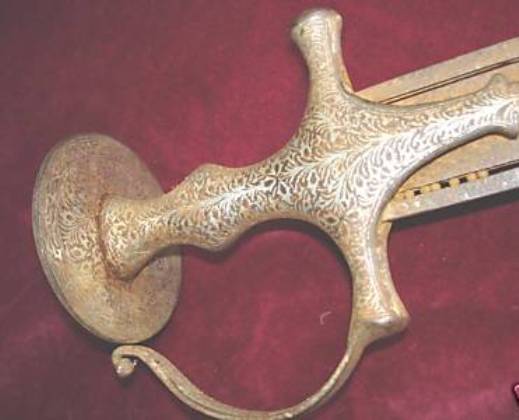

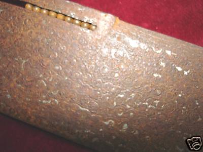

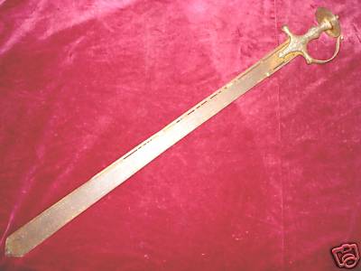

Hi all,
just finished on eBay...looks to be a nice Patissa ? (Khanda blade mated to a tulwar hilt ?) ....with small rolling balls set into the wootz (bird's eye ?) blade. I know we have had several discussions on the reasons for the 'balls' ....but no difinitive answer has 'surfaced'.
I wondered on the opinions as to the Patissa /Khanda in question ..I have a few 'reservations'....and whether there are any other ideas as to the function or meaning for the balls.

Looks brand new to me just left out in the weather and rusted up.
Koftagari on handle is not old type and blade with pronounced pattern like that very suspect also tears of the wounded unusual on this type sword

definetly FAKE.

Fairly recently made sword.
The balls in the blade that could roll back and forth were sometimes called, "Tears of the Wounded".

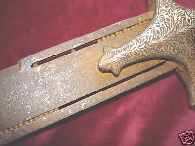

The blade 'patterning' appears raised ...similar to a number of 'modern' Indian knives .... pattern welded ? .. although this looks to be 'acid etched'.
I didn't realise that the koftgari was recent and not the 'old type' ....please, how do you know the difference ? However, there was no wear / rubbing of the koftgari either.
The two 'slots' nearest the hilt ...disappear 'into it' ...suggesting to me that hilt and blade were not meant to 'be together'.
