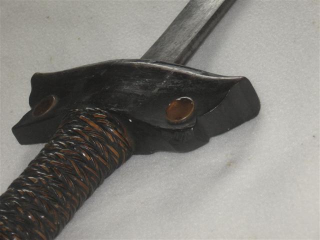

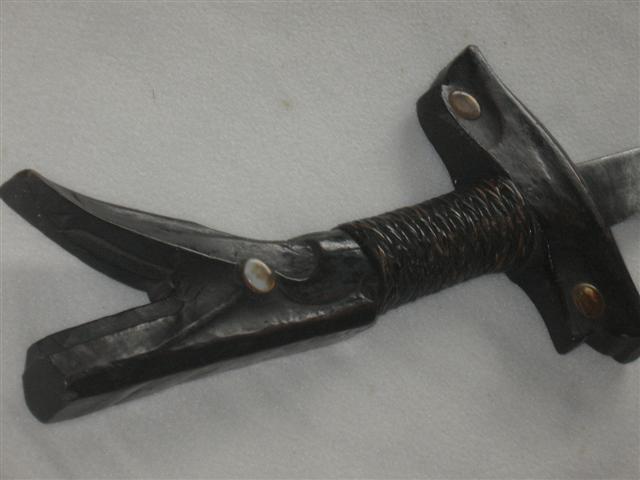

Here a heavy kampilan with a total length of 41 inches.
I discussed this MOP dots on the handle with other collectors and I still have this curiosity...........
The best that came up IMO was that they where later implacements to cover the "eye" and the holes where the iron guard were fitted.
I would like to hear other suggestions.
Kind regards,
Maurice

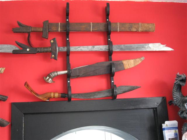

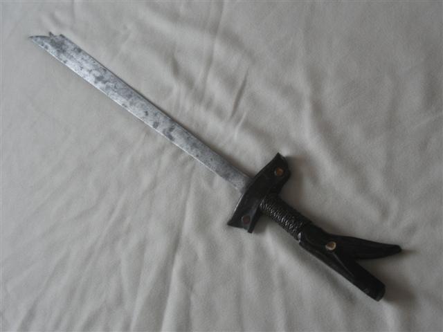

Hi Jose, it is not a short blade.
But I must agree it lookes like it on the attached pics above. The blade itself is 31 inches.
I couldn't stand right above it when I took the picture because than it wouldn't fit because of the length of the blade. (and also because of my own body-length, when I was taller I probably would get it done )
I made a new picture of the kampilan hanging on my wall from a more distance, so the length can be seen better.

OOO, I see your point (get it, point? )

Nice Display Maurice

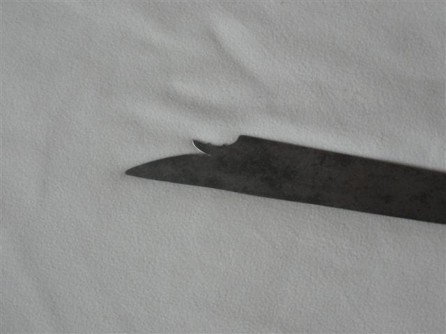

IMVHO, the rather roughly carved hilt, no considerable wear, and the large size of the blade may point towards the 20th century. Also the MOP on the crosspiece seems to be too close to the outside to be covering original guard holes (not strong enough). I'd guess that the MOP may be the original decoration.
I'm not sure about the blade - I'd like to see a close-up of the tip if possible.

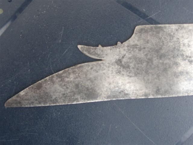

The picture attached of the tip of the blade is the only one I have available right now.
Let me know when you need more or better pics than I will make them tomorrow.
A close-up of the tip without shadows would be great - thanks!

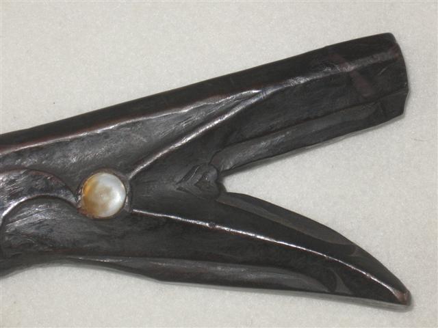

Acutually I have seen staples that far out before.
I think that Kai has a point though in that it may be 20thc - the carving seems later now that I look at it again.
OK. Here it is. Not one of the sharpest pics, but the sharpest one I could make. (look at the end of this post).

Also the tip doesn't look like 19th c. to me (just a hunch though).
I think it would be interesting to etch the blade...

Are you looking at the spikelet?
