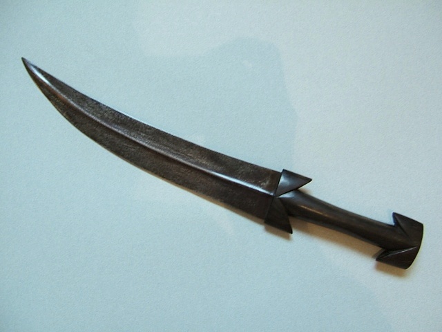

Just arrived the other day a large horn hilted Albanian jambiya. I sanded down the blade with 600and 1000 grit sand paper and etched it. The blade turned black instead of the normal grey but I don't know if I see any real pattern? So this is probably not wootz?

sand it again cut your solution to a 1/2 to 1/4. I assume you are using ferric chloride. It still may not show pattern but your concentrate is to heay right now

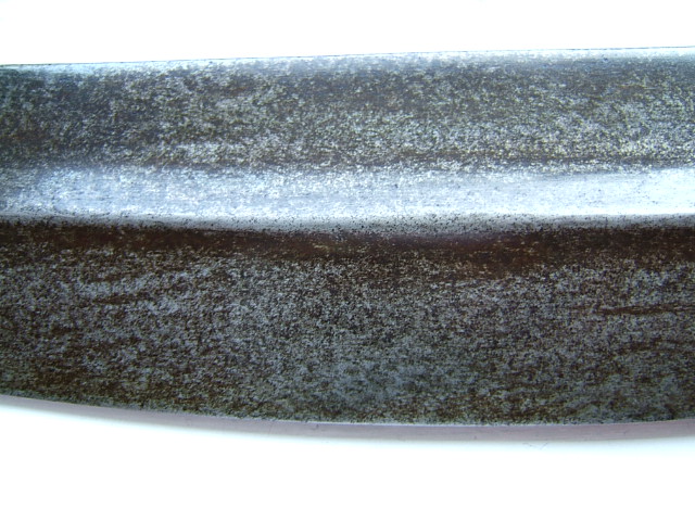

Ward
I sanded it again and used a weaker solution and I am definately seeing a wootz pattern starting to appear it shows swirls but seems low contrast it will need more coaxing.

You always better off starting with a lower concentrate and just repeating coats over and over again

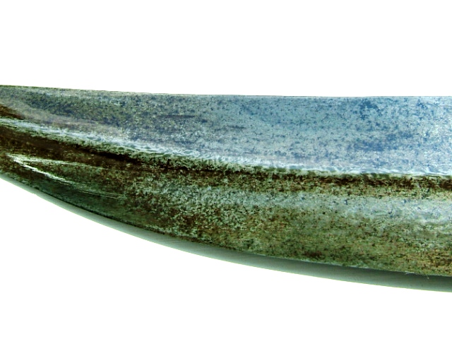

Here is a better pic you can see the pattern but it's not high contrast.

if I may suggest more sanding got down to 2500 also still half your conentrate will take longer but will come out. you need to get rid of some pitting slow and sure. I think you should be able to get a decent pattern out of it. slow and sure. citric is not going to cut it on this tyoe of damascus. light etches neutralizing in between. you can use warm vinigar as last step
