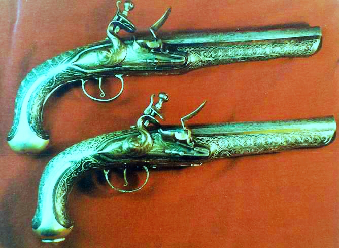

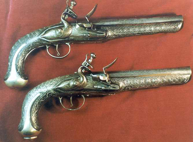

Hey guys, this isn't my field at all, but i ran across this article and thought some of you might find it interesting.
One thing i found of specific interest to me is that apparently there is a way to determine if something is forged meteoric ore without destroying part of the item. At least according to this article.
http://news.bbc.co.uk/2/hi/science/nature/7414544.stm

First of all the pistols seem to be of Moroccan origin based on the inlaid spiral silver work motif. Second there is no way you want to make gun barrels from meteoric iron there are too many impurities that would cause the barrel to explode in the users face during use. So maybe these curators need to stop believing in these stories.

Is that so, Lew? Moroccan ? With such lock and mountings ?

Who is to say that these could have been European style pistols that were reworked? I have a Moroccan dagger with the same spiral motif on the scabbard and damascus gun barrels were more often seen on Ottoman and Arabic guns than European ones. Of course clearer pictures would help . If these guns were from Argentina than they could have originally came from Spain or surrounding area tell me how far is Spain from Morocco anyway?

that looks a lot more like european influenced turkish to me

With all due respect, they look like european pistols to me, though decorated in a moroccan fashion. By the way, spaniards forged (not produced) wootz from India, and made mechanical damascus until mid 19th Century. There is documental evidence of this fact. The style of the pistols, does not reminds me any of the styles seen in North Africa, the Middle East and Turkey. Of course, I can be wrong.

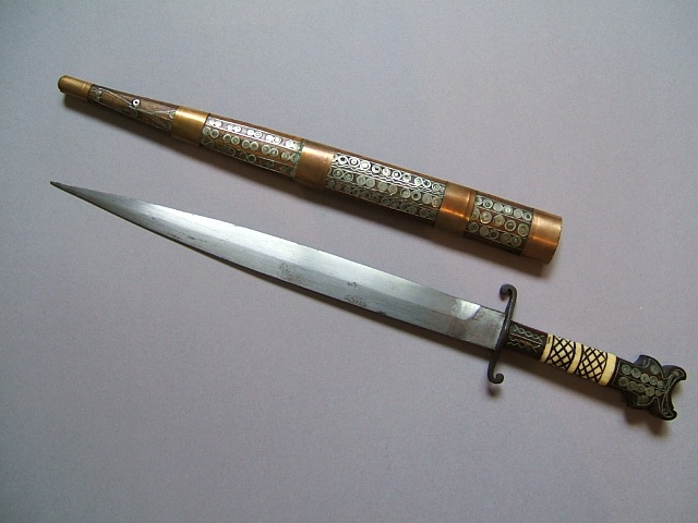

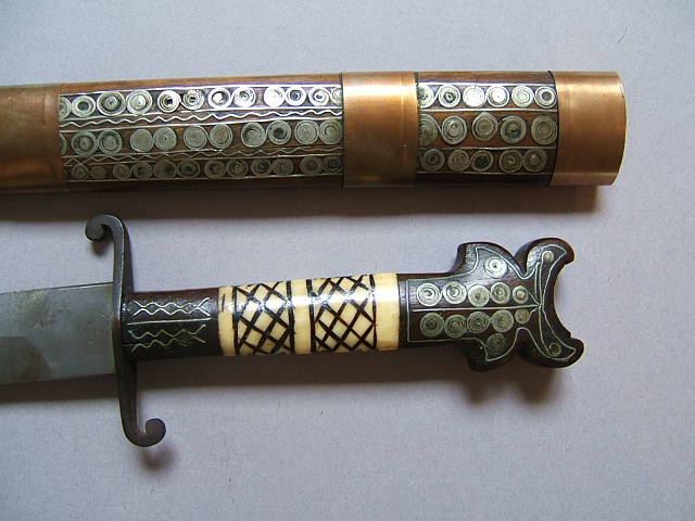

I dug this out of my closet. This is an early 20th century or earlier Moroccan/Algerian dagger with the same inset wire design as seen on the pistols.

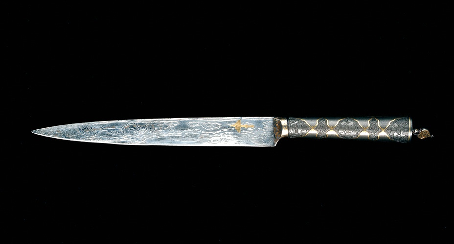

They might have been looking for Iridium in the gun barrel which can indicate the presence of meteoric metals? Below is a Indian dagger made from meteoric Iron.

Hi all! Iridium is present in all meteorites, as are Gallium and Germanium (at least in the ones I've bashed about ) so the test would probably be for these elements-none of the above, not meteoric in origin....
Lew
Impressive ... couldn't be more similar.
Not only the spiral efects but also the waves inside the paralel lines.
Now, are these decors a Moroccan (or Algerian) exclusive or could they, instead of being a localized custom, belong to a general culture ... Muslim, for what counts ?
I guess that firearms are rather more complicated to dissecate their origins than white (edged) arms. They are built with far more components, often each one of them provenant of the most distinct places.
In the other hand, General Alvarez wrote in that letter that the pistols were the first essay on manufacturing arms in Buenos Aires. Maybe manufacturing was a "strong" term and they only assembled them, but obviously some enterprise was taking place there; there is no smoke without fire.
This way the importing of the components was potentially from Spain, even if they were not Spanish ... although obviously not from Morocco, even being a surrounding area
But once in the field of speculation, it could be that the General had the pistols stocks decorated by comission, a custom often used for presentation pieces.
In such case, he might have ordered such fancy work from a Moor
Let me stop the nonsense
Fernando
