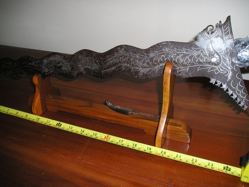

Hi all. New here and looking for advice/opinions on my keris. I inherited this from my father several years ago, and despite much research, I cannot find any published examples that are truly comparable - particularly the inlay. I'm hoping someone here has some insight. If nothing else, I hope you all find this half as fascinating as I have.
Details:
1) Luk-11, blade-only (no ukiran, waranga, etc.)
2) Weight: 1,023 g
3) Length: 57.3 cm (not including pesi)
4) Blade Width: 5.4 cm at luk-1, tapering to 4.6 cm at luk-11
5) Blade Thickness: 0.60 cm at luk-1, tapering to 0.44 cm at luk-11
6) Ganja Width: 15.8 cm
7) Ganja Thickness: 1.60 cm (at center)
8) Inlay: Both sides of the blade contain the same, intricate inlay (kinitah?) that extends from ganja to tip. Inlay material is almost entirely present, but the few voids present reveal deeply cut channels (~1.5 mm).
I believe this to be from central Java, possibly late 18th century, but that's I brave to speculate at this point. Any info or questions are welcome.
(Note: Final photo a sketch-over, intending to show the full inlay design clearly.)

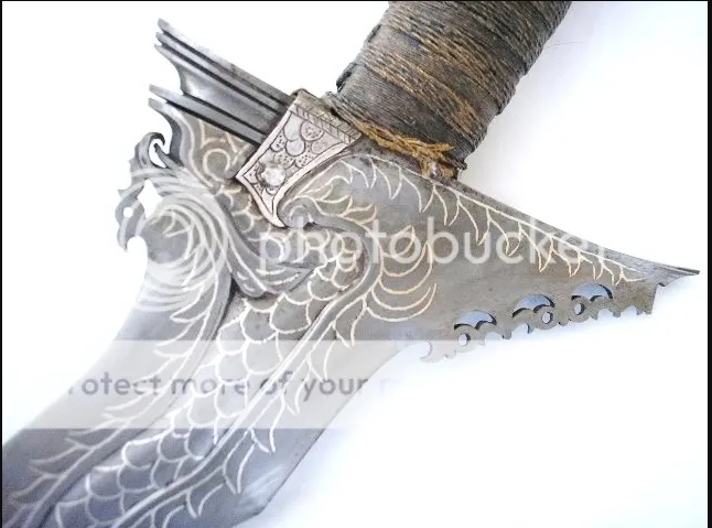

I agree with the dating and everything, except with the Gangya issue - this blade has a separate Gangya.
A very nice blade for its type.

I too thought the ganya was separate and agree with the naga influence, hence, my original assessment.

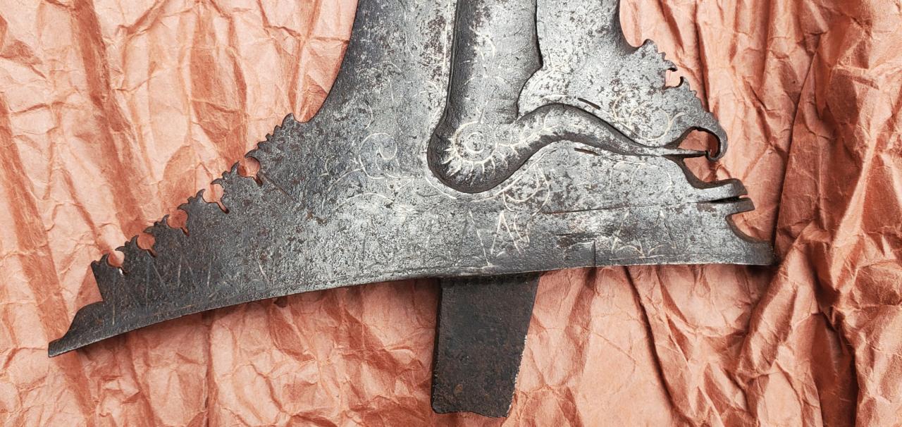

More photos of the underside with different lighting. I don't see evidence of modern welding but forging, perhaps.
The closeup (60X) is the face of the pesi/tang, at juction/joint with blade/ganya.

Of note is the very short tang. It is possible that this is a broken tang, but short tangs such as this one were made that way on some early 20th C kris.
That does not seem very sturdy... Would a kris with a tang that short have had baca baca for reinforcement?

I'm trying to figure out how the fitment was achieved at the intersection of tang and gonjo.

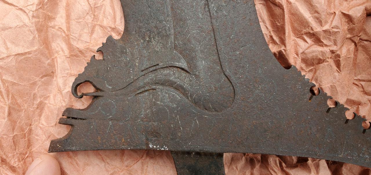

Me too. Here's another angle.
To my eye, it passes through the gonjo. The tang thickness steps down after emerging from gonjo, and there is heavy peening on that fillet, all around. (I think this is what's getting confused for weld marks.)
Is there a way to confirm this one way or another?

I also notice that the ganja has been bashed pretty hard on its side near where the tang passes through. Is there evidence of the same on the other side?
I think we're looking at a repair here; no self-respecting Pande would have done that during manufacture.
Yes, but I'm quite sure those are wear marks from the baca baca. Hopefully this shows up clearly:

Old 20th March 2026, 01:51 AM   #18
Posts: 7,403
This blade is from the Maguindanao tribe. They make a lot of (if not all of) these blades. It looks like a separate ganga to me, but many times the fit is so tight that lines practically disappear.
Looks like there was one baka-baka.
The tang seems to have been broken off later, thus being short.
And they often did silver inlay on these naga blades.

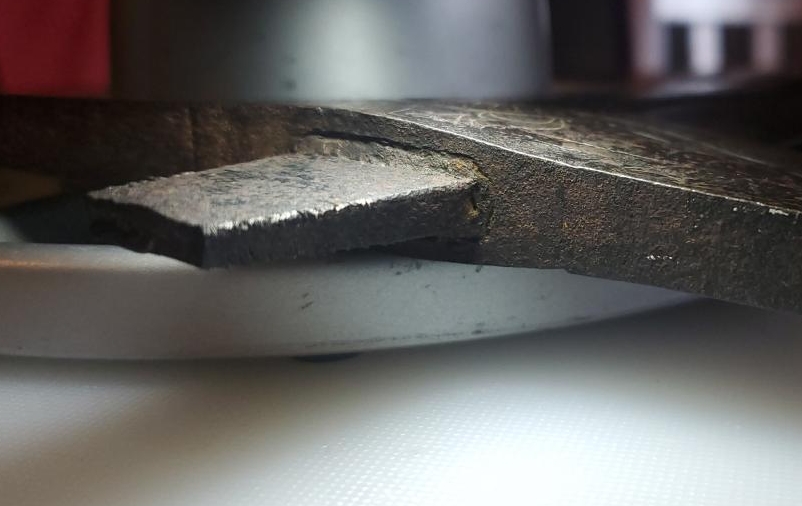

I would need an X-ray to convince me that this gangya is separate rather than a couple of engraved lines with an extensive gap between. The most recent picture shows inlaid silver work passing across where a line of separation would be expected and there is no discontinuity of the inlaid sections to suggest any separation underneath. Speculation about the existence or not of a separation line is best answered with an X-ray, and that is a simple test. Kris without separate gangya are sometimes fitted with asang asang.

Thanks Gustav. Short of pulling the kris apart and physically separating the gangya to confirm that it is indeed a separate construction, the only way to show conclusively that it is separate is via X-ray. I have done this many times and confirmed that a line of separation is readily visible when present. This is much easier than taking the hilt off.
As far as the inlaid silver decoration crossing a possible line of separation without interruption on at least two examples of this style of kris, this seems to be evidence that there is no line of separation present. Until I can find another example and X-ray it, I remain skeptical that these relatively modern kris actually have separate gangya.

Gustav, does not the definition of "separate" require there be two individual pieces that can be pulled apart? The original post has no hilt and it should be a simple matter to remove the gangya if it were separate, But it seems to be firmly attached to the rest of the blade — ergo, "not separate." Whether it may have been separate in the past depends currently on interpretation of the surface appearance of the ensemble. Such interpretation can be difficult or misleading for pieces of this period, especially when there is substantial oxidation. My suggestion of an X-ray examination provides a more specific way of looking for a (partial) line of separation.
X-ray examination of the hilt also allows measurement of the length of the tang. Tang length of intact 20th C kris can be surprisingly short, sometimes in the range of 1.0–1.5 inches.

Because I can't leave a debate unsettled, x-ray is below. Separate ganya, yes?

There you go Rick! Clearly a separate gangya.
The X-ray removes any debate. Did you lose the elephant trunk in cleaning it. It seems to be missing on the X-ray.

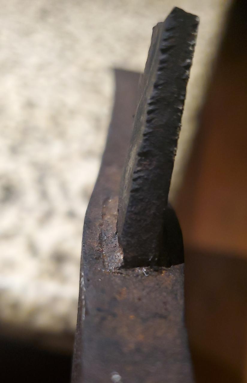

Another example of this genre that sold recently at auction. No hilt, just the blade unfortunately.
The blade is similar to your example, but the head of the naga appears higher on the blade and closer to the hilt. When I enlarge the gangya area, I cannot see a complete line that would suggest a separate gangya on this one. The groove defining the naga head extends over where a separation line would be expected, and on the greneng side of the naga I can see no line at all.
In the labeled figure, there is a line (1) in the correct place for a separation line. That line extends almost to the groove outlining the naga, but stops abruptly short of it. I can see no evidence of any line on the greneng side of the naga. There is another line (2) at the cocor but such a line is always engraved on the surface and does not indicate any separation at that point. My conclusion is that the apparent line of separation on the gandik side of the naga is an engraved line also, and that this blade's gangya is not separate. However, an X-ray (as you found) would provide a clear answer.
The area of attachment of the tang to the gangya (3) again shows some widening adjacent to the gangya. I suspect it represents welding of the two pieces.
Interestingly, there appears to be a horizontal crack in the tang (4) at a point similar to where your tang appears to have broken. Perhaps a forging flaw that may have eventually led to this one also breaking.

Interestingly, there appears to be a horizontal crack in the tang (4) at a point similar to where your tang appears to have broken. Perhaps a forging flaw that may have eventually led to this one also breaking."
Now this comment is really interesting (at least to me).
How to interpret this has me more than a bit stumped.
Same area, same forging fault; same Smith ?
