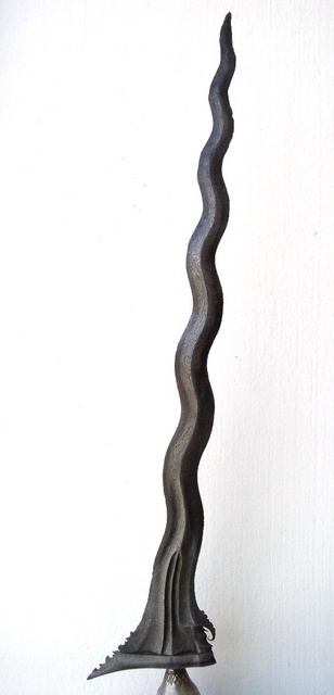

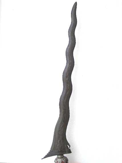

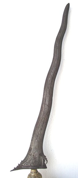

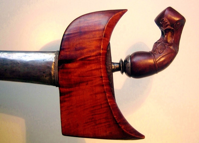

I have discussed this Keris with some of you but still nobody is really sure of from where it is.
Hopefully the forum members here can shed some more light on its origin?
Please note that it has Ganja Iras.
Some references:
From Adni's site:
http://www.geocities.com/keris4u/ker..._sul_luk13.htm
Tammens De Kris 3 page 88 pict 71. A very resembling hilt is classified as West Kalimantan.
Hulu Keris page 83 pict 126. A slightly resembling hilt is classified as West Kalimantan (maybe influenced by Tammens?).
Frey's The Kris pict 20 a. The Sampir/Wrangka of a Peninsula Keris slightly resembles this Keris.
The blade resembles a bit the Keris Kapak Cina at The National Museum in KL
http://www.kampungnet.com.sg/modules...view_photo.php
So where does it come from - West Kalimantan, Sulawesi, Sumatra or Malay Peninsula?
Or is it a "traveller" or a "dealer's mix"?

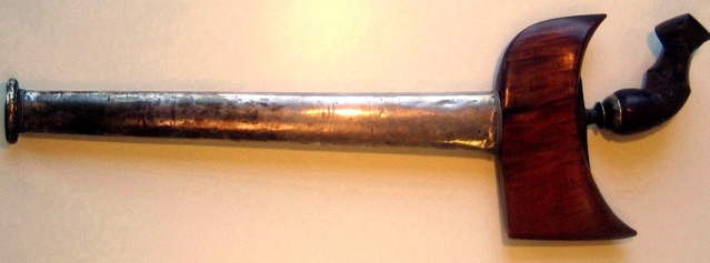

Nice old keris! But a puzzle to guess from where it comes.
Surely the selut is from Sumatra.

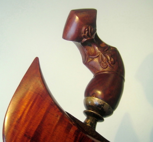

The hilt (nice the decoration) 90% would be from kalimantan (...but also, maybe, from Malaysia?) .
Sarong and silver pendok would be from Sulawesi .
About the blade i don't understand where it comes ( Sumatra?). Surely a good smith made nice dapur and nice pamor (tritik or untu walang)
....(sorry for my english)

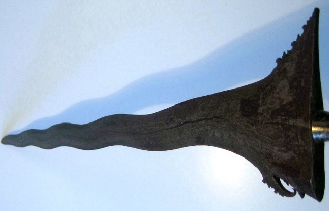

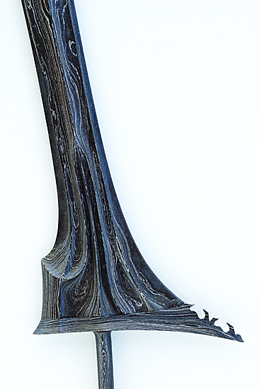

Old 15th October 2006, 02:57 AM   #6
Posts: 7,249
Yes, its a mix. How, when, where, why , we can only guess.
The blade is an older Madurese one.
Note the angle of the gandik, as if it wants to fall into the body of the keris.
Note the whispy style of the kembang kacang.
Look carefully at the greneng, especially the ron dha.Note that this blade is comparatively recent and has very little evidence of erosion. Ever seen a Javanese greneng or ron dha like this? Of course not!
Look at the distance from the luk nearest the point to point itself. One of the indicators of a Madurese keris is that it has a long point.
Look at the pamor:- relatively complex, involving both surface manipulation and a forge manipulation. The core will be found to be hard steel, where it has been heat treated. Where else will you find this type of material and workmanship?
This is a Madura blade.
In attempting to identify origin of a blade you should first disregard the dress in which it is found, and then look at each feature of the blade, do not just look at the overall blade. Pay close attention to the way in which the greneng, especially the ron dha , is cut. Look at the detail in the kembang kacang----how long is it? rate of taper? substantial? flimsy?
In the case of this blade, all these details only confirm the immediate impression:- you see a gandik like that, and it is almost certain that you are looking at an older Madura piece.

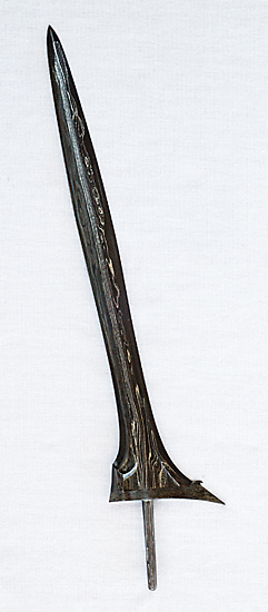

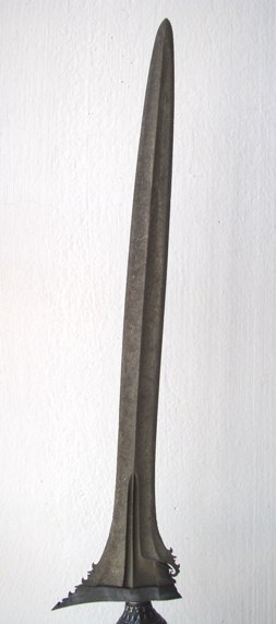

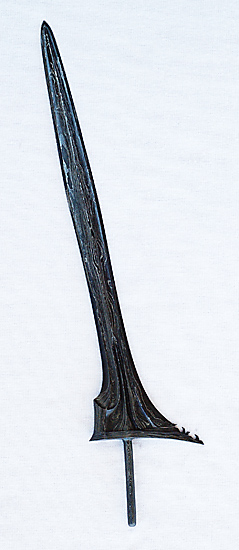

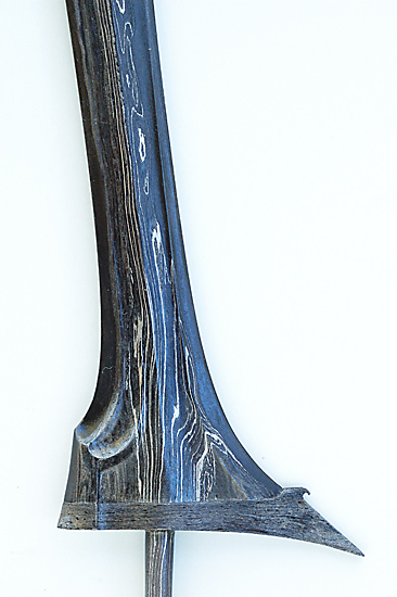

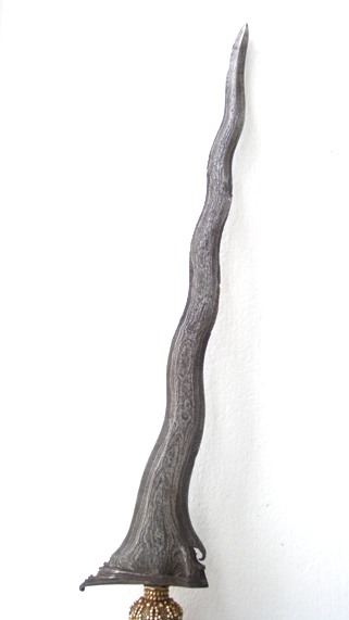

May I present a number of examples of Sumatran Bugis-influenced blades. 2 of them were collected from Sumatra, in wretched condition, dressed in their original fitted sheaths. One was purchased from a US seller, with no sheath, but a Sumatra hilt. The others were purchased from Artzi, and the sheaths were old and fitted perfectly with the blade.
The "gandik falling into the blade" feature is very common amongst Sumatran Bugis blades, and in fact, not unusual in Sulawesi kerises as well, though I don't have examples of those in my collection. Such features can also be found in Peninsular pieces.
These blades have a basic triangular shape at the base of the blade, and can have rather long drawn kembang kacang. The greneng and janggut are of the variety that sticks out of the blade's profile, and can run from the blade to the ganja's aring side. The greneng's form is in line with what I have seen on Sumatran blades.
The pamor on the blade is not that uncommon in the realm of Bugis/Malay blades. The name is pamor "gigi yul", or shark's teeth. The central sader saleh pamor line is also common. I have 3 Bugis blades with such pamor:
The long distance of the last luk to the tip is also a common feature in Sumatran Bugis blades, and even in Malay blades influenced by Bugis styles.
A further point to make is that the blade is ganja iras. Though not a smoking-gun argument to make, ganja iras blades are more common on Sumatra than anywhere else.
So it may not be so certain that this is a Madurese blade.

I agree with Kai Wee, the blade might not be a Maduran blade. and also about the "gandik falling into the blade" feature is common amongst Sumatran Bugis blades, Sulawesi kerises, as well as Peninsular pieces.
I do agree that, trying to determine the blade origin, we'll have to ignore the dress, (for the time being) and concentrate on the blade's features.
The blade, might be of Sumatra/Kalimantan origin. Looking at the blade's features... the ganja iras, the ricikans, the greneng-works and the pamor. Probably an adaptation of different influences, made for a Bugis.
The blade, does have some resemblance to Keris Kapak Cina.

For the hilt type, I've seen it before (at Adni's shop) on a kris and a badek (kawali or Badi Guru), as well.
The hilt cup (pendongkok), does looks like a variation from a Palembang style, a variation from Kai Wee's example (in his gallery).
The sheath, a mix between a Sari-Bulan and a Tengah form. I've not seen this form before.

Old 15th October 2006, 07:29 PM   #10
Posts: 7,300
Personally i don't see any Bugis influence in this blade. And the execution of the pamor seems very different from the Bugis/Malay examples shown even if the basic pamor type is the same. I don't think this blade was created by a Bugis smith.
Old 15th October 2006, 11:50 PM   #11
Posts: 7,249
Gentlemen, I am not very often giving to making positive statements in respect of the origin of keris blades.
When we say that something is of one classification of blade or another, what we are doing is applying the Javanese tangguh system which relies on a number of indicators , many of which can only be applied with the blade in one`s hand. Because of this I am more often than not very hesitant to be at all positive about the origin of a blade, based upon what I can see in a picture.
Some blades can be very obvious, such as a big , smooth finish Balinese blade. Almost anybody can recognise these with just a passing glance. Similar with the classic straight Bugis blade---a glance as you walk past it, you know instantly what it is. For a person with extensive experience in handling Javanese/Madurese blades, recognition of a classic older Madurese blade is just as simple.
My teacher of the tangguh system was Empu Suparman Supowijaya, who was acknowledged as one of, if not the most knowledgeable man in Surakarta , which essentially means in Jawa, and thus the world, on the subject of tangguh. I studied under his tutelage for more than twelve years, and it took me about ten of those years to begin to understand how to apply the indicators used in making a classification of a blade. During that ten years I would have handled a minimum of at least 20,000 keris blades. In the years prior to this, and following my ten year "apprenticeship" I also handled about 2000 keris blades during each year. At the present time I am reasonably confident that the tangguh that I give a blade will be accepted by the majority of people in Central Jawa who do understand tangguh, as a reasonable classification of a blade. I say " majority of people", because decison on a tangguh is essentially a matter of applying certain standards to the indicators and forming an opinion which can be supported by reasoned argument against the standard of the accepted indicators. There will usually be a few people who do not agree.
In respect of the blade under discussion I have varied from my usual reluctance to give a positive tangguh.
Why have I done this?
The answer is simple:- I am absolutely positive that this blade conforms in all material respects to the indicators which will give it a tangguh of Madura.
However, as I have already pointed out, this is an opinion, and in this case that opinion is based upon what I can see in a photograph.I acknowledge the right of anybody at all to disagree with me, however, my decision in this matter is firm, and I stand by it.

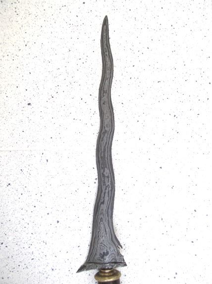

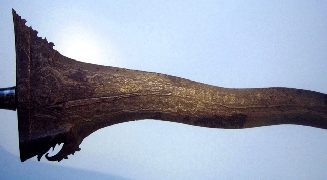

Hi all,
Below is an example of a blade which was acquired in Borneo (Kalimantan) by the previous owner (blade only). Now in the possession of our forumite, John.
http://www.kampungnet.com.sg/albums/albur05/Blade1.jpg
http://www.kampungnet.com.sg/albums/albur05/Blade.jpg
Notice the similarities in the greneng-work.
The pamor is also similar, except that John's piece does have finer worksmanship, imo.
Let's discuss...

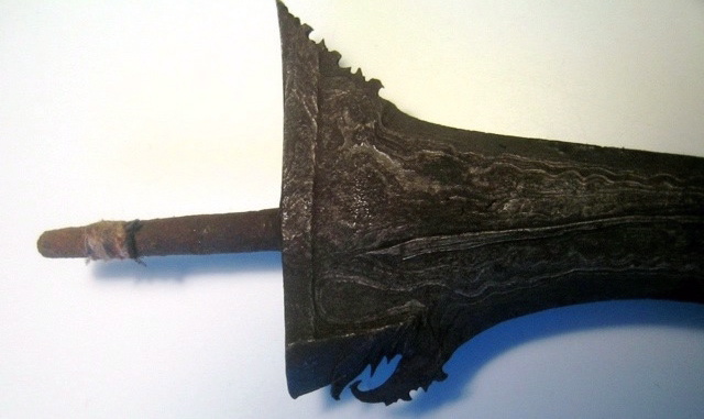

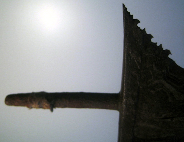

To Michael,
Can we have a picture of your keris's pesi, please.

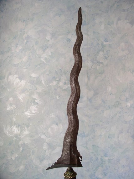

For instance.
Where do you think these blades might have been made?

Here you are AlamShah.

Thanks VVV.

Well, luckily I not a betting man. How about comments on the fittings?
Are the blades your?

Originally Posted by Alam Shah
I somewhat agree. How about the similarities to Keris Kapak Cina? Any comments?
You know, i am afriad i can't really get a good enough look at the keris kapa cina to make a viable conparison. Again, as with John's keris, it bears an overall similarity, but i think that if we examined it piece by piece we would not think there were of the same origin.
As for the fitting, i'm pretty baffled. Bugis influenced Sumatran , Sulawesi and peninsula dresstends to mend together for me. I miss the subtlties.

For instance.
These blades look like they came from the source that you normally get your kerises from.
There is a certain distinct feel to these types of new keris blades. Though they may look like some of the Sumatran (1st keris) or N. Malayan (2nd keris) kerises posted on this forum before, the execution of the keris gives them away immediately. The 'air tangan' is not 'right'. As is pamor execution and material used.
Is it possible to see more pictures of old Madurese keris blades please.
Thanks in advance.

Is it possible to tell where these blades came from?

Those two blades that I posted images of are my work, as guessed by Marco.
They were forged and carved in Wentworthville, near Sydney, Australia.
The first used a classic Surakarta keris as its pattern, but I did not express the ada-ada distinctly, in order to retain the pamor. The material used was old carriage iron and German nickel.The method used to make the pamor was to fold a single very thin leaf of nickel into the iron; four of these pieces were made, which were welded together and folded five times to give a nominal 128 layers of pamor.The pamor forging was then cut in half, turned miring, and the steel core welded in. This is the usual method employed by most Surakarta makers of the current era---except of course for the turn miring. The thingil is a unique variant. Upon completion the blade was heat treated.
The second keris used a number of different old Javanese keris as patterns. In making this my intention was to produce a keris that would not fit any accepted tangguh.The material used was a tyre from a carriage, which means that it needed to be washed repeatedly, as was old iron, before it could be welded to the core. The contrasting material was Indonesian nickel from Luwu, and it was incorporated into the folding at an early stage, resulting in a distribution similar to that found in older keris.The washing ran to something over 9 welds before the iron was clean, however, the nickel was incorporated on the first weld, so the nickel was folded in at the same time that the iron was being washed. There are a number of variants in the garap which would confuse anybody with a knowledge of tangguh, and as I have already remarked, this was my intention.
The execution of garap in both keris is Surakarta.
Blu Erf has suggested that these are similar to the keris that come from my usual sources. Well, this demonstrates I think that photographs are totally inadequate to allow even somebody as knowledgeable as Blu Erf to distinguish material differences in a blade.
Most of the recent keris that I offer are from the Madura school. I do have the occasional recent keris from Surakarta, but the cost of these blades means that they are normally not offered publicly. The materials used in Madura keris are always modern materials, the pamor is produced by using current era products that has a nickel, or other contrasting material, content.
Madura garap is fairly easily recogniseable, when it is compared to Surakarta style garap. One of the obvious differences is in the gusen. There are others of course,such as the fit of the gonjo, the method used to cut a ron dha, the blade angle, but to see these in a photograph can be quite difficult.
If one were to see the keris I posted images of, and some keris from the Madura school, in the hand, the difference would be immediately apparent, but from photographs published over the internet, it is extremely difficult, if not impossible to be too certain about anything. Only very, very occasionally can we be reasonably certain of anything, and then that certainty must be based on what one can see in a single dimension.
This thread has been principally directed at identification of a complete keris with a mixture of features.I gave a firm opinion on origin of the blade of this keris. My opinion was based on my experience, and what I could see in the photograph. I have returned to look at the image of that keris many, many times. Based upon what I can see, I cannot alter my opinion.However, were I to hold that keris my opinion might be qualified. Although stylistically that keris is beyond argument Madurese, a microscopic examination of material could indicate other than Madurese origin, feel of the material could indicate other than Madurese origin, weight and balance could be other than Madurese.
What we are doing here is involving ourselves in tangguh. We may not realise this, but that is what it comes down to:- if you wish to classify a blade in any way at all, you are dabbling in tangguh. In determining any tangguh you need to not only look at the form of the keris, but you need to understand the material, you need to understand how it was made, you need to view the angles and corners of the garap from a number of angles, you need to gauge proportion, you need to look very, very closely, often with magnification, at tiny details. Then to understand what you have seen and felt, you need enormous experience.
Sometimes we can offer an opinion based just on style, for instance in a Javanese keris of tangguh segaluh, or in the classic Balinese straight keris, or in some other tangguh with an over-riding distinctive feature, or features, of form that gives a very high probability that this opinion based on form alone would be confirmed were the blade to be handled.
In most cases, however, an opinion based on blade form alone is not enough.
Ultimately, any determination of tangguh is opinion. This is the meaning of the word. Thus, there may be a number of opinions regarding any one blade, usually when an opinion is offered on anything the opinion that is most likely to be correct is the opinion that can be backed with reasons and experience.But any opinion is only as good as the information provided to base that opinion upon, and as I have already demonstrated, photographic images seen on a computer screen are simply not good enough.
Blu Erf, who is an experienced and knowledgeable student of the keris with, I assume, considerable experience, was unable to discern the differences between current Madura, current Surakarta, and a unique approach deliberately created to confuse somebody knowledgeable in tangguh.However, had he had several current era Madura pieces, and the pieces of which I posted images, in his hand, I have no doubt at all that he would have easily observed the differences in material, garap , and method of manufacture.

Greetings to all after my long absence – I confess I have not had much time to participate in the forum what with work and life and all but I have a few things I wanted to add to this discussion which I hope will be of some use to all involved – so thanks to Kai Wee for drawing my attention to it.
First of all – I am more or less convinced that the piece in question is Sumatran (though with a remote possibility of a Sulawesi origin but I doubt it) of the variety which I prefer to call the "Straits keris" – this is an amorphous and broad area that for much of the 16th through 19th centuries was highly unsettled with a very mobile community. It had a highly diverse population of more or less ethnic “Malays” as well as Bugis, Minang, Orang Laut and Javanese not to mention dashes of just about everything else. As such identifying keris from this area and pinning them to any one place is extremely tough to do. That said the Strait region extends more or less from North of Palembang to Deli on the Sumatran side as well as selected areas of the Peninsula – Kedah, Perak, Selangor and Muar (all more or less controlled by Malay/Bugis polities for the period of time when most extant kerises were produced). (Also note the conspicuous absence of the Negeri Sembilan which was a Minangkabau enclave and note further the very confused state of Siak which was hotly contested between Bugis, Malay and Minang forces and is as such even more confused.)
Given this state of affairs it is highly suspect to even begin to think of a classification system for the blades of the region – smiths from all over everywhere appear to have worked there and I have seen blades that look Bugis, Malay, Minang and Javanese (and all/or none of the above) but all dressed in more or less similar styles. Dress forms also comply to the above admixture of forms and styles. Trade blades, immigrant smiths and keris bearers and a lack of a strong “courtly style” to model on mean that this area is a mess for people who hope to identify the accurate provenance of a piece based on art historical analysis alone. Lampung, Palembang, Minangkabau, Aceh-Gayo (where keris are very rare), Pattani (w/Kelantan as a border/buffer with Terengganu) and Johor-Riau (inclusive of Terengganu and Pahang, on again, off again satellites) all have more or less identifiable characteristics. The Straits on the other hand are a fascinatingly bewildering mess.
Anyway, as for tangguhing, anyone who has read my comments in previous posts will recall my inherent mistrust in the methodology outside of Java (well even in Java frankly but I won’t go there – I’m not an expert on that particular subject). It is very difficult to classify kerises according to tangguh in the Malay world because of the confused political economic situation there and because of a seeming lack of “court style” as a model for more common examples. While the archetypical piece is more or less easy to place there are just too many examples of borderline cases where it could be one or the other. Besides really the fuzzy edges is what makes these things so darned interesting to begin with!
