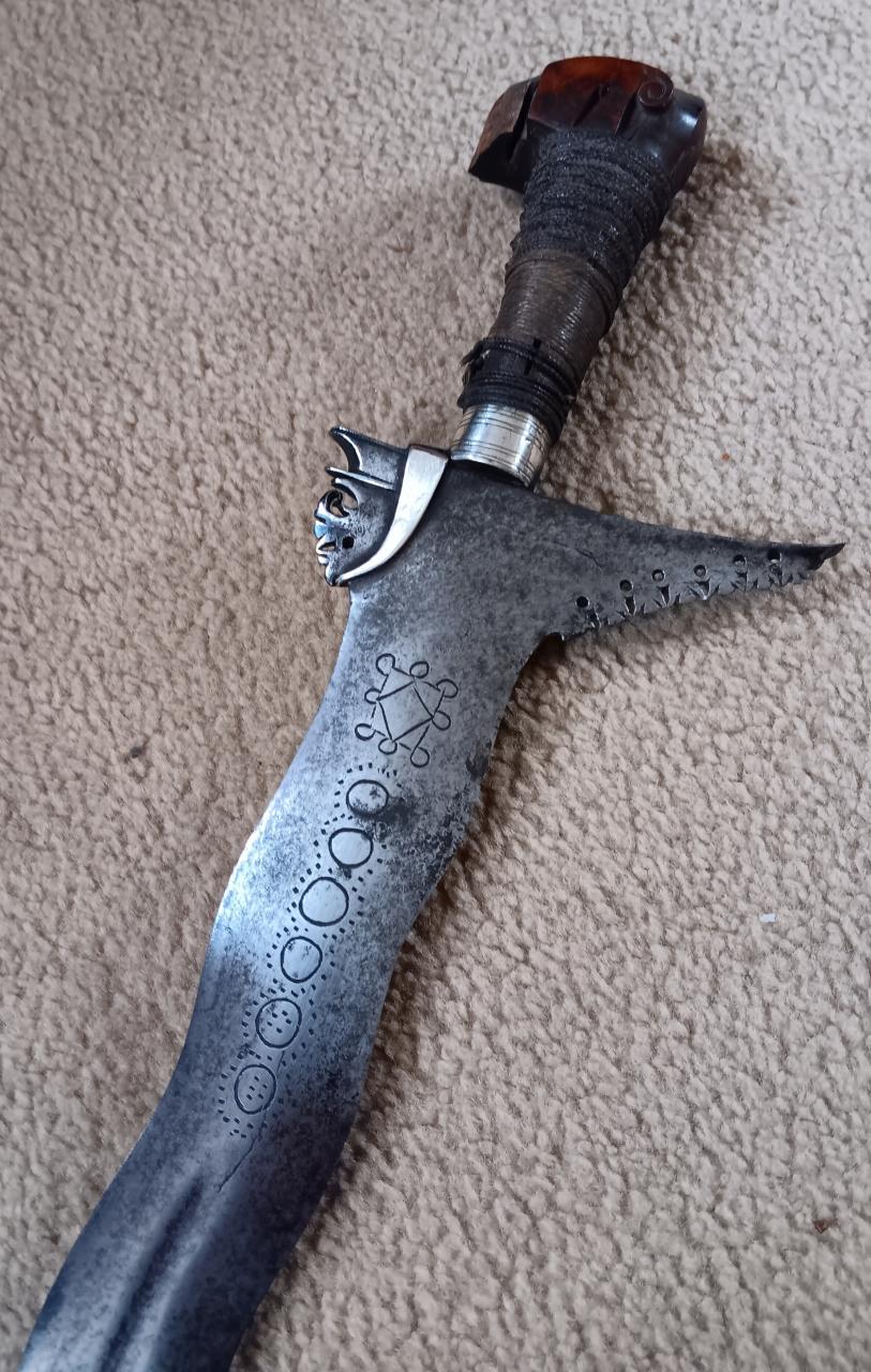

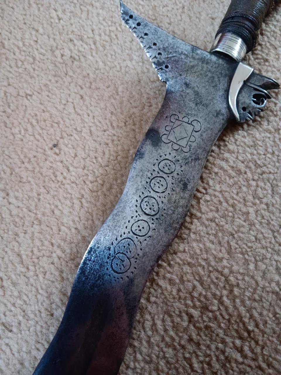

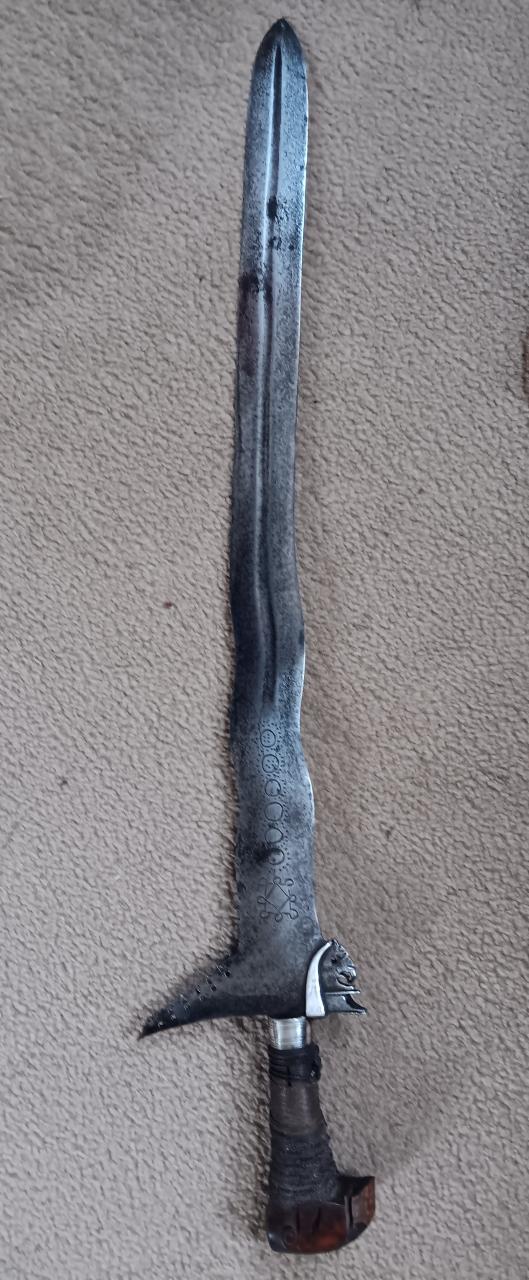

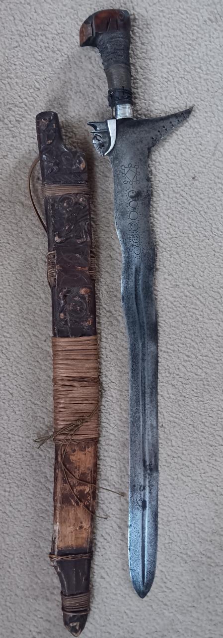

I recently picked this up in a junk shop and it came i the dayak scabbard, the blade was covered in a dry grease ,I've cleaned it up a little , I just wondered if the design has any meaning or just decoration , it's quite a large heavy blade

The symbols would have very deep and personal talismanic meaning to the original owner. For better or for worse though, i am afraid no one today would be able to decipher their exact meaning. Nice junk shop find!

The square engraving is known as the "Seal of Solomon," a symbol for King Solomon's ring. Folk Islam attributed Solomon's control over Jinn to his possession of the ring which came straight from Allah.
The other engravings- the circles- may refer to either stages in spiritual ascent, or energy sources.
Hope this helps, nice kris!

That could indeed be a magickal seal of some sort, but it is not the Seal of Solomon.

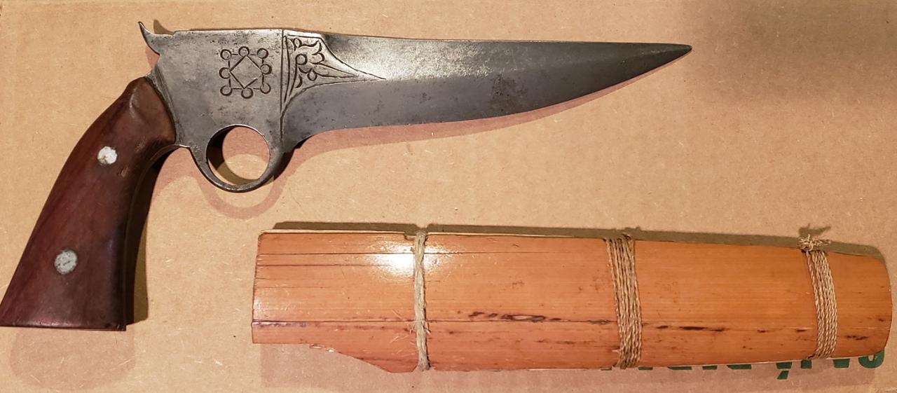

The same symbol on my "gun-ong."
Many of this variant a Ring of Solomon.

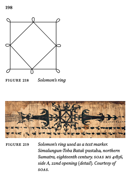

As proof, here's an image and accompanying text entry from one of my references.
Yahya, F. (2015). Magic and Divination in Malay Illustrated Manuscripts. Brill.
"This design is an ancient one- Schuster has traced its earliest appearance to an amulet from Mohenjo-Daro dating to 1,300 BC (at the latest), and it is prevalent in South and Southeast Asia and even in Europe according to Shaw (1971)."
I used "Seal of Solomon" because as noted in your Wikipedia entry, the term is interchangeable with "Ring of Solomon." The image in the book is captioned as "Solomon's ring."
