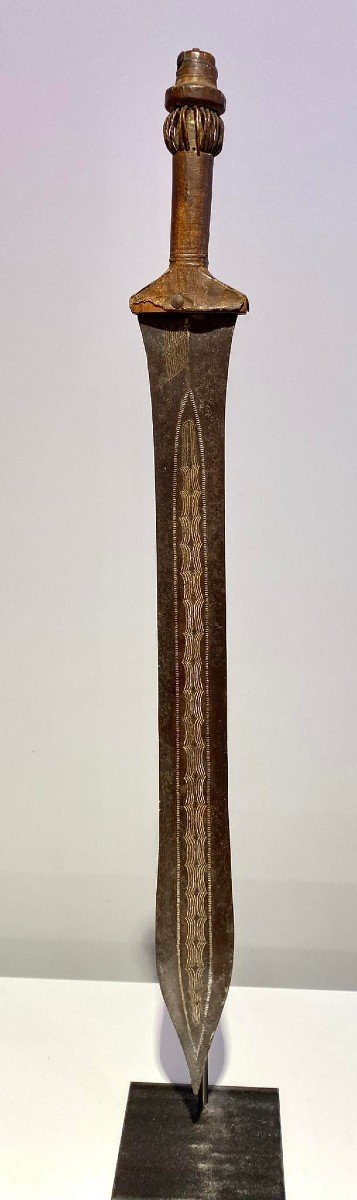

I have one that is very close to Tim's museum example. It appears to have some age. The leather is very thin and covers a light wooden sheath. The leather work was well done but has split in places with age.
The blade has a longitudinal groove down the middle on each side, flanked by multiple small linear marks. The metal (bronze?) hilt is constructed similar to other examples shown here. In hand, I estimate the age of this sword at about 100 years, so early 20th C or possibly late 19th C.
The weather was not very cooperative today for photographing today. If anyone needs better quality pics, please let me know.
This one came from a Swiss auction house in Basel. It was listed as a Yaka Ceremonial Sword and said to be called "mbeeli ya phoko."

Got the sword.
Well, what can I say – a real African gladius.
In general, the sword pleasantly surprised me with its quality of manufacture. If you don’t take into account swords with European blades, then, perhaps, such quality of forging is rare for Africa, except for Berber fleece.
A fully functional item, definitely not a souvenir.
Overall length – 580 mm, blade length – 455 mm, blade thickness – 6-7 mm, weight – 508 g

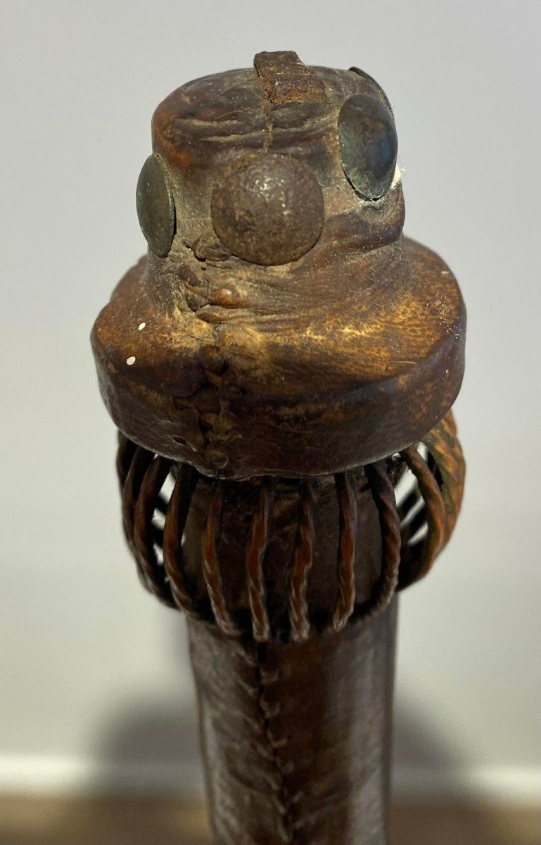

The wooden handle is covered with leather. Upon careful inspection, I came to the conclusion that the pommel could have been in the shape of a cone, but was broken off during use.

Nice sword Pertinax, and the patina on the hilt and blade do suggest some age. The presence of these upholstery nails does seem to indicate a late 19th/early 20th C foreign influence. Perhaps it was simpler (and cheaper) to use brass nails to embellish the hilts rather than some of the traditional cast brass/bronze elements. There appears to be residue from an old polishing compound between and around the nails, again an influence from outside the culture.
This is not an old polishing compound, this is leather. The handle is wooden, covered with leather.

I was referring to the white material that surrounds many of the nail heads. I realize that the base is leather, but the white material is not leather. Another possibility is mildew resulting from some moisture on the hilt.
This is mold on old leather.
Do you think, Ian, that we can determine the age of swords like this by the upholstery tacks?
