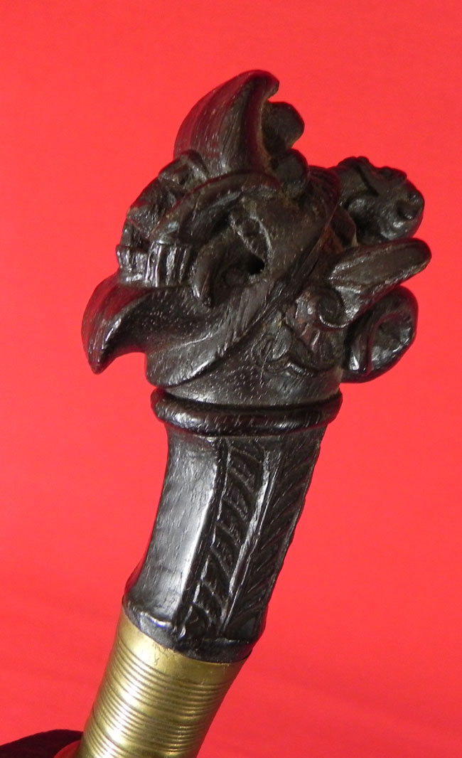

The second piece with the ebony carving seems to me to have a Visayan look, perhaps like from Panay Island.

The pommel on the ebony(?)hilt seems reminiscent of the Lasara motif seen on Nias swords.
This figural hilt is definitely not from Nias. I do see where you are coming from. However, the carving details and ferrule as well as the blade don't vibe with Nias (nor any related cultures).
There is a Nias hilt style that seems even closer to Carlos' example than the most well known Nias sword hilt. Let me see if I can dredge up a pic for posting.

I agree that the other blade might well have a Lumad origin, especially Mandaya and possibly related groups; even despite figural hilts not being documented from this area ...
This does not look Mandayan to me. The hilt would be highly unusual, as would the inscribed blade. Also, the blade lacks the little "nubbin" along the cutting edge where it angles down sharply. Incidentally, I think the right hand sword in Carlos' picture of five is Mandayan, showing the typical hilt form and blade with (what I think) is that small "nubbin" on the edge.
... also neighbouring Visayan islands may be a possibility. Do I assume correctly though that the edge doesn't exhibit a chisel grind? ...
There's a lot of Visayan odd deity hilts but I've not seen one like this, especially with curly hair. It's sort of reminiscent of a Sinhalese lion with that curly mane.
Yes, it is. However it does not help unless we find a provenanced example to align it with: For the time being, just ignore it and focus on the blade, please.
It's certainly not one of the major types. While this strongly curled hair can be also seen with some Indonesian groups, I'd be inclined to believe we might see some Chinese influence here.

For the time being, we have no convincing contender for this hilt.

I don't think that the sword under discussion is Indonesian.

I would love to see a picture of this hilt face on. These side views are not really helpful in getting a full picture of this hilt..
