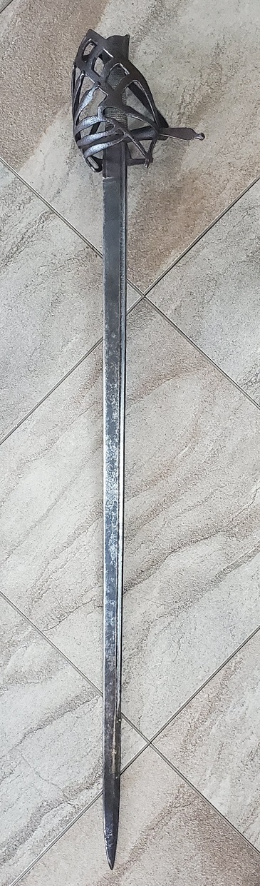

This is of course a schiavona, which is a trellis hilt sword most famed for its used by body guards for the Doge in Venice, typically from Croatia (hence the term schiavona, loosely referring to 'Slavic'). What is seldom realized is that these most impressive swords were widely used elsewhere in Italian contexts and regions.
This example is a cavalry sword, suggested by the latter 18th c. backsword blade similiar to horsemans swords of various other countries of the period.

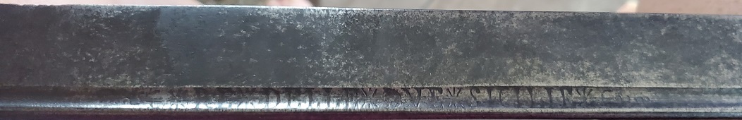

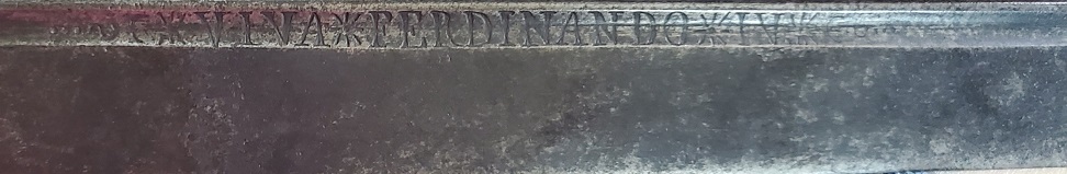

What is most interesting, and telling, is the inscription in the blade's fuller,
to FERDINAND IV of the kingdom of the TWO SICILIES.

Your blade is similar to that of the Dragoon sword made at Toledo about 1761 to 1780.
Ferdinando IV of Naples was son to Carlos III of Spain. Carlos III was previously king of Naples where he erected a weapon factory at Torre Annunziata in 1758, built by the architect Sabatini. When Carlos came to be king of Spain, he repeated the concept in Toledo from 1761, with the building again by Sabatini (1771).
I wonder if the Due Sicilie inscription was added later.

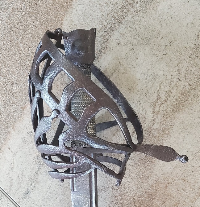

Jim, thank you for posting this most interesting sword. The hilt looks like what Ewart Oakeshott describes as a Type 2 schiavona in “European Weapons and Armour” (1989). I therefore wonder if the hilt might be older than the blade? I’m under the impression that the second half of the 18thC is more associated with Types 2a and 2b schiavonas, which also tend to have bronze cat’s head pommels.

I agree this hilt is quite possibly older than the blade but certainly in 18th c.
I have not quite understood whether the brass catsheads were of a period or other specified use.
