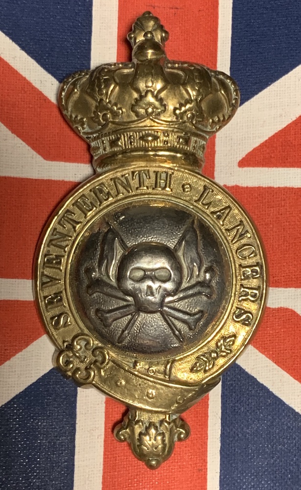

On October 25,1854, at Balaklava, the British Light Brigade cavalry with five regiments led by the 17th Lancers charged down a valley into Russian guns and immortality, thanks to the poem by Tennyson.

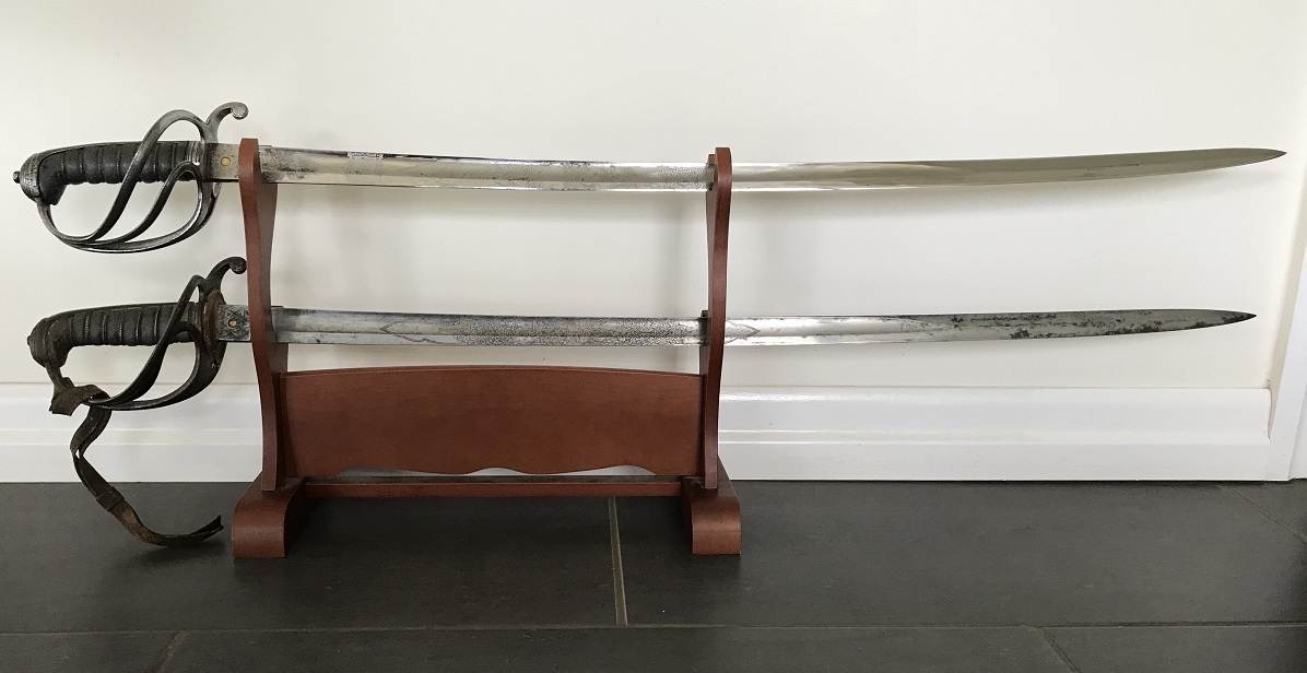

Always fascinated by British cavalry in my youngest years of collecting, I sought to put together an assembly of swords as used by these units that day.
While the swords only serve as 'of the type', they present a view of what the swords carried in 'the charge' looked like, and are not claimed to have been actual examples of that event.
Attached:

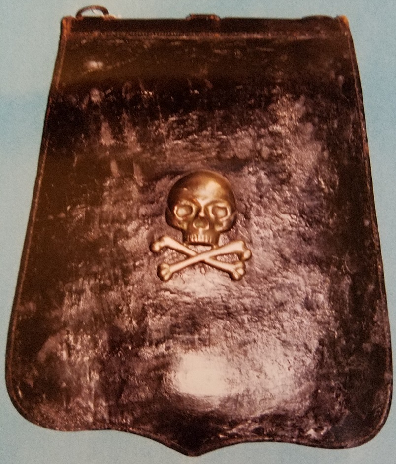

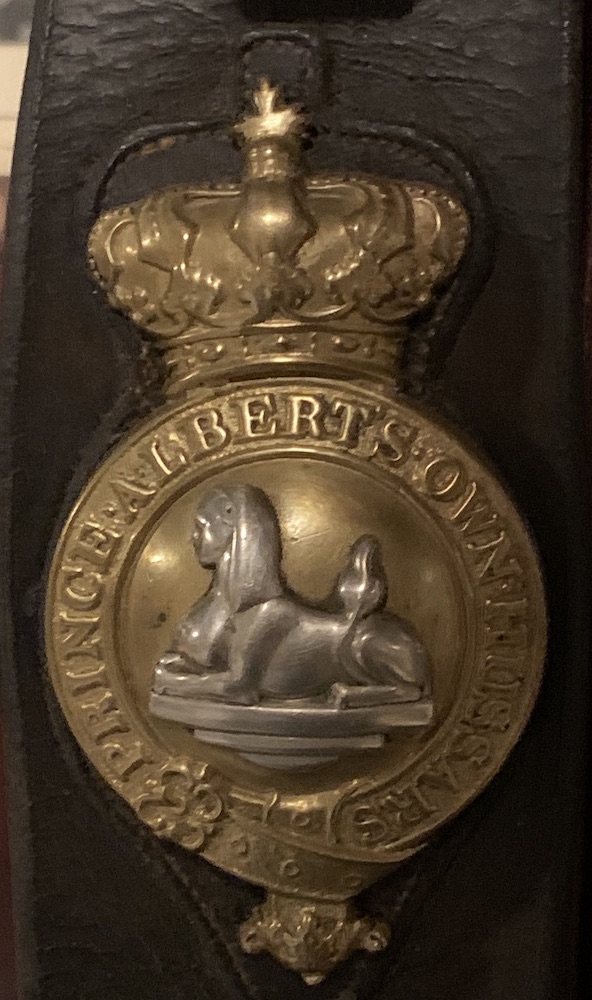

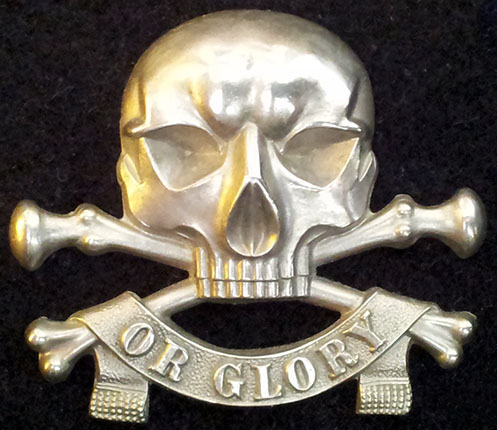

The painting of the 'charge' with 17th Lancers leading; the cap badge of skull and crossbones; the leather sabretache (pouch to carry orders) is believed or the period with the simple skull and crossbones.
The photo of landscape is the Balaklava valley as seen today, now a vineyard.

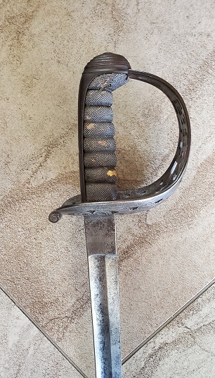

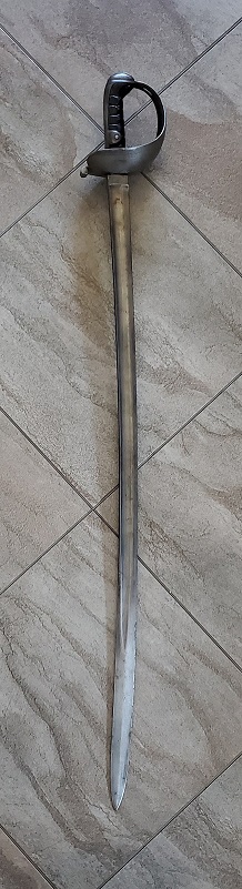

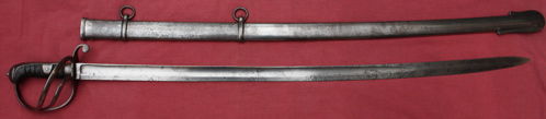

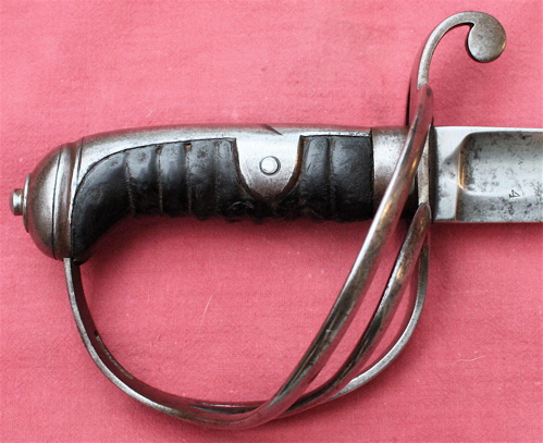

The M1821 light cavalry saber with three bar hilt as carried by the troopers of all four regiments 17th Lancers, 11th Hussars, 8th Hussars, 4th and 13th Light Dragoons.
These were being superceded by the new M1853 saber for both light and heavy cavalry, as seen in the example which is by Kirschbaum, Solingen who produced many of the first examples. It is now known that many of these Solingen examples by this maker were among the swords carried by both light and heavy brigades at Balaklava.

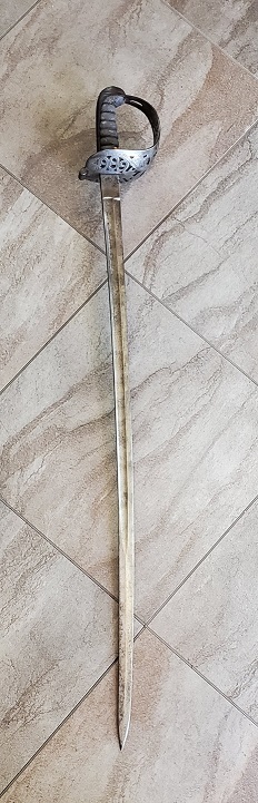

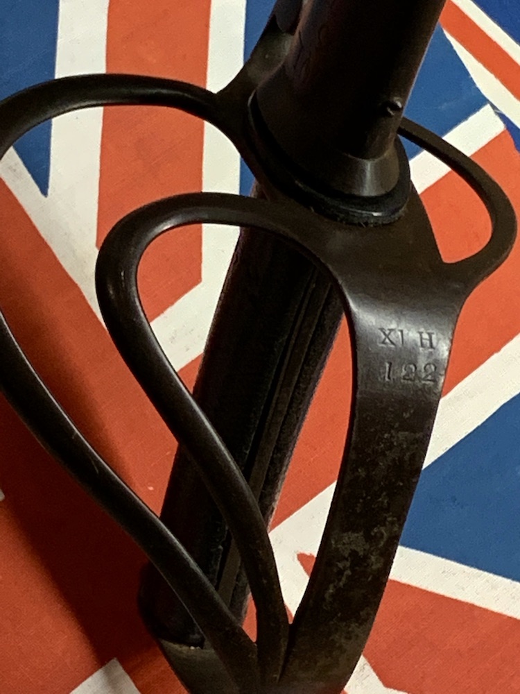

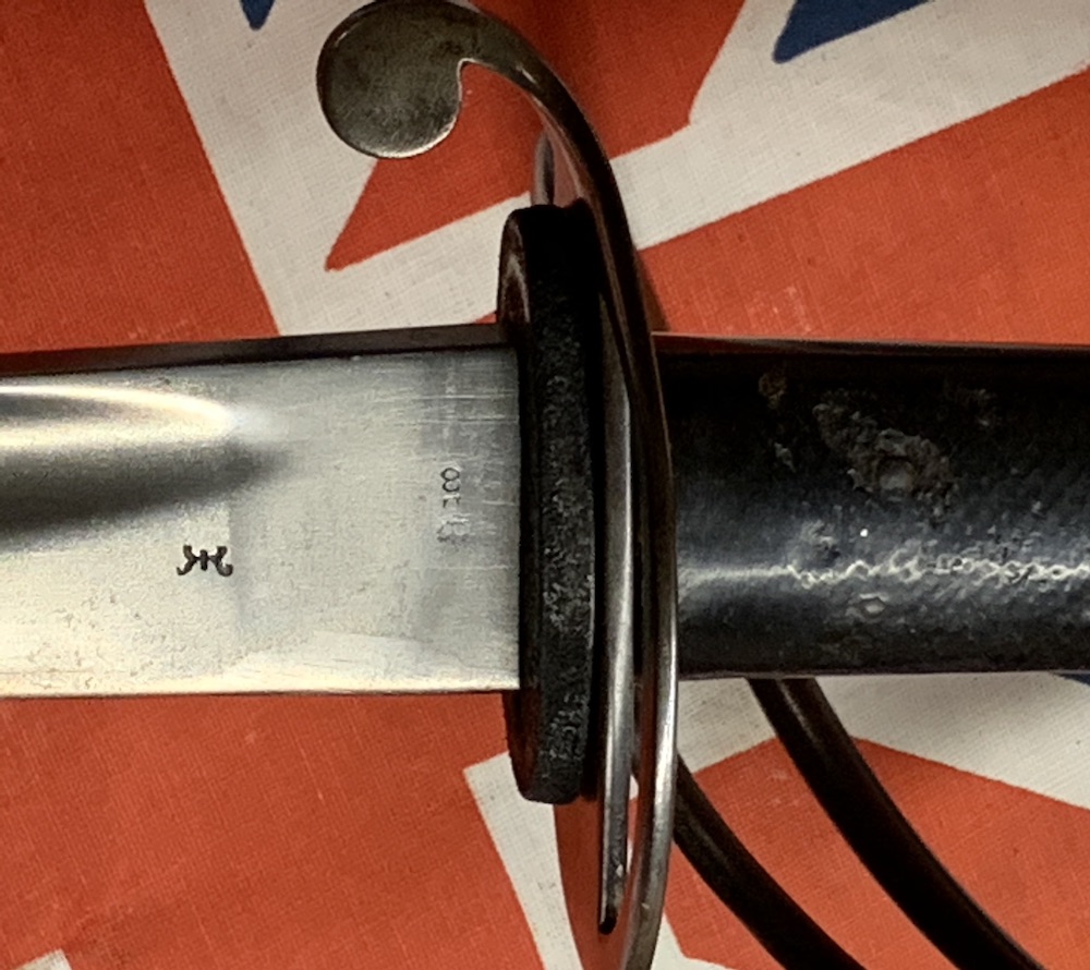

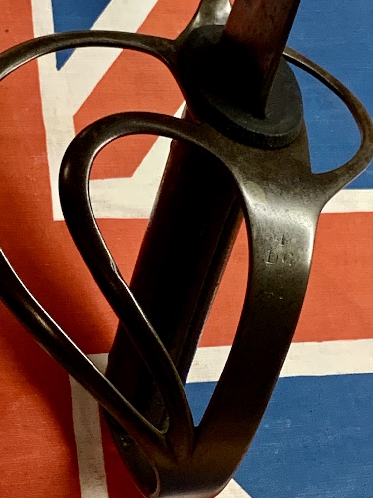

Some of the earliest 1853p swords were also Liege marked. There were soon reports of the new 1853p blades bending at the hilt due to thinner tangs as these two 1853's have. The guards themselves thinner with thinner bars than later examples by Mole and Enfield.
Pictured are two 1853p Liege marked 1853p swords, marked to the 11th Hussars and 4th Dragoon Guard. One 1821p HC sword marked to the 4th DG.
And for interest a 17th Lancers and 11th Hussars martingale.

BRILLIANT WILL!!!! Thank you.
It is truly exciting to see examples of these swords of the types used and with regimental markings which of course profoundly suggest their presence in the famed charge is possible.

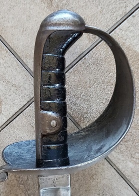

The information on the M1853 is most interesting, and I was not aware of the Liege examples. Richard Dellar's outstanding book was where I had heard of the Kirschbaum models which were supplied to the units for Crimea.
It seems that Reeves produced these as well, as he had established the new patent hilt with the tang sandwiched with grips riveted to it.

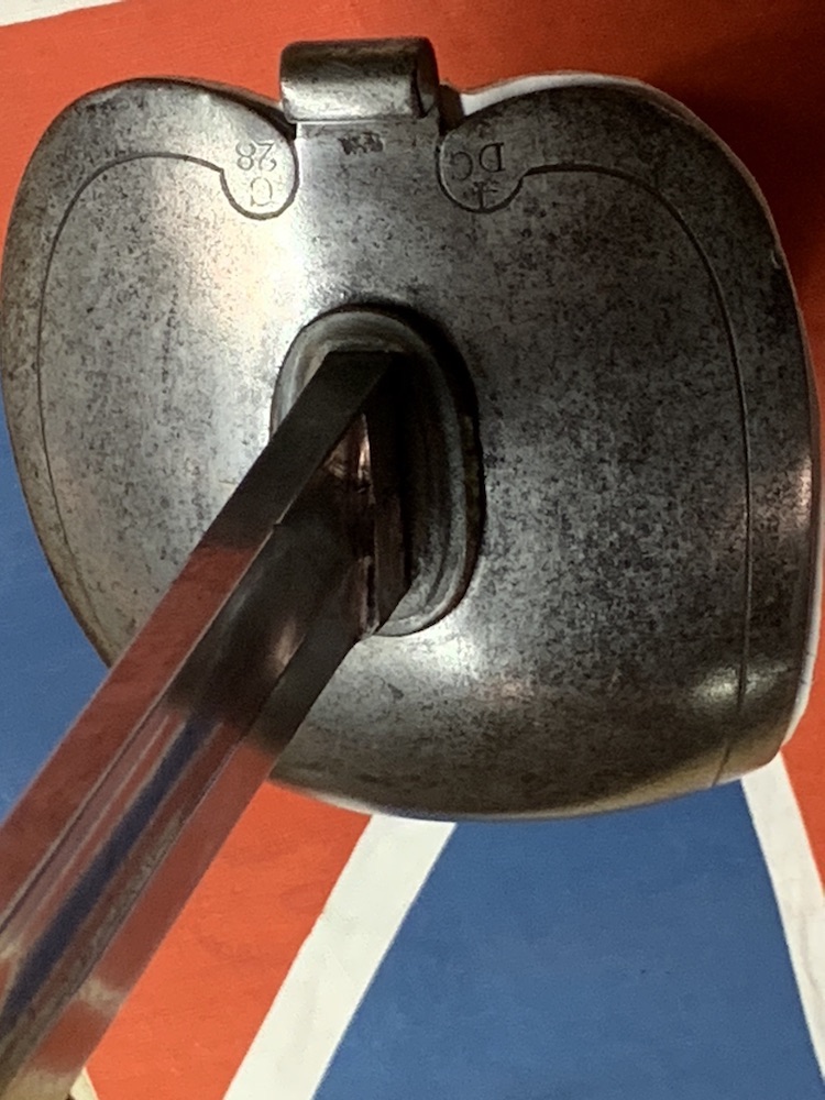

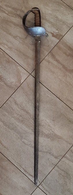

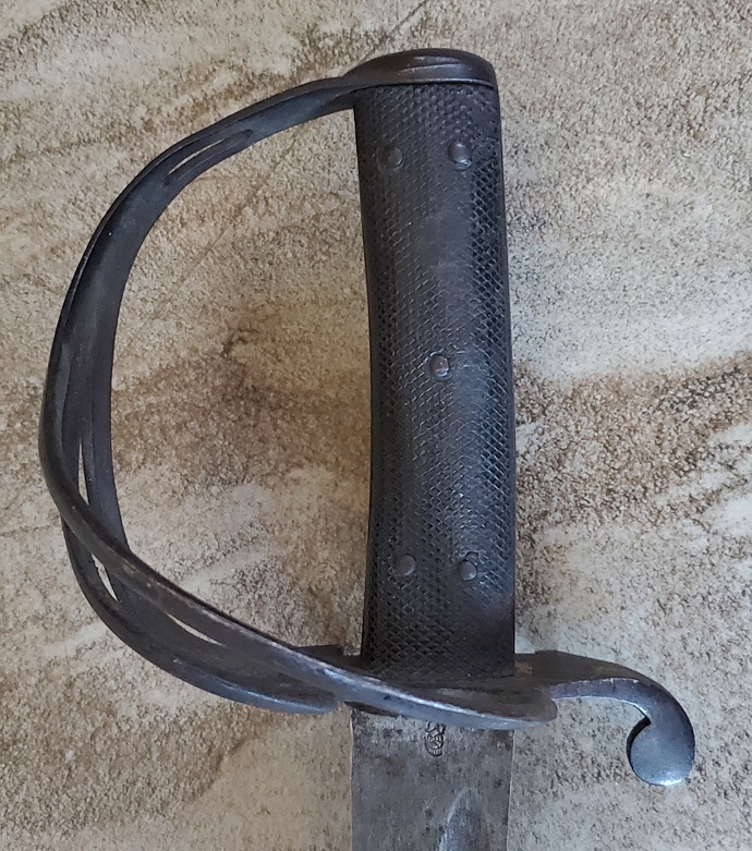

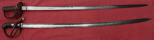

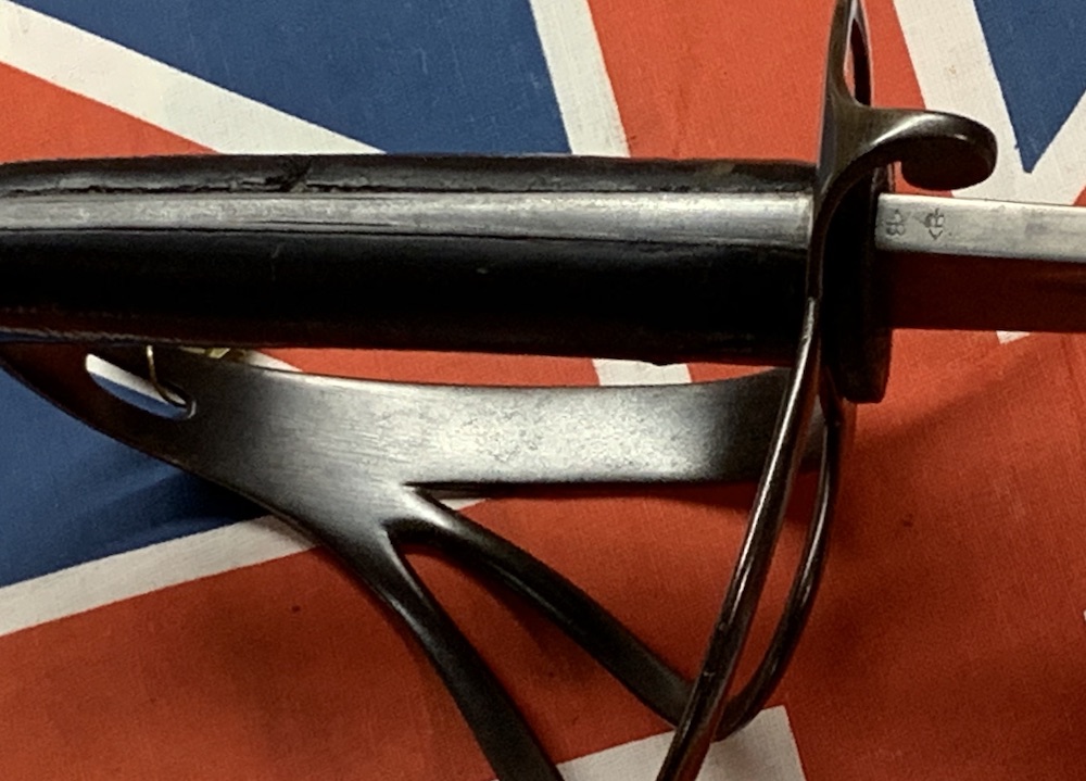

As shown in the last image the 'bowl guard' M1829 saber for heavy cavalry was used in the not as well known charge of the 'heavy brigade' just subsequent to that of the 'light brigade'.
From what I recall both the light and heavy versions of these sabers were initiated in 1821, with issues developing and production was halted until 1829...thus confusion on 1829 vs. 1821.

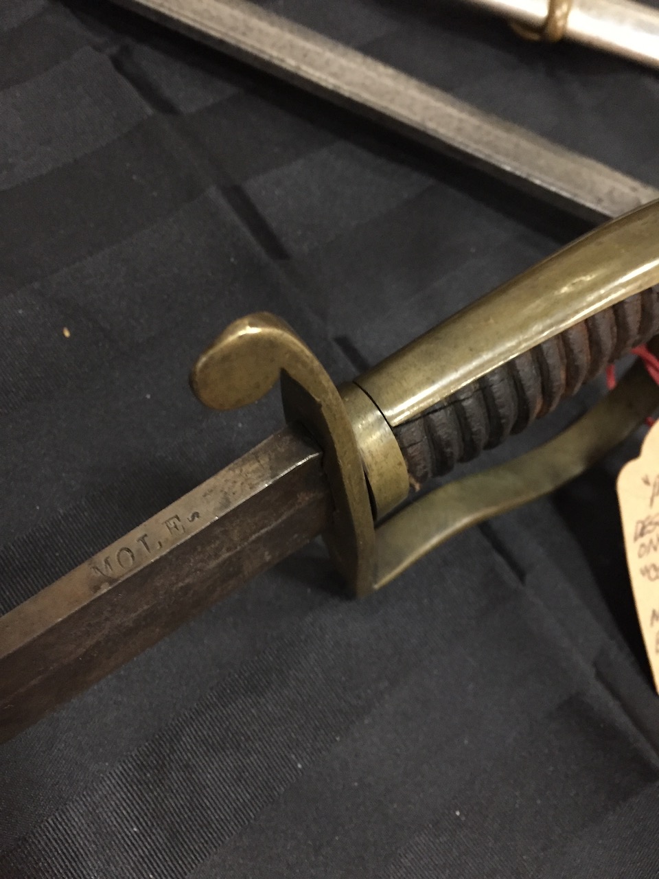

Attached are the two 'bowl' guard 1829s I have, the one without the 'ears' on grip has a curious straight blade (by Mole) which I have believed was a modification for use in training?
In those days(only references were Robson and Wilkinson) mid 70s it was believed these were hard to find because of many of these used for naval cutlass conversion prototypes, training swords and numbers destroyed in a fire. It took quite some time too find these examples I have, though not exactly stellar quality.

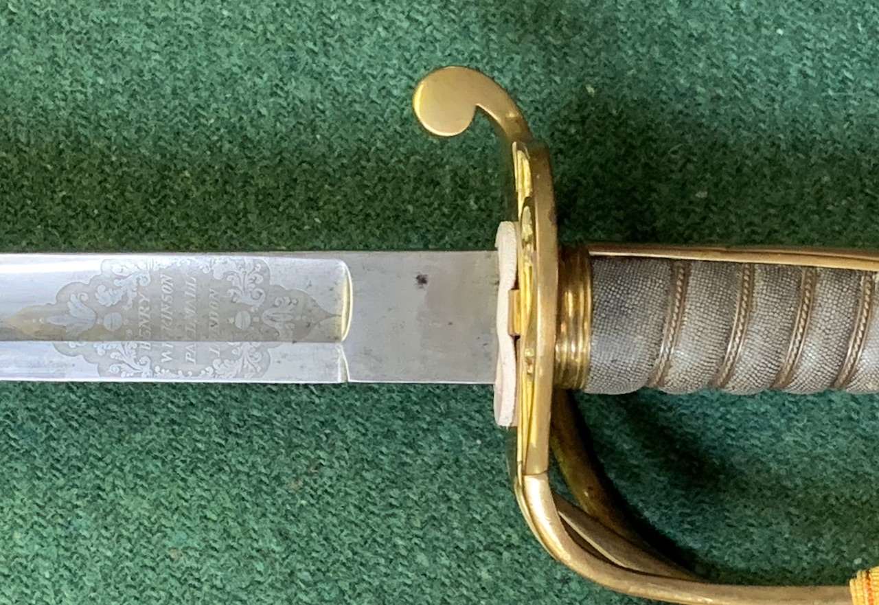

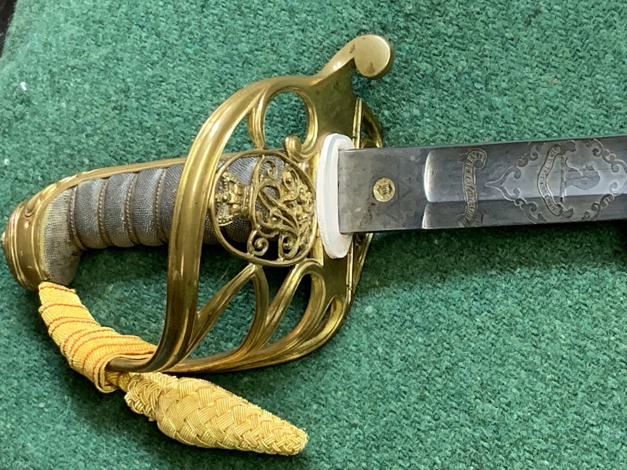

The officers version of the 'bowl' guard heavy cavalry was pierced, this example by the Hamburger, Rogers outfitters.

Jim your straight bladed Mole 1921p if for training would most likely have a rounded point as seen on other training swords.
I would suggest Mole made some prototypes or an officer had this one made as a fighting sword.
At the onset of the Crimea War Enfield was struggling to supply war materials. European made 1853p swords were inspected at Liege as not to make a trip to England and back just for proving, even furthuring the wait times.
The 11th Hussars sword interstingly has a 16th Queens Lancers scabbard which makes sense since the regiment was posted to India for 10 years after being in the Crimea as was the 16th QL. Procurment of sword parts seemed to be scavaging parts to more quickly equip the troops. Since the British Crimean cavalry were outfitted with the new 1853p sword before the war ended, it makes sense these Liege swords were one of their first issues.
I was under the impression the Kirschbaum swords were made and issued later in the Crimea War. Being govt. issue swords none of the 1853p swords became presentations for the war and we see the previous pattern, the 1796 LC swords with inscriptions on them.
It can be debated Liege and or Kirchbaum but the thin tangs that drew criticism for bending with the first issue 1853's are evident on the Liege marked swords. The tang may look thicker in the photo, but there is sheet metal on either side of the tang as grip backing plates which makes them appear slightly wider. These tangs do measure considerably less than later 1855 made Mole swords. Liege tang thickness at guard: 0.210 and the Mole of 1855 manufacture: 0.340 Both taper towards the pommel. 0.130 difference in thickness is not manufacturing tolerance but a change made to strenthen the tang of the 1853p.

That is interesting on this curious blade, and perhaps that an officer might have had this fabricated as a fighting sword makes sense. That would explain the absence of 'ears' , but the acceptance marks on the blade (which do not typically appear on officers sword blades) threw me off.
The straight blade intended as a fighting sword also makes sense as the conflict of thrust vs. cut had been ongoing since the late 18th c. I'm sure there were officers who were proponents of the thrust who might have followed this course.

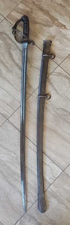

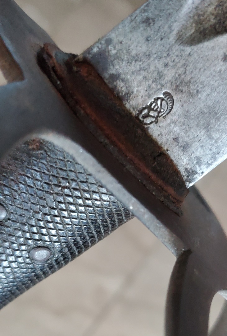

Hi,
The P1821 L.C. sabre I have is by Osborn. The single number acceptance mark denotes, as far as I can remember, a date of issue prior to the 1840's. I have photographed it with a later P1821 H.C. officers sword by Wilkinson. They have similar profiles but the L.C. sabre is much more robust in all directions.
Norman.
P.S. The old photograph is from the Crimea and I believe the sword is the P1821 L.C. version.
