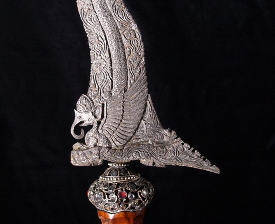

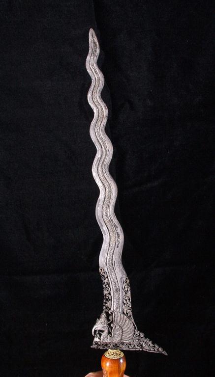

So here is one of my favorites and am using a name that comes to my mind. The Elephant. I invite your comments. Thank you, Bill

I understand that you do not feel knowledgeable enough to comment further on your keris in terms of technical details, but perhaps you could expand upon why this is one of your favorite keris.
I also have a keris in my collection that has a winged, crowned elephant motif at the base of the blade as does yours. It is a contemporary blade as i believe yours is as well. I have never photographed this blade and it is currently in storage so i probably won't be showing it anytime soon, but i have seen this motif many times. It might be interesting to aim at least part of this discussion at the symbolism behind this creature.

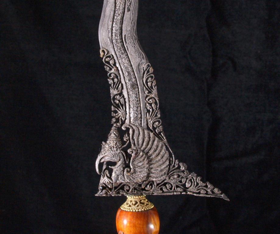

Hello Bill,
The winged elephant motif on the sorsoran is normally part of the dapur Lar Monga with 3 waves, or Liman Lar with 11 waves, not 13 as your blade.
I can understand why you like this blade because the design and workmanship are quite spectacular, what puzzles me is that the style of the elephant head is different on each side?
As said by David, I think that it is probably a recent creation, normally the blade is not carved through like yours, see a more traditional blade with dapur Lar Monga/ Urubing Dilah.

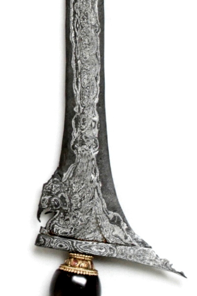

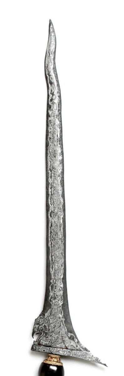

Jean, i believe that Bill is actually showing us two completely different keris in his post. The style is not different on each side. These are not the same blade.
David, I just like the elephant and how the trunk comes into play. I do believe it is more recent, but the carving is very nice. Amazing work.

I was in a hurry and added in the second elephant keris not meaning to do so, nor to confused.

Bill, you have invited comment on this keris.
Are you able to be more precise in respect of the information you would like to receive?
The motif in the sorsoran might be able to be understood as a flying elephant, how that might be able to be interpreted might be able to be associated with a Javanese cult, the talismanic qualities that the motif is believed to incorporate could depend upon how it is interpreted.
The name of the motif is manglar mongo (also manglar munga --- and several other spelling variations which can mean different things); the language can be read as Javanese, but it might be Kawi or corrupted Kawi. Over the years several native speakers of Javanese have given me a number of different meanings, and those meanings have varied, depending upon how they felt at the time.
As for the matter of luk meanings, it might be best not to go there, if we wish to finish this thread before Christmas 2019.
