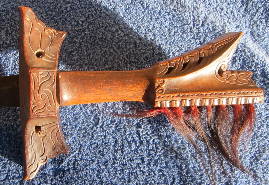

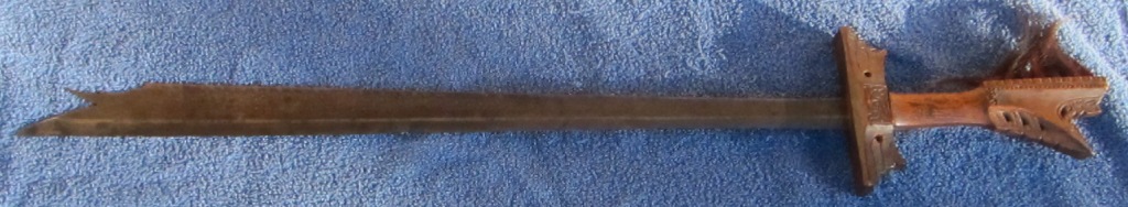

We do not see many of these in the UK, so I was pleased to get this yesterday.
Excuse the photos, my abilities with cameras appear to get worse.
Anyway, comments please.
Total length 37" with a 28" blade.

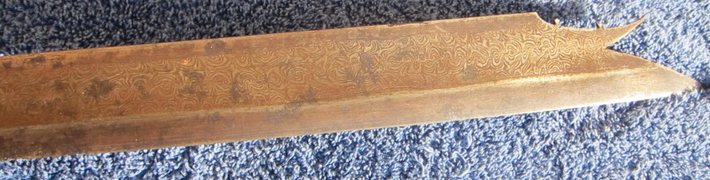

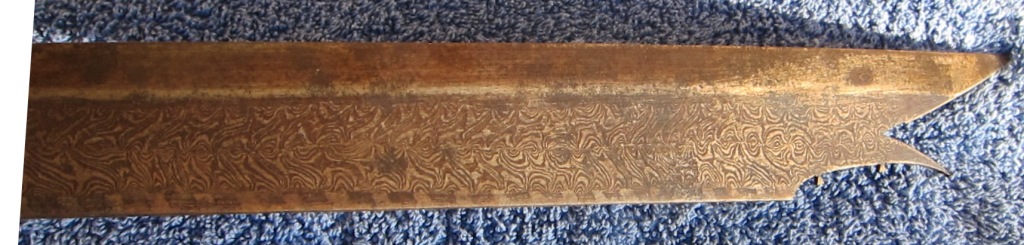

Nice patination on the blade.
Hairy bit on the wrong side of hilt ?
I have not touched it, should I clean the blade ?
Roy

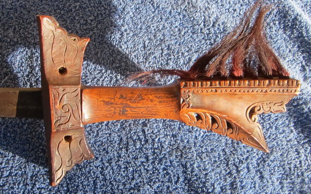

hilt appears to be upside down. as you thought...
here's one the right way up - does look a bit odd that way, so i assume some americans brought them home and 'fixed' them (they had a bad habit of doing that with moro kris too): (sadly, the example is not mine)
p.s. - i'd clean the blade carefully & etch it a bit to pop out that pattern, it'll be eye-poppin' gorgeous. seach for cleaning & etching here on the forum. the holes in the guard would likely have had a large iron staple, possibly with a lot of folds like a potato masher, as a further hand protection the bells on my example are a bit unusual tho.
ferdinand magellan was supposed to have been killed with one.
edited - added a grip example. not all had a potato masher tho, but the holes suggest yours did. they usually wrapped the grips too.

Hello Roy,
<snip>
I agree with Wayne that there was an iron guard present in your example (and that some rattan braiding would complement the grip). Actually, if I read the wear correctly, I believe it once had a guard on both sides!
The attachment of these iron staples varies quite a bit (as does the bending of the guard); however, holes going all the way through the (usually but not exclusively) wooden crosspiece are the norm - even with pieces that have only a single guard.
Old 28th November 2017, 08:15 PM   #6
Hello Roy,
Congrats, kampilan with twistcore are very rare! Just in case you get bored with it...
Yes, someone turned the hilt upside down. Should be easy to correct and will offer an opportunity to work on the blade, too.
Any active rust should be removed. It looks like it got etched with ferric chloride and this often stimulates development of new rust. Thus, some gentle cleaning, additional neutralisation and extensive washing might be a good idea.

I agree that the blade is upside down, and as Kai said it is easily fixed.

I think it could have had two iron guards as the holes go all the way through the wooden cross guards - or is this normal ?
I do have two more, much plainer examples. One of them has holes all the way through and the other does not.
As regards cleaning, I was not asking how but rather "should it " be cleaned as the patina is, in my opinion quite attractive.
Cheers
Roy
I'm not sure what you refer to as patina in this case.
From the pics, there is the obviously etched twistcore which certainly is attractive! This certainly should stay visible and stable for long-term storage; arguably, how much contrast would be suitable and culturally appropriate in a Moro setting is not fully established yet. This is certainly something which would need to be discussed while working on the blade since the results of different treatments can't be fully planned beforehand.
Possibly over the etching, there are patches of older rust incrustations which might compromise long-term storage/preservation; these should be completely removed IMHO.
Finally, there seems to be a fairly even layer of active rust all over the surface - flash tends to emphasise this while the naked eye (and automatic color correction in our brains) often glosses over it. As said above, this is a fairly common result of etching with ferric chloride: Even if you thoroughly neutralise after etching, you still have to make sure to wash off all chloride ions or they will continue to bite into the iron... (Chloride ions are the main reason for table salt or seawater being corrosive!)
Thus, I'd suggest that this blades needs and deserves a thorough cleaning. However, you have it in your hands and can have a much closer look than just basing your decision on a few pics alone.
