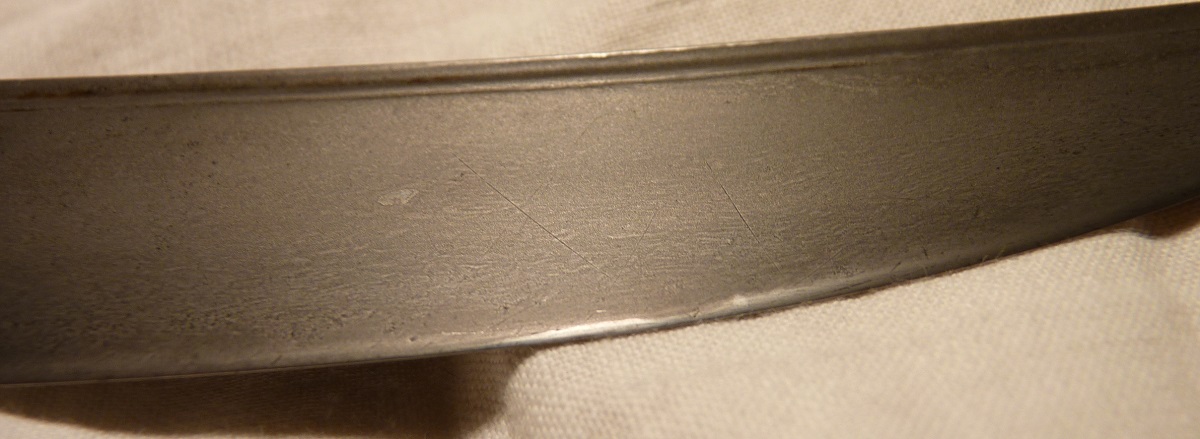

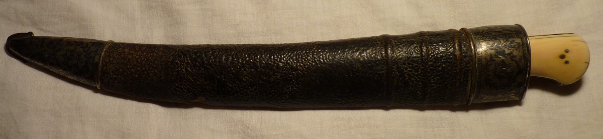

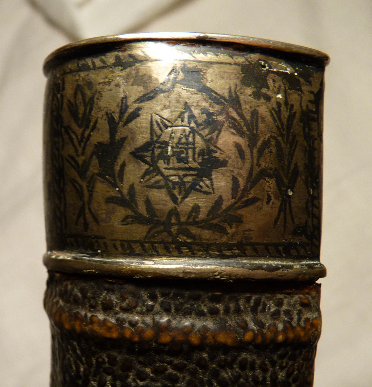

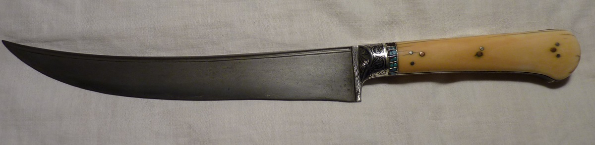

I have recently purchased this knife. Grip is ivory, blade looks like watered steel. The scabbard is leather with niello mounts. My resarch points towards it being from Uzbekistan, any comments on origin and age would be much appriciated.

Very, very nice!
It is indeed Uzbeki knife P’chak ( which means exactly what it is : a knife, Turkic dialect).
This variety with gradually narrowing blade and distinctly curved profile is usually generally referred to as “ old Bukhara” or “ old Khokhand” , and in Russian is usually called “ Afghanka” ( kind of feminine of Afghani).
The entire north of Afghanistan is populated mainly by Uzbeks and Tajiks, the latter being the second largest minority behind Pashtuns.
Please notice the nielloed coat of arms of Afghanistan, the Blue Mosque in Mazar -I- Sharif. This city is ~ 60% Tajik.
I think this P’chak actually comes from Afghanistan, made by an Uzbeki bladesmith for an Uzbeki owner.
Generally, the majority of Uzbeki knives have blades of two forms: Kaike, with the raised tip, and Tugri, with straight spine. The story goes that Tamerlane banned the manufacture of straight bladed variety to minimize their use as stabbing weapons.

Nice example, it is Afghan work as Ariel observes, following an Uzbek prototype quite closely. It dates to the eary 20h century.

Ariel and Oliver, I am quite amazed at the depth of your knowledge and greatful that you are willing to share it. I had no idea that it was the coat of arms of Afghanistan on the scabbard, but it is of course quite the clue to its origin.
