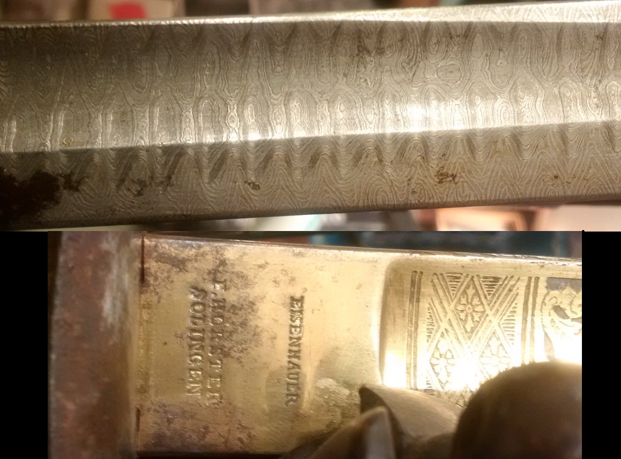

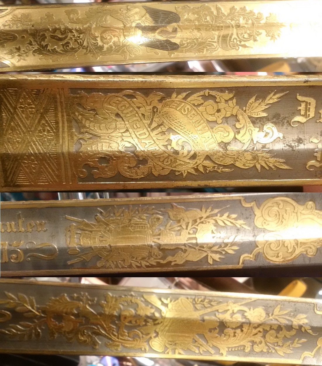

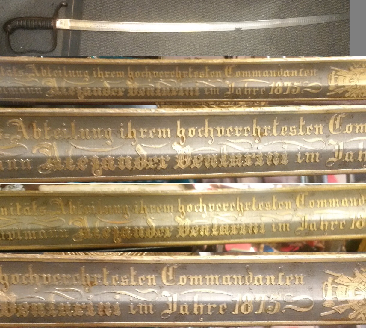

Here's Solingen presentational sword with gilt decorations and inscriptions and fine damascus pattern.

Hi Alex,
This is a magnificent Prussian army presentation sword! and the intriguing letter font using what appears to be 'fraktur' adds to the handsome etched inscribed panels and decoration.
This stirrup hilt form sabre is of course long standing from Napoleonic period through the 19th century and actually continued up to WWII.
While I cannot translate the words exactly it appears to denote a particular regimental 'command' and the sword was presented to a hauptmann (captain) of this unit in 1875.
The high quality blade is indicated with the term 'eisenhauer' (= iron cutter) both in the blade above makers name at forte as well as in the decorative flourish etched on the blade (iron cutter etched in damask) . The etched Damascus pattern is decorative of course.
F. Horster was of this Solingen family of producers with Friedrich listed 1825-1875.
Hello Jim,
I know next to nothing about the blades from my own country but I am maybe able to help with the inscriptions. I've googled a little bit and found that the term "EISENHAUER" is a quality grade and mean that the blade is proved by "Nagelprobe", a prove of the edge quality when I understand correct.
The other term seems to say that the blade is from real Damascus also when I would agree with you, it look like "fake" Damascus. But the term say clear "real Damascus"!

Posts: 9,771
The other inscription is not complete, who is the presenter from the sword I can't see but it was given to the "more as highest venerated" (hochverehrtesten) commandant....(here again is a part I can't read because not visible complete) Alexander Venkarini (?) in the year 1875. I just need to read it complete.
The Presenter is any division.

Originally Posted by Sajen
... The other term seems to say that the blade is from real Damascus also when I would agree with you, it look like "fake" Damascus. But the term say clear "real Damascus"! ...
I can see why Jim and Detlef saw the pattern as being acid etch, i.e. artificial surface applied. May I question this? Having some resemblance to wax resist method, it lacks the details that such method would produce due to application of a template that results in sequential repeats in the pattern. I do not see such repeats, nor the template being used here. To me this indicates true mechanical Damascus, in line with such stated description on the blade. Is there another resist method that could be used to yield a random pattern, etc?
Old 11th January 2017, 06:37 PM   #8
Posts: 9,771
Alex,
now I am very sure to see real pattern welding and I am not surprised about this. It's not only a identification by seeing but also a matter of feeling. I am sure that the blade is pattern welded. Roland could be a candidate to tell more about this.
Old 11th January 2017, 07:14 PM   #9
Lightbulb
Hello Alex,
The upper part of the blade is clearly pattern-welded: the darker sigmoid pattern (my added green line) is the lowest pw part.
The pattern below this line is clearly faux in my book: despite trying to look like pattern-welding, it is quite erratic and just doesn't make sense from a blacksmith POV (I have indicated a few of the more obvious areas that look problematic. I believe this was done to also decorate the inserted edge en suite with a similar pattern.
I reckon not many lay people will recognize this trick; I believe the etched pattern (or rather the wax) was drawn by hand - a technique also utilized in other regions of the world (in varying quality).

Old 10th January 2017, 05:45 PM   #13
Posts: 9,771
Originally Posted by fernando
Can you translate the text for us ?
I would be able to translate it, it's German text but not complete.
Old 10th January 2017, 06:15 PM   #14
Perhaps Alex is able to show us the whole inscription ?
