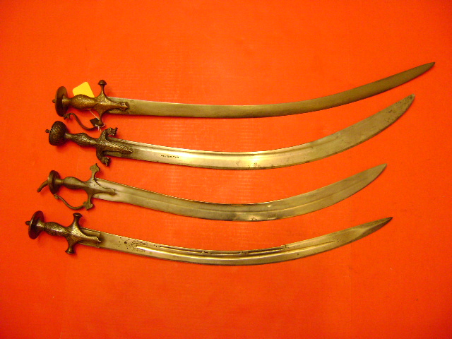

Here are pics of 3 short Indian sabers of mine.
The upper one is a standard tulwar with blade length of 29.5 inches ( straight line)
After that, top to bottom there are: 27, 25, 26 inches.
The upper 2 of them can be characterized as teghas: blade width 1 1/2 inch for both vs. 1 1/8 for the standard tulwar.

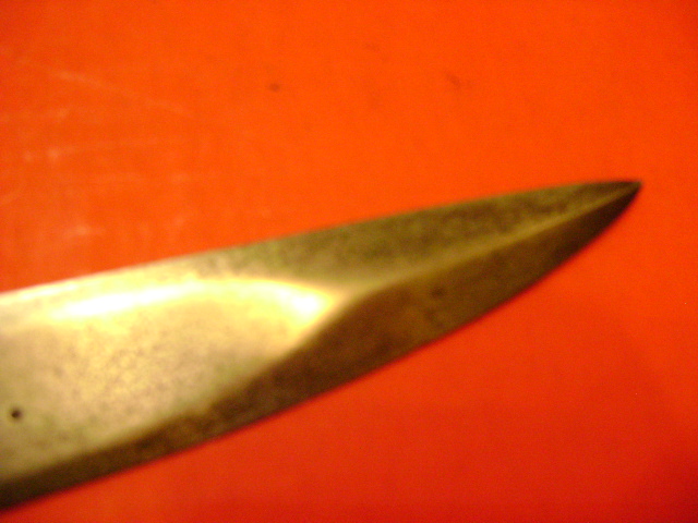

The lowest one has reinforced tip: definitely designed for stabbing.
All have non-standard handles ( well, the lowest one is a typical tulwar, but 100% intact. That counts for a "nonstandard" these days and age:-)
My attribution:
The upper one ( with the pulwar handle) is likely Afghani, although I would not exclude Central India

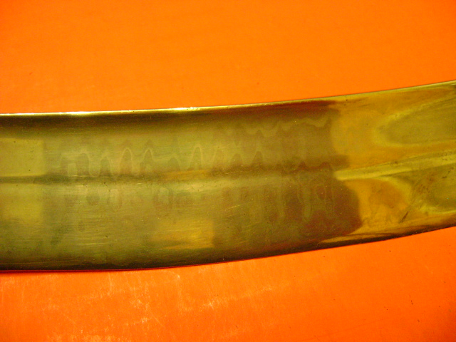

The next one : Deccan. It is mechanical damascus.
The lowest one....Afghani? Judging by the fullers?
All 3 look like infantry swords: they would not be good for slashing from the horse back.
Please help me attribute, date and otherwise define them.
Thanks.

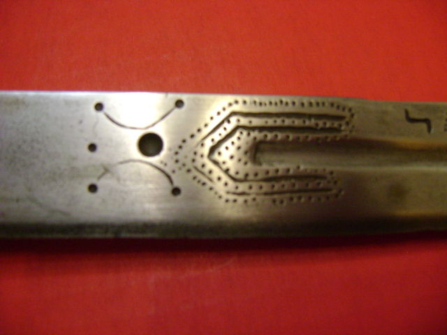

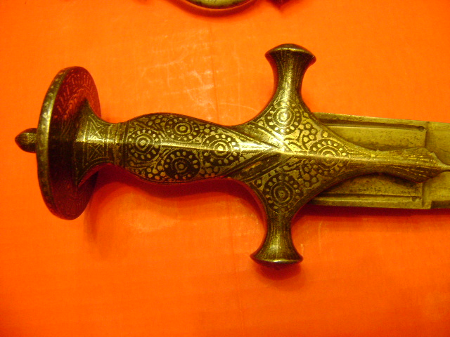

The hilt shown in post two looks a lot like the hilts shown in the thread started by Emanuel - is it quite the same decoration?
http://www.vikingsword.com/vb/showthread.php?t=11025

Hi Jens, as I understand Ariel's post the top sword in his initial image is a standard sized tulwar intended to give scale to the next three.
The questions Ariel poses are regarding the next three swords (2-4 in his image).
Old 29th December 2015, 12:58 AM   #5
Iain,
Thanks for the explanation.
Yes, the uppermost sword is just an example of a standard tulwar, just to give an idea what do I mean talking about "short" sabers ( ##2-4)

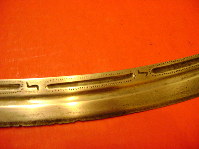

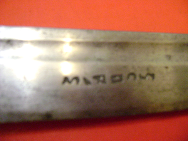

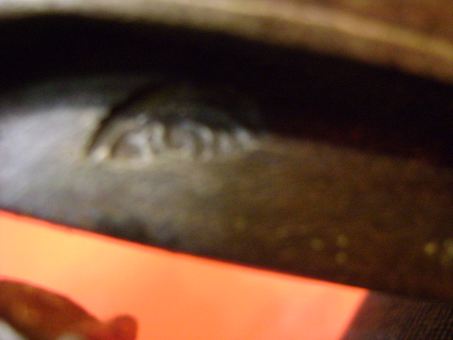

I know the formatting of how the forum displays images can be tricky, but the image of the script on one blade corresponds to sword #2 with the pulwar hilt? Looks like a stamp hiding near the pulwar hilt as well? Or have you IDed that stamp already?
Old 29th December 2015, 02:19 AM   #7
Yes, the inscription belongs to the pulwar. And yes, there is a very small fragment of the stamp, literally a sliver of an arcSplinter of a letter, nothing else.

Re. similarity between the example by Emanuel and mine ( #4, or the lowermost).
There was a suggestion, that the Emanuel's was decorated with Bidri. Don't know about his, but have doubts re. mine.
AFAIK, the objects to be decorated by Bidri are made of copper-zink alloy, then inlayed with silver and then their copper-zink background is blackened by a secret recipe. Thus, they are non-magnetic. I tested mine: strongly magnetic, i.e. iron , NOT copper-zink.

I measured only blades: straight line from the tip to the quillon block.
I also remeasured several other tulwars , Moroccan nimchas, turkish Shamshirs etc. All of them have blades between 75 and 82 cm.
I could hit the "90 cm" number only when I included the handles .
Size of a cavalry sword was derived from the length of the blade needed for a horse rider to slash at the enemy lying on the ground.
This is why I think the "short" ones were for the infantry. I could bring an argument of very short navy swords, but having "Afghanistan" and "navy" in the same sentence did not sound kosher:-) I hesitate to attribute them to the " youngsters brigade": ## 2 and 4 are very heavy.
What, IMHO, is interesting , is the massive reinforced tip on #4: we were told repeatedly that Indians used only slashing technique, and were not even acquainted with stabbing, and that's why many tulwars have rounded tips etc. What are we to do with this one? :-))

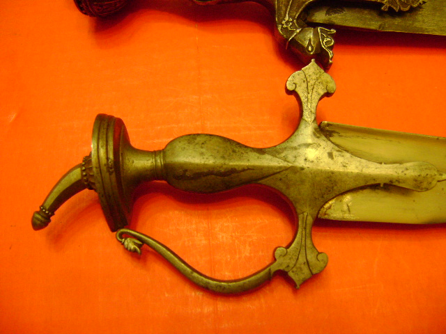

My "Deccani" attribution of #3 was based on the configuration of the handle. I do have my doubts about the blade: it looks kinda like S. Arabian nimcha. Cannot exclude the possibility of a later remounting.
Where did I go wrong with a tilt toward Deccan?

The reinforced tip on no 4 is strange, but I have seen it before. Maybe they belonged to Sepoys trained by English officers. In that case they would have learned the stabbing technique, but I am guessing.
You did not go wrong saying that the hilt was from Deccan, but these hilt types were also used in Afghanistan.

Perhaps, we are talking about different swords and the confusion is entirely my fault.
The first "short sword" has a "pulwar" handle: Afghanistan is my first choice, Deccan distant second.
But I am confused about the second "short" one" I cannot recall such handle on Afghani swords. Deccan or even more south-ward is my assumption. Do you agree?
The 3rd "short" one has a typical ubiquitous Mughal handle, but the fullers on the blade make me think Afghanistan.
