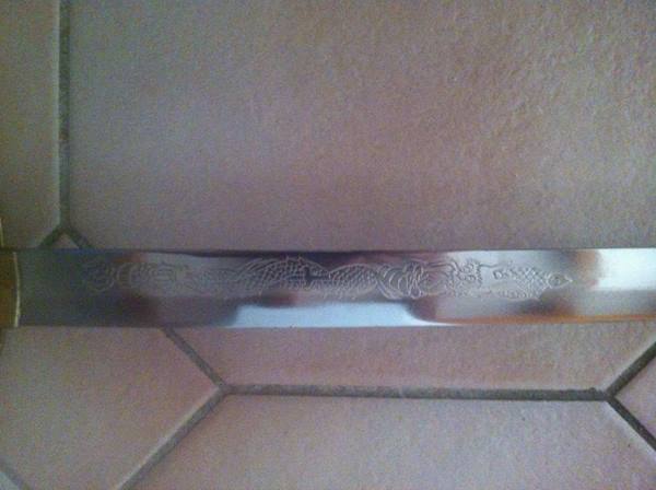

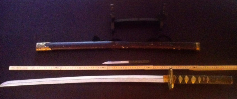

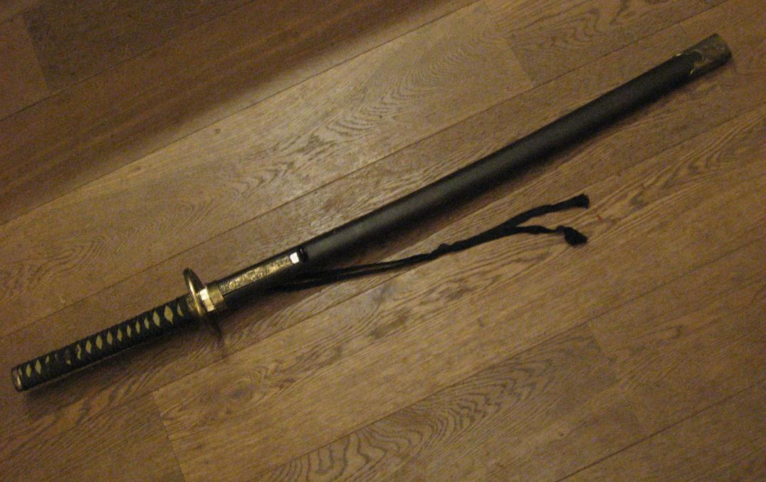

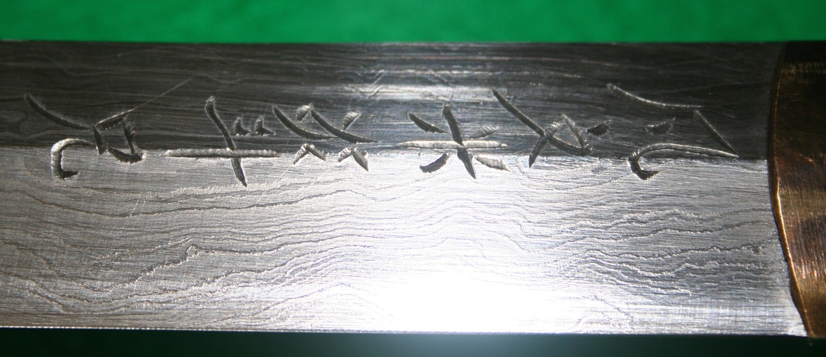

I just buy this japanese sword for few money,
I wonder if it is just touristic stuff or a bit more original
it seems semi-antique, the hilt seems to be made with real ray leather, the scabbard looks old
the blade is sharp, but the dragon engraved in the blade make it look like a bad fake japanese sword.
Have somebody ever seen a real katana blade with this drawings ?
Thank you

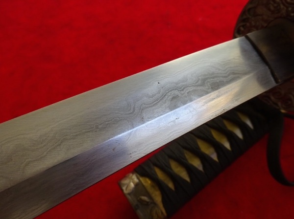

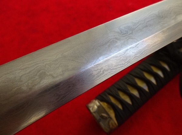

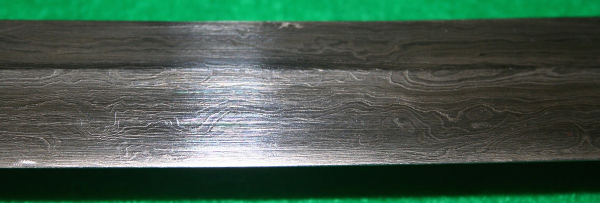

I don't know if that Katana is a fake or real. I do know that the Chinese made modern reproductions, on an industrial scale, of real Japanese swords. I know that because I have two of them, and I am convinced both are fakes. Yours looks different to me. Can you please post a closeup of the blade? I am doing the same for the two fakes I have. Maybe a comparison will help. My understanding is that the blades on the Chinese fakes were given an acid bath to imitate the Damascus steel look. I hope this helps! BTW... I think that is a great looking sword regardless of its age or origin. If it were mine, I would keep it.

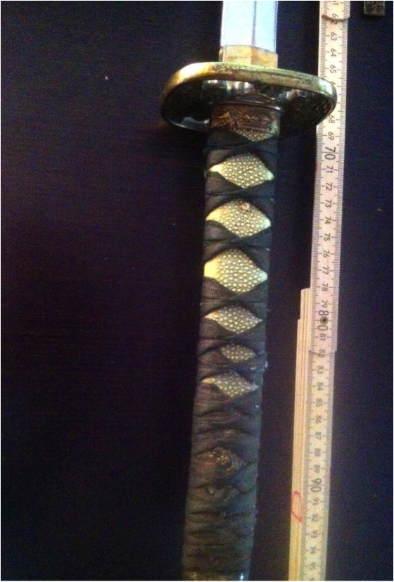

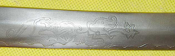

Very poor quality Chinese made 'Sword Like Object' I'm afraid. Pattern welded damascus type blade, ito wrap does not alternate and is poorly done, horimono carvings on the blade are not good quality... I could go on

Francantolin - IMHO, it is a modern Chinese fake. I don't see any hamon nor hada. The dragon carving is very amatuerish and the scabbard (saya) is typical of modern Chinese as is the poorly wrapped handle.
Harry - As you know, yours is also a modern Chinese fake that has been severly acid etched to show the hada.

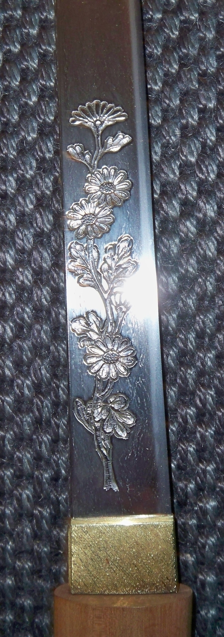

Francantolin, many Japanese swords have carvings on the blade (horimono).

these carvings sure are really nice ! and we can see it's really good quality !!
I'll post more pictures just for show it.

Definitely a chinese fake, sorry. Very poor quality overall, bad shape, unaesthetic proportions, blurred and uneven shinogi... and even the worst meiji era horimono look better than these chinese ones.

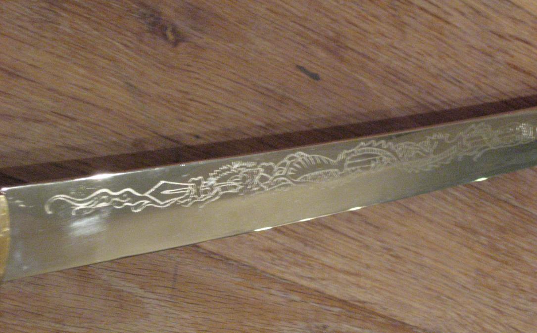

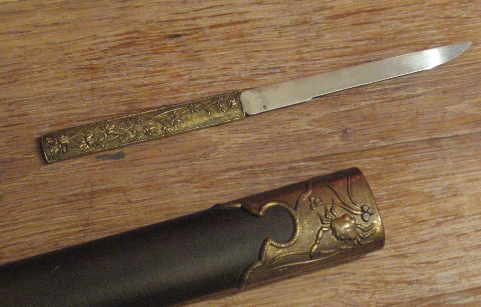

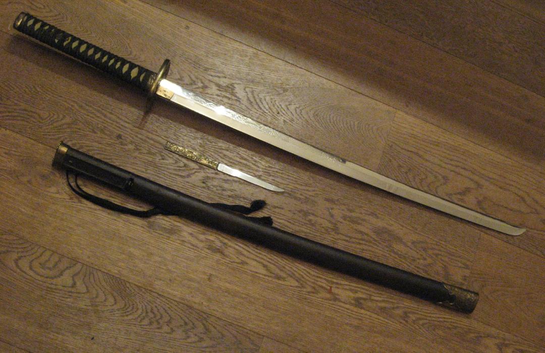

Francantolin,
Congratulations.
Your "sword like object" is approx 30 years old.
I have exactly the same and got it for my 15th birthday in 1984 :-)
I recall that in those days, they where sold an authentic reproduction and where claimed to be made in Spain.
The rayskin is absolutely plastic. There is no actual mekugi (bamboo peg), and under the buttcap you will find a hex nut keeping the hilt and blade together.
The wrapping of the hilt can be better. It became like this because somebody probably has been swinging the sword around.
Mine is still in a corner in the attic for sentimentasl reasons.
If you have no sentimental reasons to keep it, I would suggest not to keep it.

This looks very like a Paul Chen reproduction. That Chinese company makes these as reproductions, not trying to defraud the consumer. The dealer that sells these as authentic on the other hand.........

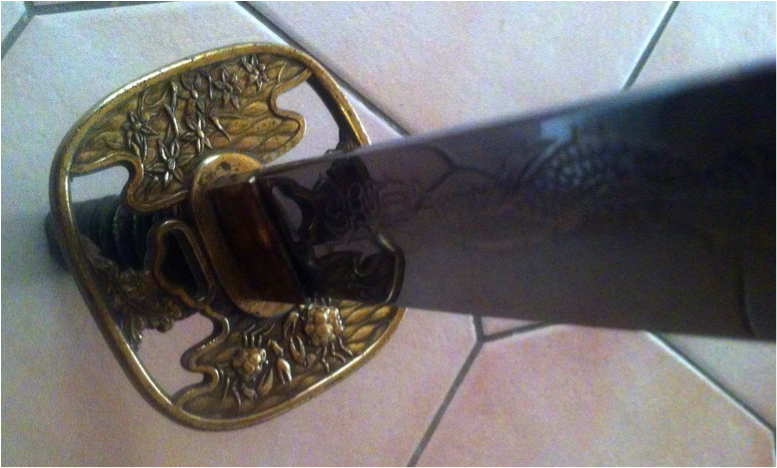

can you make a picture like the last one but with a flash (this will bring out the hamon if there is one) and a picture of the tang (Nakago) please? This would be very helpful.
I would say, it is either a real Nihonto or a good folded or unfolded (1095 steel) reproduction but no poor chinese eBay fake like the second blade.
The loose handle wrapping means nothing.
Roland

I saw your comment but no picture(s) of your sword. I would say the Tsuba looks not bad and the Horimono is also ok for a modern production and not easy to make.
Carvings from China fakes causes eye-cancer in most cases, they are ridiculously bad (I added a picture with an almost perfect chinese Hamon and Horimono).
Unfortunately the picture quality is too low for a proper statement.

Dear Willem,
I checked the attic, and it was still there in prestine condition.
Sorry for the bad pictures, but the best of daylight would not have brought out any hamon.
Willem

These swords where made in Spain, Toledo. I wouldn't say tourist but decoration.
