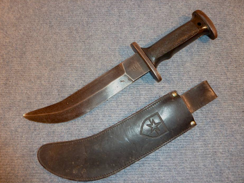

The corvo remained a lost art up to relatively recent times. Today's standard models were created circa 1963 by 2 special forces officers. They had to learn to use it and studied with a man serving a prison life term for seven murders! Today we use moves adapted from Tae Kwon Do with the corvo.
Production was carried out by Andes Sam (a unit of FAMAE) from 1971-2000. Today it's not being manufactured as the unit closed and a new producer has not been found.

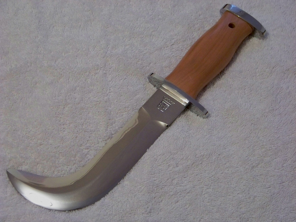

The pictures show this:
first one: the oldest War of the Pacific pic with a corvo used in uniform
second & third: modern corvos. The more curved ones are officer issue, called by troop Parrot's Beak (the knife, not the officer). Special forces use them. The more straight ones are for soldiers, they are the Atacameños (native of the Atacama Desert)
(PS The link is from a store. I have never bought from them)
The knife is very simple and tough. The handle I don't like. It grips better like a sabre (tip up). That goes the wrong way, you should point the beak outwards. The pommel is a good hammer. The military issue corvo is designed to cut metallic nails. It's heavy. Presentation models are plated, combat ones are black.

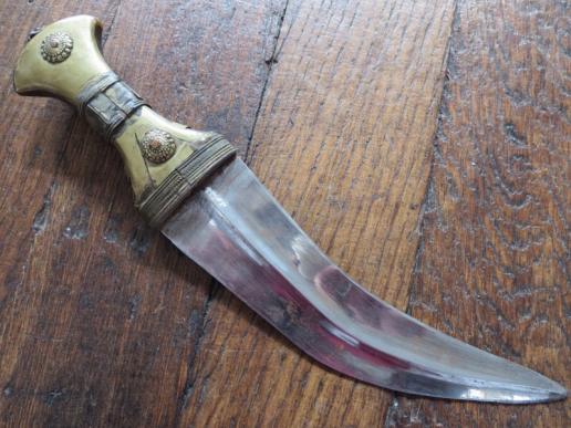

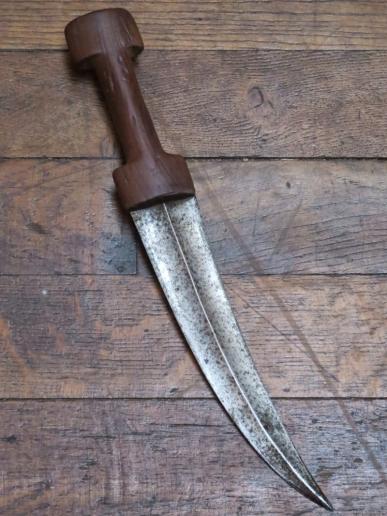

it is of course a so. american version of an old friend, the double edged jambiyah/koummiyah/shabriyah, whose use of the pint down, inner curve we discussed recently on another forum.

There are obvious similarities between the modern corvo and the jambiya.
However, the development of the corvo appears to be quite separate and uninfluenced by the jambiya style of weapon. The corvo started out as a single-edged, sickle knife and tool. From there it evolved to a weapon (sharp on the concave edge only) and eventually a double-edged weapon.
A number of years ago we had an extensive debate about a possible Arab/African origin for the corvo and concluded there was no evidence for such a link or association, rather a similar end point but from different origins.

parallel evolution in action
there was also the single edged sica, used by roman gladiators & the sicarius of palestine & elsewhere.

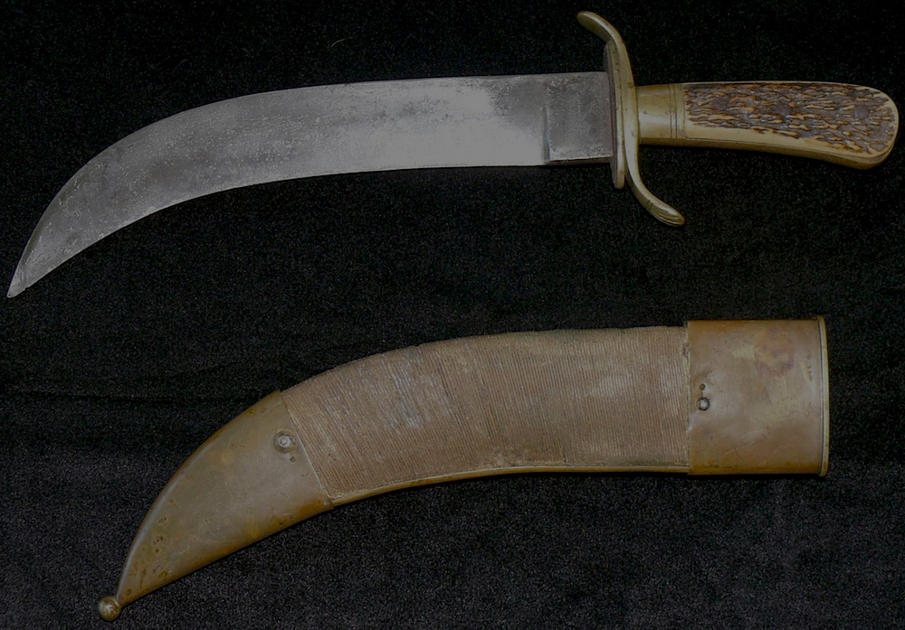

Here is a clearly documented 19th C. corvo. The officer pictured is Sub-Lieutenant José L. Herrera and the picture was taken in Antofagasta on February 20, 1879 (very early in the Pacific War just after the seizure of Antofagasta by Chile). Note the bolster on the hilt and absence of a guard. This was a civilian knife taken to war.

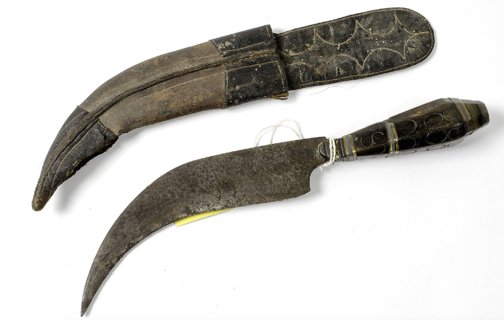

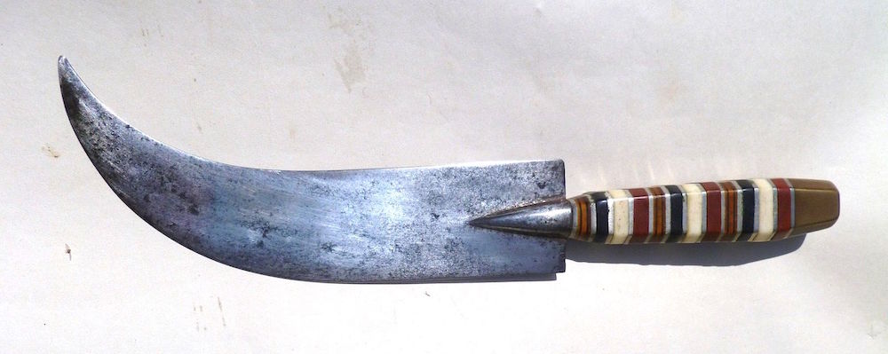

Default Early corvos

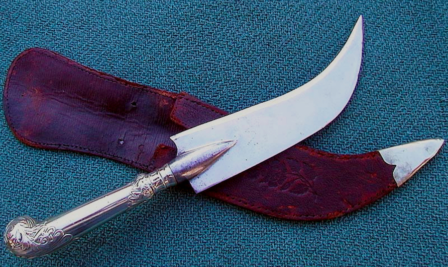

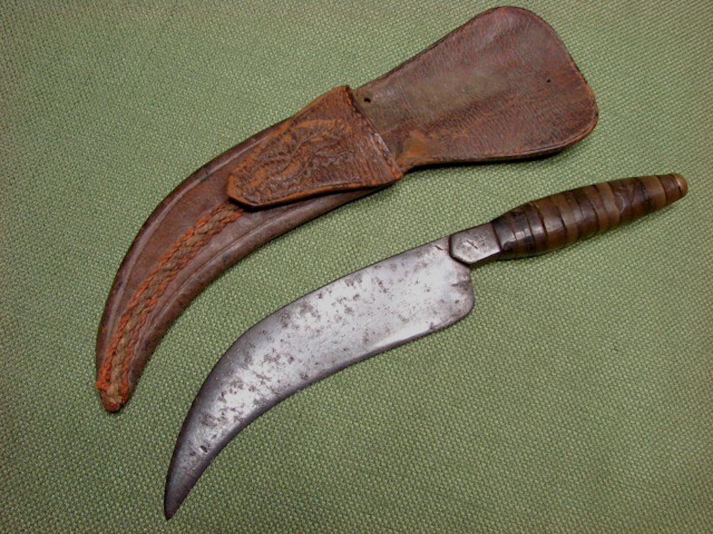

Examples of 19th C. corvo. Note the "Spanish notch" on the blade of the silver handled one, the one below it, and two in the bottom picture--I have not seen this feature on 20th C pieces.

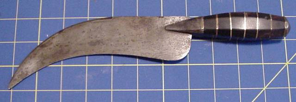

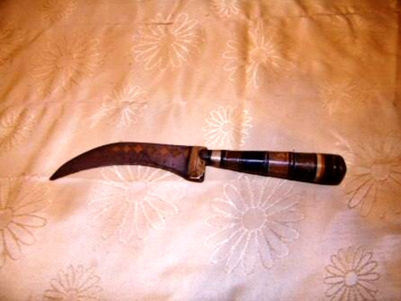

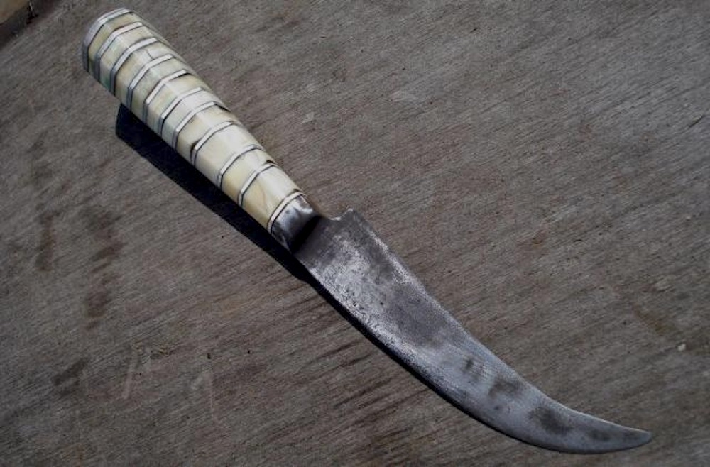

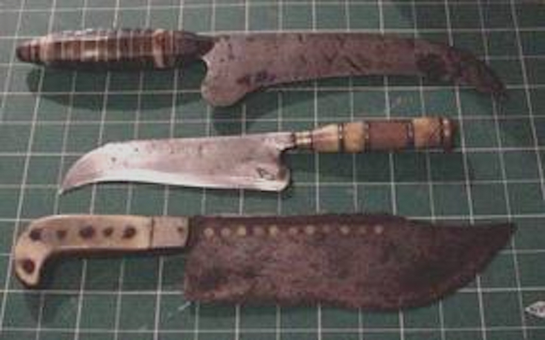

Early to mid-20th C. corvo
Examples elsewhere on this site:
http://www.vikingsword.com/i3/e1526a.jpg
http://www.vikingsword.com/i3/e1526b.jpg
http://www.vikingsword.com/i3/e1526d.jpg
http://www.vikingsword.com/i3/e1526c.jpg
Other examples:

A European version of the corvo. A German single-edged hirschfanger made in the corvo style and manufactured by Laute in about 1910.
