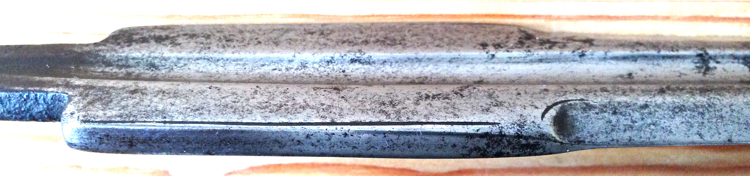

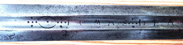

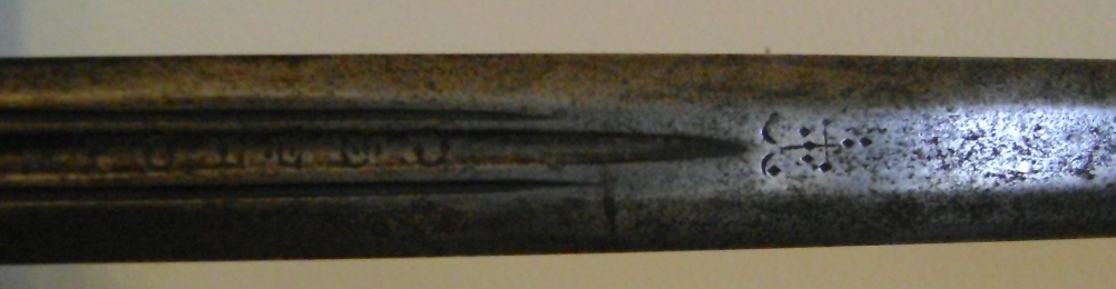

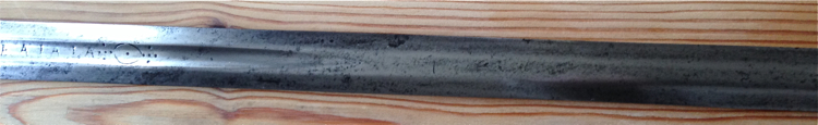

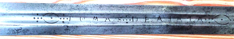

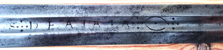

Hi,
Blade length 37 1/4 inches (94.5 cm) tang length 6 1/8 inches (15.5 cm). On one side TOMAS DEAIALA or TOMAS DEAIAIA other side IESVS MARIA. The I in Jesus looks like a J but upon close inspection it appears to be an I. I know there are many period and later blades with spurious markings but I'm not sure with this one. Looking forward to your thoughts.
Norman.
P.S. Please excuse the photography I have no camera at the moment so the wife's phone and a little jiggery-pokery on the computer was all I could do so the photos may appear a bit photoshopped with an odd colour temperature.

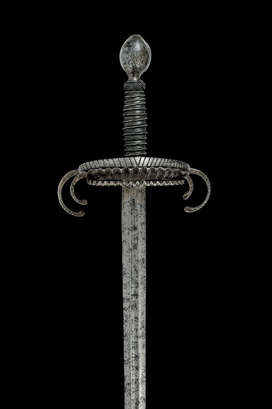

Hi,
Images from a well known auction house.
Norman.

Blade on mine is double edged flattened hexagonal cross section after the fuller tapering to almost lenticular very near the point.
Norman.

hello
In modern silk, the name is TOMAS DE AYALA
Affectionately. Fernando K

Old 12th May 2015, 12:15 AM   #7
Posts: 10,732
Hi Norman,
The TOMAS DE AIALA name was from Tomas Ayala of Madrid ( who is also noted Toledo as he was of course of these smiths) and his son Luis who was in Barcelona. They worked c.1566-1620 but more on their exact dates and locations is unclear among arms writers.
The Tomas Aiala name, like Andrea Ferara, became one of those names of famed makers which became a sort of trademark, and appeared on blades from Italy (c 1620s) and Germany later..in fact into 18th century.
The JESUS MARIA was used by Milanese armourers (Wagner, 1967, p.173) as well as apparently by the Ayalas In any case the combination of these names and variations of spurious Toledo marks often are seen.
In my opinion , the occurrence of the 'anchor' device suggests a Solingen version here probably 17th century using the Ayala 'trademark'.
I have seen rapier blades with Jesus Maria and Toledo marks as late as 18th century (with Ayala though) as a good number were discovered in a wreck off Central America in the 80s. These, like the 'Spanish Motto' blades were shipped in good numbers to Spains colonies from Solingen producers.

Old 12th May 2015, 05:04 PM   #10
I guess that, if it were a blade forged by Thomás de Ayala (as spelt in the XVIII century), during his early XVII century activity, would have his mark on the tang, in the ricasso area ....

Norman, in reviewing this you make some good points, and I am inclined to think you may be right on 17th c attribution here. The position of the anchor as you note, as well as the style of the fuller with the profiling along each side of the blade remind me of blades I have seen of Alonso Perez. This maker of Toledo also used a similar type anchor device.
What is interesting is that one of the Perez blades was on a rapier found on the well known galleon wreck , the Atocha, which sank in 1622.
What Fernando said is also correct, the punzone used by Tomas Ayala , the crowned ST would have been at the ricasso if indeed his work. Also I am unclear on why it would be Tomas DE Aiala and not TOMAS AIALA.
As noted he was around until the time of the Perez blades, so it certainly seems plausible it could actually be the general period.....the only concerns for me would be the nature of the tang/blade which does not correspond to the blades of period rapiers if I am correct.
Next I would ask what sort of provenance might have this blade without hilt. I have seen of course, many instances of unmounted blades, notably with JESUS MARIA as previously noted from a wreck (I think there were about 40 of them). These were apparently Solingen made and probably latter 17th c. and the punzones were not Ayala. These also had the same style tang as this one.
The 'disconnect' in the 'anchor' I think possibly due to these style markings (we call them anchors, but they are stylized sigils in my opinion) seeming to have peculiarities which reflect highly nuanced symbolism.

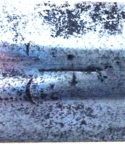

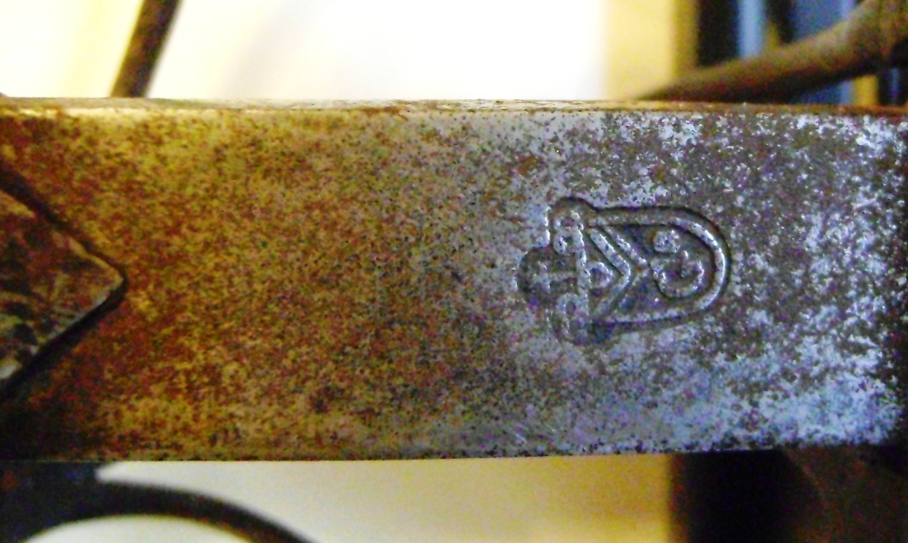

P.P.S. Is this the symbol or similar you are referring to?

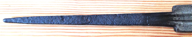

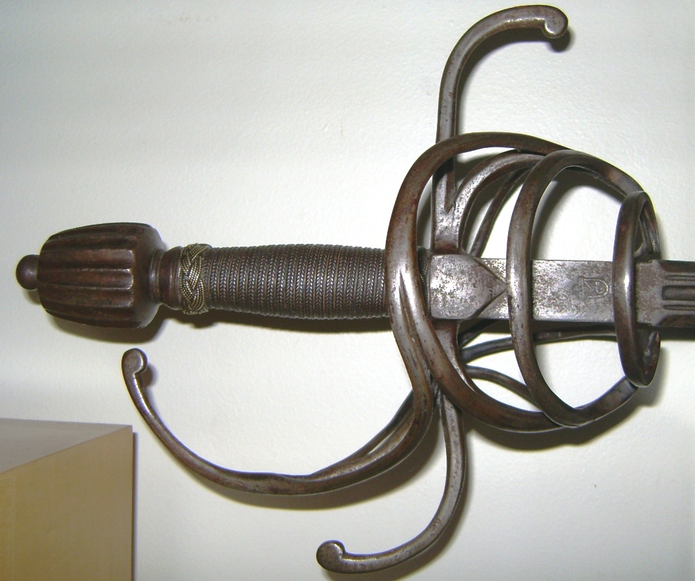

I'm really bad at finding pics etc. but what I mean is that on rapiers it seems the guard of course is at the base of the blade, and the ricasso extends to the bottom of the grip. In other words there is a section where the fingers extend past the grip and around the block section. With the cuphilt for example, the cup is at the blades end, and inside there are pas d'ane rings adjacent to the ricasso......then the grip starts beyond that.
In this type of tang, the grip is right at the blade base, there is no ricasso to be visible inside the cup or guard.
Fernando can explain this better
The symbol you show here is the cross and orb, while somewhat related to the 'anchors' in having cross symbolism, is not what I mean by the symbol on your blade.
The cross and orb relate mostly to German blades, and though often suggested 'makers marks' are usually used in conjunction with various names, invocations or other inscriptions on blades. This is very much like the way the 'anchors' were used on Spanish blades, and used in Solingen with other spuriously used punzones, names and phrases.
On the Aiala name, just an observation as the name is spelled differently on various occasions so interjection of the 'de' might be correct. Just seemed notable.

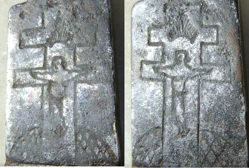

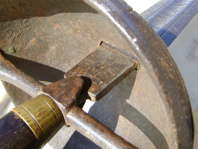

In the plate and nomina designed and crafted by Francisco Xavier Palomares in 1762, after the listing drawn by his father Francisco Santiago Palomares, the name for these smiths (father Thomás and son Luis) was DE AIALA.
Mind you, the maker's punzon may appear both in the uncovered part of the tang, before the guard (ricasso), also in the first third of the blade section (forte).
BTW, the term ricasso may also be applied to the blade section right after the hilt when its purpose is the ( long) sword entire hand holding, which is a different story.
Whereas the blade has (or not) an assumed ricasso before the hilt, i would say such is not a characteristic of different smiths but the purpose the blade is going to serve, whether a cup hilt sword, a swept hilt rapier, you name it.
I am not sure this whole story makes sense, as i am far from having a profound knowledge of the subject.
Attached are examples of marks in ricassos, the first a cup hilt sword with period symbol in both sides and the second with a makers punzon in one side; the first also with a period typical motto on the blade (MIN SINAL HES EL SANTISSIMO CRUCIFICIO) and the second with the maker's name (GONZALO SIMON).
Master Gonzalo Simon (1608-1617) also figures in the Palomares nomina and, eventually also uses the 'anchor' mark

Hola Me ha llamado la atencion el motto . No deberia ser
MI SEÑAL ES EL SANTISSIMO CRUCIFIJO
Afectosamente. Fernando K
(El traductor no permite, o no se, ponerlo como corresponde, en ingles)
Old 14th May 2015, 04:27 PM   #21
Espaderos were not so good in writing as in forging blades, Fernando .
The only letter of the motto i was not sure of, was the H, as this part of my blade was rather worn.

I think it's a rapier blade (given the broad ricasso of same width indeed an early rapier blade and not a small sword blade) from the last quarter of the 16th century perhaps very early 17thC, given the eye mark, probably Italy.
Hope it helps.

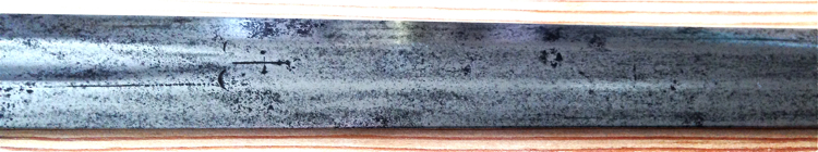

Just noticed this mark on the tang. Unlikely to be a makers mark, inventory number?
