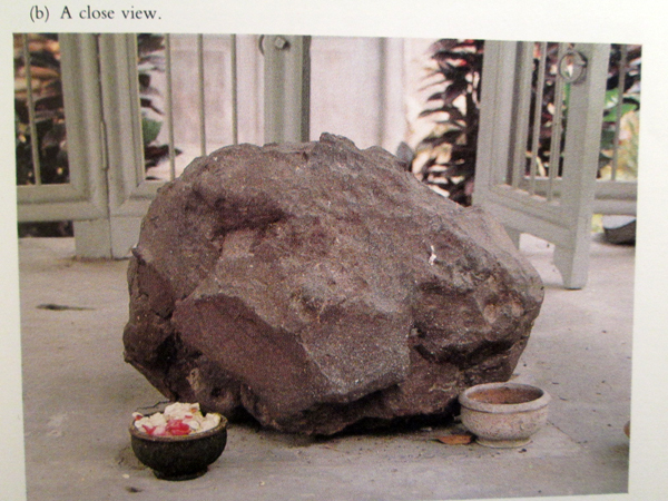

I should like to know the dimensions of the part of the Prambanan meteorite still present in the kraton of Surakarta today.
Can anybody, who has access to the kraton, help me with that information?
Does anybody have recent photographs from that meteorite from different angles?
(Especially the places where parts were taken of for the forging of kerises)

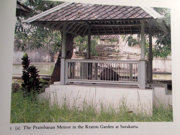

Seerp, there are 2 photographs of the meteorite in Edward Frey's book (The Kris, Third Edition), one showing the entire shrine and another more close up. Just after page 54. I can't be sure from the photo, but i would estimate that the remaining piece is perhaps nearly 2 ft. high by nearly 3 ft. across.
This book was first published in the mid-1980s, but i am not aware that pieces of this meteorite were still being used so i would imaging that the size of the piece hasn't changed much since this photo was taken.

Seerp, if you have a look at Edward Frey:- "The Kris" Oxford University Press you will find a couple photos of the remnant of the meteorite, and a short commentary on it. I cannot find my copy of Frey at the moment. Sorry.
I visit the public areas of the Keraton Surakarta Hadiningrat regularly, my most recent visit was in April this year, but I've only seen the meterorite remnant once, and that was perhaps 25 years ago. Even if you could see it in person, I doubt that you would learn anything from it. There's not much of it left, from memory, its about 24 inches long, 18 inches high, less than 18 inches wide.

Originally Posted by David
Seerp, there are 2 photographs of the meteorite in Edward Frey's book (The Kris, Third Edition), one showing the entire shrine and another more close up..
These pictures are from Edward Frey's book The Kris, second Edition,
(which are the same, I guess?)
sirek is offline   Reply With Quote
Old 16th May 2015, 11:06 PM   #5
Posts: 7,286
Yes Sirek, those are the same photos as in the 3rd edition.

Sirek, thanks for the photographs.
I have put some (estimated) dimensions on them.
Left from the lines the dimensions in cm. At the right side inches.
A rough calculation, from this dimensions, estimates the weight of the meteorite remnant to be approx. 1000 kgs.
I am very interested in the true dimensions as well as the surface where parts were chiseled off?. Probably the backside of the meteorite.
When anybody visits the keraton........
