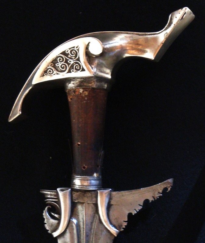

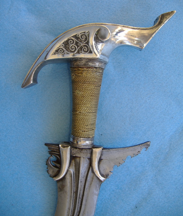

Greetings folks!

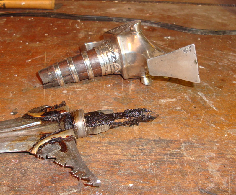

By request, I am posting some pictures of one of the recent restoration projects I have done.

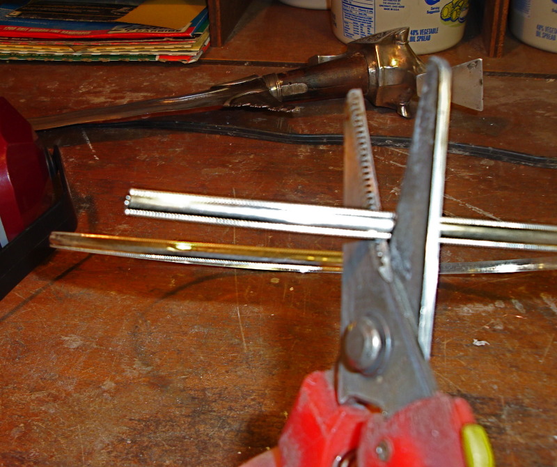

These first 2 pictures are of the original piece with the hilt wrapped in later twisted brass wire. I took that off and discovered that there were extra holes drilled into the wood to place the ends of different strands of twisted wire.

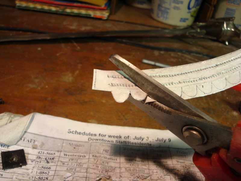

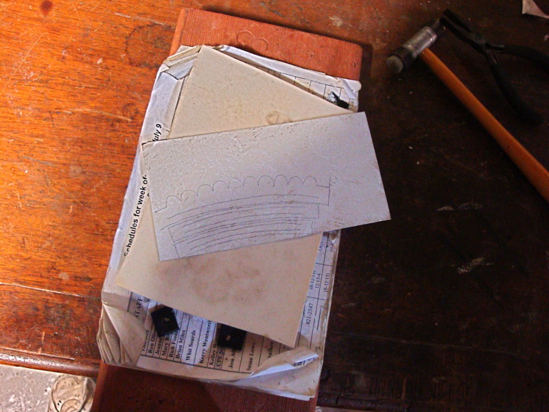

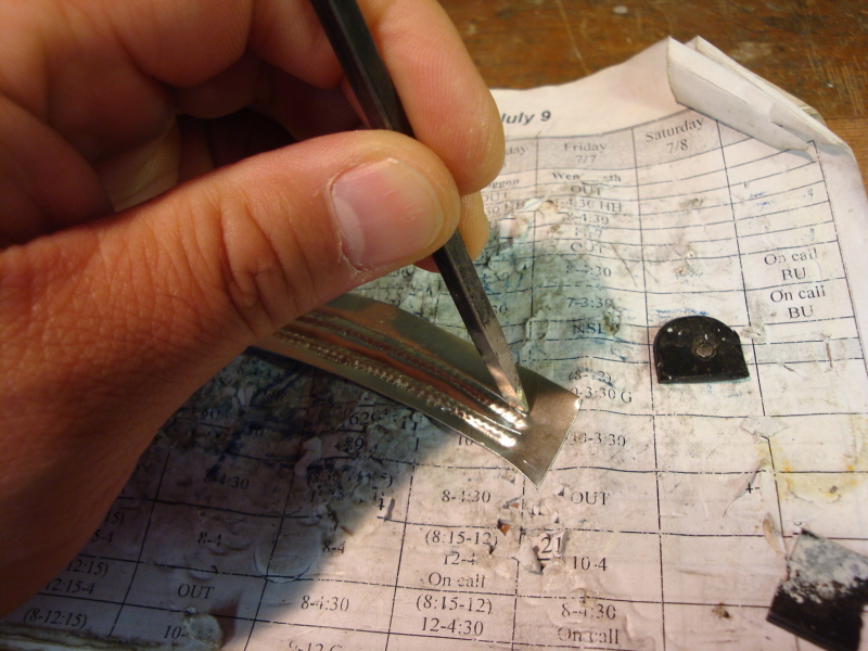

Then I drew out the design on sheet silver and repoussed, cut, and stamped the top band.

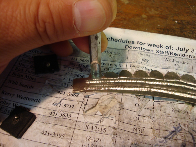

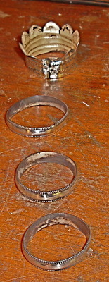

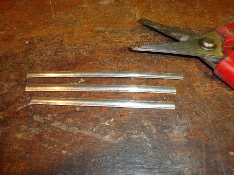

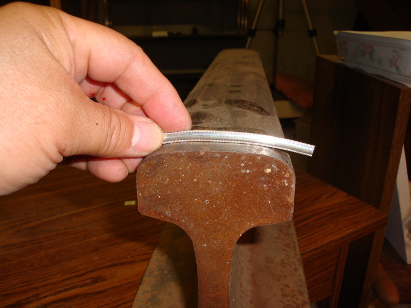

After that I then cut and hammer bent the other silver bands into shape.

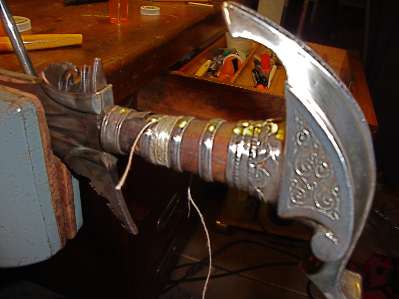

I then soldered the silver bands, placed them on the hilt, and wrapped the spaces in hemp (lacquering the hemp).

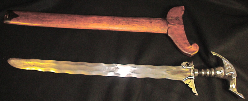

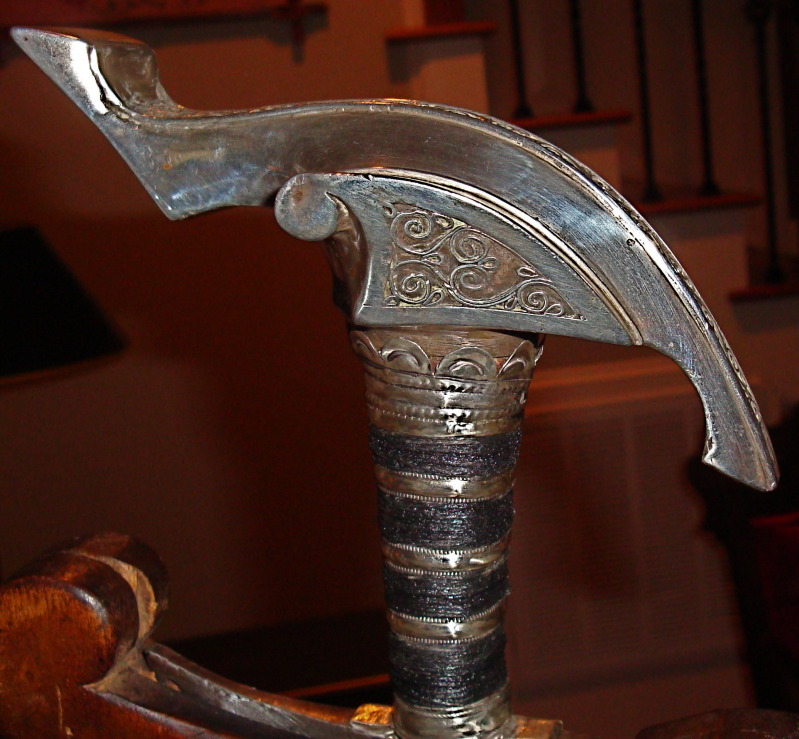

Here are the final results:

Wow! nice work Jose :-) Do you also work on items from other cultures?

looks great Jose
What guage of silver sheet are you using?
Old 18th October 2012, 02:32 AM   #10
Posts: 7,403
On the top band I used 28 gauge. For the other bands - I forgot (sorry).
I tried to match the gauge of the bottom original band as well as be thin enough to do a primitive form of repousse. Unfortunately I could not match the bottom band because it is thicker and cast silver.
In some way I tried to match the rope motif from the bottom band to all the bands, including the top band.

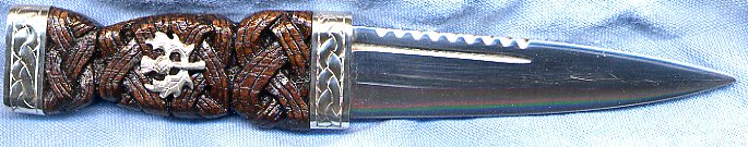

Another good question: I do as much research as possible to base my work. For example, on Moro pieces I try to do the work based on the work and motifs of the particular tribe a kris comes from. On the Scottish sgian dubh I carved (wood and silver work) the knotwork based on Celtic knotwork one on others like it (see below).
