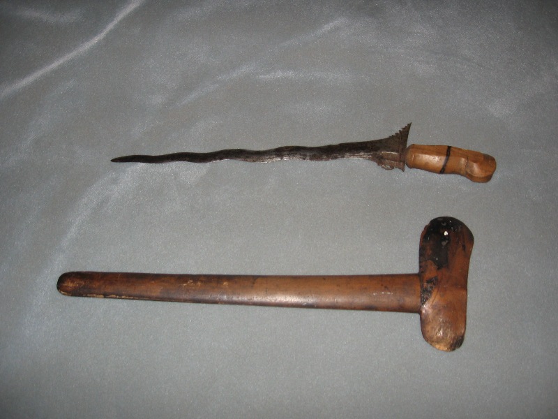

I found this Sunday at Flea Market in Central California I bought two blades one from the Philippines and this which I know is Kris- not sure if you class it a knife or short sword the blade length is 14 /12 inches, base width is 3.5 tip width is 3/8 inches handle is 4 1/4 inches. Please help me ID where the this blade is from and roughly how old. It is a forged damascus.

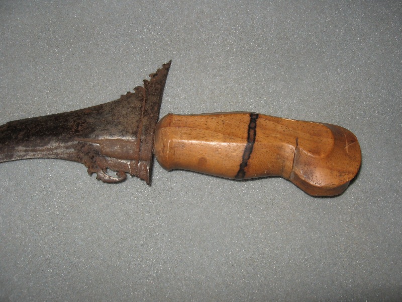

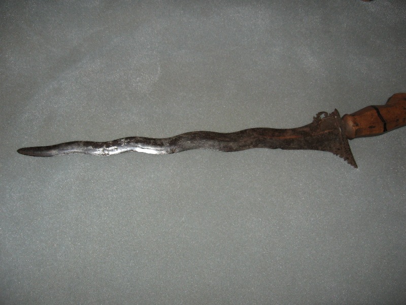

Generally speaking keris are referred to as "daggers", though some indeed reach lengths that could qualify as "short swords". Yours could either be from Bali or Lombok, but from the form of the sekar kacang at the front of the base of the blade i am leaning towards Lombok. It is sometimes very difficult to distinguish between these two origins. This is actually a bit short for keris from this region which are often between 16-18 inches or longer.
Age is always tricky and your photos are not helping clarify very well, though there is some obvious age and i would say 19th century is a fair guess. The kendit (belted) pattern on you hilt is a desirable catch when true and not painted on. Yours appears to be a true pattern. It's a little beat up, but the wood should respond well to some cleaning and oiling and the blade could use a good bath and toothbrush scrubbing in some pineapple juice.

All true David, but I tend to regard all of this style of keris as Bali, the reason being that although it may have originated in Lombok, it would have done so from a Balinese cultural base in an area that the Balinese still living in Bali regarded as Balinese.
To me, this one looks more Bali than Lombok, but I don't really know of any really distinguishing blade features that separate one from the other. Generally speaking, if I see a Bali style keris that has an acid cleaned blade rather than a polish cleaned blade, I will opt for Lombok. If I see a Bali style keris that demonstrates some sort of extremism in some way, I will opt for Lombok.
Stock standard Bali style and evidence of a polished finish --- no matter how deteriorated this may be --- will have me leaning to Bali origin.
But it often is guess work.
Nice thing to find in a flea market.It will restore very well indeed.

I will certain defer to your greater knowledge on this one Alan. What i was looking at was the rather long and thin sekar kacang which seemed just a little unusual to me. But i agree that everything else looks solidly Bali and that the polish is a good indication as well.

Yeah, the kembang kacang looks more like Madura than Bali, but we need to make some allowance for difference in makers' styles and difference in preferences from time to time.

Thanks Alan, Madura style was exactly what i was thinking.
