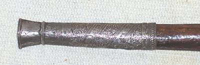

Just buy this keris. I think that it is a Minangkabau but not really sure. What is your opinion?
Thank's in advance,
sajen

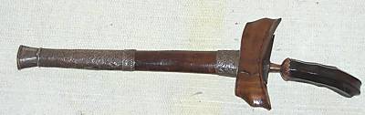

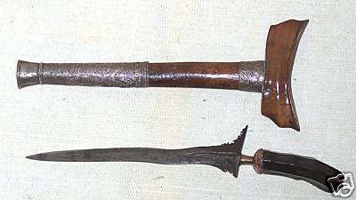

Here some more pictures from the seller. Oversheat seems incomplete or not original. The handle he write me is very heavy, maybe from horn. Selut maybe from Suasa (?). Lenght complete 12,5 inch / 31,75 cm, blade 6,25 inch / 15,9 cm.
sajen

Can we have a close up of the blade, please. The blade form seems to be of Minangkabau worksmanship.. The hilt, I'm not too sure..

until now I don't have other pictures, they all from the seller. A similar hilt is to see at Jensens Kris disc, chapter 9.3, picture 173b by a keris from Aceh. The hilt is old javanese style, nunggak semi type.
sajen
Sorry, still one picture I have.

Thanks for the close-up pic.. looks crude, later works, perhaps?

yes, the blade looks a little bit crude. But I have the hope that it is better in real, like yours or nine from this thread:
http://www.vikingsword.com/vb/showthread.php?t=8160
Interesting in my opinion is the handle. Not only at Jensens Kris disc I have seen a keris from Sumatra with this form of handle also somewhere else but can't remember excatly where. Some other examples from members with this handle form?
