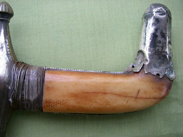

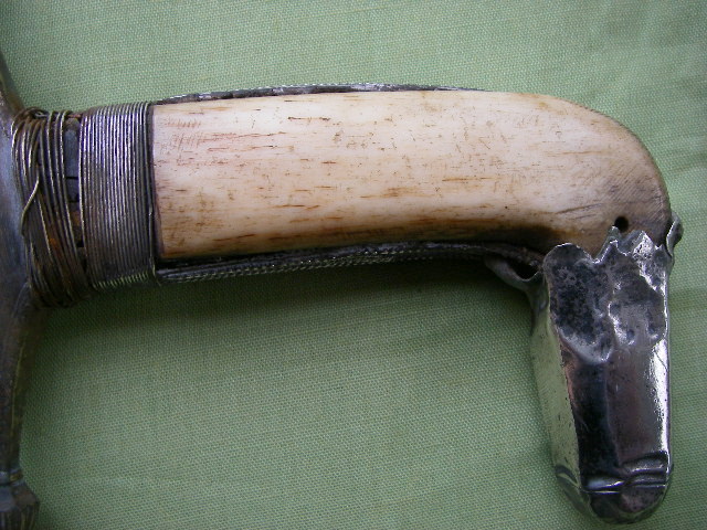

Hi all, this is a recent purchase..........as you all know by now, I buy edged weapons because they look pretty, and then wonder what they are! The back edge for about 6 inches back from the tip is quite sharp; there are no markings at all on the blade; the silver scabbard has been mended in the centre section , with an inferior metal (it has a greenish tinge, so maybe some copper in there); the handgrip has panels of what I think is ivory. I took the sword to a silversmith and he tested the metal and confirmed that it is silver. Solid silver scabbard and silver on the grip indicates (to me anyway) that it must have been owned by someone of status. The ivory(?) panels are dark on one side of the grip and light on the other, and I am told that ivory exposed to the light remains light in color and ivory kept in the dark turns yellowish, hence my thought of ivory rather than bone or other.
All comments welcome, and thank you in advance.
Brian

Brian,

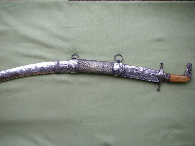

This sword is somewhere from the Arab peninsula, or maybe Syrian, based on the hilt shape and the decoration on the scabbard. To me the hlit looks like bone.
Nice sword.

It was supposed to be worn edge down. It does not look like a katana or a shashka:-)

Absolutely phenomenal Brian!!While Teodor is right, this does have initial appearance of Arab sabres and resemblance to the 'Baddawi' style hilts on many of them. The scabbard resembles those on the sa'if of Hadrahmaut and Yemen, however the carrying rings are not in the normal baldric style.

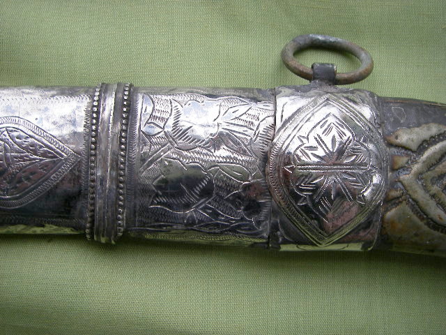

This scabbard has the carrying rings on the convex side, with blade worn edge up, in the style of the shashka. The right angled pommel on the hilt, Persian style crossguard, scabbard of noted Hadhramauti style (these are known to have been produced in Hyderbad, India) and triple fullered trade blade strongly suggest this is a Caucasian sabre, presumably Georgian and possibly even a Khevsur weapon.
With trade contacts with India, the features on the scabbard (the aghrab device on scabbard throat) and the wire wrap at grip neck (seen on Persian and Arab sabres, but some shashir styles in India also), these influences reached Caucasian craftsmen as well.
There are of course certain complexities in the elements of the sabre overall, but I would think this is a very interesting sabre of these Caucasian regions.
Further research may reveal more, but from first glance this is my opinion.

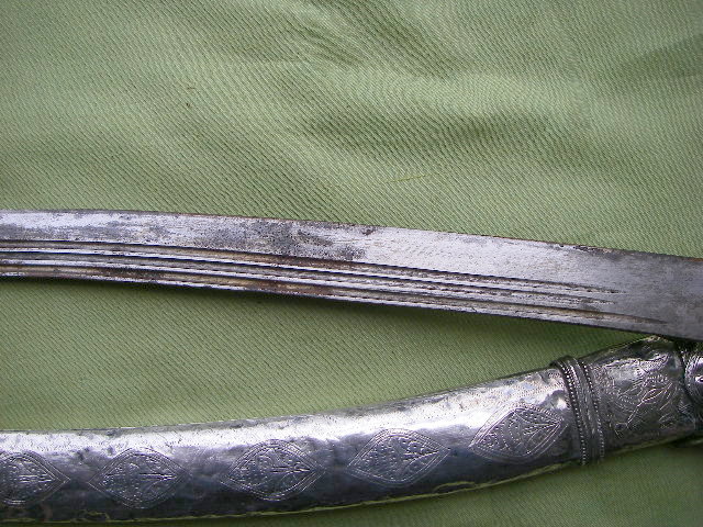

This piece has all the indicators that it may be one of the multitudes of variant sabres used in the Bedouin sphere, but the scabbard rings were the first clue.
Even more confusing, while this resembles a shashka 'gurda' style blade, which were copied from European forms, it seems more likely Caucasian,although lack of markings seems unusual.
I had suggested a Khevsur sword, which were often roughly furbished by native artisans, but these sabres typically were mounted in regular edge down fashion.

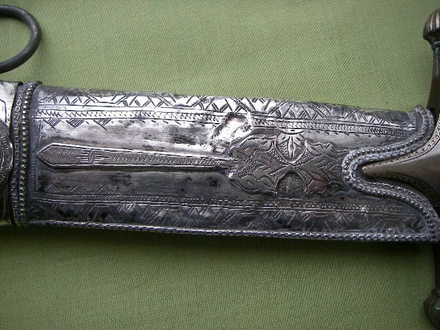

The scabbard throat has the stylized device known by the Arabian term 'aghrab' (=scorpion) and served as an apotropaic in the folk religion as protection against the evil eye. These, as noted, are regularly found on the scabbard throats of the Hadrahmauti sa'ifs which were also used in Yemen. These silvered scabbards, according to Elgood ("Arabian Arms and Armour") were typically produced in Hyderabad, India for export.
The scabbard, as mounted with rings at convex or blade edge upward means that the scabbard was worn with that 'aghrab' inward and non visible. Also, the decorative carrying ring bosses also faced inward. More puzzling is the center section, with crudely fashioned geometrics as would often be seen on the obverse (non visible) side of the scabbard.
Caucasian scabbards are typically decorated on the visible side, and quite plain on the inside.
The hilt, as noted, is intended to approximate the beautiful ivory and silver hilts of the Persian shamshir, the most desirable in the Dar al Islam, however the pommel cap, though beautiful silver, quite crudely done. The wire wrap at the neck, while sometimes seen on Persian shamshirs, is quite typical on Arab, Central Asian and Indian versions of shamshir. It does seem also a Caucasian affectation on some Khevsur examples.

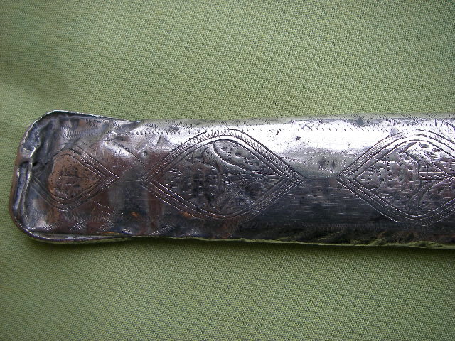

While I cannot place for sure, the motif en cartouche on the scabbard panels seems Caucasian, the bird being one figure that seems to stand out.
I think that this sabre seems rather simply furbished by a village smith, with components and influences at hand. With distinct Arabian characteristics in imitation of the favored Persian style, and features suggesting Caucasian influence and last, the curious positioning of the carry rings suggesting Russian fashion......I think the closest we will come to final answer will be somewhere in the Ottoman sphere.

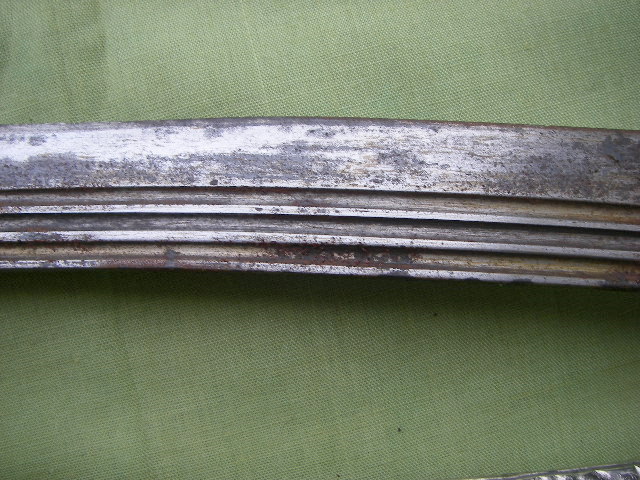

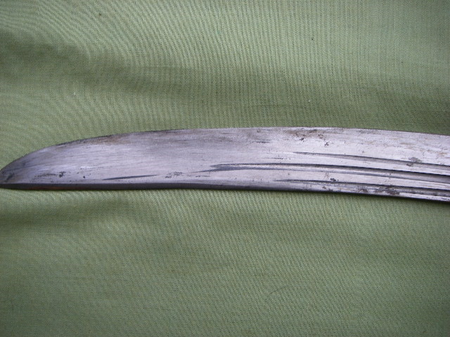

The blade with 3 narrow and very "mechanical" fullers looks , if anything, trade Syrian or N. African ( the worst, Heavens forbid, is a modern Georgian arts and crafts design). The silverwork is NOT Caucasian at all. The handle of Georgian swords widens toward crossguard, and Khevsurian swords have flat brass ( or, if expensive, silver) rings, just like the scabbard.

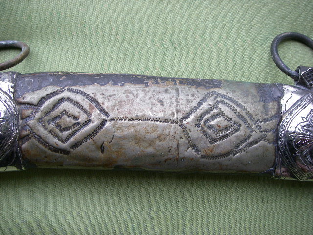

My guess, the fittings were reassembled: the middle section of the scabbard covering is a primitive replacement. At that time, the adjacent suspension plates were put upside down.

Ariel put it quite nicely, and accurately. This sword screams reassembly, and fairly recent. Even though it resembles a legit Arab sword form - so many components are out of match, and of low quality. It's hard to judge by pictures, but in my opinion it has been done by an amateur.

If I were to caption this sabre, and with all of the very helpful discussion placed here to arrive at some consensus, I would say:
A Bedouin sabre, mid 20th century
While this blade is definitely a 'trade' blade, it is of triple fuller form which is copied from European forms that were produced into the 20th century (similar examples are seen in "Boarders Away" Gilkerson). The crude fullers suggest native production, probably imitating earlier Hungarian sabres.
As I have been emphatically informed, the silverwork is not Georgian which is clearly correct after I have discovered the information on doves. I am grateful for learning that as well. The note on the carrying rings is also absolutely correct, and looking at Khevsur examples they are indeed flat and more refined.
Bedouin's typically did not have blacksmiths as handicrafts and such work were considered demeaning, in the 19th century ("History of Arabia", Andrew Crichton, 1833), however certainly by the 20th century, such restrictive attitudes probably were less prevalent. It seems quite possible this blade may have been furbished into a charming interpretation of the much admired Persian shamshirs, and regardless how crude the work, it was fashioned with purpose and probably worn proudly by at least one Bedouin tribesman.
All very best regards,
